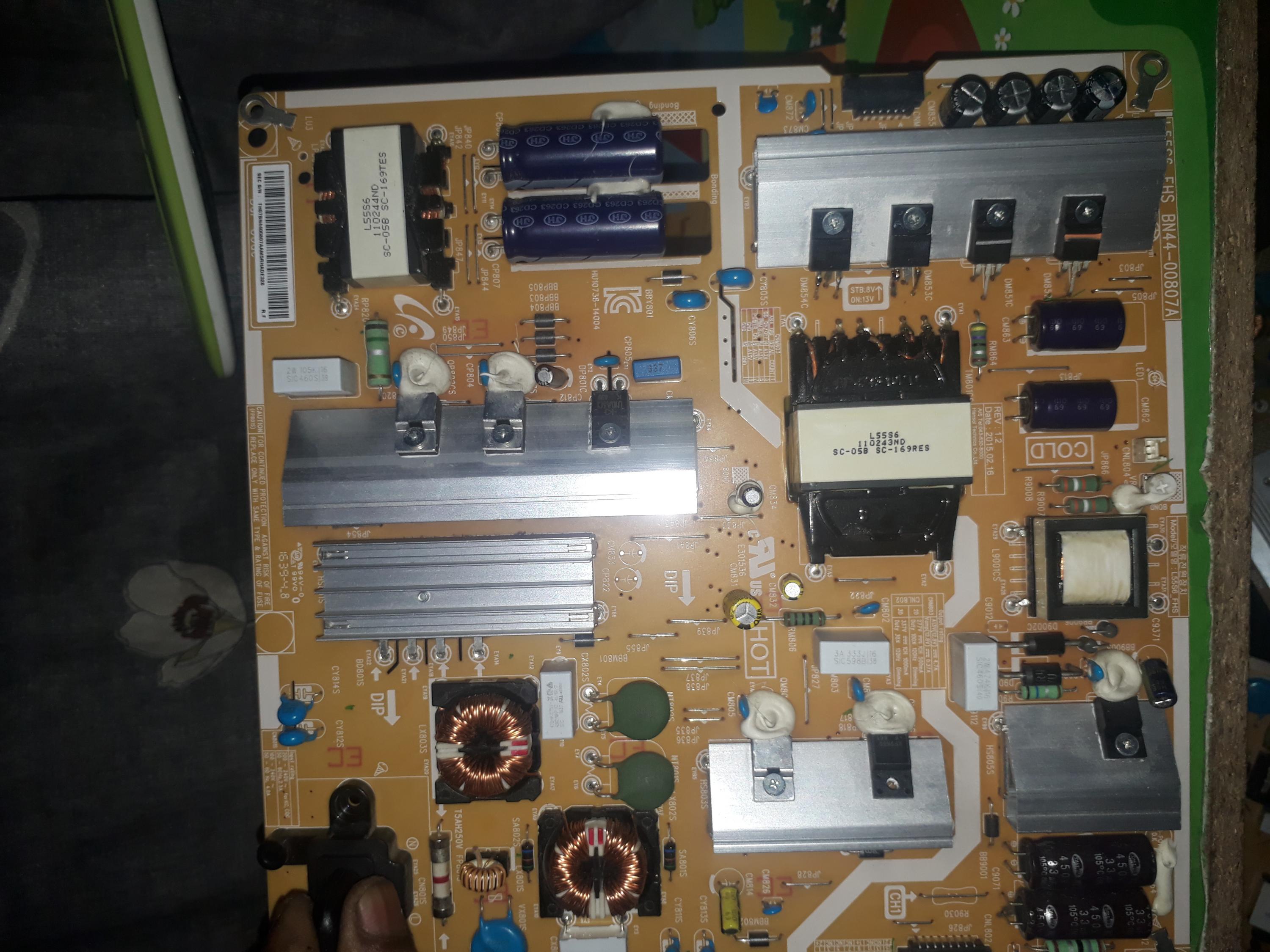

    Samsung curve 49 BN44-00807A
    hi need ur advice to my problem.. all the voltage are fluctuation.. primary and secondary. what is cause that so. all the transistor seems ok no short at all. when i unplug cablle to main board sometimes backlight turn on and some not.. voltage 13v is goind to 8 then 3 back to 13 just like that

    Re: Samsung curve 49 BN44-00807A
    some one with bad soldering experiences worked on the Powerboats. need to rework all in clean way under good magnifier.
      When you unplug cable to mainboard (always do it with tv unplugged from power then plug power cord into powerboard) the backlights should stay on every time, not just sometimes. Check all your solder joints, look them over real closely and give them the wiggle test to see if any are loose, reflow any that look bad, can google for bad solder joint images if needed, is a good place to start I guess.

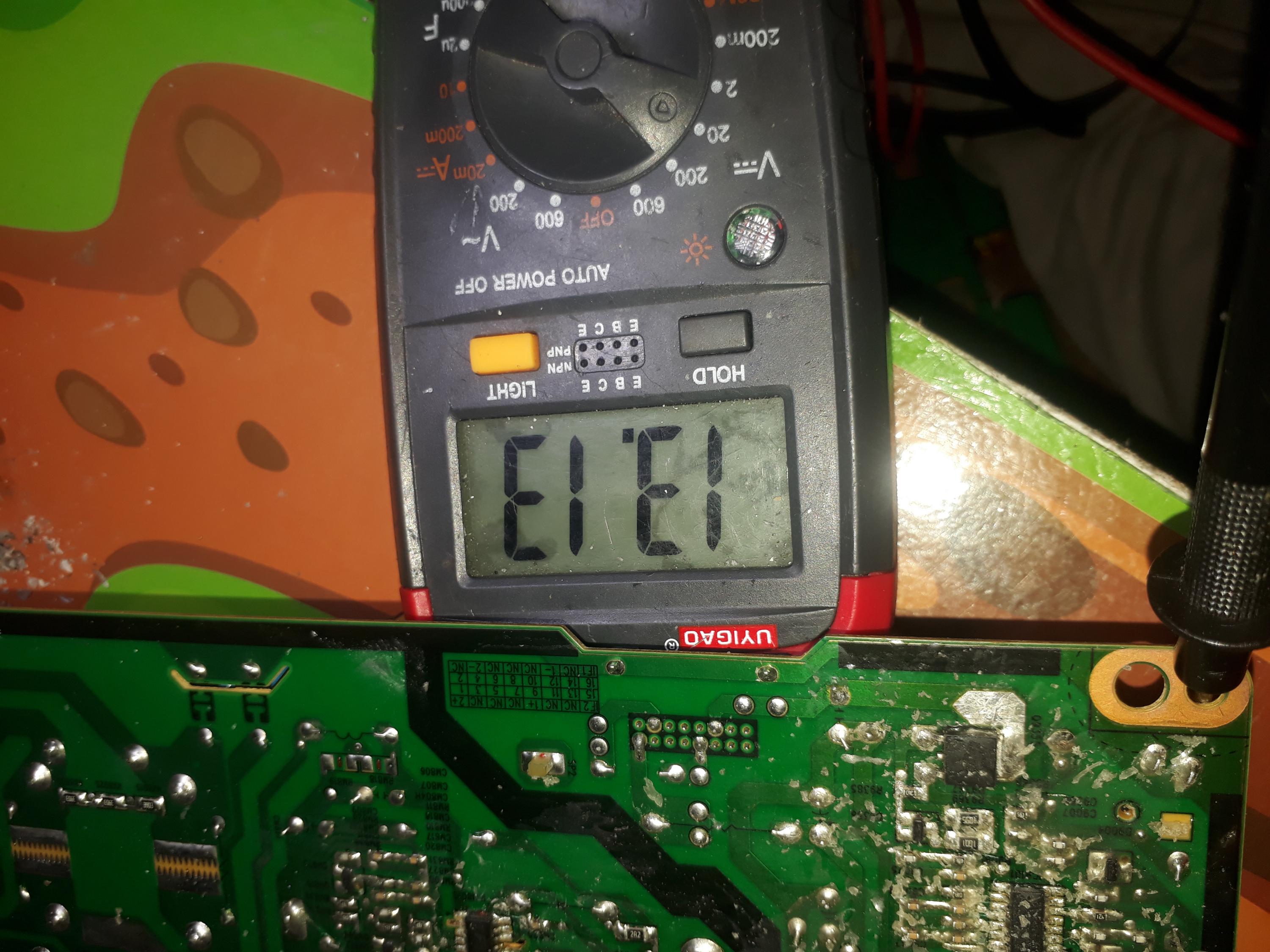

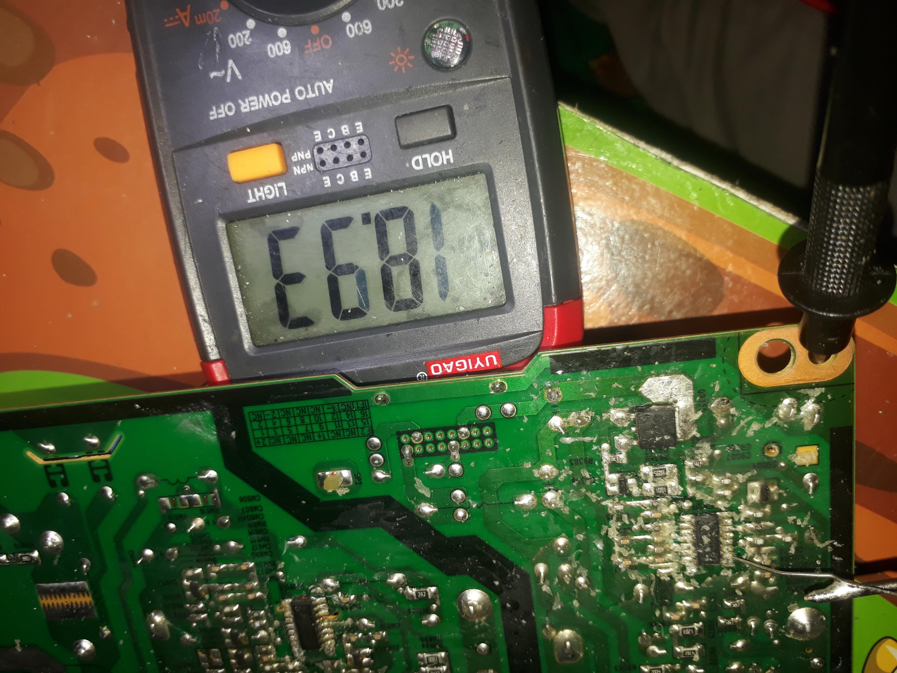

            backlight driver at pin 1 , i think the input .. see 13v 10v and 8v..
            what is maybe the spoiler..
              my power supply ac line also not stable 233 - 240 fluctuation.. is that cud be the cause of output 13v got fluctuation..
                If you run the power supply board by itself without cable connected to the main board, what are the Voltages at the power supply board connector that goes the main board?
                What is the history of the TV?
                Did someone try to repair the board before you?

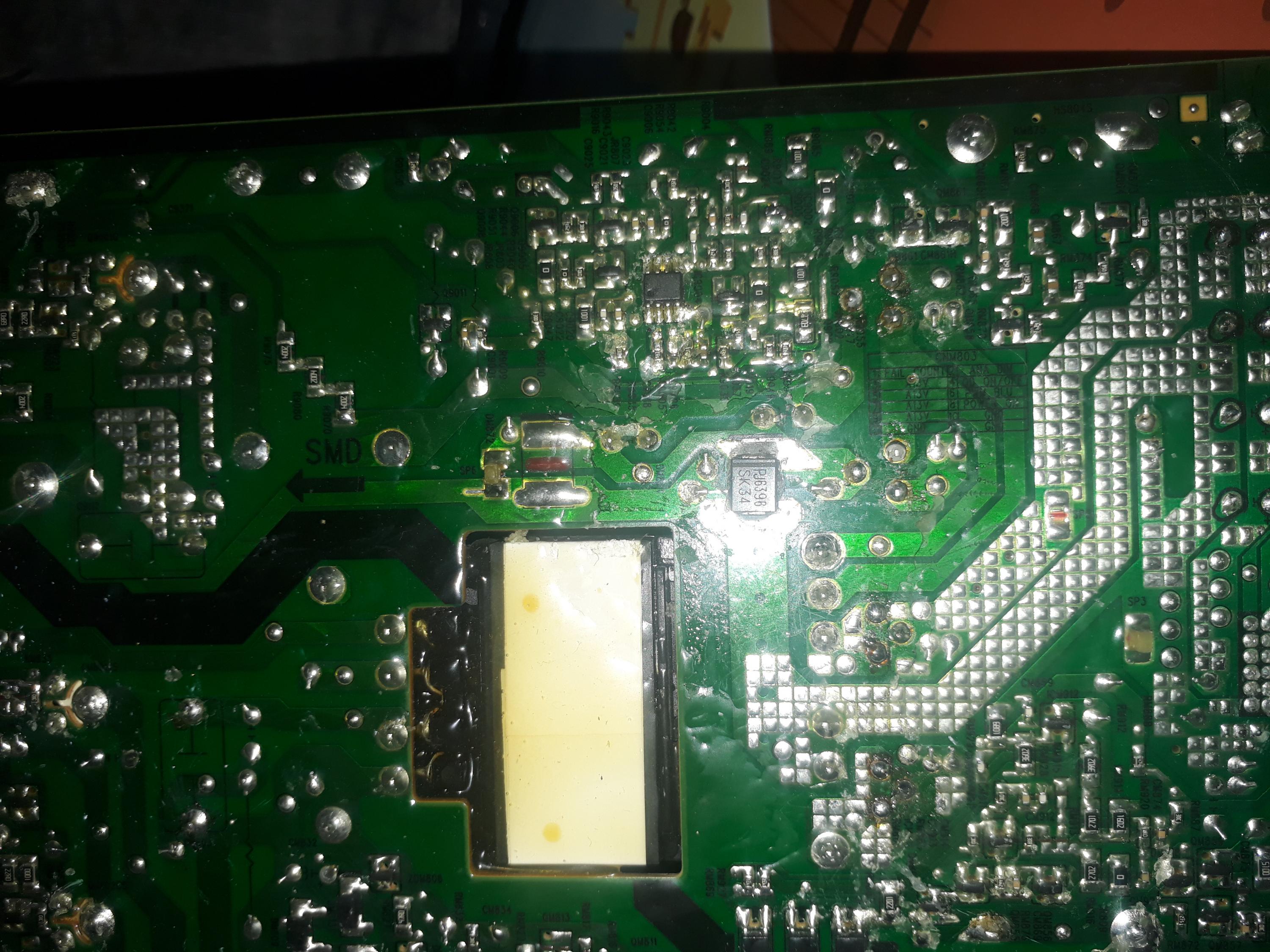

                  https://www.badcaps.net/forum/showthread.php?t=90116
                  Check my thread here.
                  Not 100% that it's causing your fault but it's fairly common with your fault symptoms.

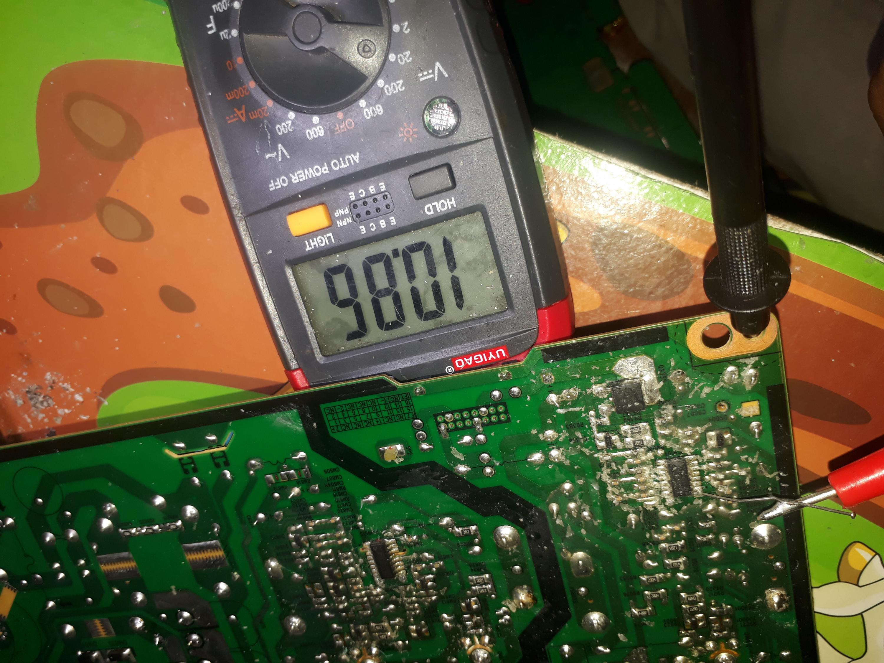

                    [QUOTE=budm;1022372]If you run the power supply board by itself without cable connected to the main board, what are the Voltages at the power supply board connector that goes the main board?
                    Did someone try f
                    voltage witout board .like i attach pic above? something like cycling between stanby and power on.. several led wer fault n id replace them off.. and now i at the mainboard the small fuse been defective.. and now when rhe psu connected to mainboard.. at stanby the voldtage maintain at 12.8v.. but when u turn it on those backlight become disco club on and off
                      i just try pul out the diode.. the testing the psu without that ic.. same gos up and down..
