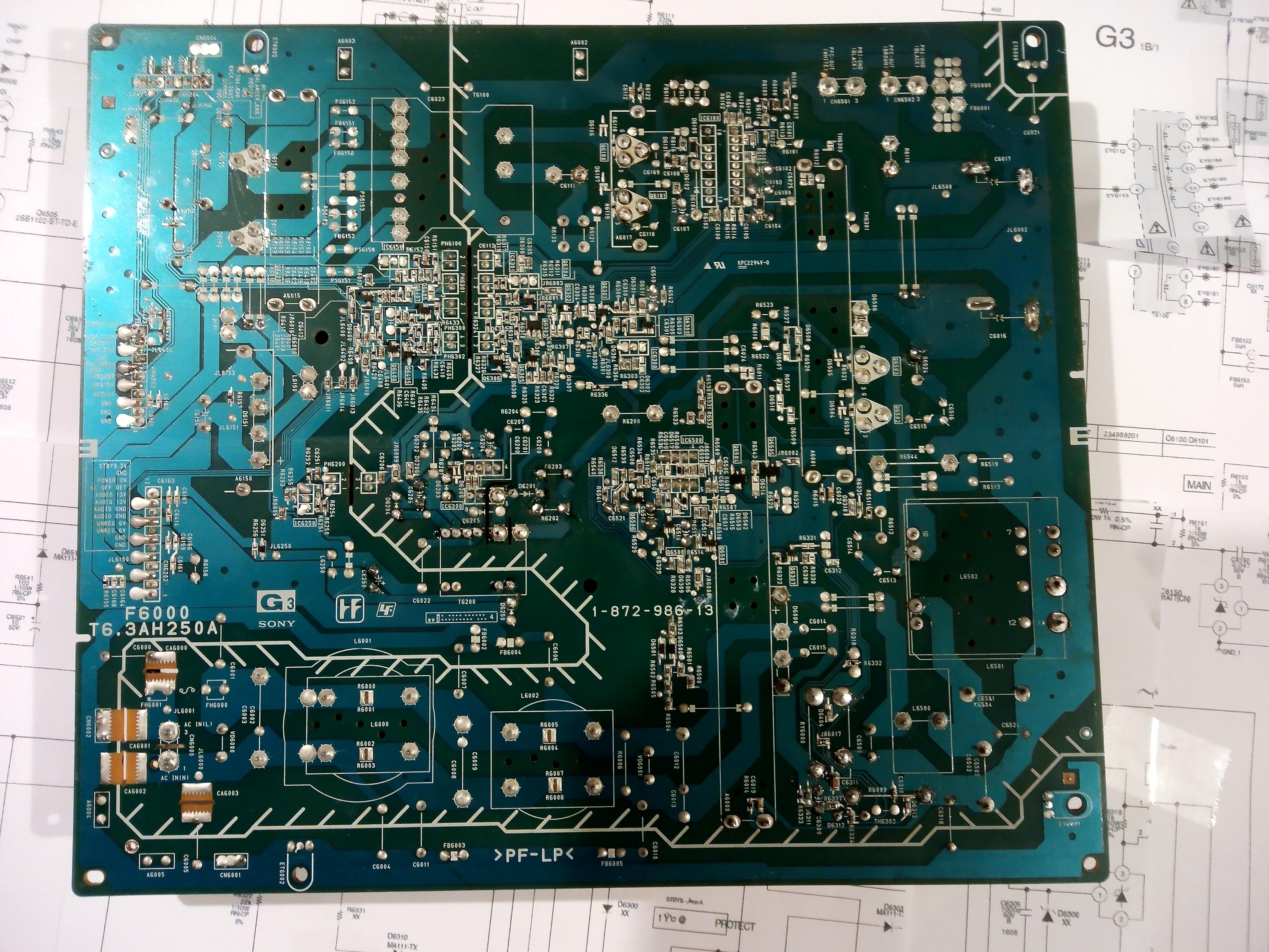

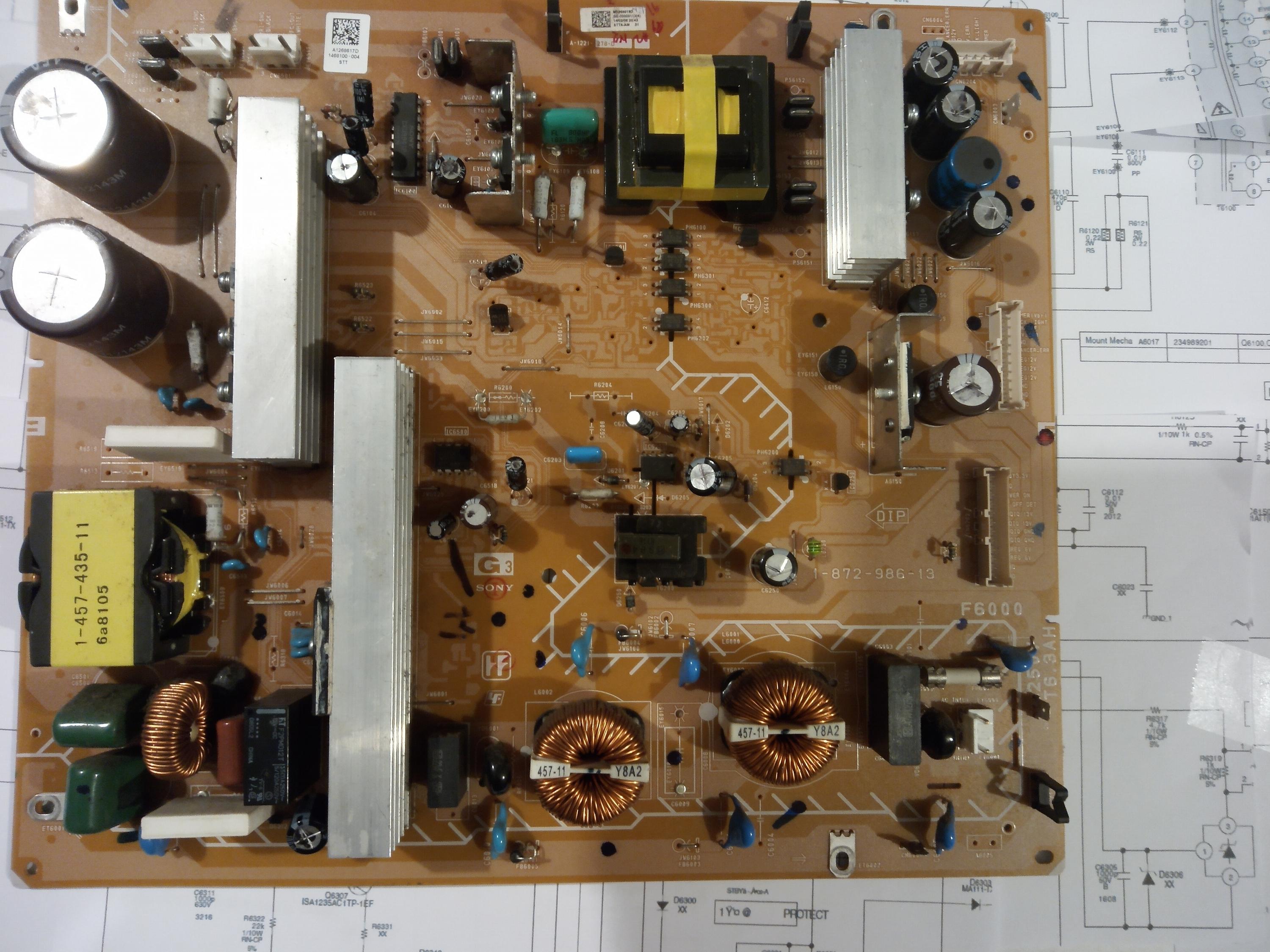

    Hi all and happy new year
    this oldie was given to me to look at ,
    no red led ,no secondary volts from psu,
    no relay click, no blown ceramic resistors,
    theres no 3.3v sby volts .
    first i changed most psu caps ,
    theres no s/c on any secondary supplies the main s blocks are charged to around half of normal around 190v as theres no s/c on the primary of psu i linked the contacts on the relay ,still no o/p,removed link, and checked resistances .
    so i need to know how the primary is switched on,i thaught it may be some protection cct shutting down the psu outputs.
    i sourced a cct but there seems to be more than one version of this psu
    and it seems to be over complicated
    so bottom line is you need 3.3v to start the psu ,without it the psu wont run
    has anybody got any ideas ,as im now scratching my head ?
    i believe its a WAX3F chassis
    i will post pics of both sides of psu

    Re: sony KDL 40D 3500 DEAD PSU
    heres the pics of the psu board
