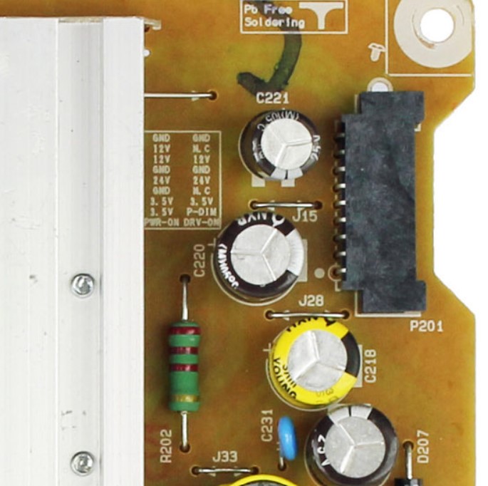

    A friend's parents gave me that 4k TV set after lightning struck our village, saying "if you can fix it...". Their insurance had paid for a new one.
    It just doesn't do anything when plugged, or pushed on the I/O button.
    So I thought I'd buy a new power board, but actually, it didn't change anything.
    Do you guys think the motherboard could be faulty?
    If so, where could i check tensions, please?

        Re: LG 42LB5610 no reaction at all after lightning
        If this is your board then the voltages to check are given
          Oh well, that's absolutely true !
          So I don't seem to get much, except 3.5v approximately where it's supposed to be...
          I'm guessing the 12 and 24 show up when it decides to turn on...?
            You can do the same test as in your JVC thread to test the power supply. For this supply connect Standby to PWR_ON and Standby to DRV_On using 1K resistors
              Cool !
              Do you mean I need two resistors and connect them at the same time?
              And then it should have the other tensions reappear, correct ?
                Yes, the use of two resistors is correct.
                  Different situation here (compared to my other tv)
                  I connected Standby to PWR_ON and Standby to DRV_On, and I did have the backlight on.
                  So the mainboard is faulty, right ?
                    If all the secondary supplies come up as well as the backlights then the power supply is working correctly.
