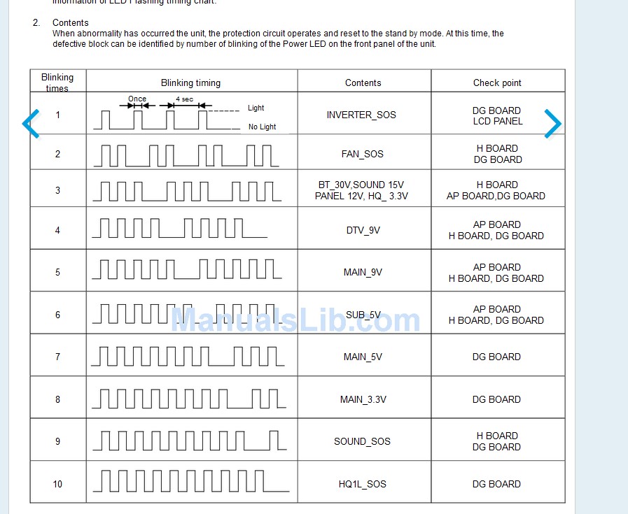

    panasonic tx370d28bs 7times blinking
    Hello, i just received panasonic TX-370D28BS with a 7 times blinking. i need help am not familiar with panasonic tv
  • dick_barton
    • Aug 2015
    • 6643
    • Wales
    Re: panasonic tx370d28bs 7times blinking
    Do you mean 37D28BS. If the blink code is similar to most Panasonic sets then here is a list.
    • hispeck
      • Aug 2015
      • 258
      • nigeria
      yes please very sorry about the mix up
