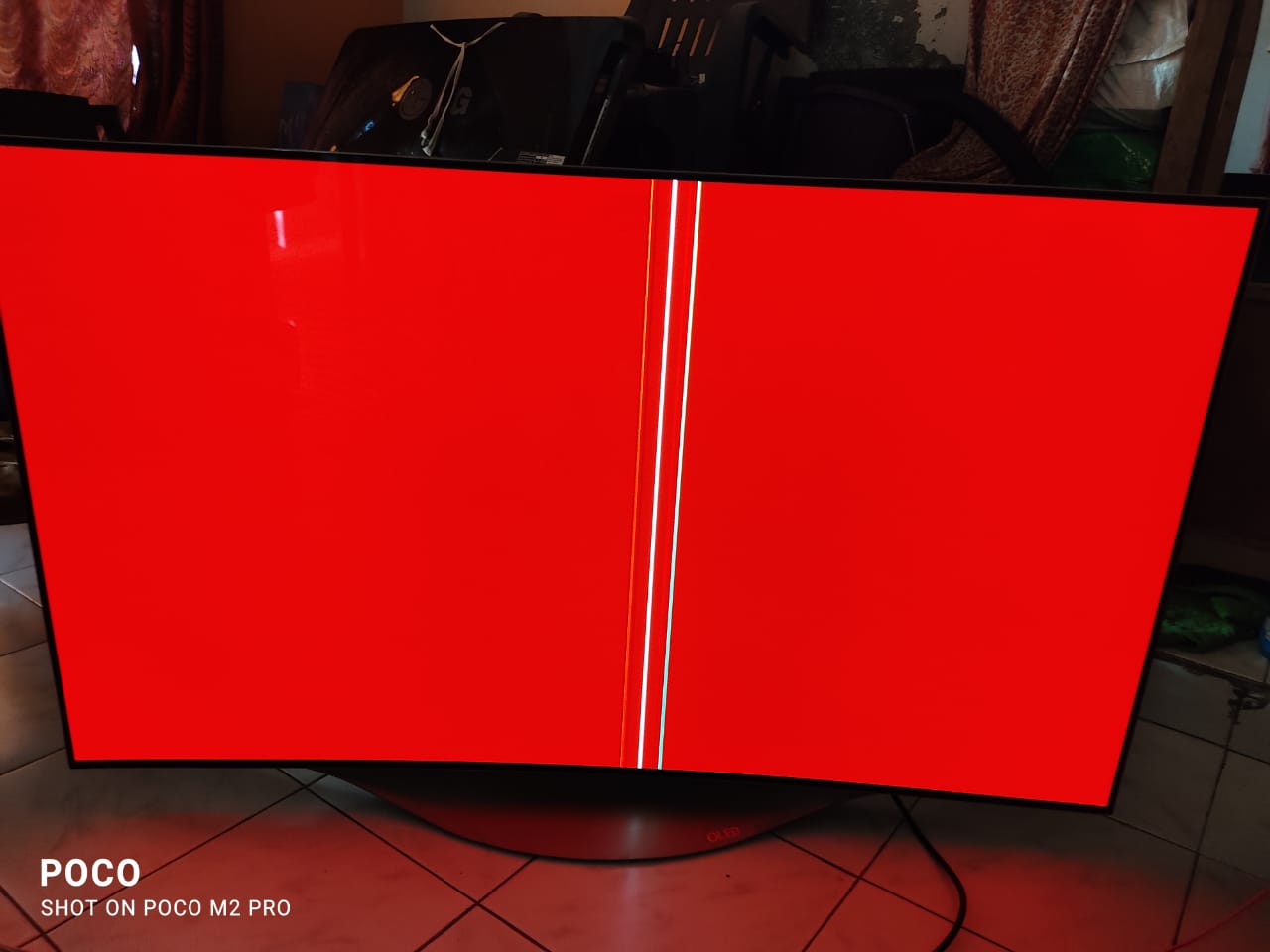

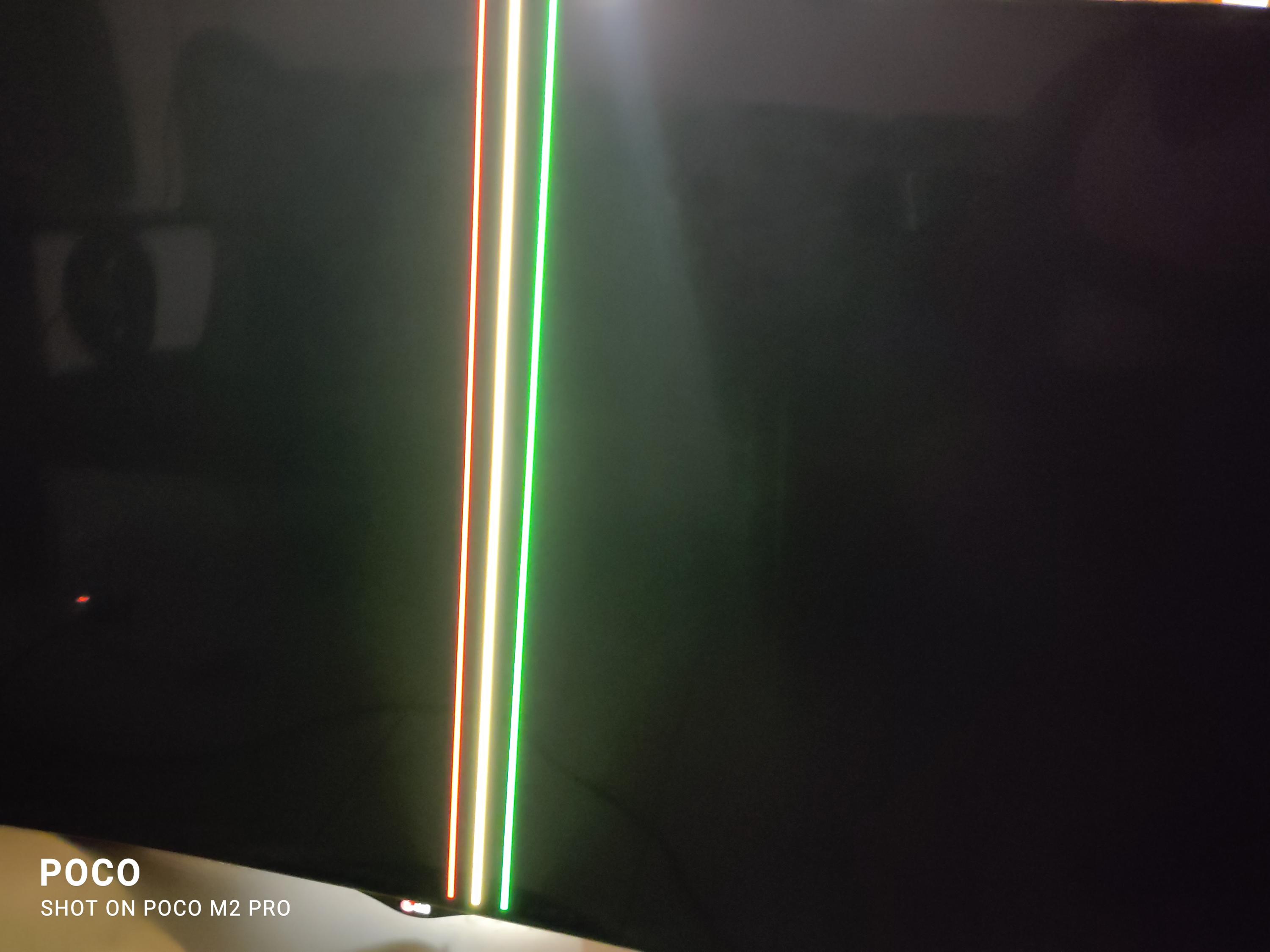

    Lg curved oled 55ec930t not starting, When pressed power button it Powers on for 2-3 seconds. Relay clicks for on and then off click.

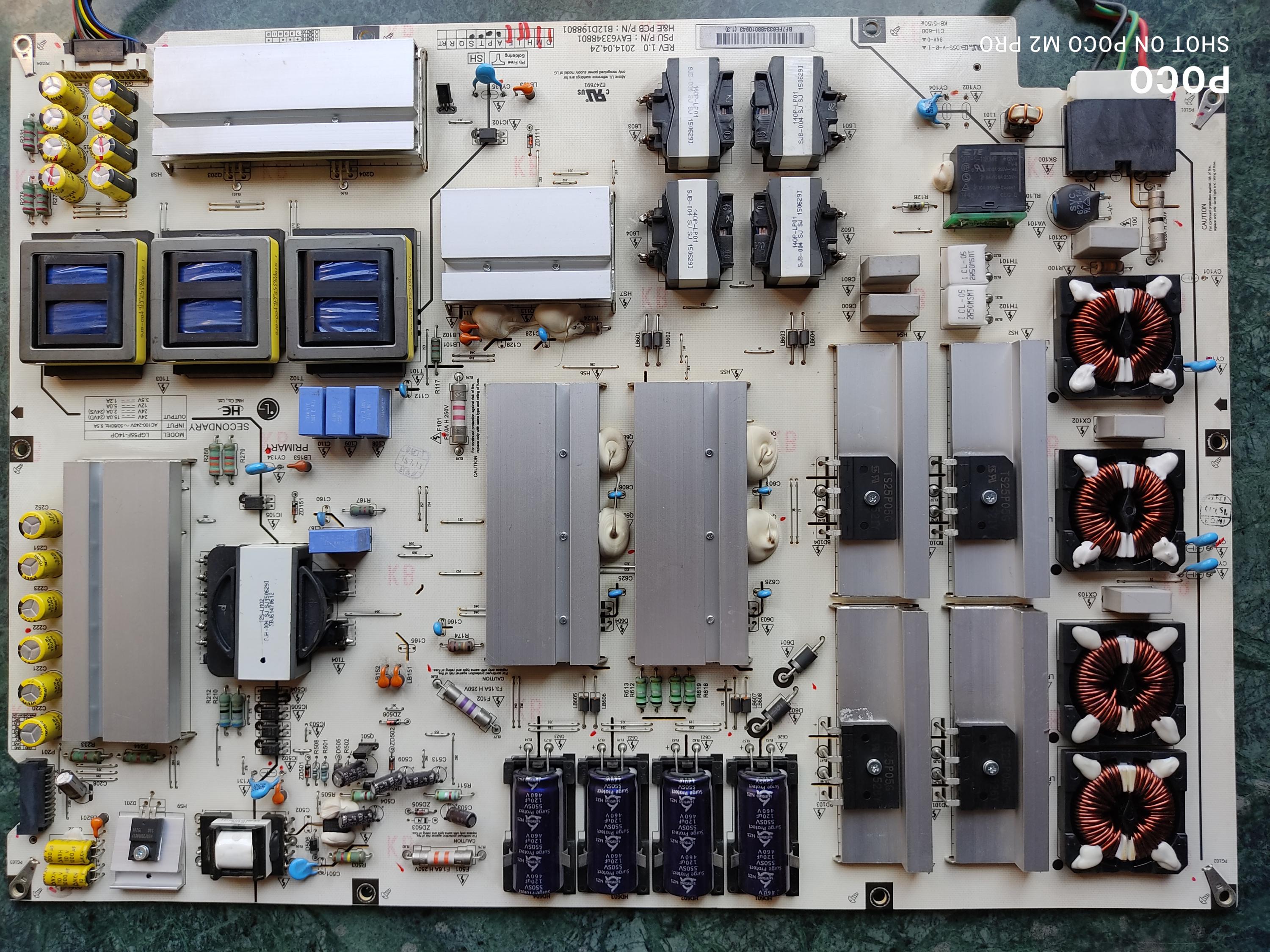

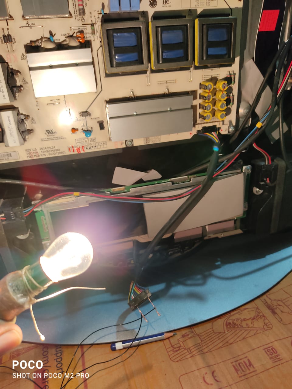

    Checked power supply according to OLED SMPS Testing manual. All voltages fine. Bulb test fine. Red vertical line over the screen.
    Do I have dead panel and TV does not want to start due to it?

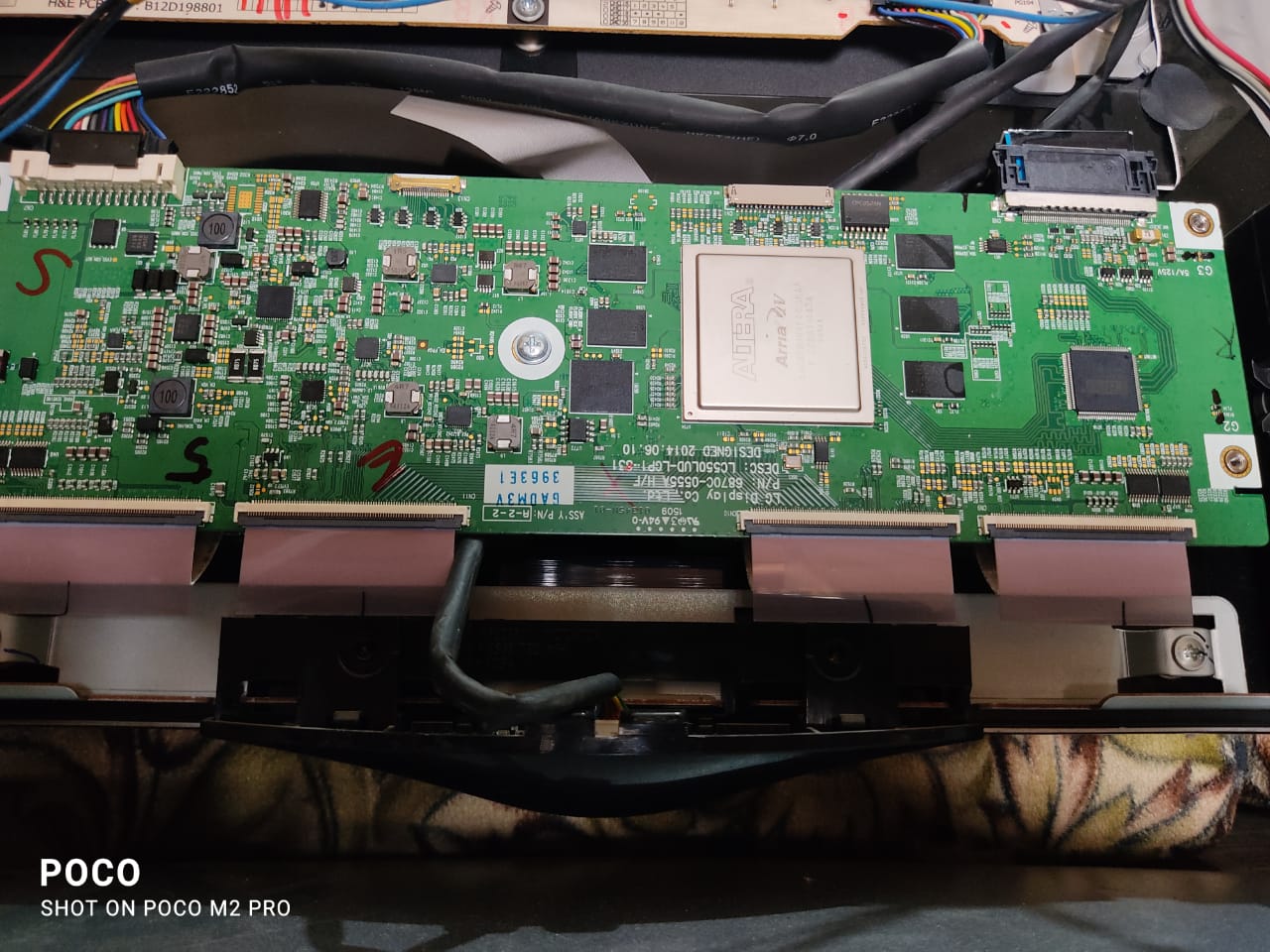

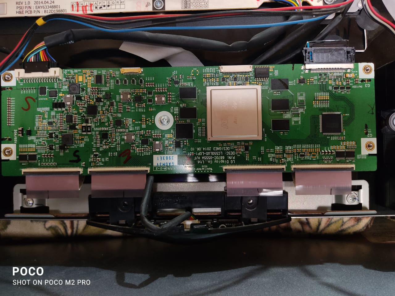

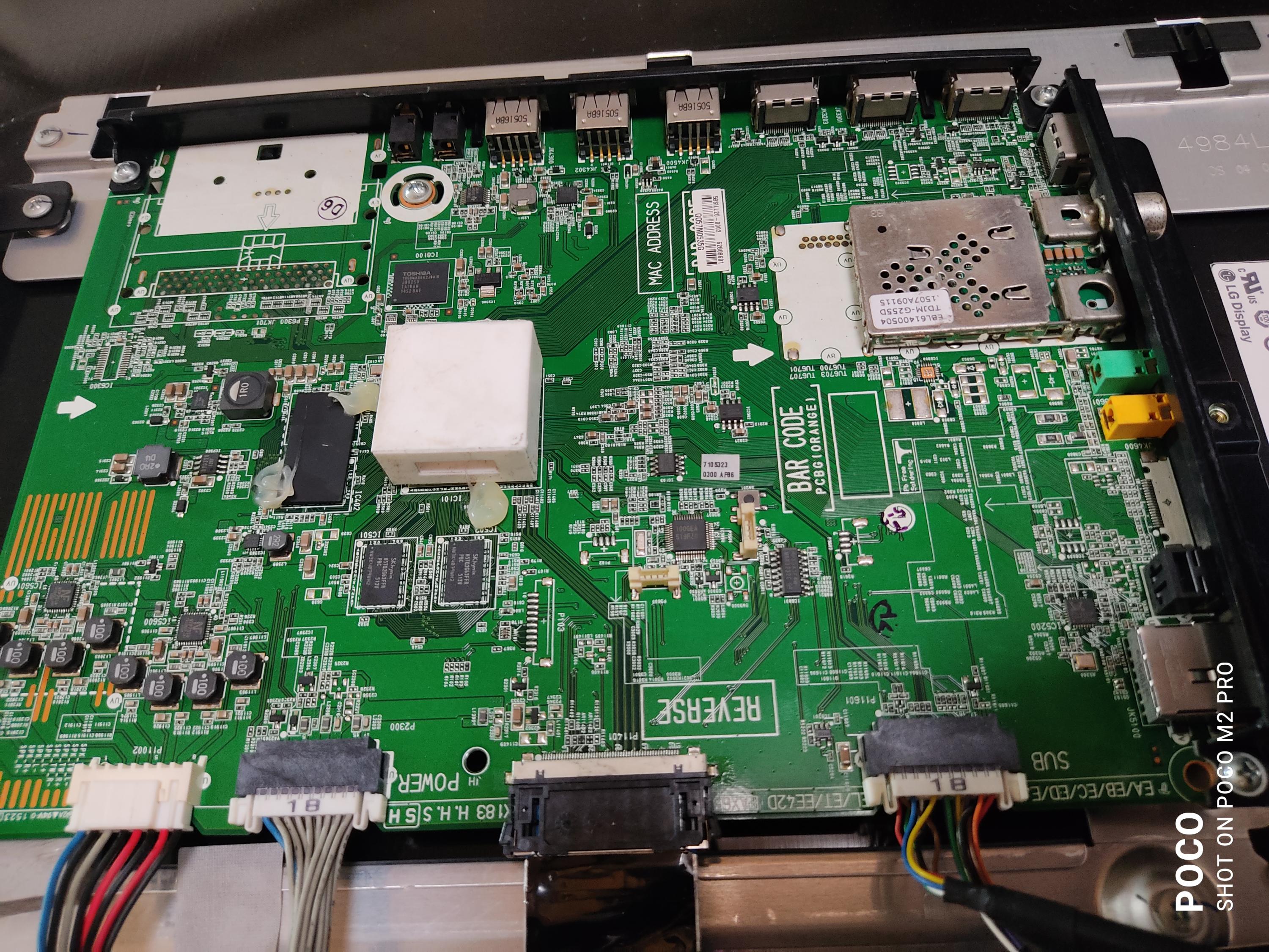

    I have attached part and screen photos just in case you need.

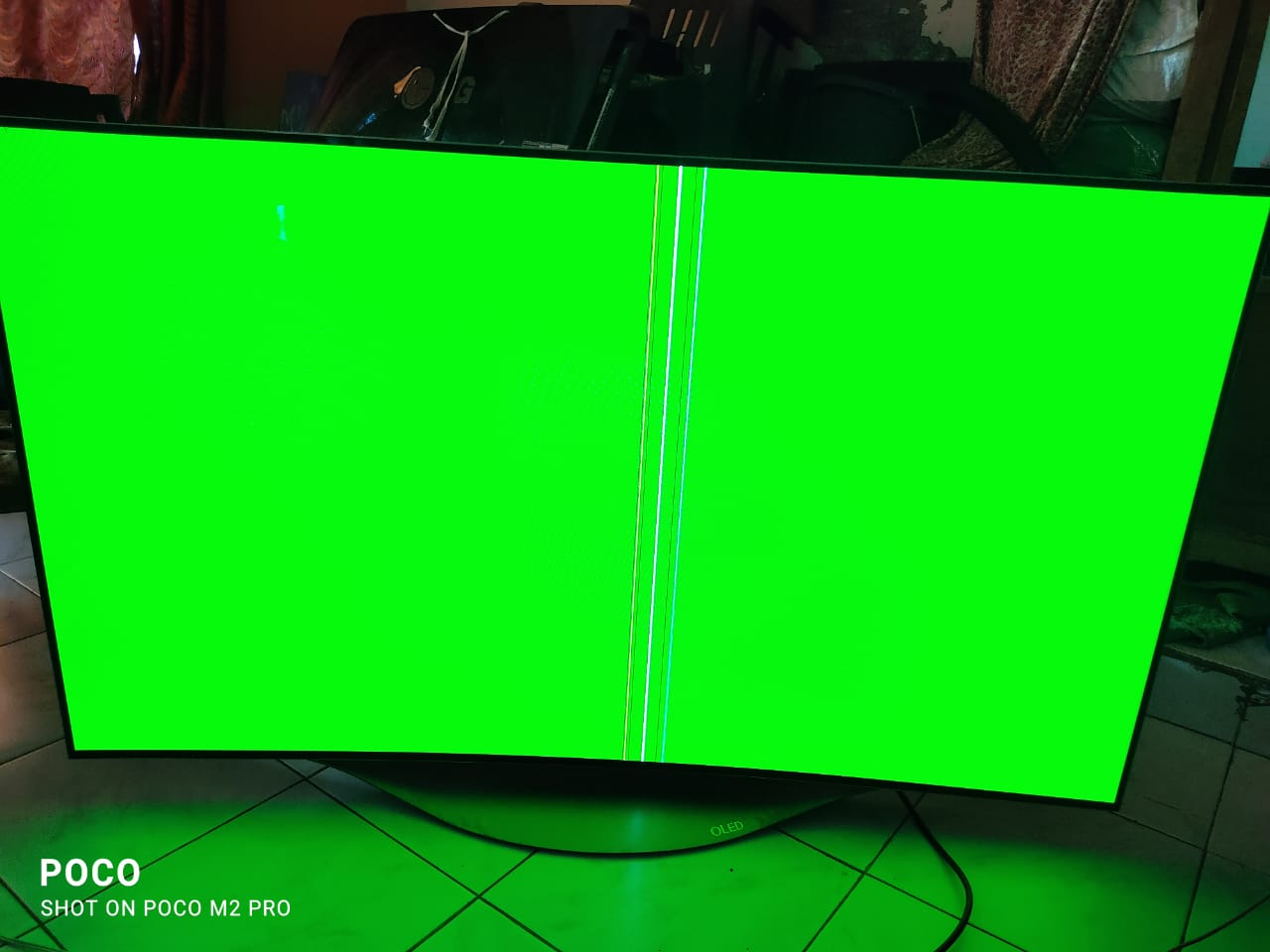

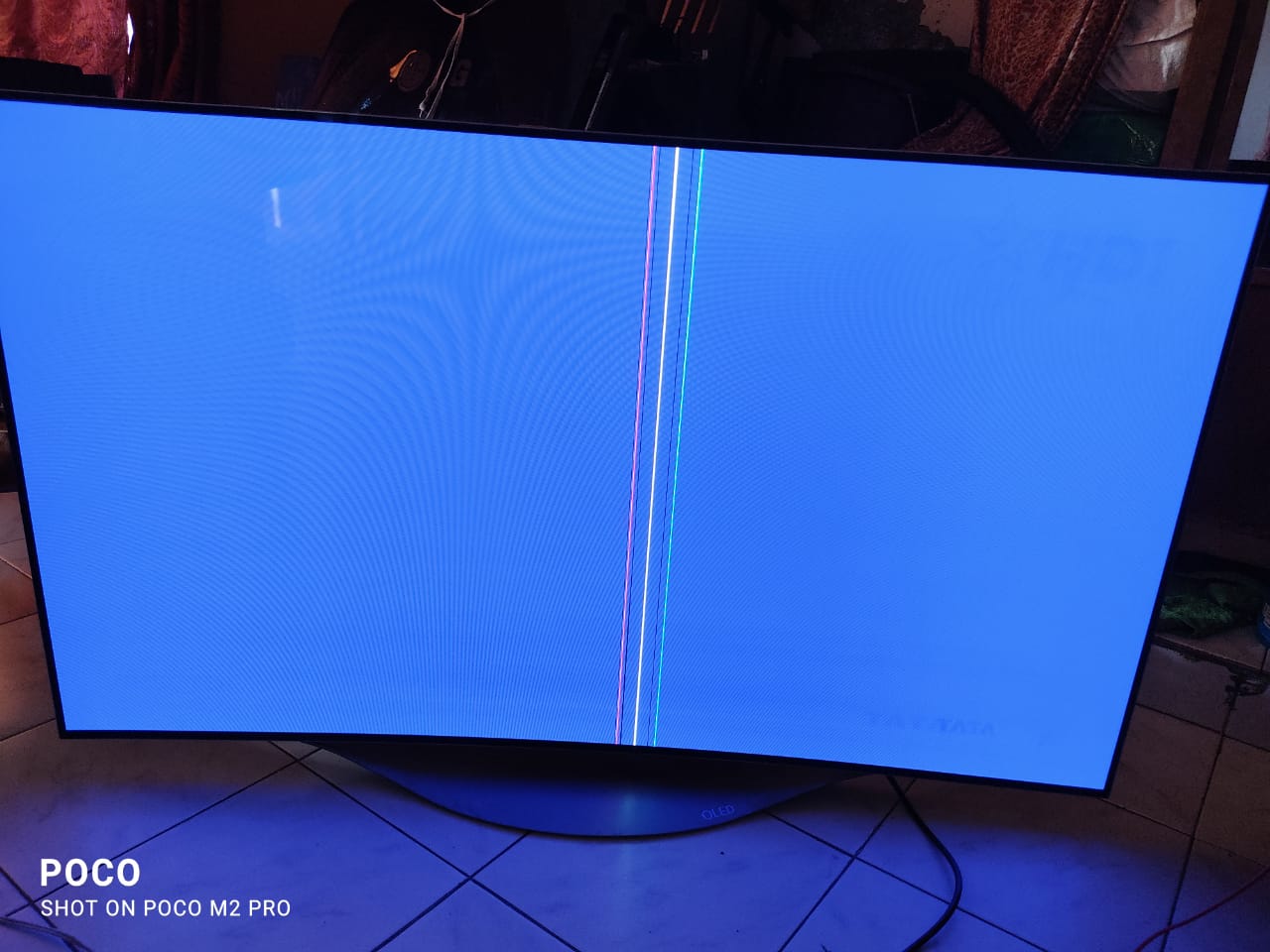

      Tested as per your post 22 and attaching photos of the screen. I get green, red, blue, white, black screen. All colors have NO distortion. Just getting lines in middle of the screen Did not do test points.

        you have Open cells line../ or visual damage at panel rand.
        you cant do any things more. just keep this test running always how long you can.. click softly with finger on the top / down screen area of the middle white line. if you have luck could be get in tact or terminated from the set (sign when other 2 color line changed ).
