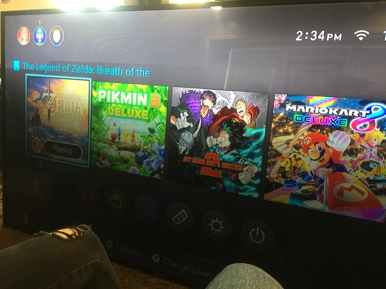

    Latest curb find, Samsung UN75F6300AF, brightest at the top and getting dimmer as you go down. It has a line across the top but it's not straight across. What should be my first check, Led string voltage?

    Yes,
    Test led voltages, but make sure it's like that on every source first. Also check and see if it's like that with the tv menu open. If so then most likely the led's. But until all voltages are checked can't say 100%

              Re: Samsung UN75F6300AF
              the second picture the top 1/4 of the screen is like divided a lighter grey color and on the left side it takes a juke down.
                That just looks like the OSD from whatever you are using to generate the image. Go to settings/support/picture test and run that. See if it shows up that way?
