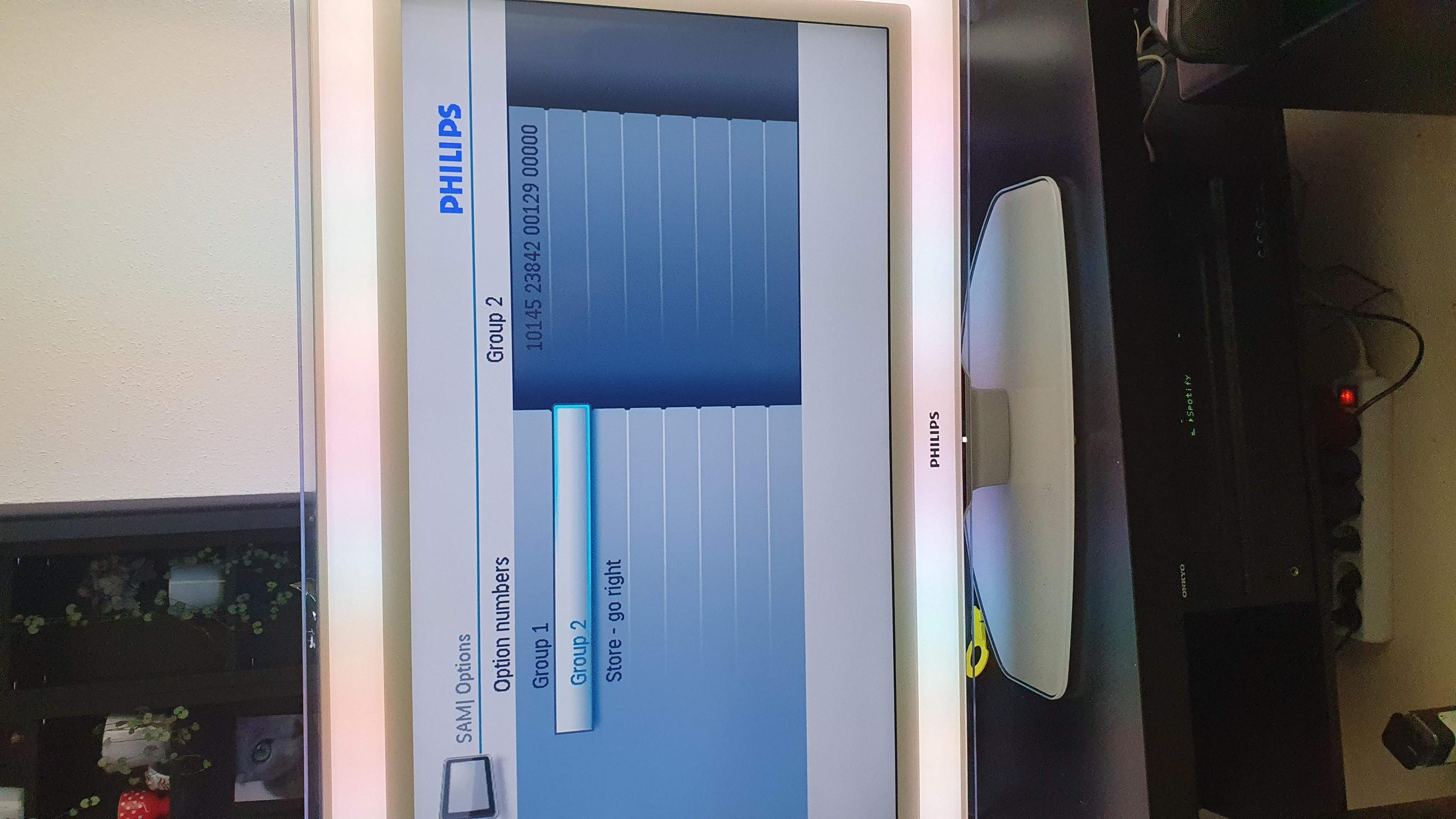

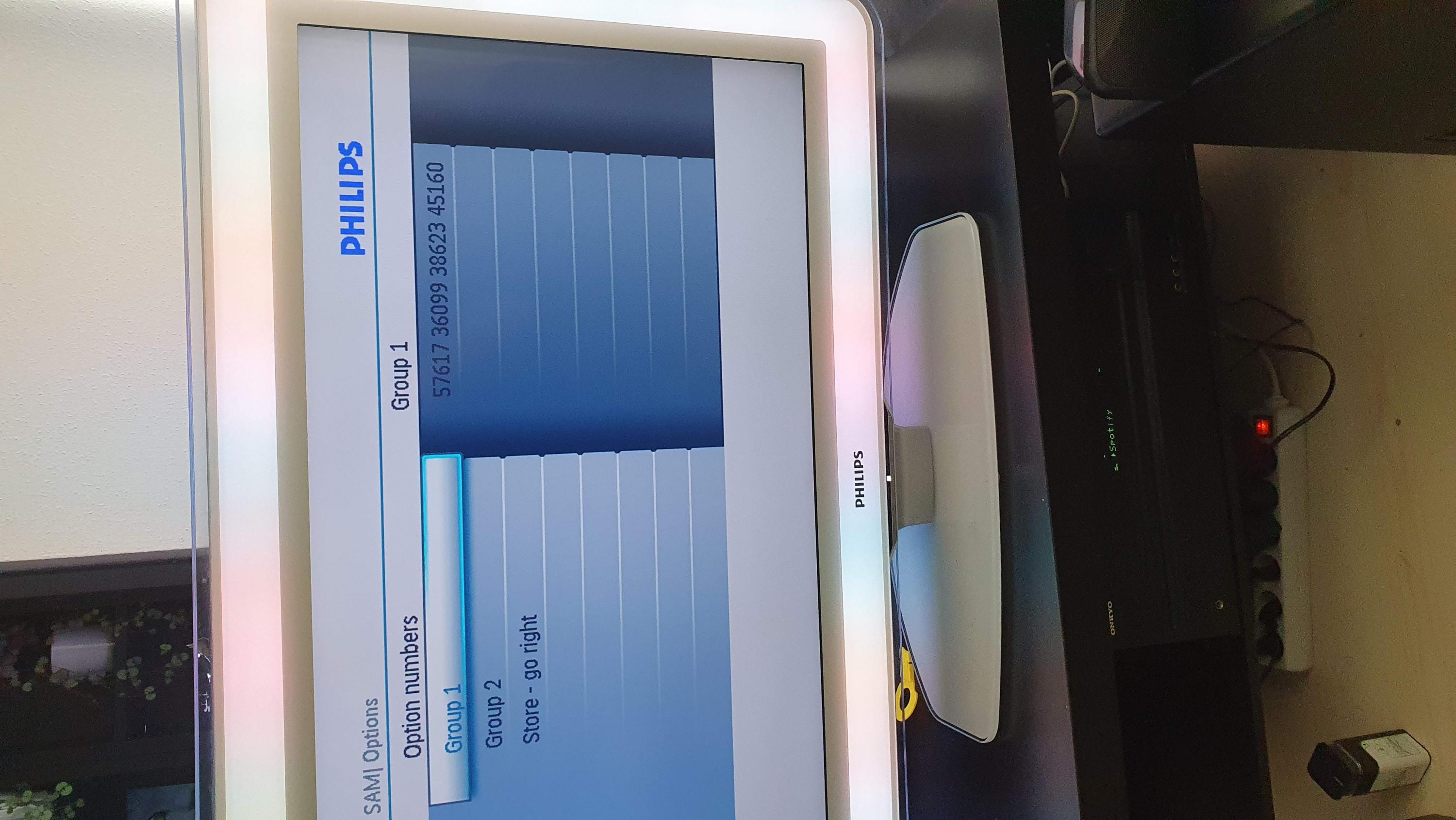

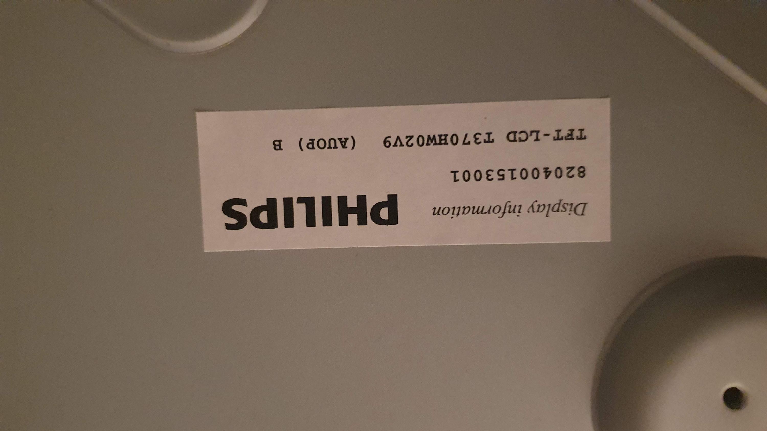

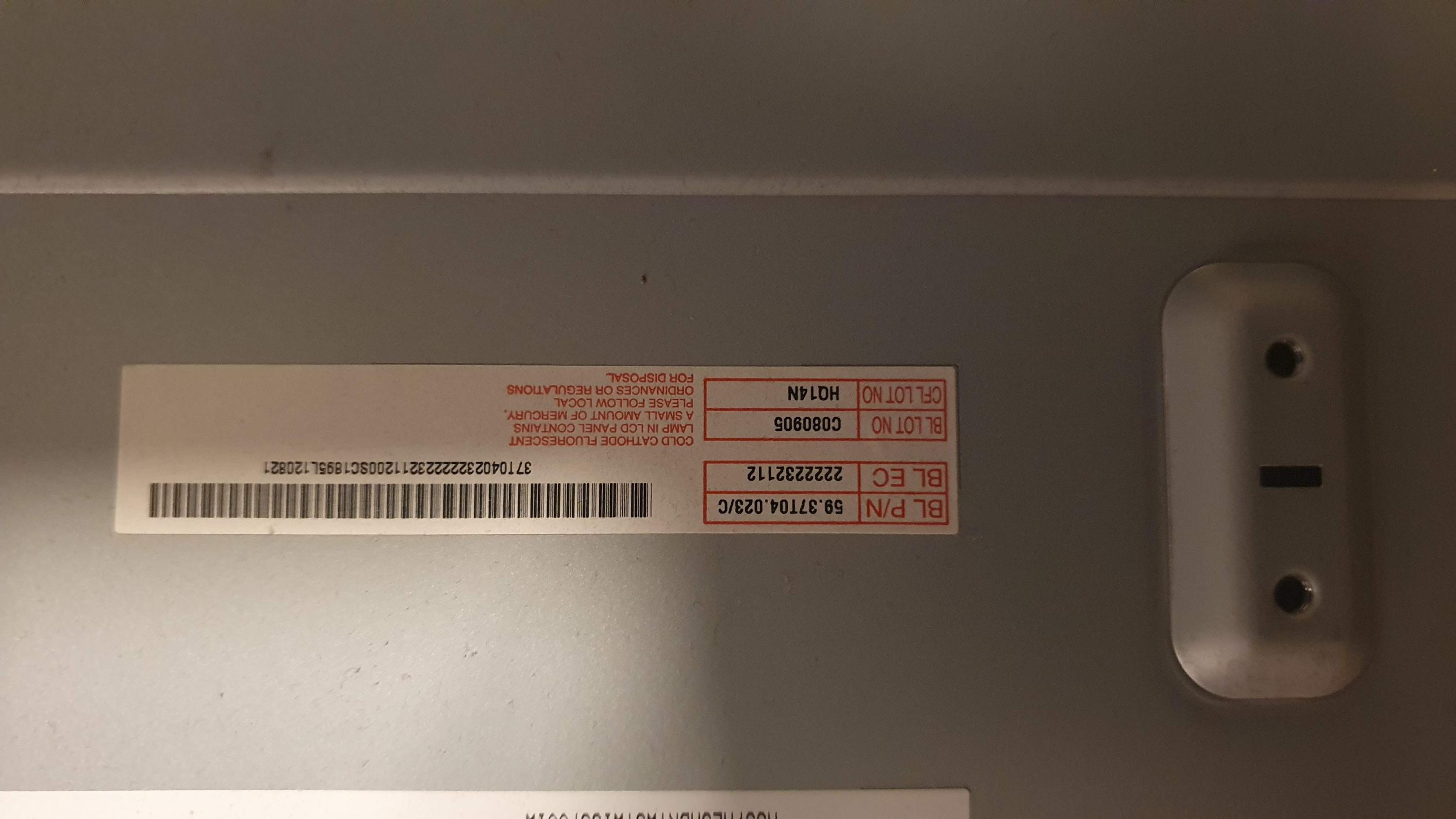

    Hello

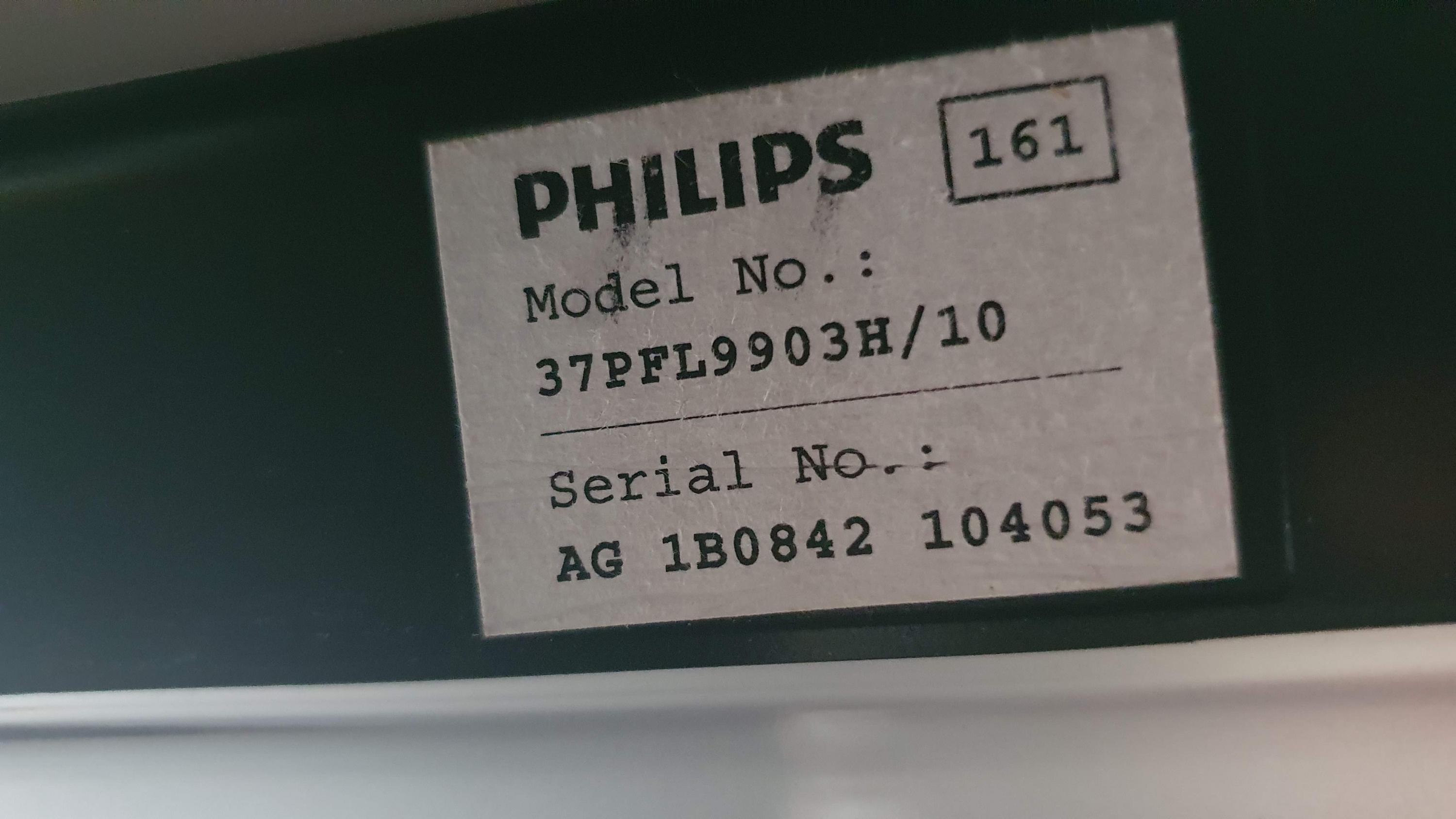

    Iam having an issue and i cant solve it, This tv had an defective mainboard type 310432858531, so i ordered an other mainboard which should work according the seller 310432854945.

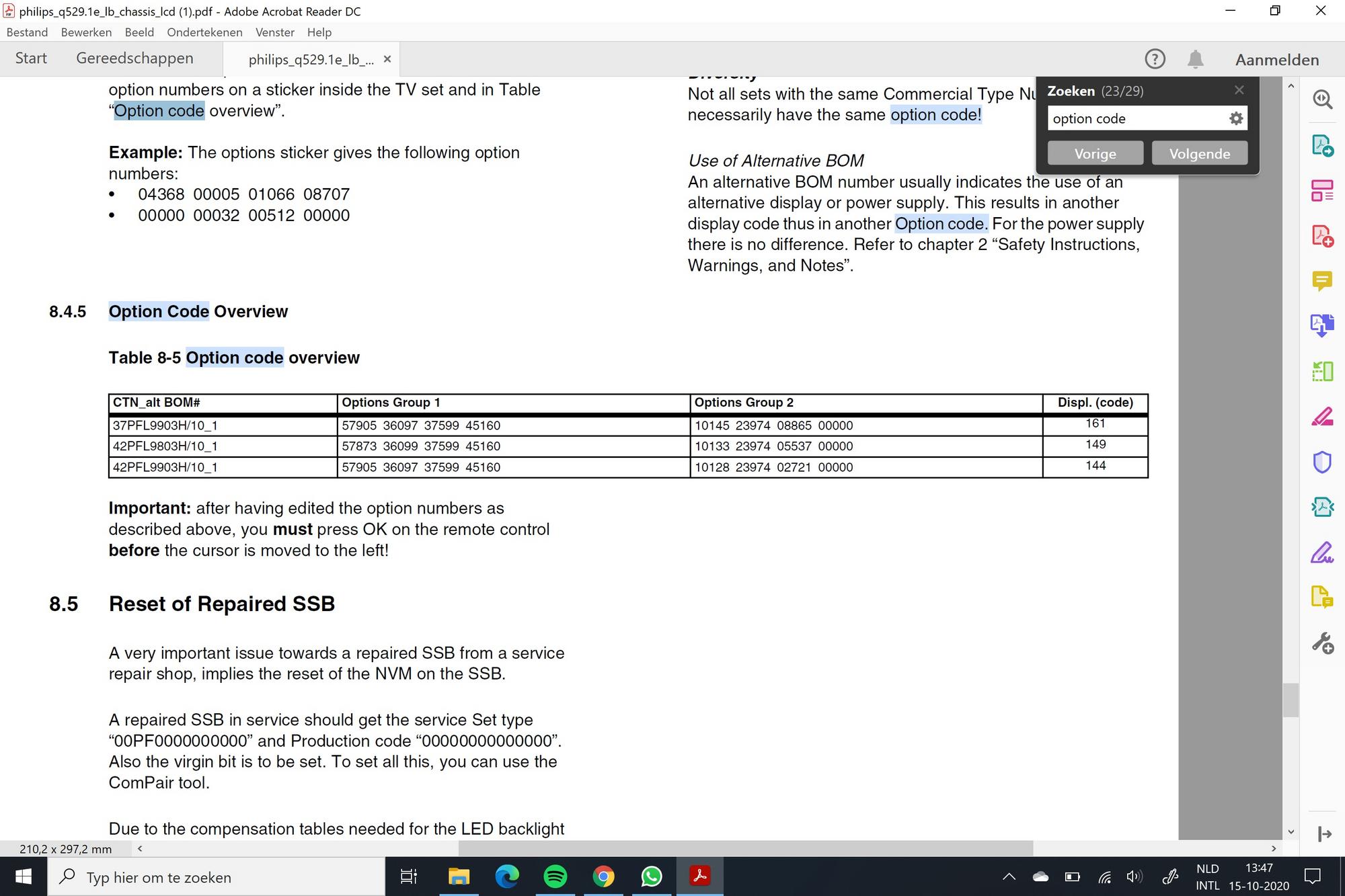

    The Display code in that board is 141 according to the sticker on the back it should be 161, Only problem when i enter that code i dont have an image any more. So i did change the display code back to 141
    So i also changed the option group 1 and group 2 codes arcording the to service manual when doing this the tv goes into reboot mode.
    So i did the manual SDM mode with an jumper wire and changed all codes back, the issue stays that the iamge is flickering.
    Iam out of options who has an idea ?
  • Diah
    • Feb 2013
    • 6593
    Re: Philips 37PFL9903\10 Q529.1E Display Code
    write code 161 again then re flash firmware
    • trunks81
      • May 2020
      • 265
      • Nederland

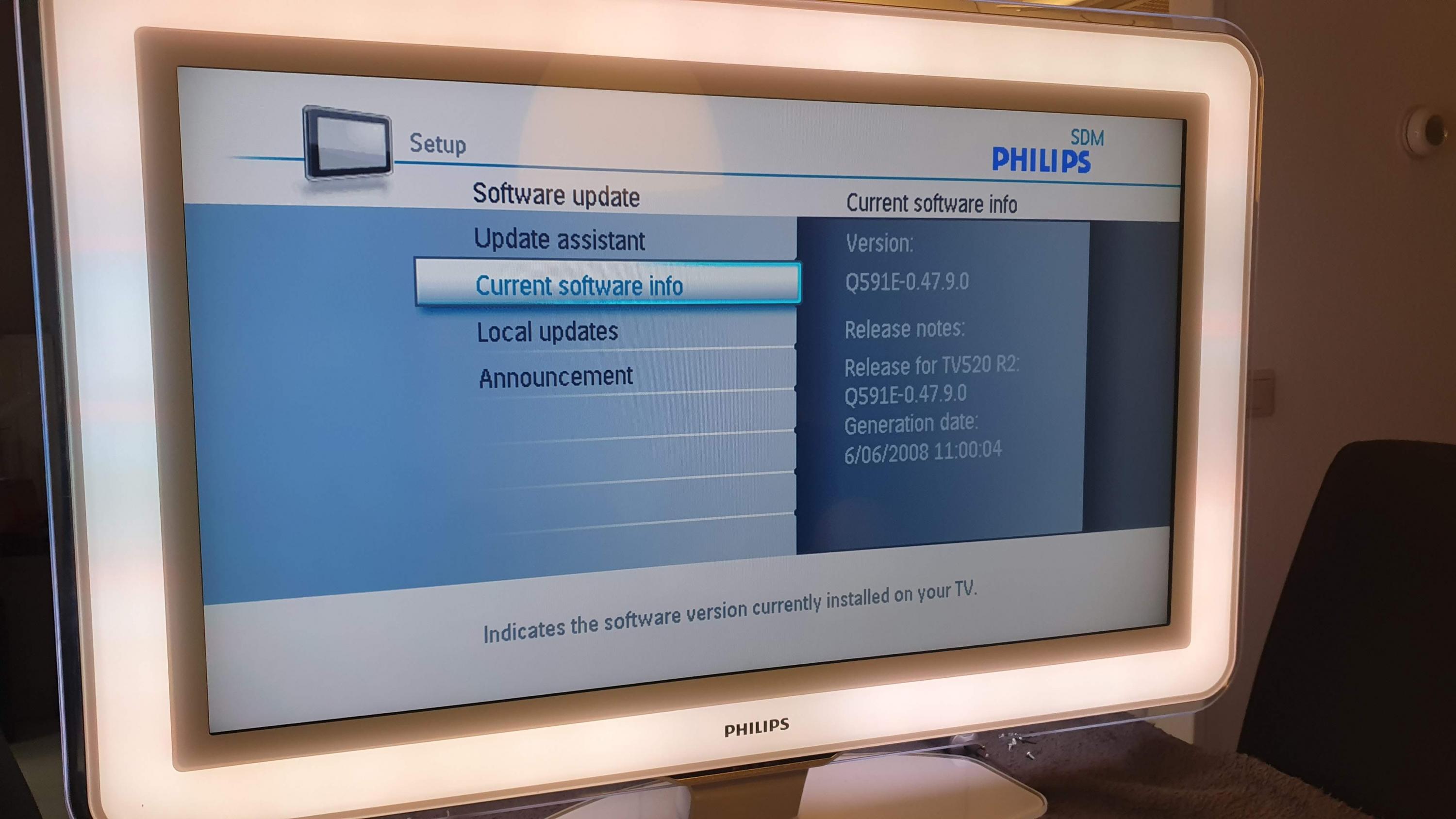

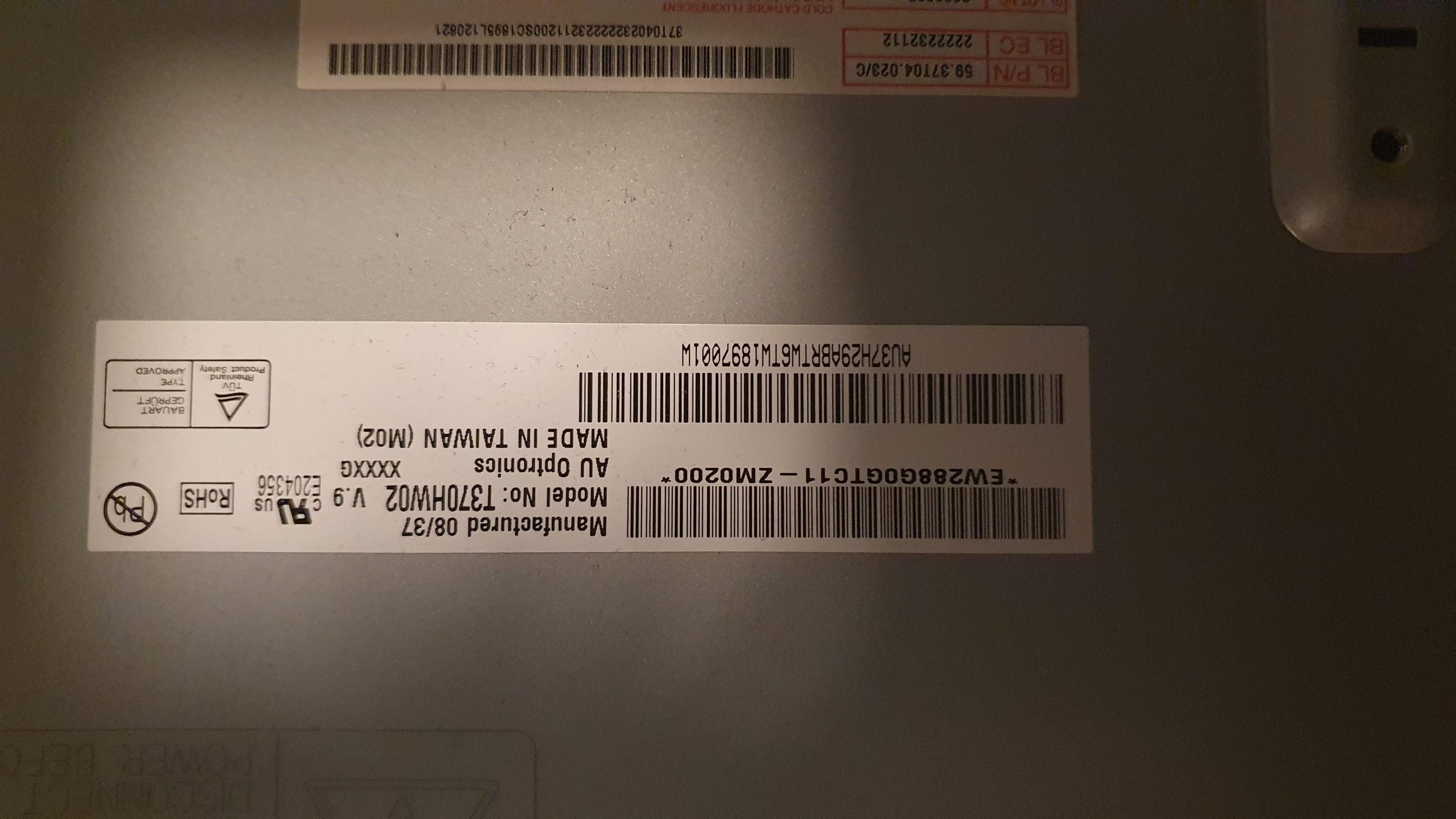

      Hello Diah when i change the code to 161 the tv does an reboot loop, So flashing is not possible i think
      The tv option code are set like on the pictures matching code 141.
      Edit i also uploaded all the stickers in the set or on it
      Edit finally managed to update to the to the lastest version
      But the set keeps flickering ?
      edit found the problem the smps needs to be modified.. now i need to find which parts
