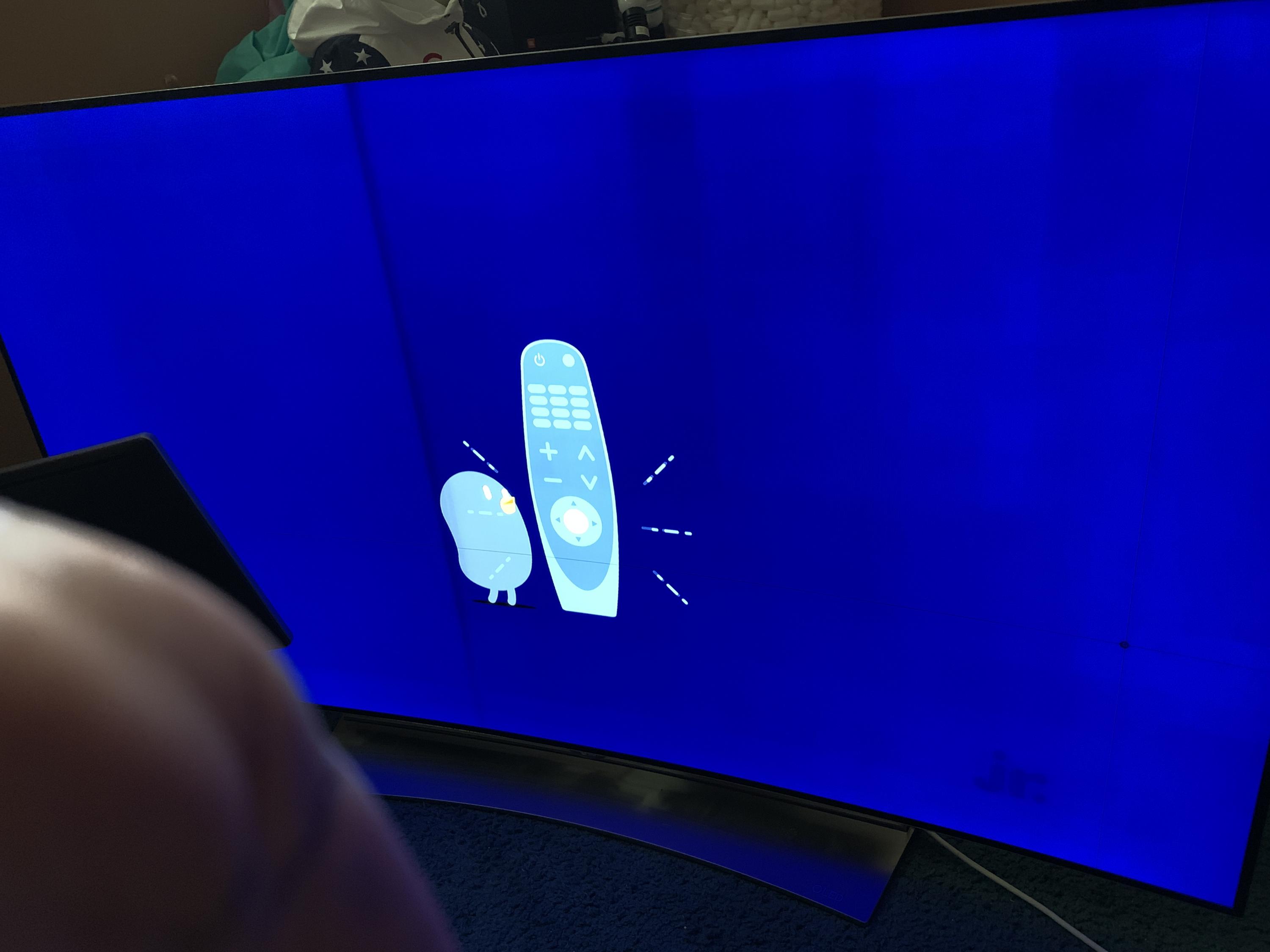

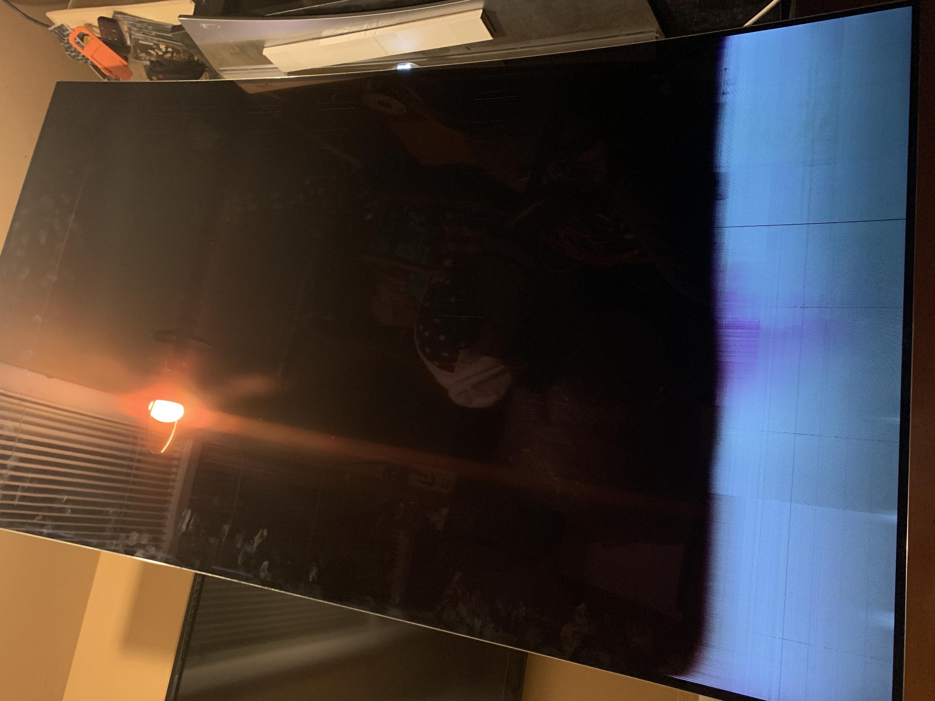

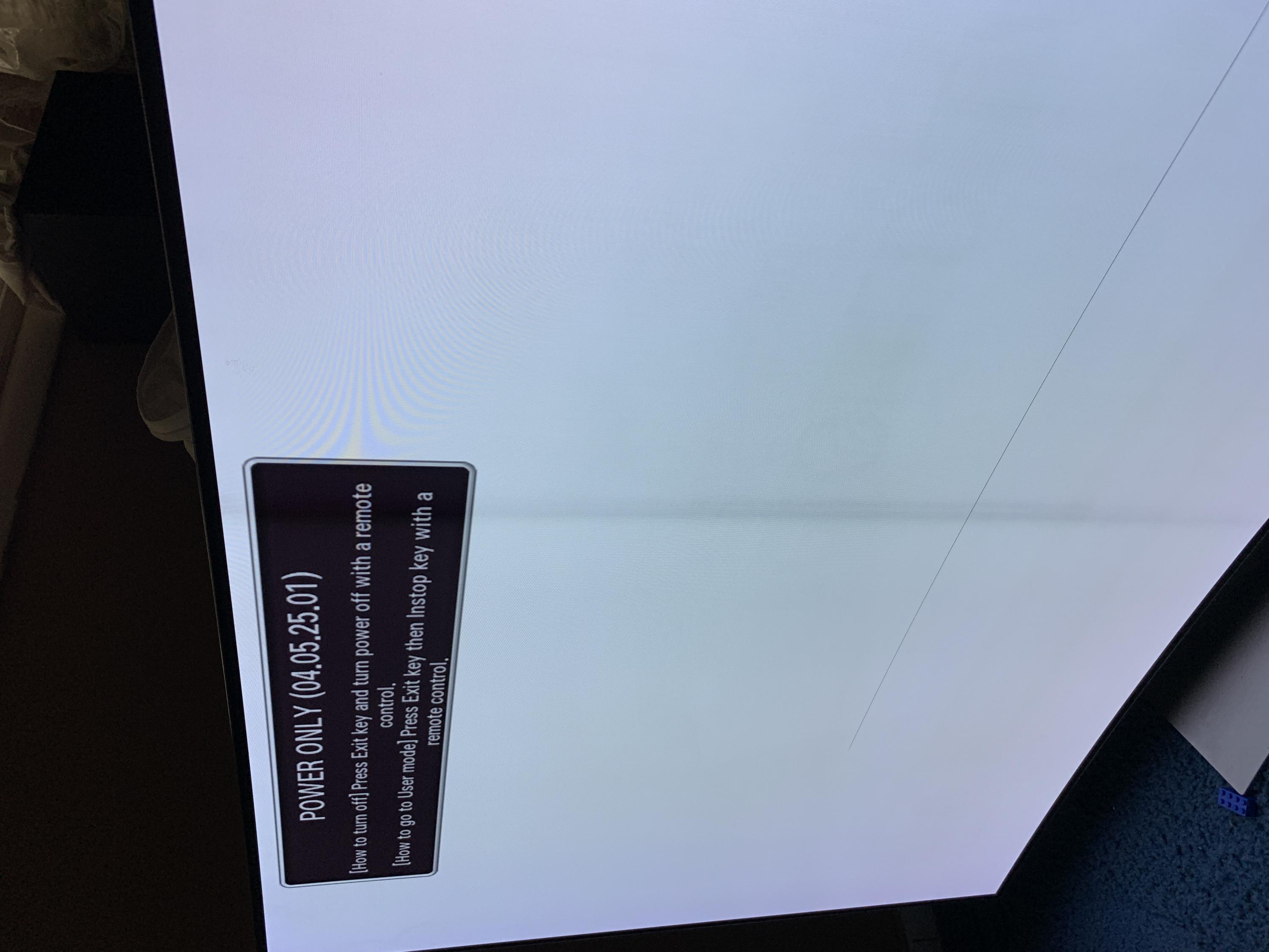

    Hello folks!! I have a LG 65' 4K OLED Tv that a purchased for 50 bucks a few months ago. I have taking the tv apart and have had some better results after purchasing the service remote. When I first picked it up I only got a blinking LG light at the bottom. I have been able to get the tv to come on full a few times. As of now the screen will come on with a red line going down the side. after it goes from the top to the bottom of the screen. It will actually come on and then shut down after a few seconds. The last 2 pictures are normally what I get. The others show up every blue moon. Im not sure where to start but any help would be great. Thanks!

    Re: 65 inch EG9600 LG 4k OLED for $50
    short at cells, when you first time worked on it.. the cells by moving the set round or on table the cells short went out so the set turn on... now the short of cells are intact so after it make the refresh cells and the line spears from top to the bottom the screen went out after SOS signal generated and the set goes to standby or protection mode.
    to approve this ( click with yours finger gently on the line area while the set in standby or off of wall socket then turn on... try many time don't give up..LOL) this could be temporary or fix for long period of time if the set didn't face any move or shocking at panel. BUT the LINE will remain on screen

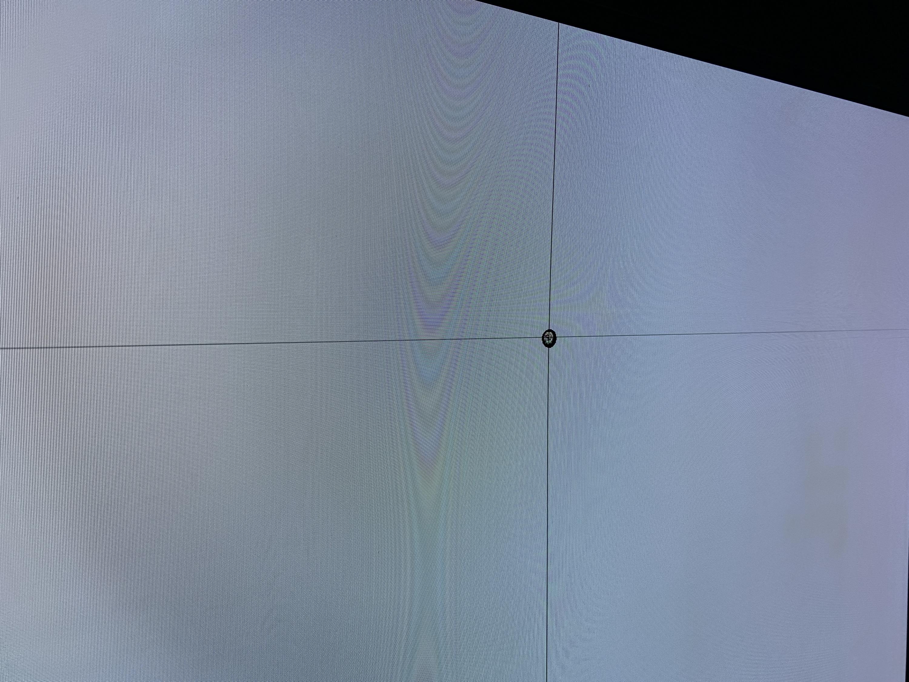

      I tried that and im getting nothing. Even when it does come on the tv will never stay on for a long time. When it first comes on the redline is the same line that shows up in the next to last people.
        try more at different corner or places, or try to find the T-CON schematic to terminate micon SOS signal, still the first option more successful as i faced it many time with OLED

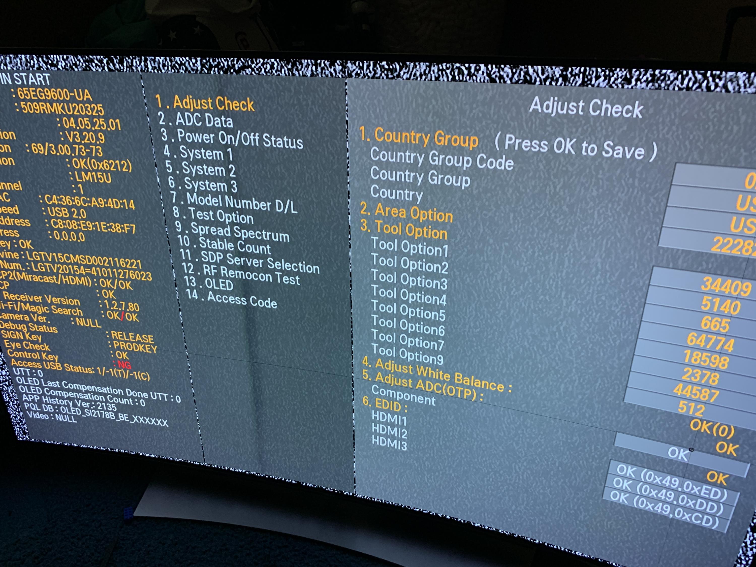

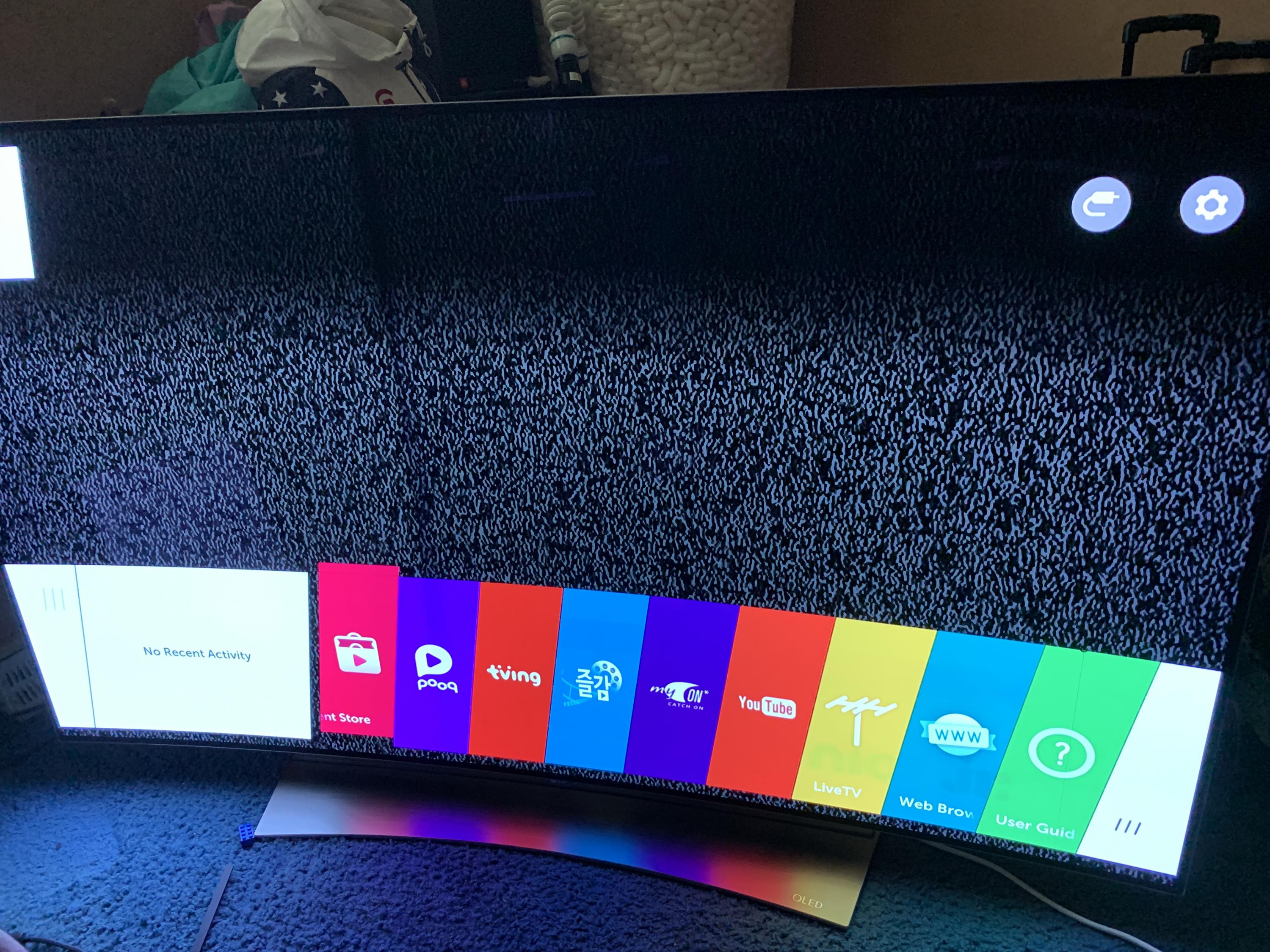

          I have still have the same issue. Every blue moon the tv will come on and stay on for maybe 2-3 mins and shut down. Thats as far as I can get. I have tried pushing all the corners and really all over the tv but no jackpots. Is it possible I need to change out the t-conn board?

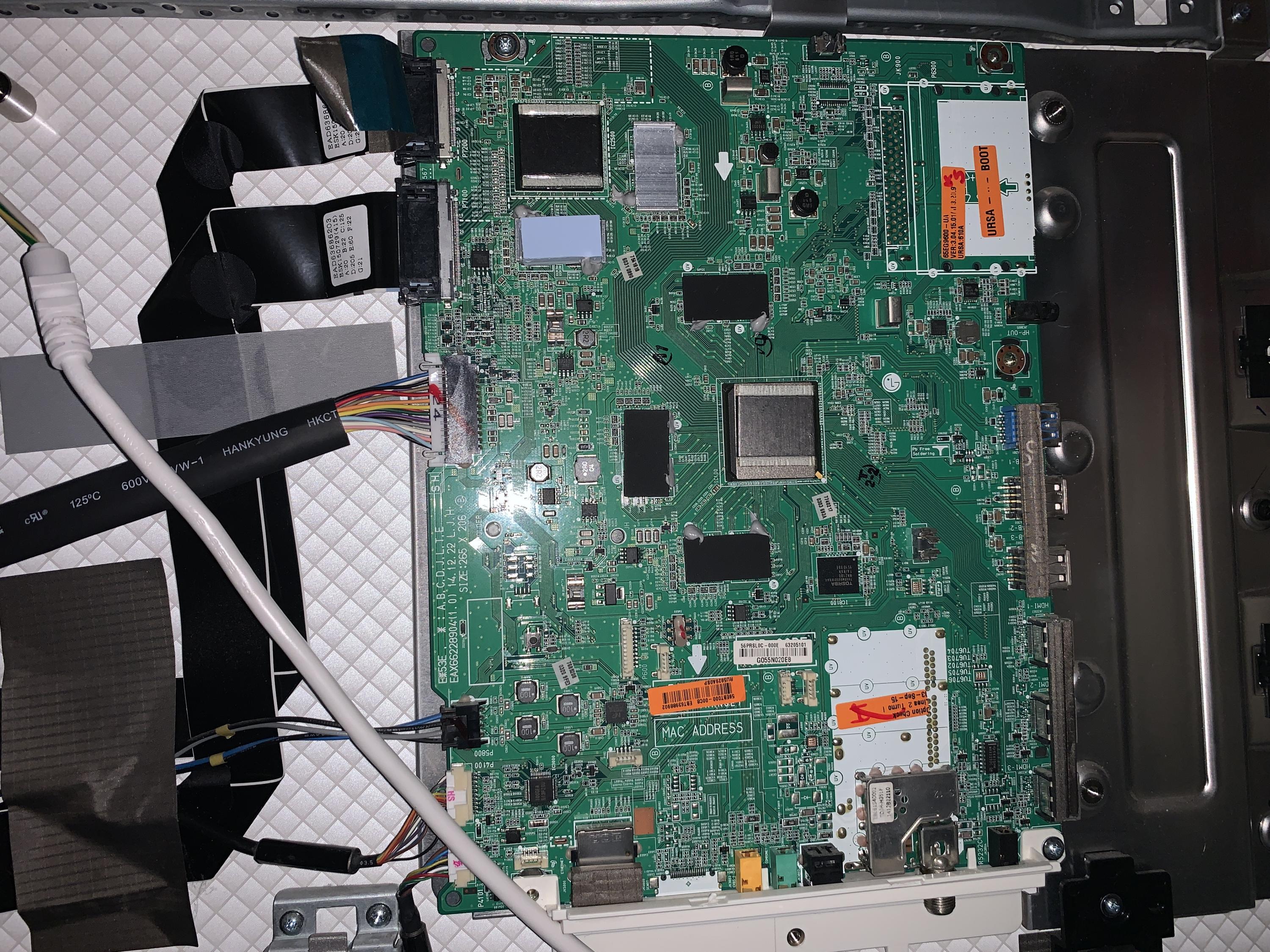

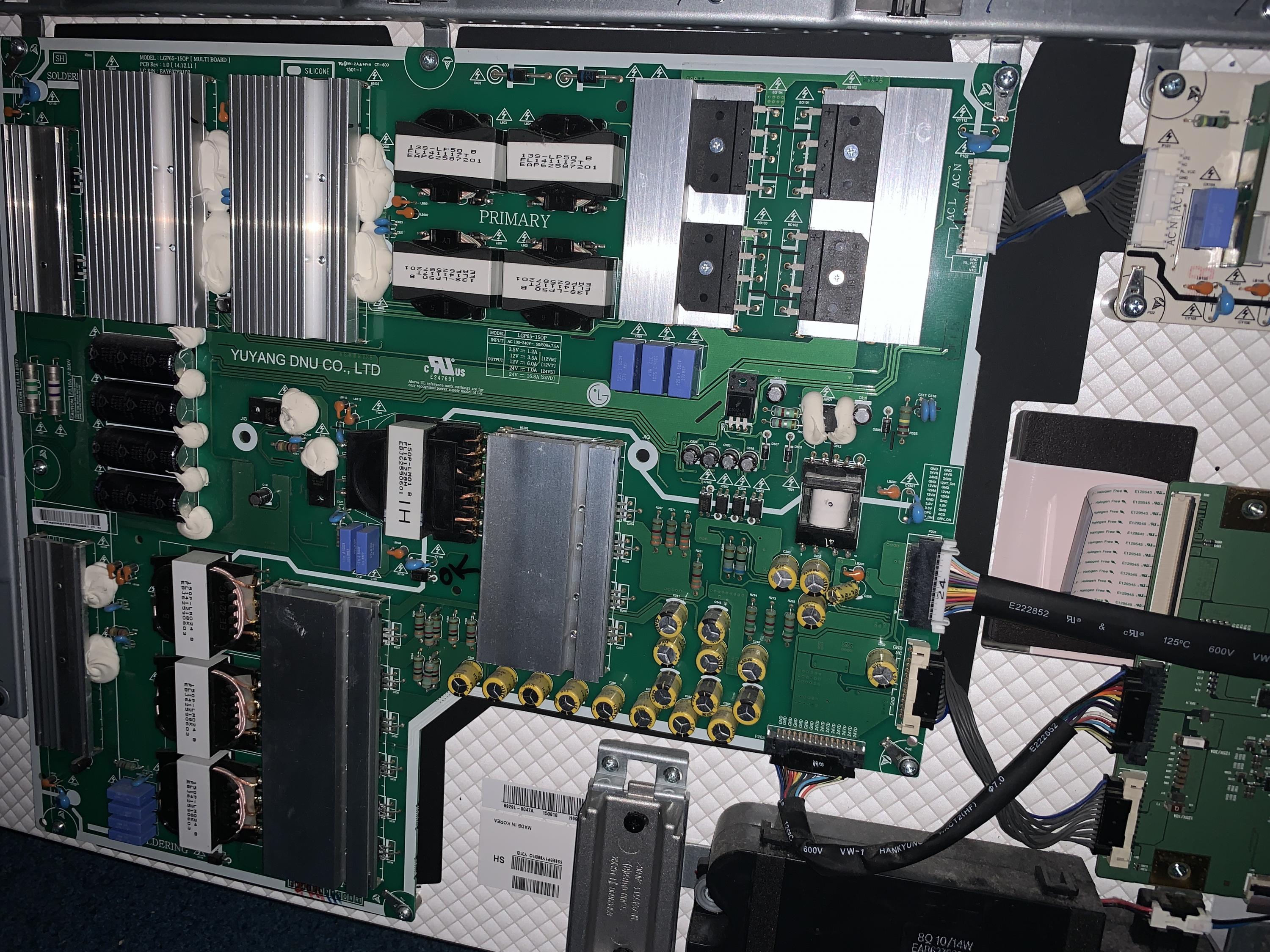

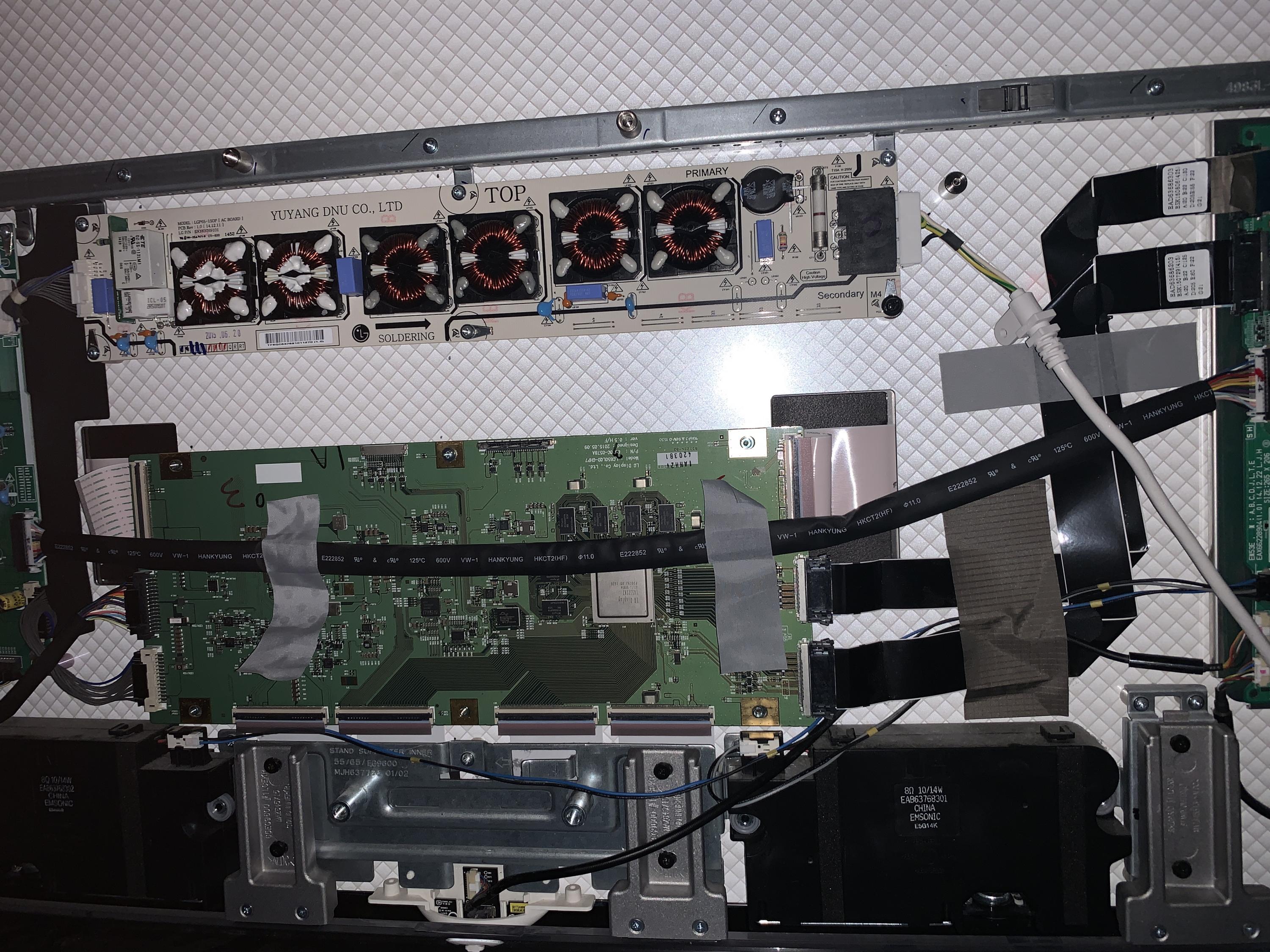

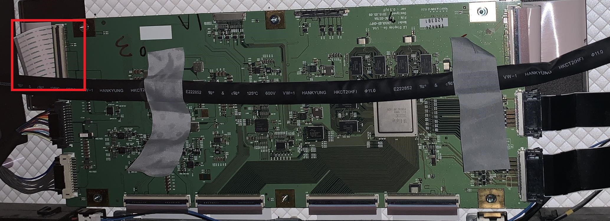

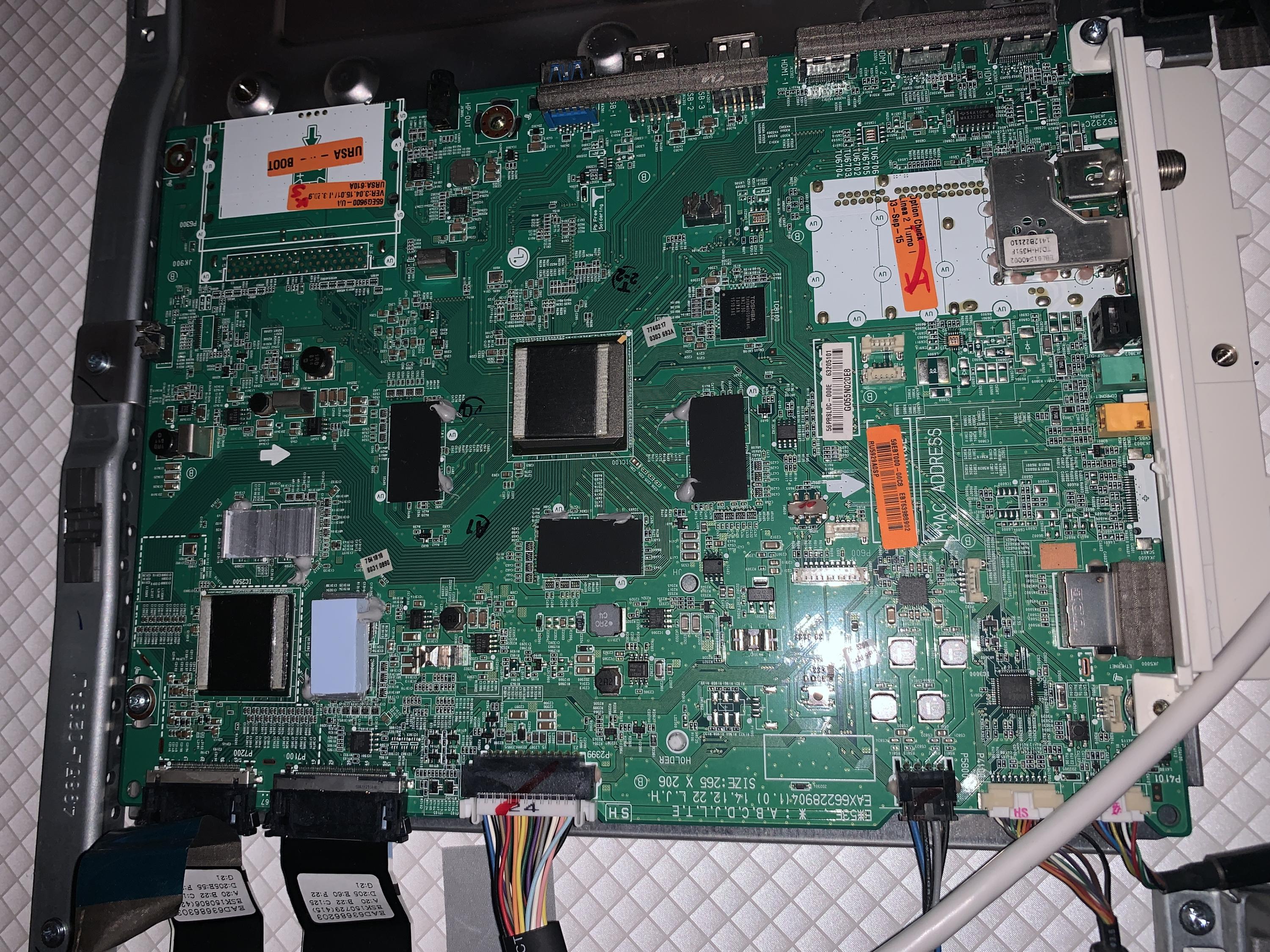

              Ok here are some pics of the inside of the machine. Sorry for the delay it's been super hectic around here.
              • Diah
                • Feb 2013
                • 6425
                1- why the ribbon Jumper of the T-CON disconnected ??? look at marked photo.. you need to put it back. ( who Knows it could be this is the fault LOL)
                2- yours T-CON driver boards + the panel can run as stand alone. the power boards feed them direct with 12 & 24V. so only you need to disconnect socket P201 which it goes to main boards and disconnect the 2 LVDS ( Black sockets) between main boards and T-CON driver boards ..
                then make 2 jumper on the socket p201 (( be sure 100% of the pins when you make.. its not difficult as 3.5V you have 3 pins and the others we need are one over the other ))... so do as following
                A- 3,5V and Power_ON
                B- 3.5V and DRV_ON
                turn on the LG and leave it as long you can and remark your screen how its look better shoot photos and upload over here.

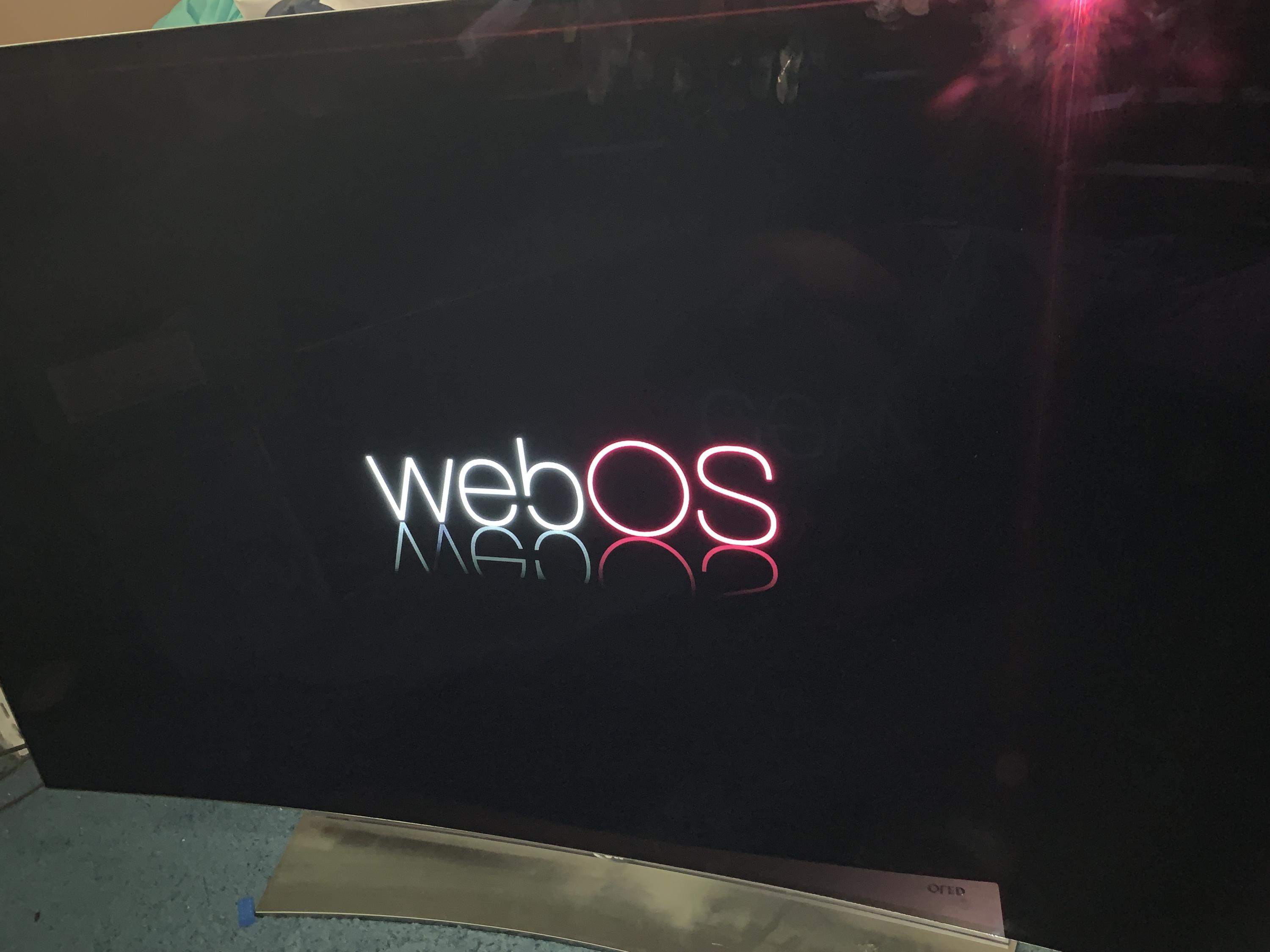

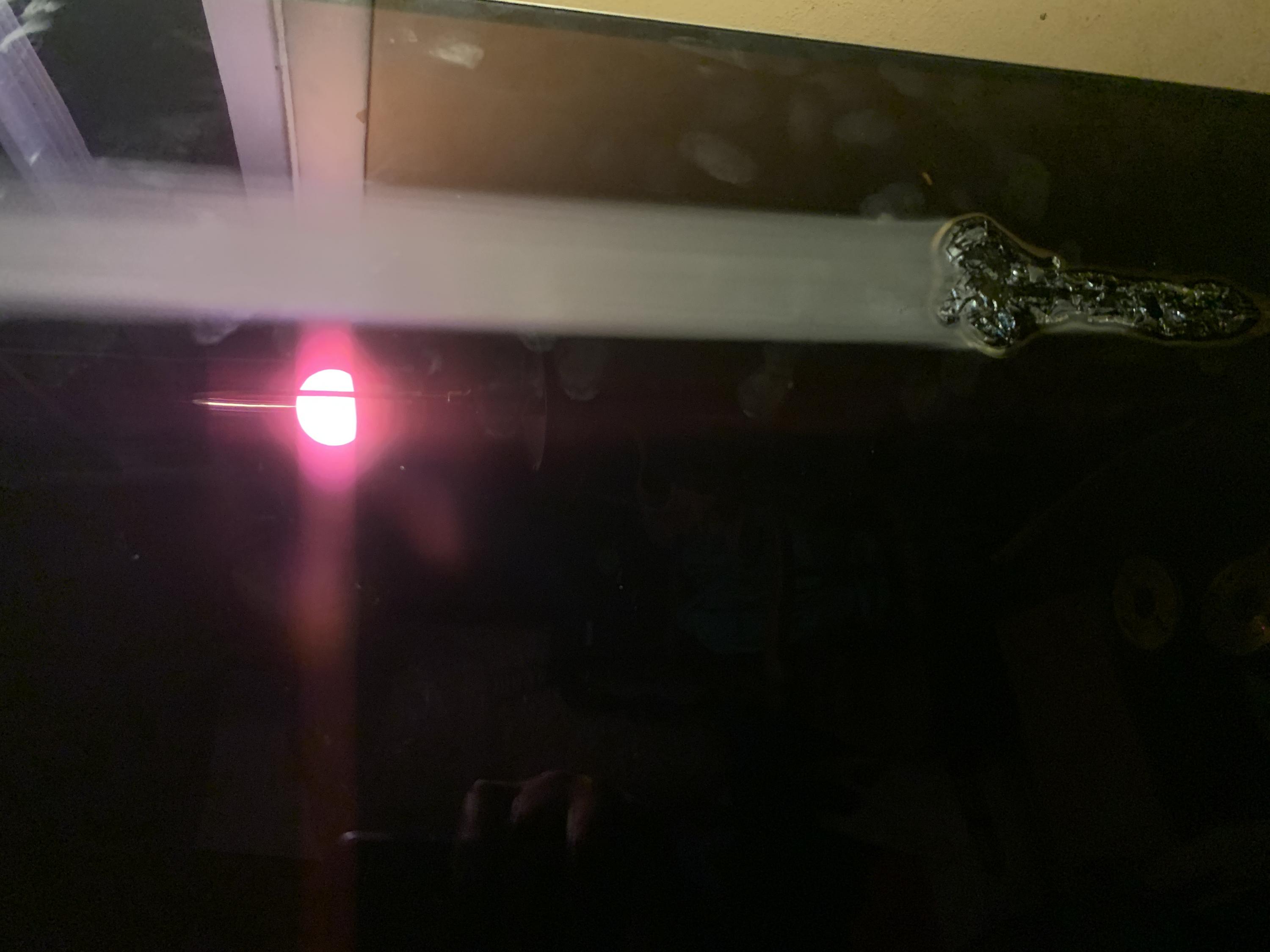

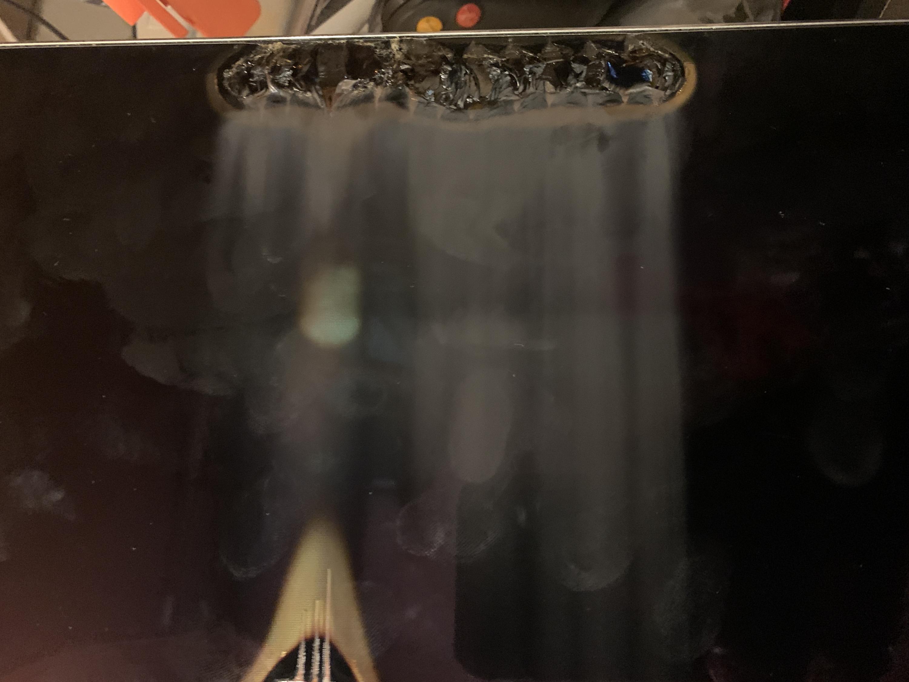

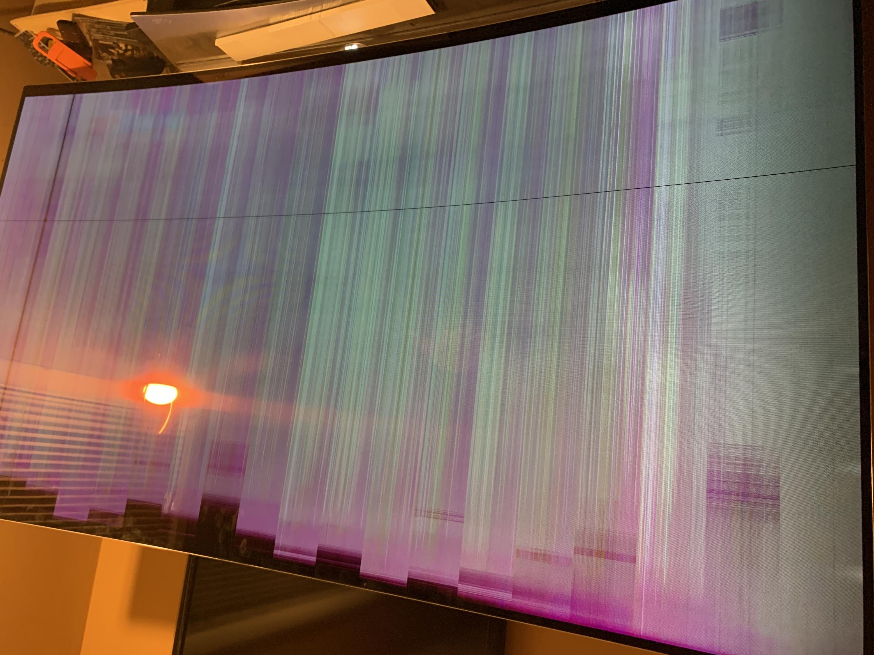

                  Well well well. Looks like this project over. After doing numerous test this happened. The first 2 were normai nothing major. The last 4 pictures the screen catches on fire. In the place where the screen had the 2 red lines come together. If you look in one of the original pics you can see where the line has a dot or circle where the red line is. Not sure why But im guessing it wasn't meant to be!! Geez!! I guess I can sell the boards on ebay but the screenitself is literally toast lol.
                        My goodness, so the LG protection circuit did not work too well.
                          my post #2
                          there is no Protection circuit at stand alone Test T-CON with panel Only
                          Move on. its not only at you happened.
