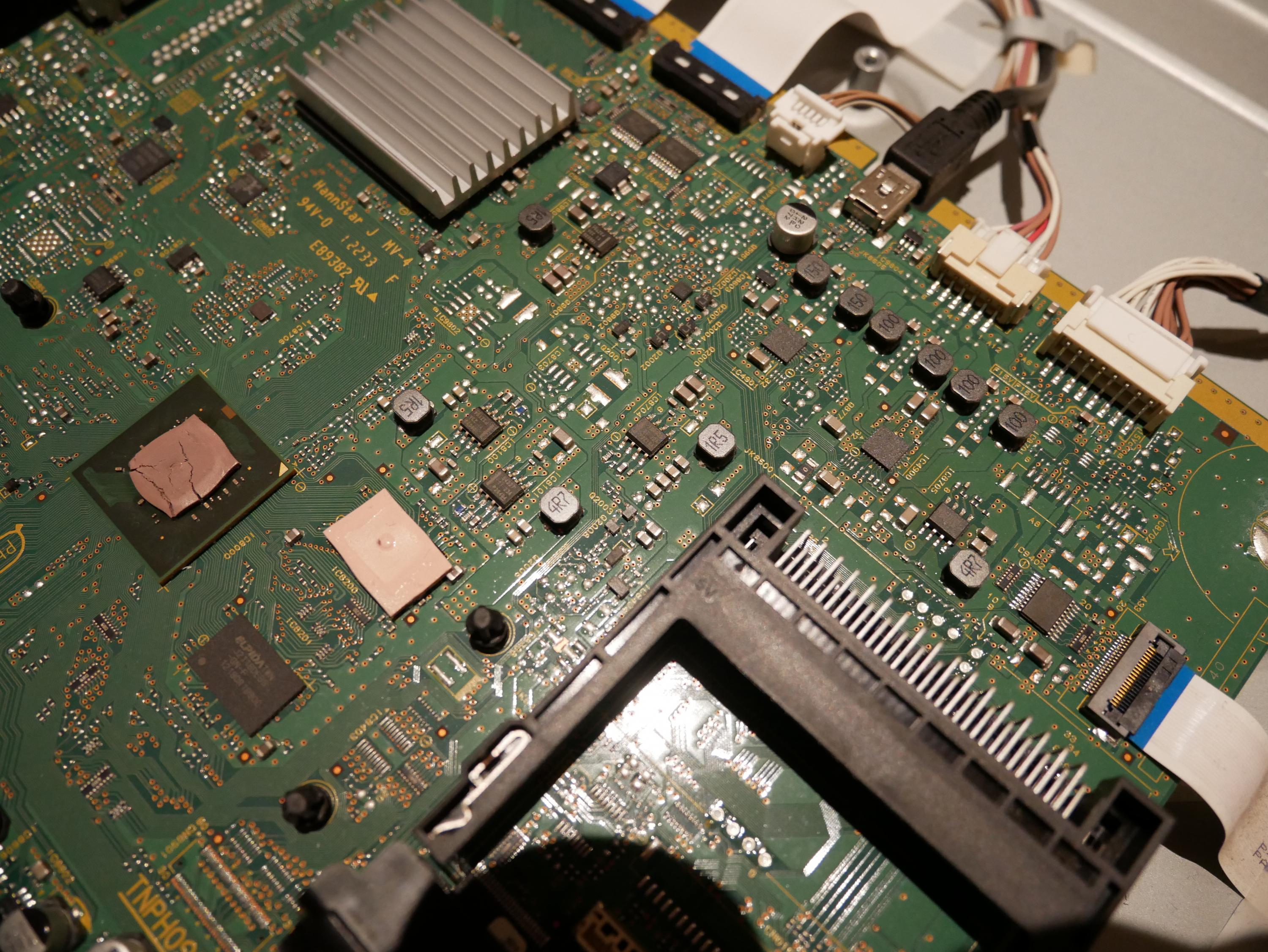

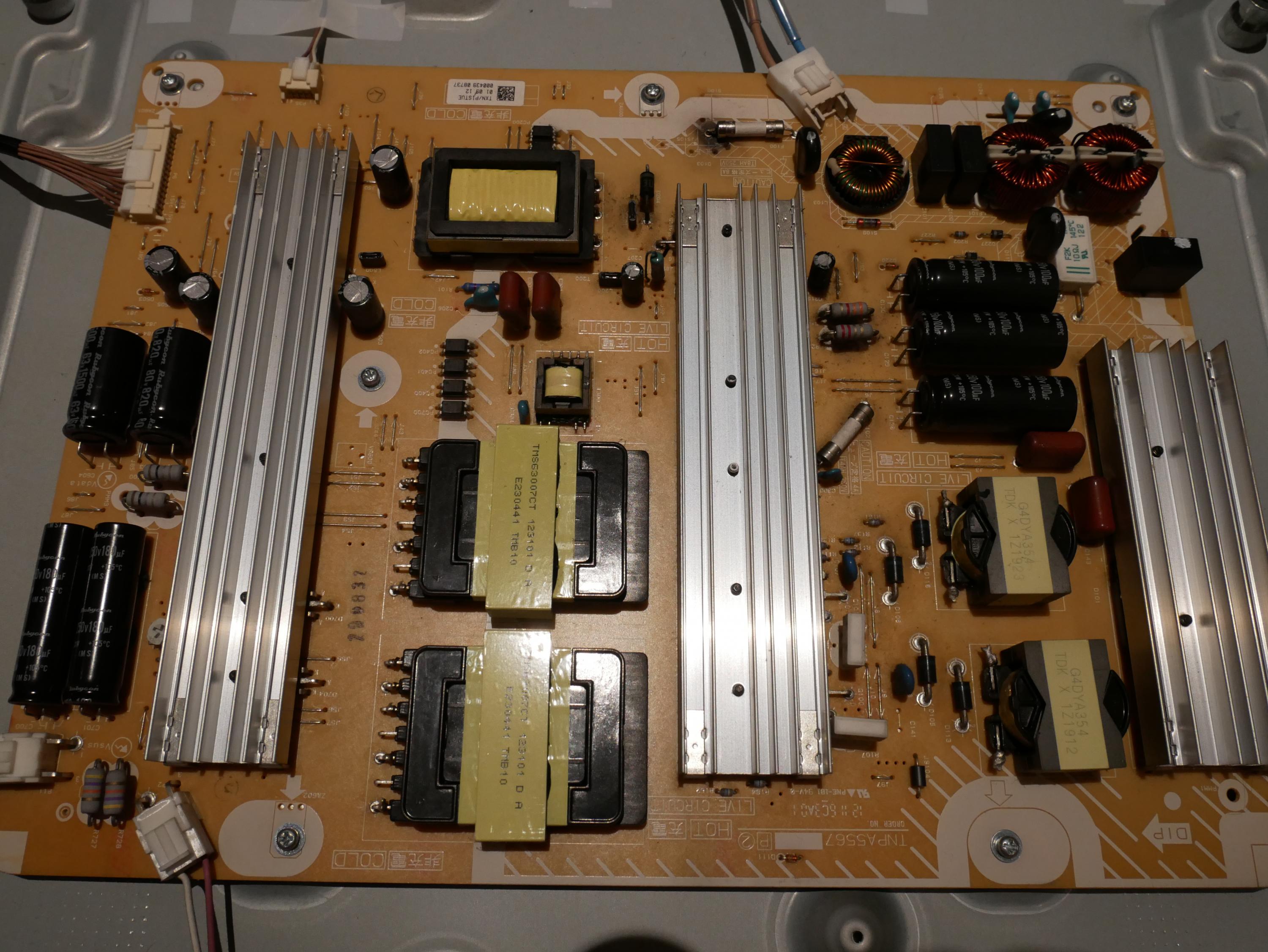

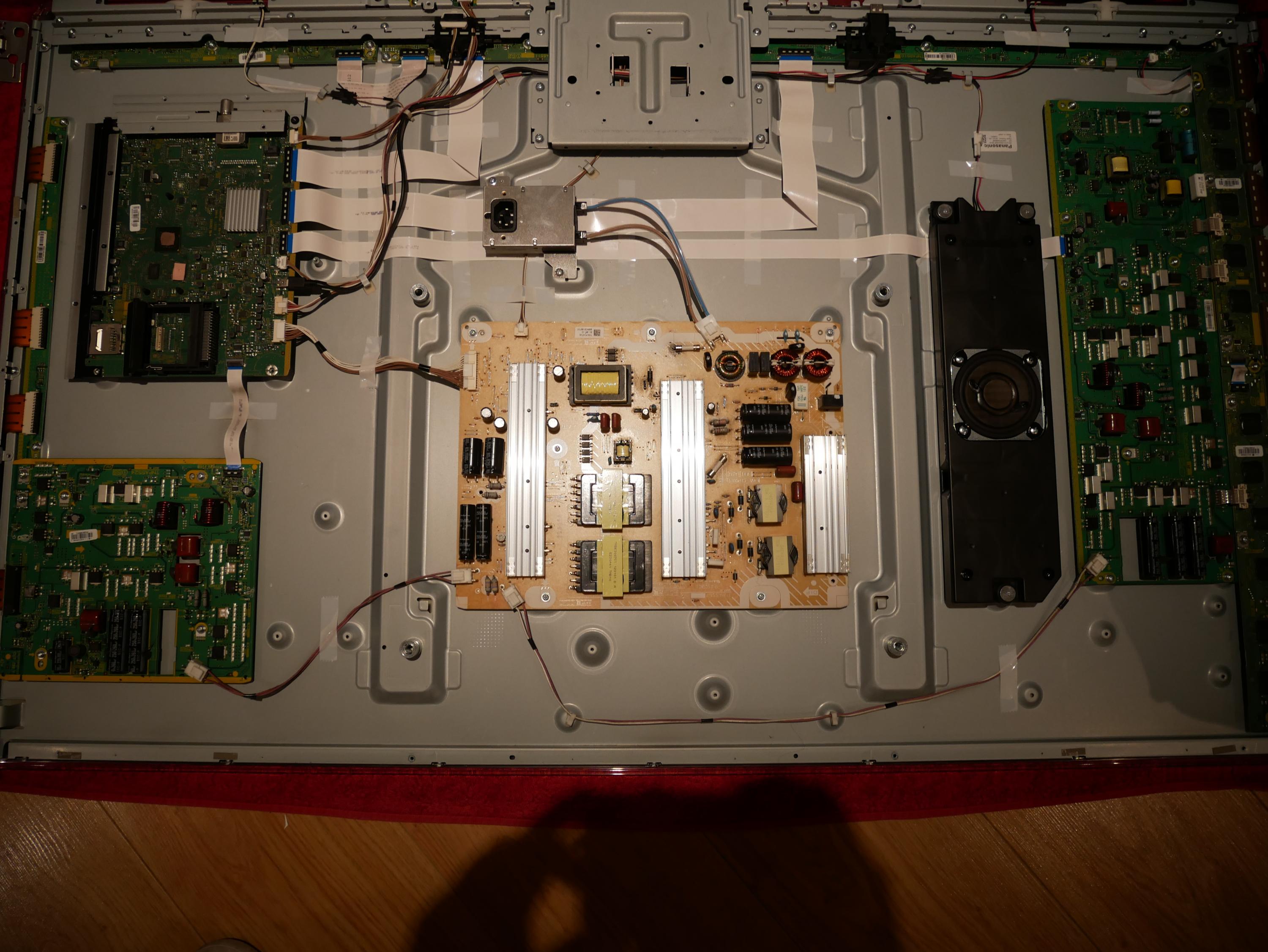

    Hi everyone,
    disclaimer: I am a newbie at electronics, trying to learn as I go This is my first troubleshooting experience.
    My Panasonic P50ST50B has stopped turning on a couple of months back, and I am now trying to understand what happened and if there is a way to fix it.
    The red LED turns on when you plug the TV, pressing buttons on the remote will make the LED flash green fast for a few seconds.
    After 2-3 minutes of no activity, the PSU clicks twice and the LED turns red again and blinks 13 times.
    According to the technical manual,
    "This condition can happen when the internal communication of the Main processor
    and the Standby microprocessor within the PEAKS-LD4 IC is interrupted.
    It could take up to 3 minutes after the TV is turned on for this condition to occur."
    The display never turns on.
    A few weeks ago I could get it to turn on every once in a while.
    When that happened, it would display the Panasonic logo and get stuck there.
    I measured voltages at P6, the results are the following:
    - TV plugged to AC but forced off: all pins 0v except pin 6 at 4.5v (I guess this is an error in the multimeter, based on other posts on this forums)
    - After pressing power button:
    pin 6 4.5v
    pin 7 3.0v, fixed
    pin 10-11 15.80v
    pin 13-15 2.15v ( ??? )
    - After 2-3 mins, i.e. once the TV goes into shutdown and starts blinking red 13 times:
    Not sure about this one (multimeter isn't working at the moment)
    I think it was just pin6 4.5v and 10-11 15.8v
    More info:
    - I checked the top fuse on the PSU board (the one close to the input). There is continuity (so it should be fine, right?)
    - pin 1 of P6 is always at 0v, i.e. the Panel ON signal never comes (as far as I could see)
    - I verified that IC8714 has 3.3V and 1.8V on the two side pins. This is part of step 6 in the "Start up operation" described in the technical manual, however I am not 100% sure if that implies that the TV got to step 6.
    - I never got pins 13-15 on P6 to show 15v, i.e. the correct value according to the manual.
    What is your opinion, based on the available information?
    Could it be that the problem is actually the PSU and not the A board?
    The A board for this TV seems really hard to find (or more expensive than getting a new TV), so I am hoping there's another way to fix this

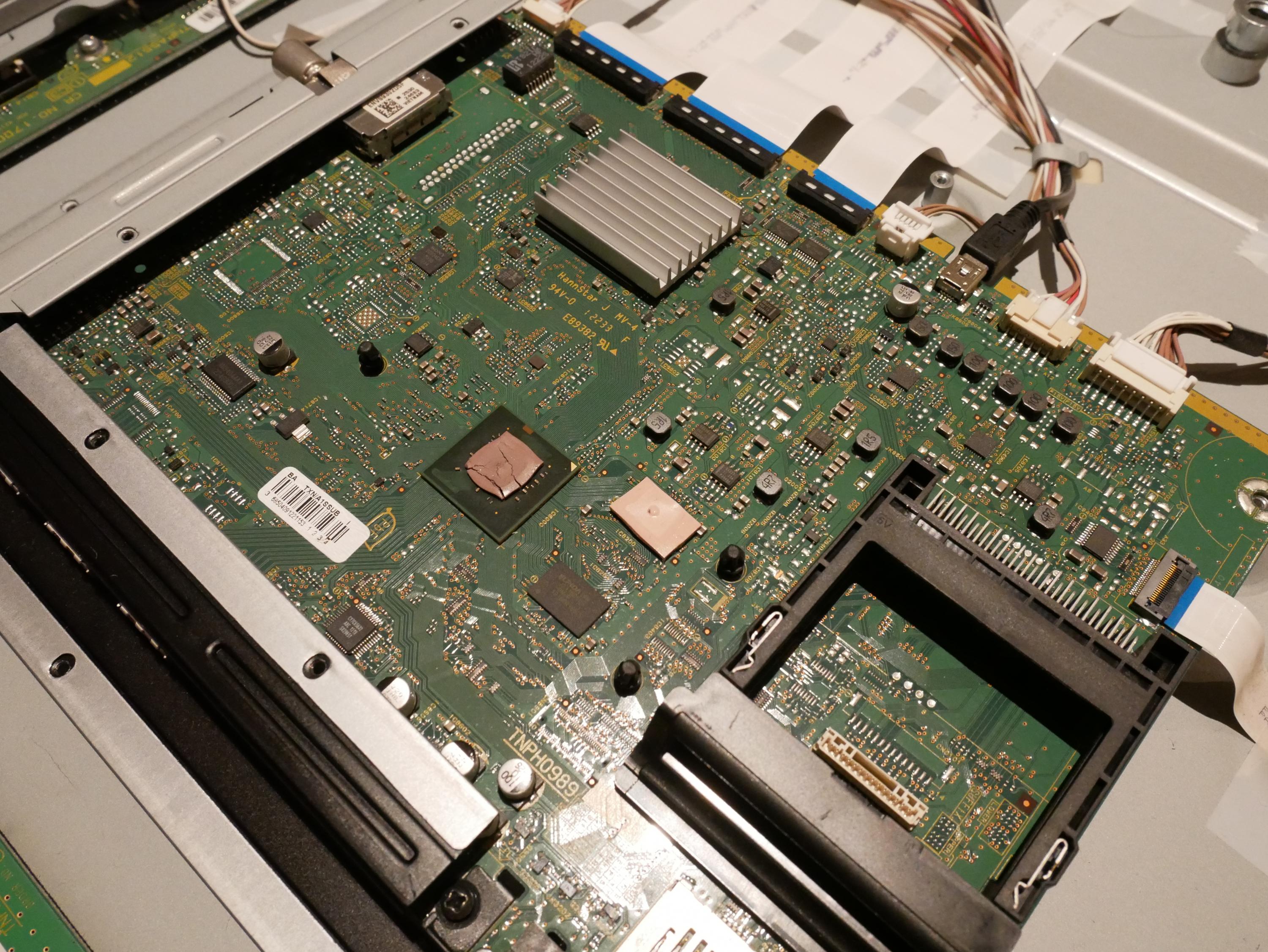

    A board is bad.

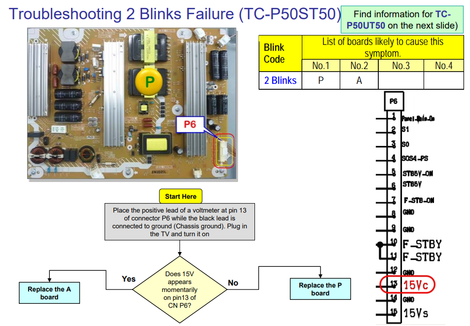

              Ok, it's missing the pins labels, 2.15V at P15V is too low, that is enough to not trip the 2 blink error code apparently, but test with only A and P boards connected, 15V is routed to SC boards via the flat cable.
              Service manual pins read as:
              1 Panel_Main_On
              2 S1
              3 S0
              4 SOS4_PS
              5 STB5V_ON
              6 STB5V
              7 F_STB_ON
              8 GND
              9 GND
              10 F_STBY
              11 F_STBY
              12 GND
              13 15Vc
              14 GND
              15 15Vs
              The picture included says that P-Board is at fault if 15V does not appear even for a brief moment.
              You need to have a reliable multimeter with proper batteries, all your voltage readings may be wrong and be misleading.

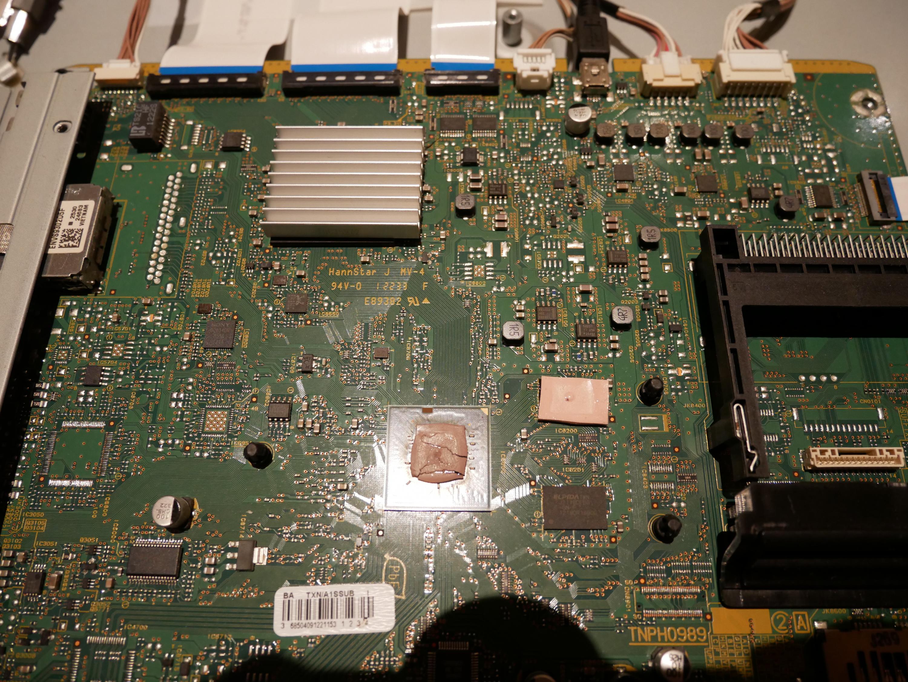

                  Don't waste your money on a power supply, it's a bad main icu chip on the mainboard.
                  I had the same problem on one of the US versions of this tv. There may still be re-balling services out there.

                      tvtimmy knows better, I wasn't suggesting an exchange of power boards, but troubleshooting to see what could it be, I have no experience on this model.

                        They start with the erratic turn on, then go to the freezing of the Panasonic logo, and then nothing at all. I got lucky and found a mainboard in New York. I found it on the ALL OF CRAIGSLIST page on the web.

                          I see, so you think I should just go for a new A board (or look for a reballing service).
                          Unfortunately I cannot find any online for this model...
                          Do you know if I can use any TNPH0989 to get it going? Will the board for p50st50C work (I think that's the asian model)?
