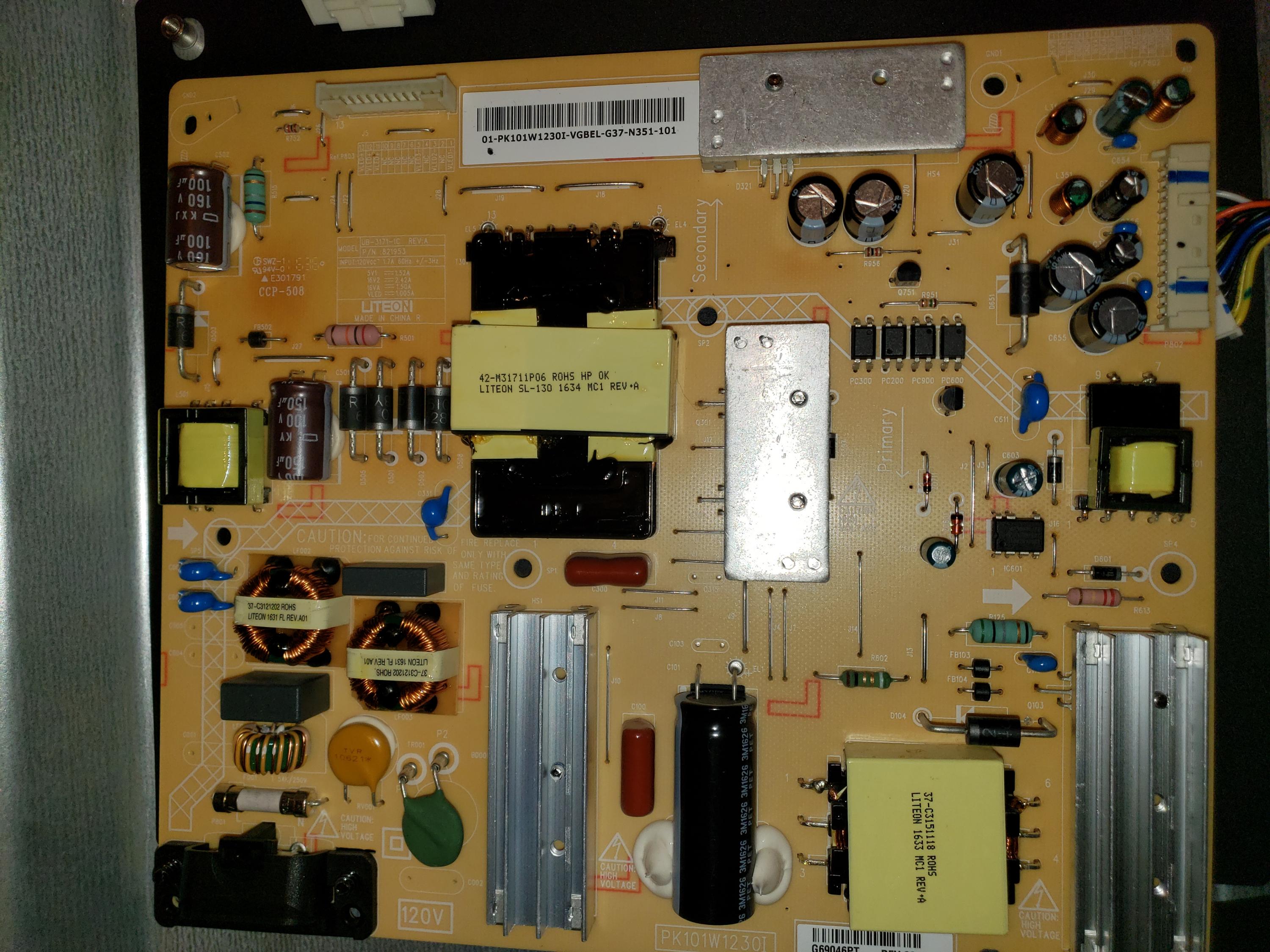

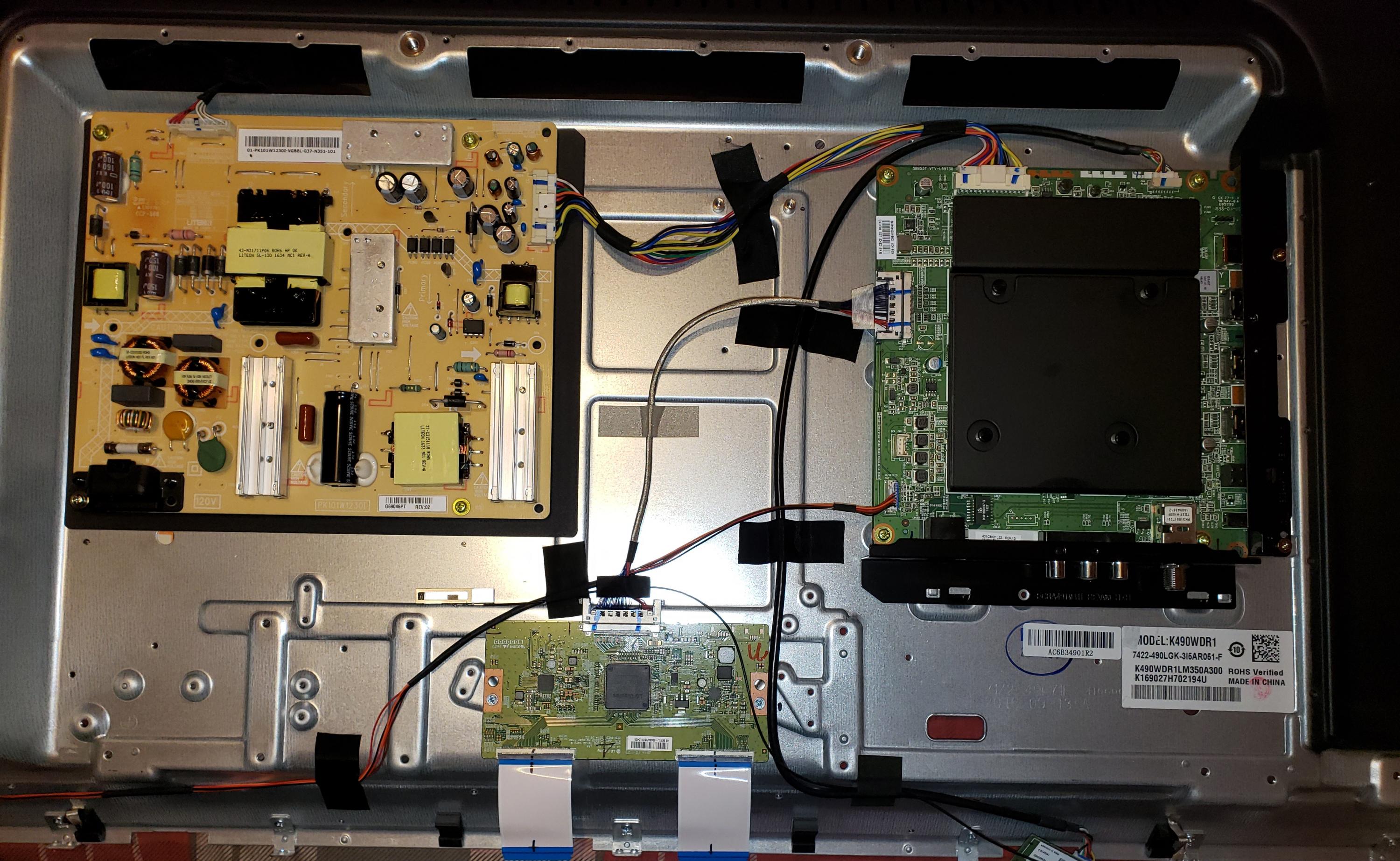

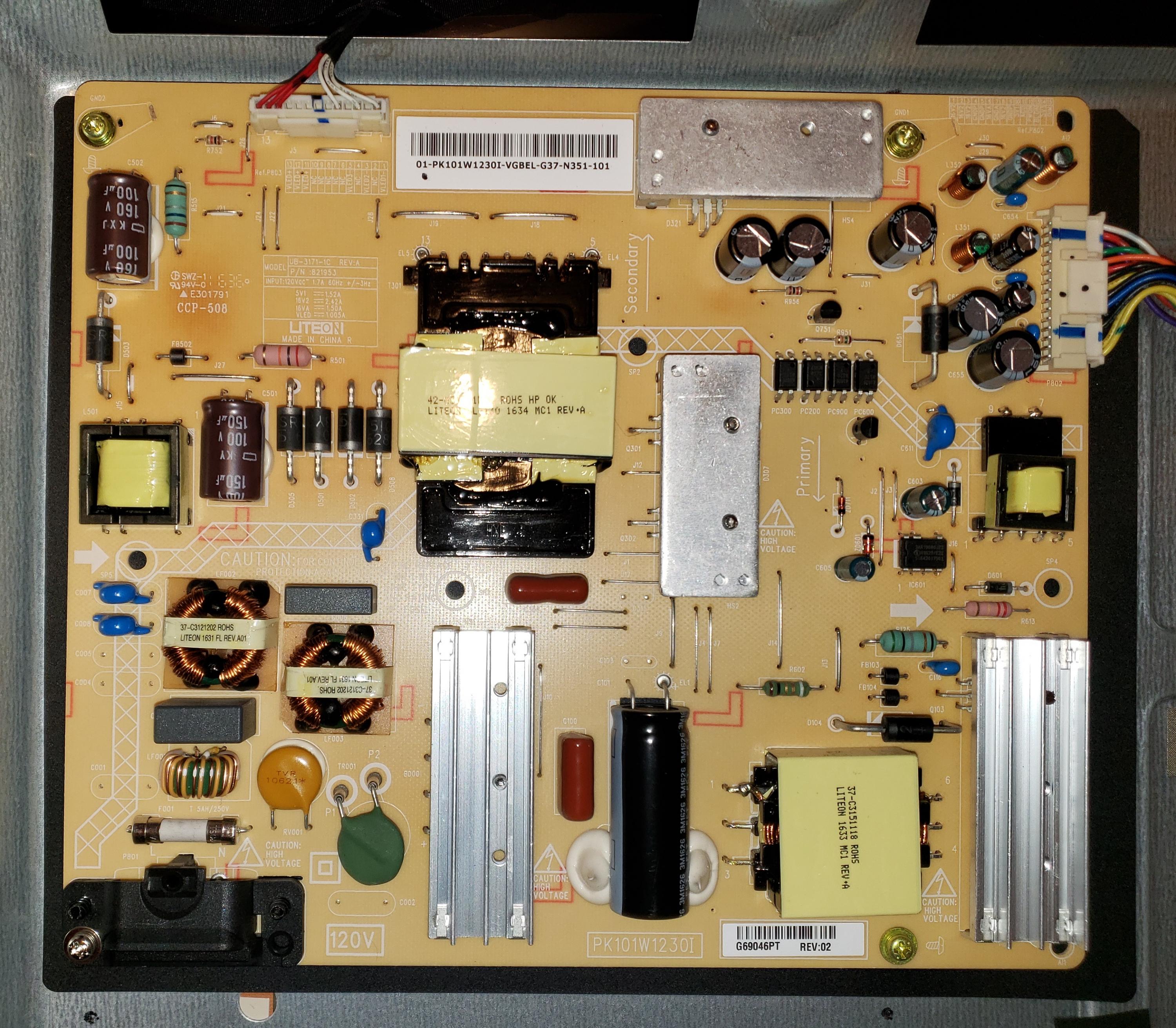

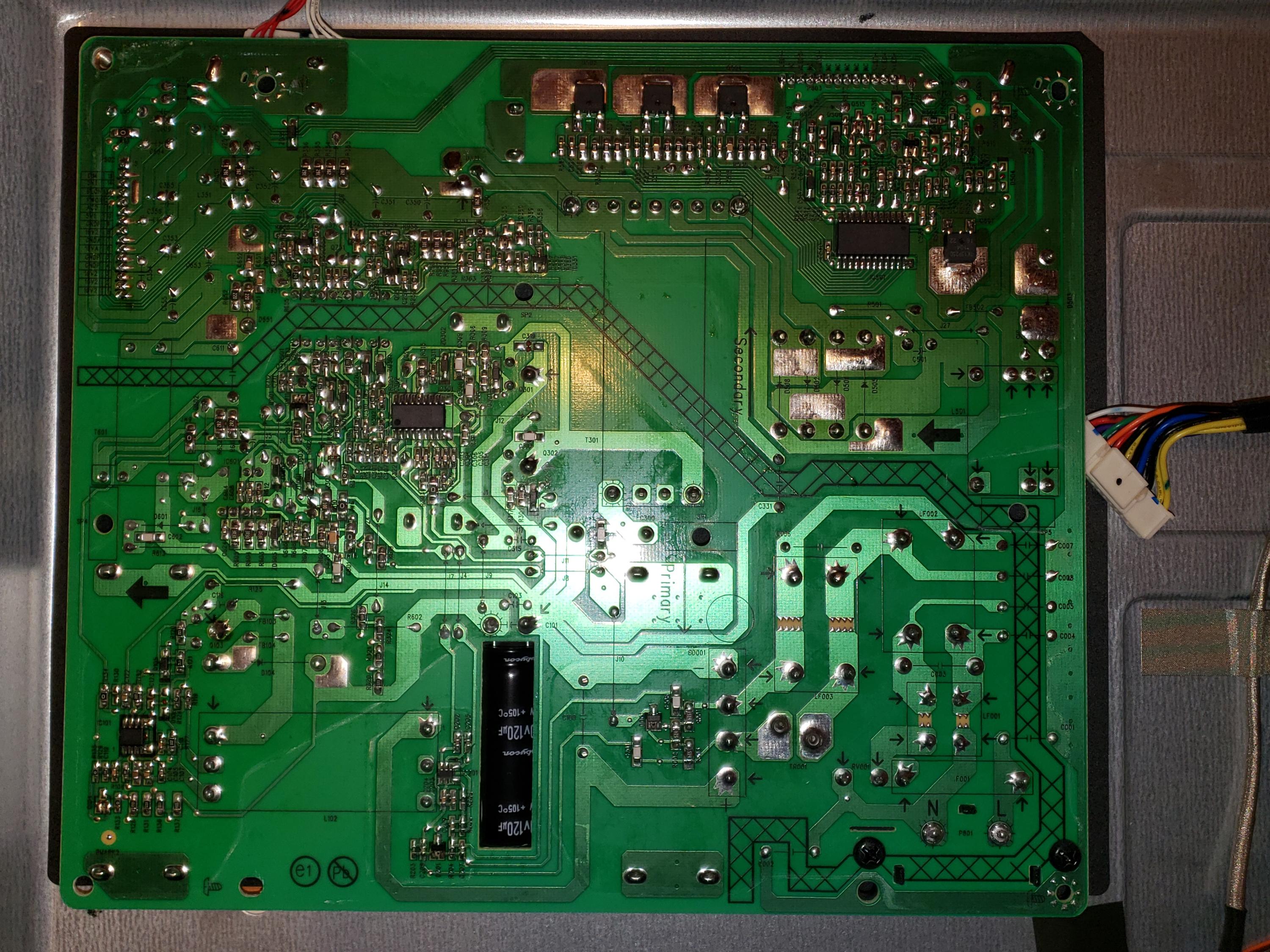

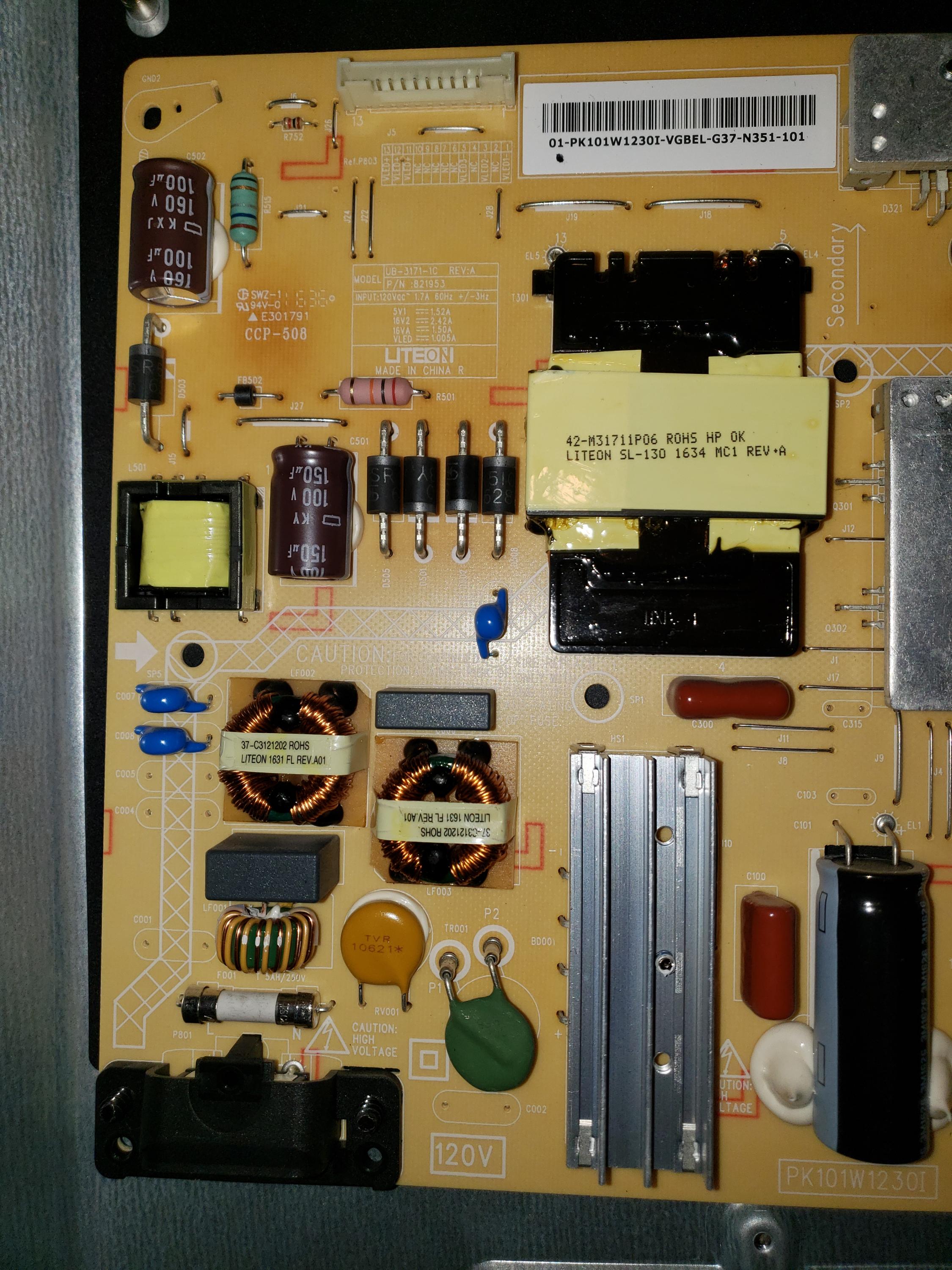

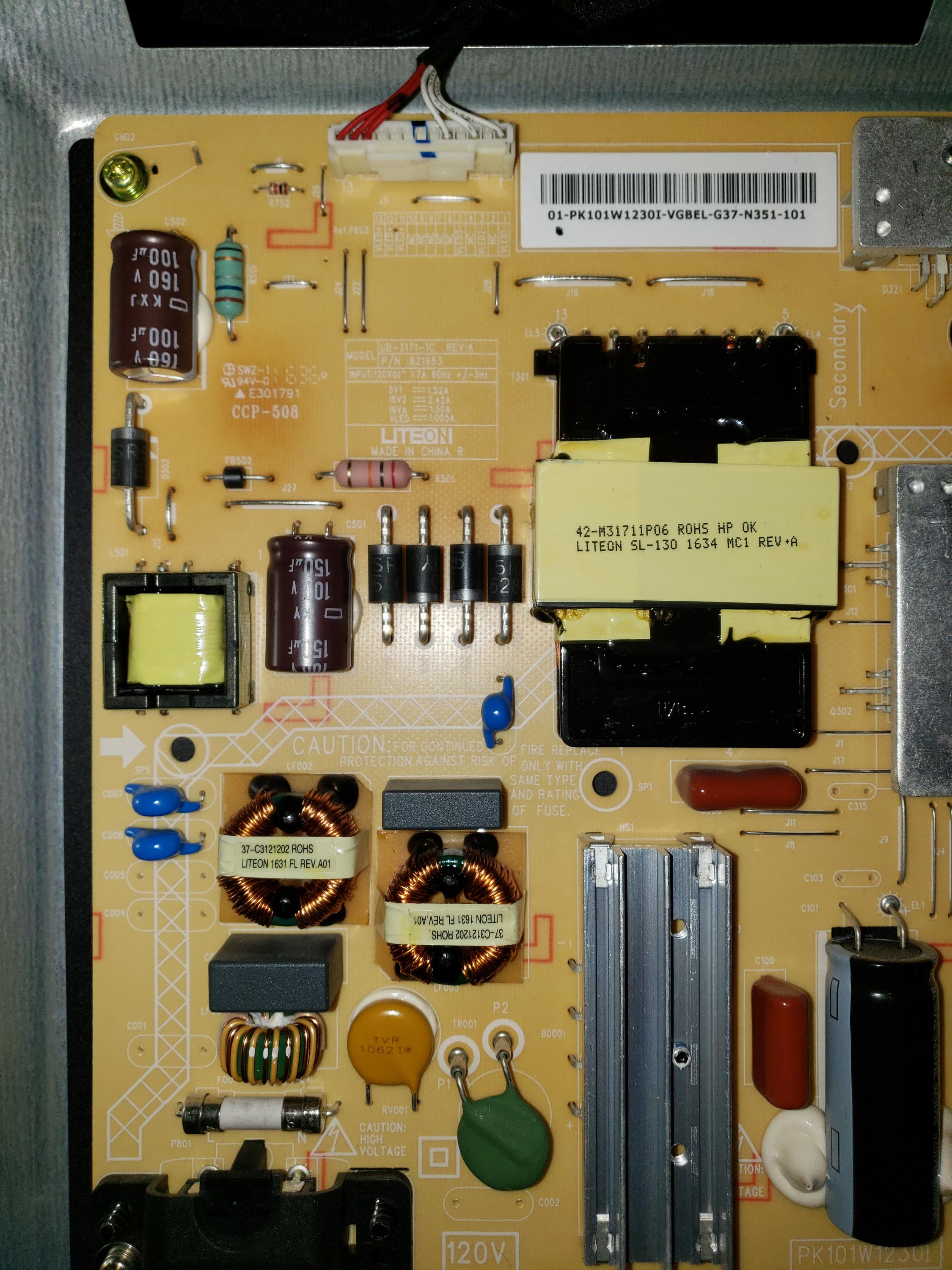

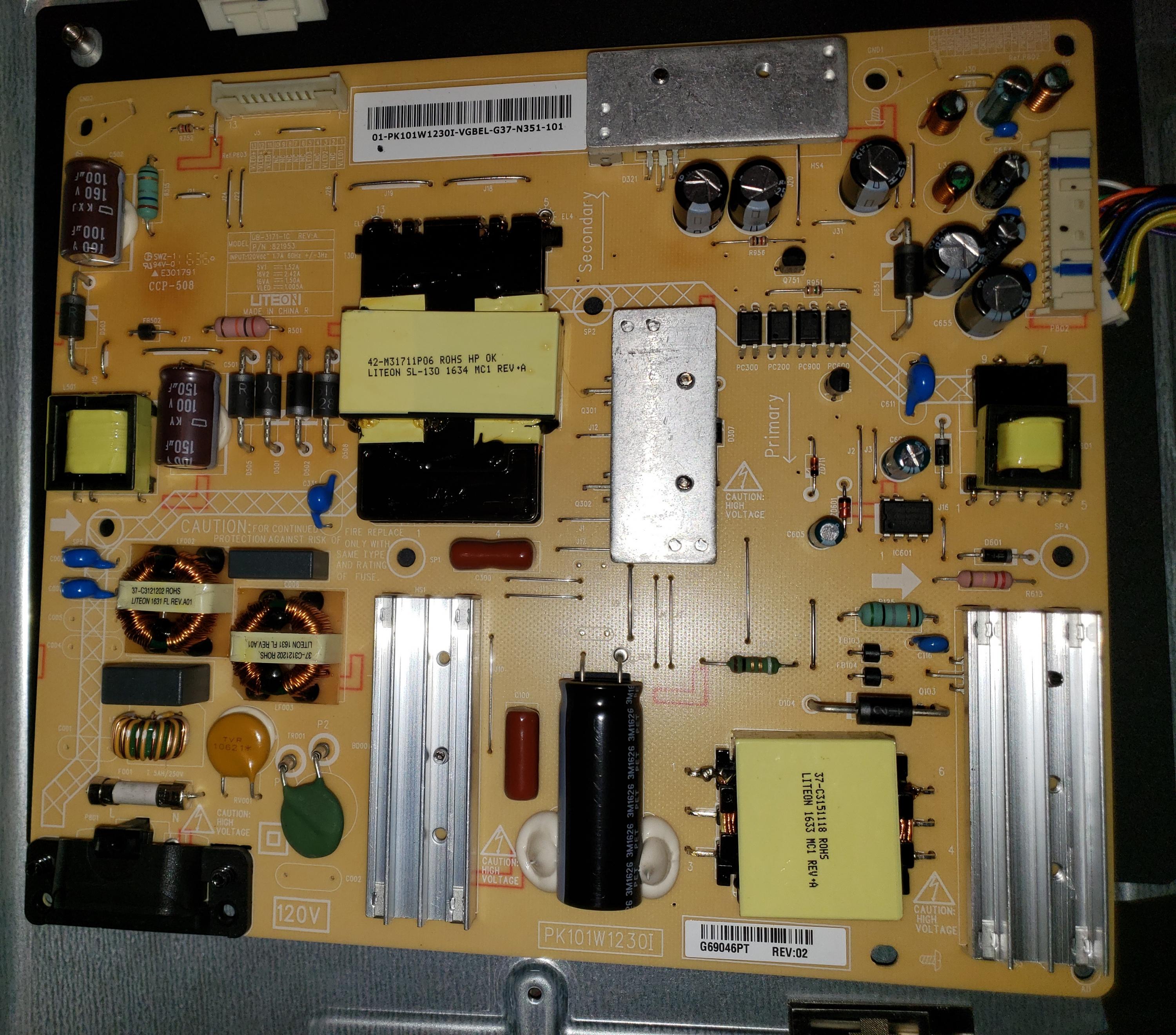

    Show us good clear pictures of the backside of the TV showing all the board, then good clear straight shots of the whole power supply LED driver top and bottom side.
    What Voltage testing have you done so far?
    • jason123
      • Oct 2015
      • 1138
      Re: Puzzling - Toshiba 49L621U Good backlight
      Let me know if you need a closeup of anything, or better shots

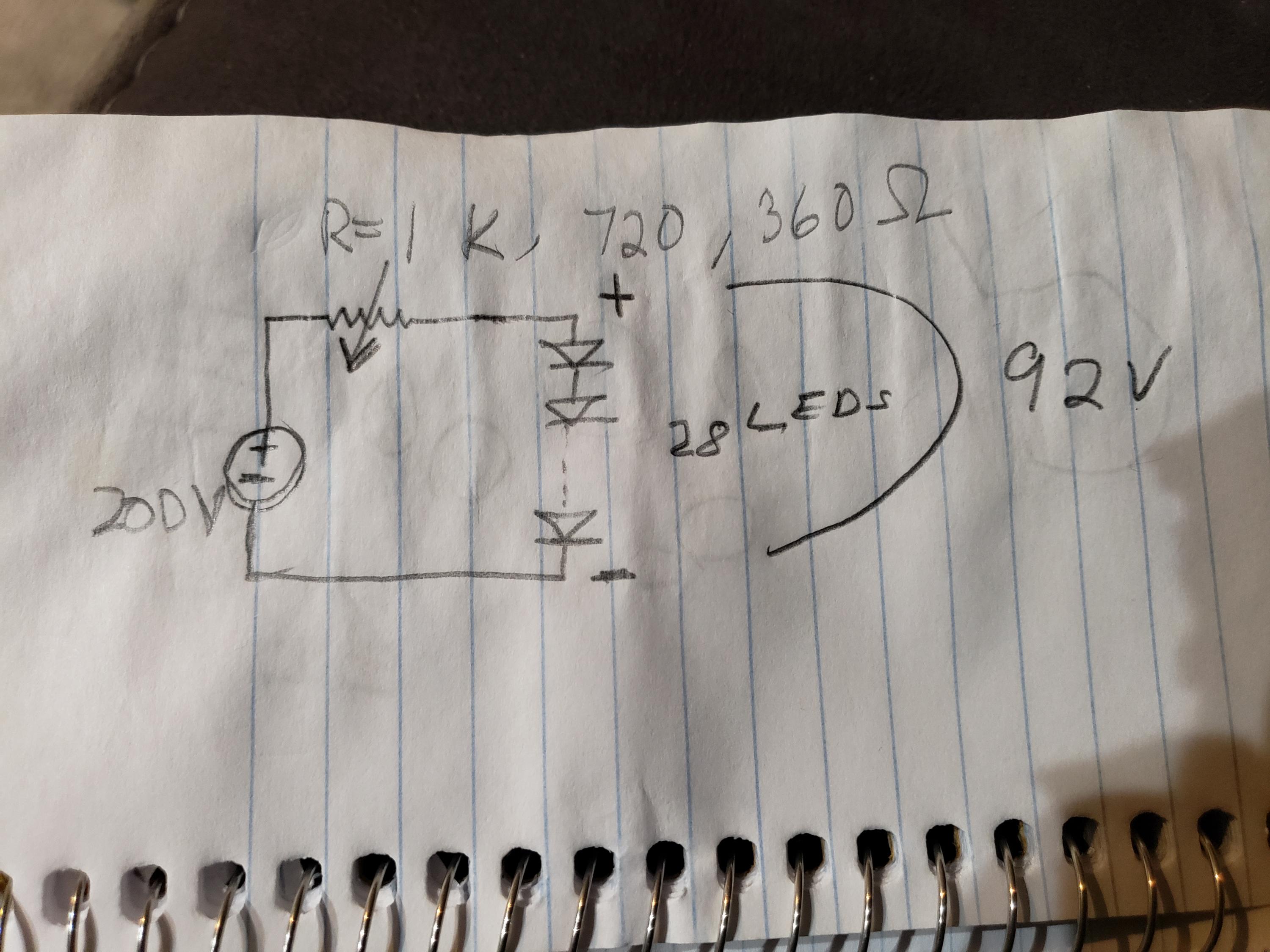

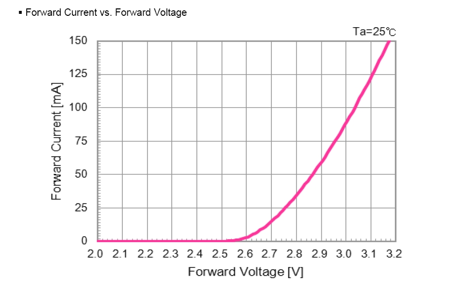

        "I was testing a string at a time (200 V - 3V*28 = 116V across)"
        Please clarify that.
        3V x 28 LEDs = 84 total Vf for the string.
        116V across what?
        • jason123
          • Oct 2015
          • 1138
          Hopefully this helps clear it up
          200VDC source
          Series R 1k or 720 or 360 ohm
          Across led string (4 strips- 28 LEDs )
          Actual measured voltage is 92 across the LEDs
          • Diah
            • Feb 2013
            • 6573
            again we are at topic LEDs ... they are working together as currents forward not V. !! which type of LED build in the string? i guess yours replacement LED didn't match the CF
              200VDC source
              92V/28 = 3.28V
              As you can see in the graph, the higher the current the higher the Vf as to be expected.

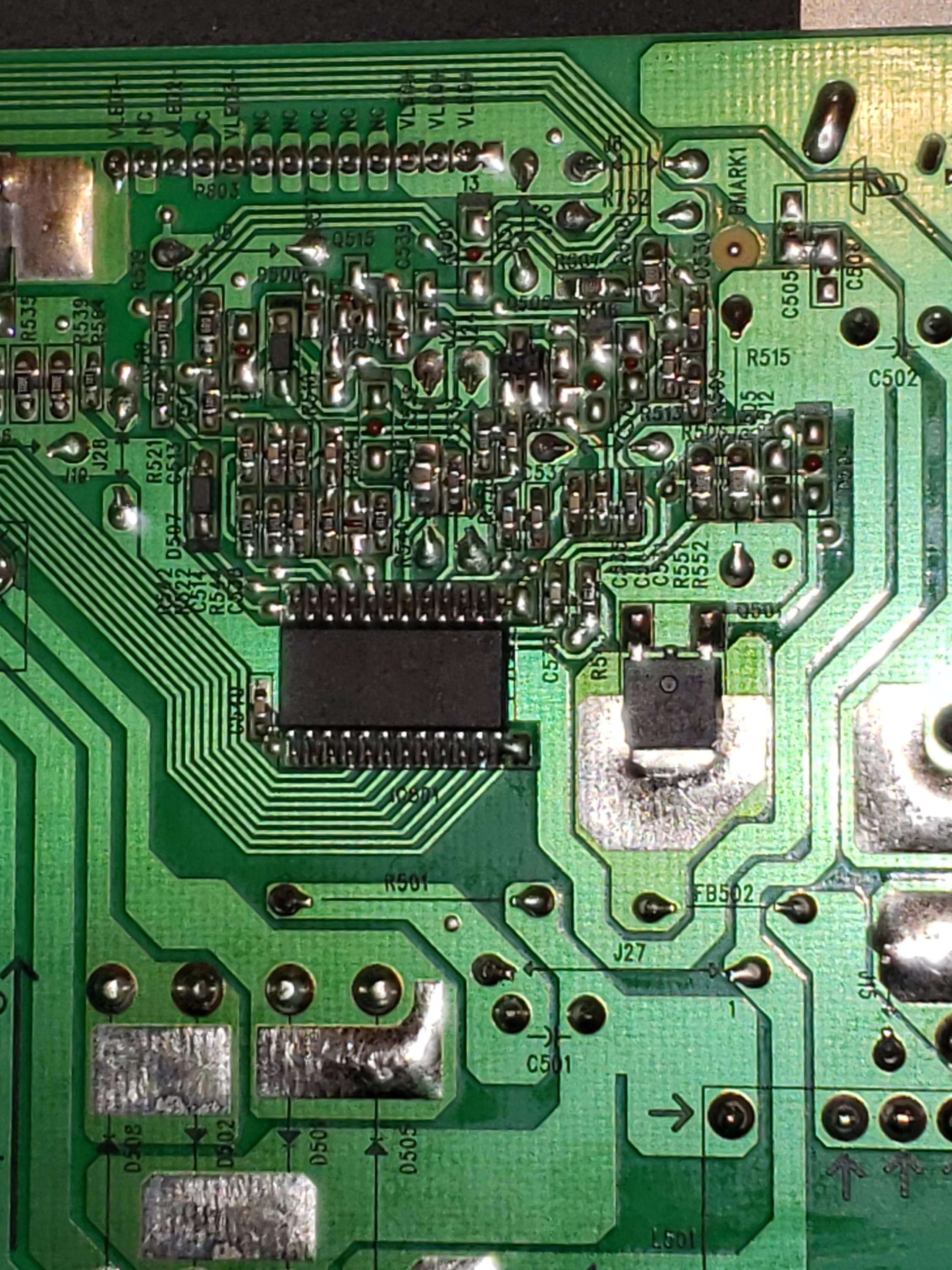

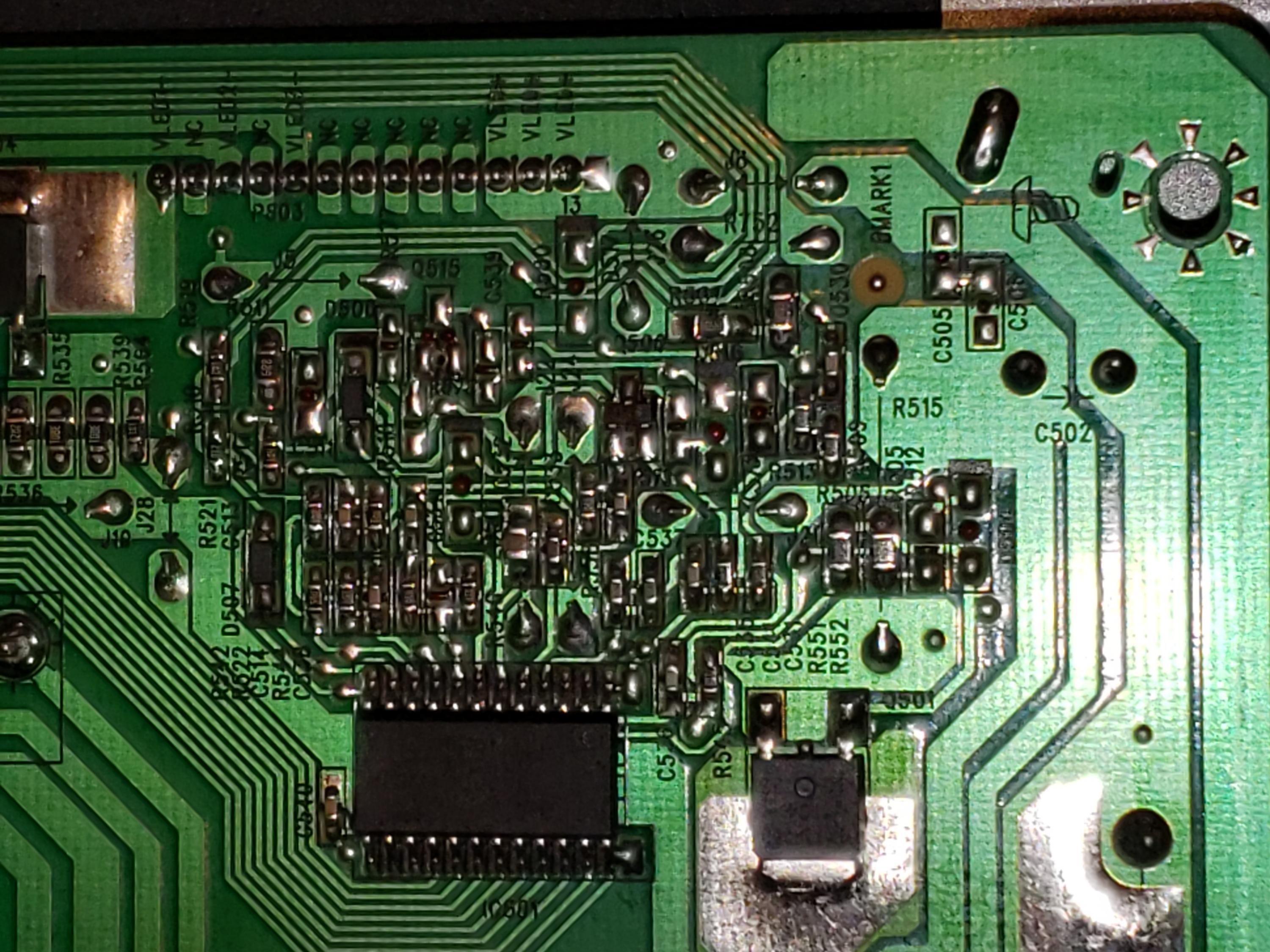

                  Can you show me where the location of the R585?
                  BTW, what is the P/N of the LED driver IC?

                    Hi budm

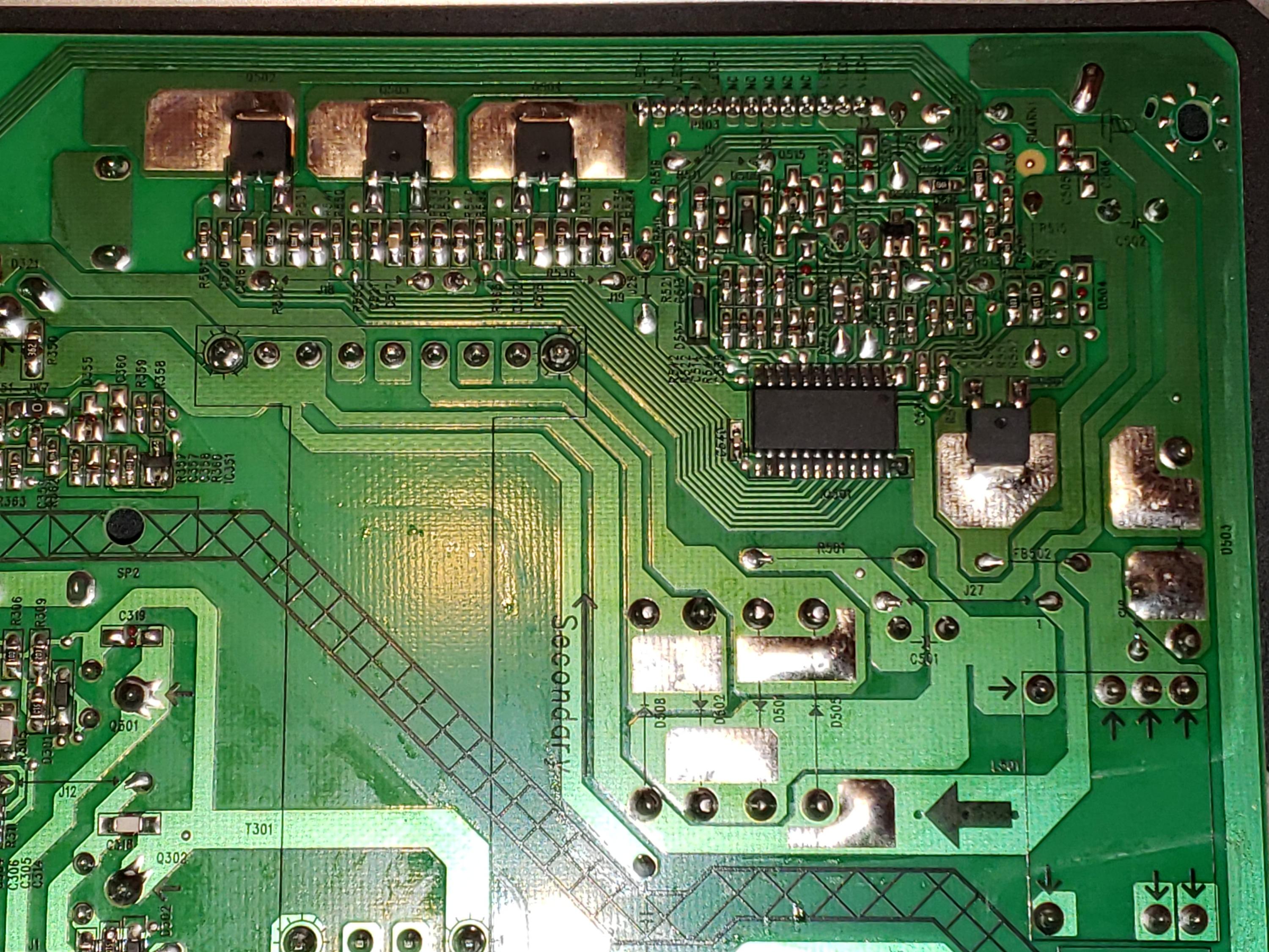

                    The resistor is right to the left of the 2 caps below the FETS
                    See picture

                      So one of the Resistor for the PWM controlled MOSFET for VLED1 (one of the three PWM controlled MOSFET's, One Boost converter) for controlling the constant current is bad..
                      Thanks for the info.
                      So the measurement in your post #1 gives us the clue:
                      Photos Uploaded
                      On P803 (Power to LEDs)
                      VLED+ (referenced to Chassis) goes up to 105 V then down to 65 and slowly discharge
                      VLED3- and VLED2- goes to ~6 V or so, then discharges to 4.5 V then slowly discharge
                      VLED1- goes to ~5.8V but almost instantaneously discharges to zero V
