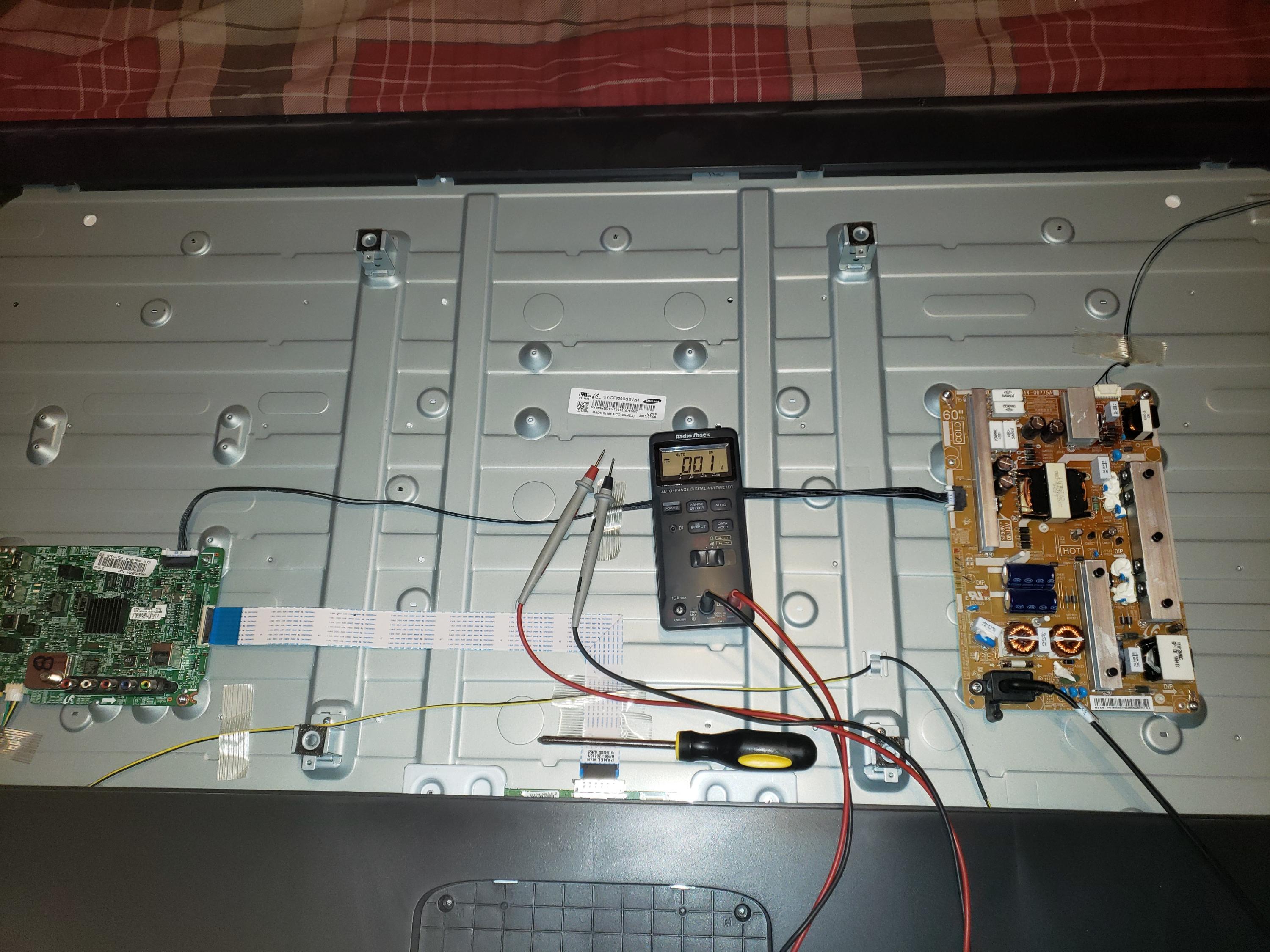

    Troubleshooting a TV that doesn't have backlight (Flashlight tests ok - I am getting data on screen - no backlight)
    I see Firmware ICs and PS repair kits on eBay in addition to the obvious bad Backlight.
    I'd hate to open up the panel to find a different problem though.
    So here are some measurements I was hoping someone can tell if it's backlight or something else.

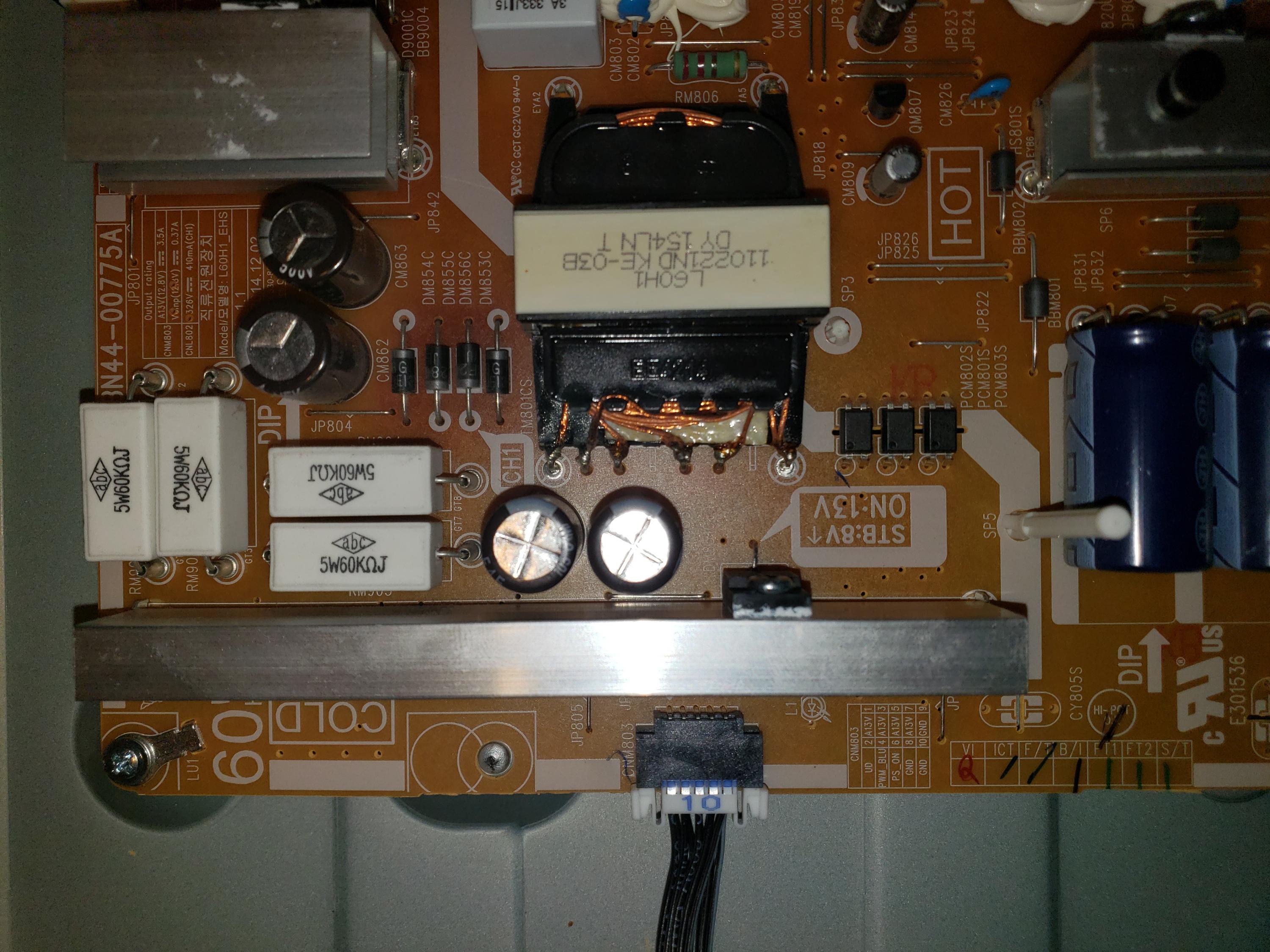

    Main board is getting 13V standby and does generate the 3.3 PWR_ON signal
    On the Power supply board:
    D+, D- = 417 V
    S+, S- = 402 V
    (guessing if D+ and D- are same voltage then there is no current flow = translate to open LEDs?)
    Readings above are when TV is on, and referenced to COM (Chassis)
    I tested the problematic Diode - it has 417 V across it. Upon removal, it has 0.7k ohm, and 3.9 k ohm (keeps going up)
    Any other measurements to take to confirm the diagnosis?
    When I apply voltage from D+ to S-, and S+ to D- I get some LEDs lighting up. I don't have the panel open, so I don't know how many if any are dead LEDs.

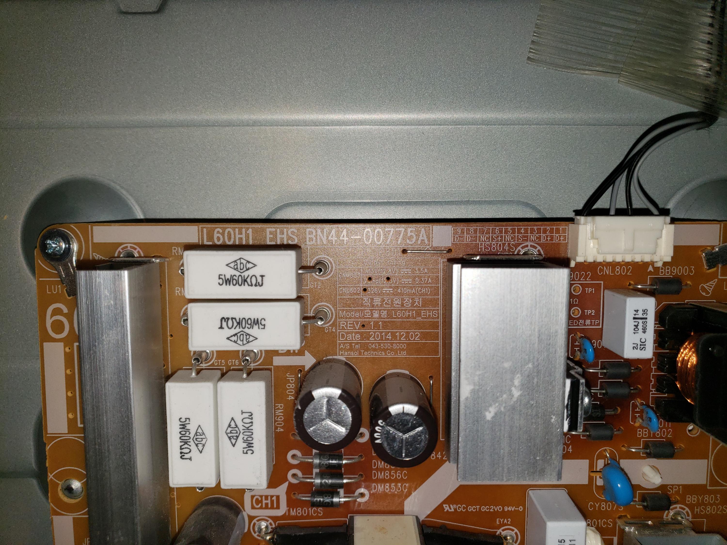

    Which Diode? What is the designator for that Diode, Dxxxx?
    It is bad if it shows resistance in both directions.
    Board: BN44-00775A

      D9001C... from other posts you've helped on, the same resistance was the issue. You think it's bad with these readings?
      Yes, this is the BN44-00775A

          I have a home rigged 380 V with adjustable current from 3 to 25 mA. I have used it for years.. bulky and ugly but it does the job.. i think

            " it has 0.7k ohm, and 3.9 k ohm (keeps going up)"
            Replace it.

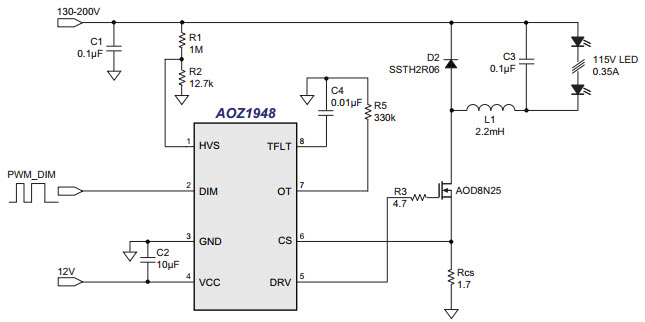

            See the LED driver topology, if the diode is leaky you will get same Voltage reading on D+ and D-.
            Also check SMD resistors R9032/9033 right by the LED connector.

              A LED tester will read back the voltage across the probes so you can tell right away if you have an open or lots of shorted LEDs without opening up the panel. I have also used the tester to power up the backlights independent of the power supply to confirm a tv has video and the screen is good before ordering new strips.
              To test a diode, unsolder and lift up one leg and put your multimeter in diode test mode. It will read a voltage drop forward biased and open reverse biased. If shorted, it will read 0V both directions.

                          BTW, you can use the LED tester to test Zener diode, and diode (rated >300 Volt) too.
