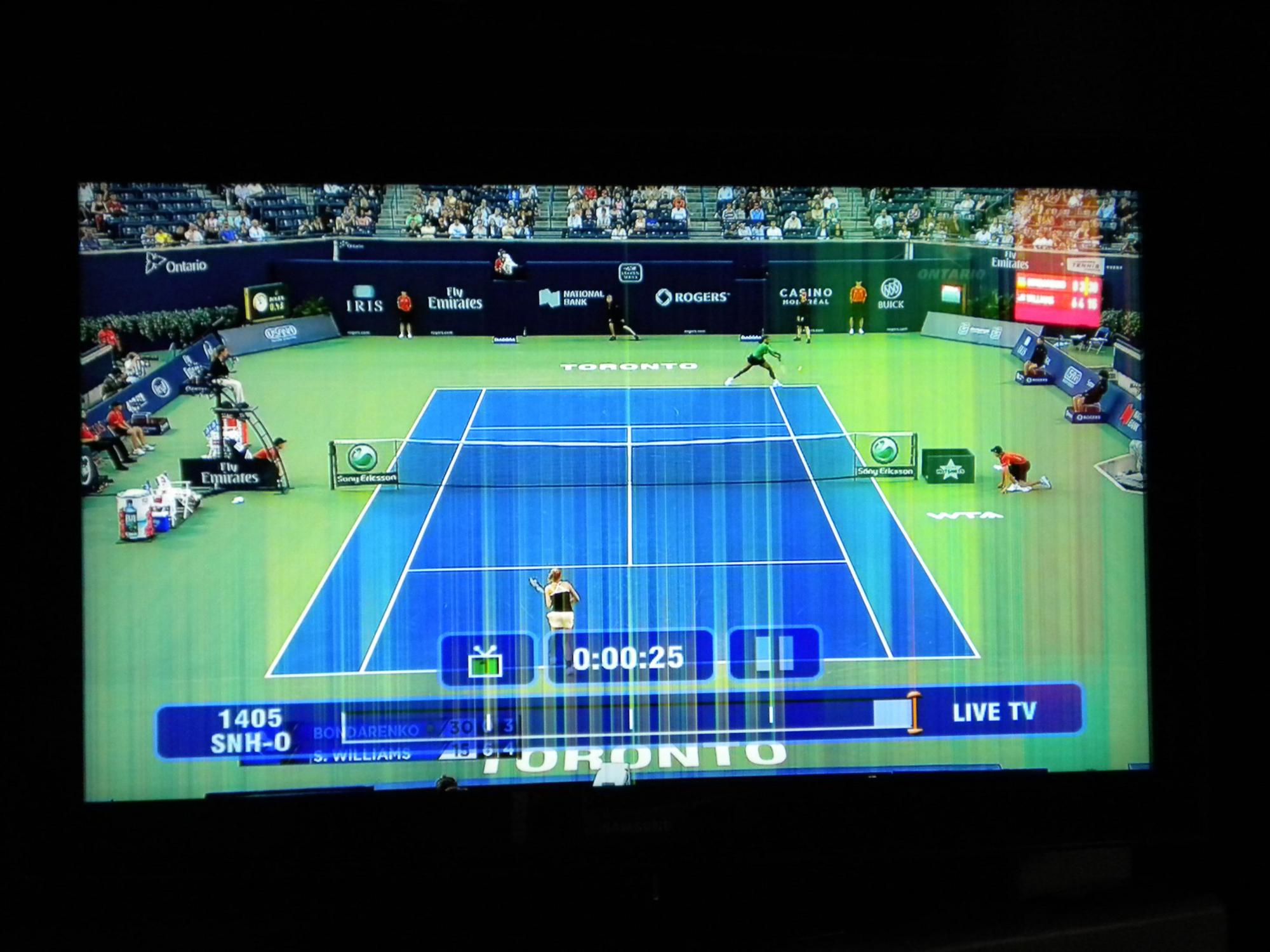

                    There is a second thread about this TV with a lot of law suit talk so I thought I would pick up this thread instead. I picked one of these TVs up super cheap and it shows lines that seem to only happen when there is red on the screen. Blacks come out perfect. The tv is apart and everything looks perfect. It was suggested that this was the TCON board but I don't have experience with big tv's and I don't have a scope. Can someone point me in the right direction?

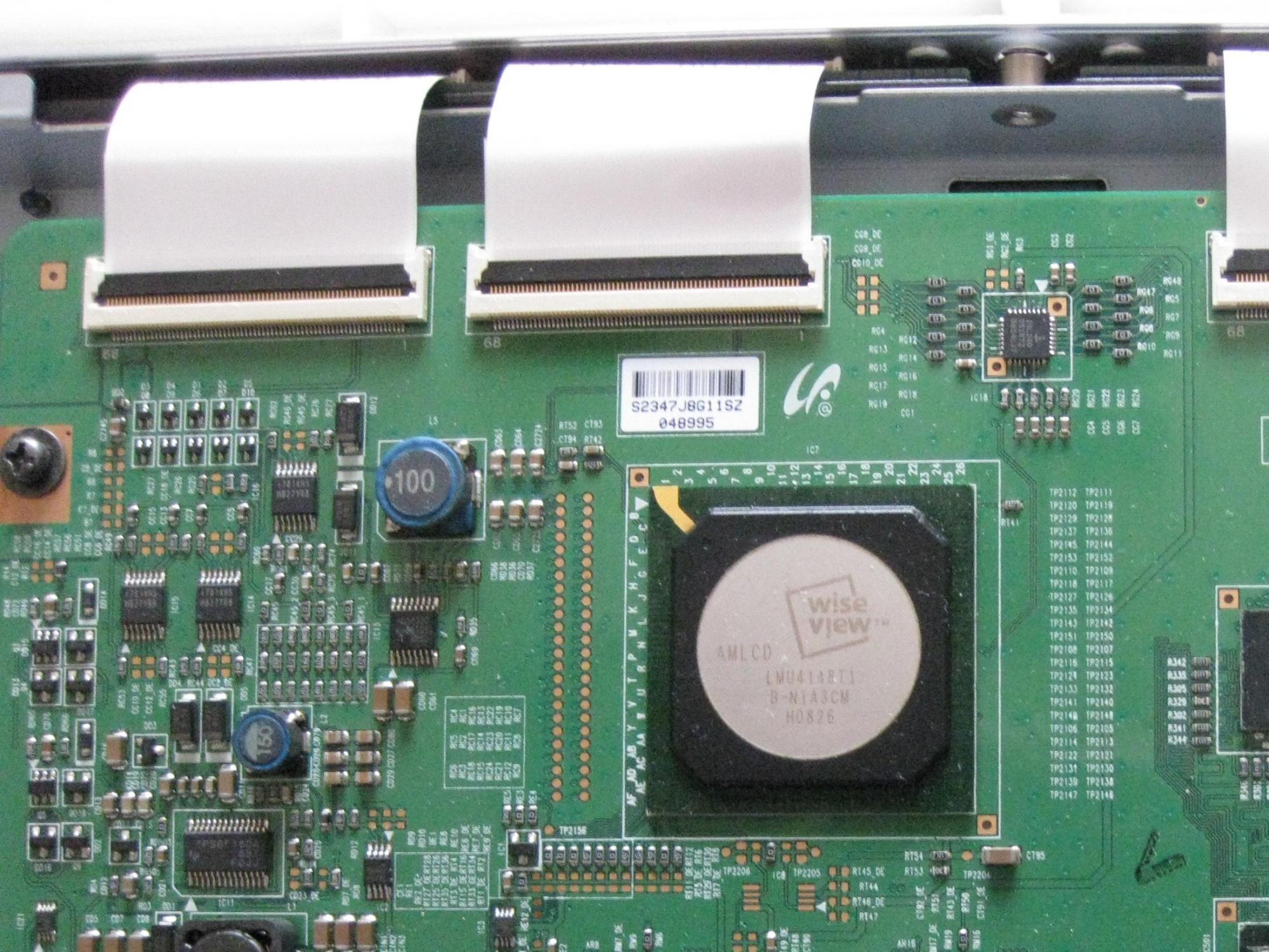

                      Re: Samsung LN46A650 with suspected video processor issues
                      This either points to T-CON or panel.
                      PS: can't scope high speed signals that is used on LCD panels.
                        thanks Wizard. Is there anything that I should check with a multi-meter on the T-Con...it seems to be all solid state.
                          Again, cannot do this with meter as this requires experience to know what to expect good voltages. Replace this board to test is prudent.

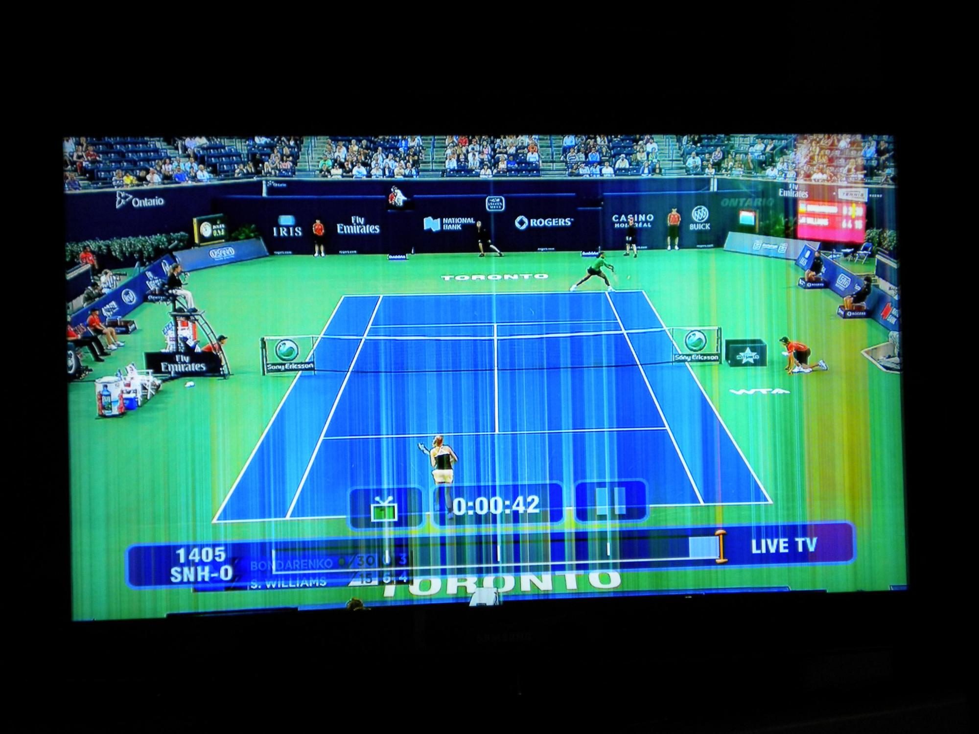

                            ok...so I have replaced the main controller board and the TCON board with the same results. The lines follow changes in the signal. Some areas of the display are perfect and others have these streaky lines in them. They are somewhat random at least as much as location goes so this doesn't appear to be a board or display problem from what I can tell.
                            I can order new caps for the power board but before I go through that exercise could bad / marginal caps affect the board like this? The picture in post 29 is a good representation of what happens.

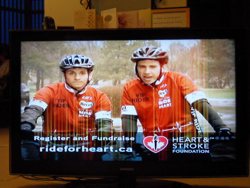

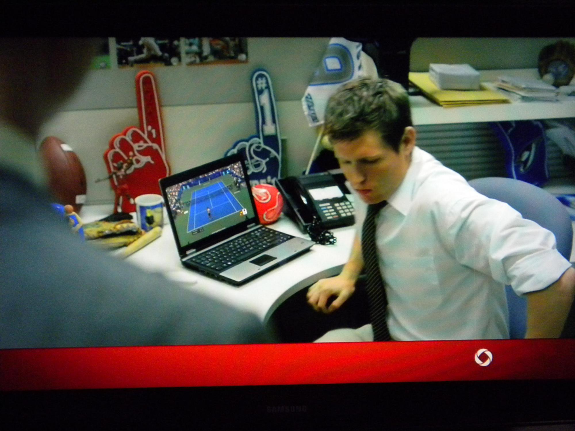

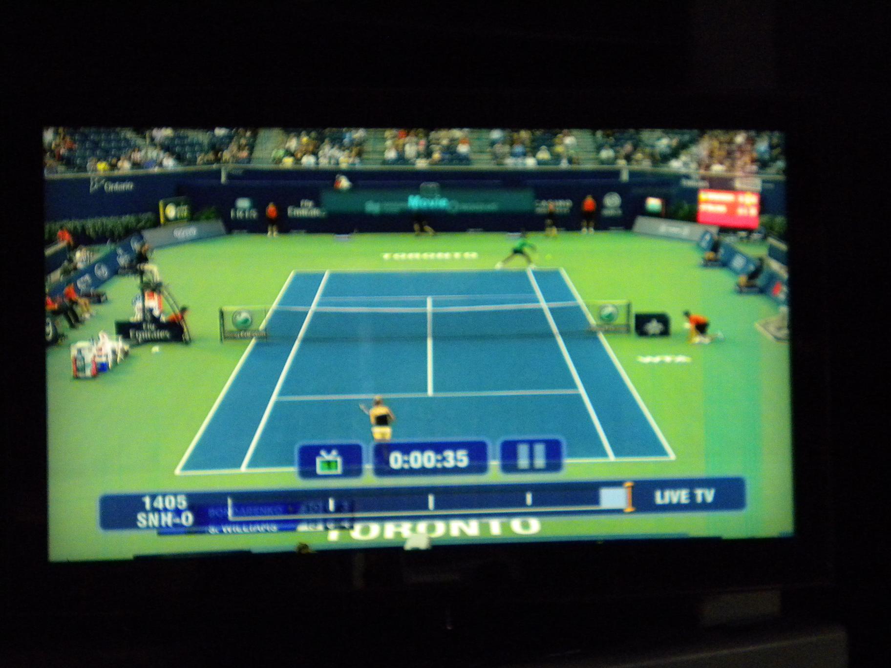

                              I wanted to post again since I am hoping that there is some advice or experience that can point me in the right direction. This TV has the TCON board, the main IO board and the power board. Based on advice from here, I have replaced the TCON and main IO boards as well as replacing the caps with new Panasonic low ESR ones just to be safe (no signs of issues).
                              The TV is essentially the same where in many images lines will appear and seems to focus on red images for the most part. I can get images that look perfect and I can also change the effect by selecting different display modes. The following are the same image with changing modes...the movie mode is the blurry picture but it also minimizes the effect most.
                              I have gone in to the service menu and reset to factory defaults but I haven't adjusted anything else. It seems like the TV is capable of working properly so I am stumped by what to do next...suggestions?
                                I think you have a bad panel. I have seen this before on certain JVC and Sony models.

                                        I went through the same steps replacing the TCON and main IO board as well as re-capping the whole thing...no effect. The issue is with the panel. I sold it to a guy on Kijiji that said he knew how to fix it. I said good luck to him and moved on.
