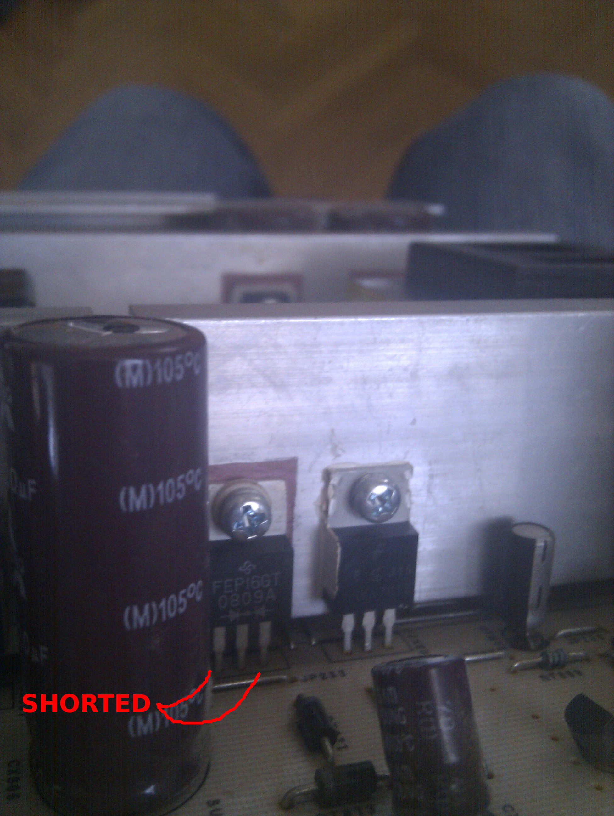

                  So, some new measurements here. I checked the 3 leg rectifier diodes in diode mode and I get a beep and a 0 reading when I check between the outer pins as marked on the image. From what I understand about SMPS designs those two pins should come from different rails on the transformer output and should not be shorted. Otherwise it could've been just a normal, fast diode. Can you tell me if I'm correct in concluding that those rectifier diodes are shorted?

                    Re: Samsung 50" plasma PS50Q97 with a dead main board
                    No, they are two anodes in parallel, in every TV circuit I've seen them being used those pins are always shorted by the trails on the PCB.
                    The correct way to determine if there's a short is to measure between the middle and leftmost or rightmost pin.
                    Do you have VS and VA when the clicking occours?

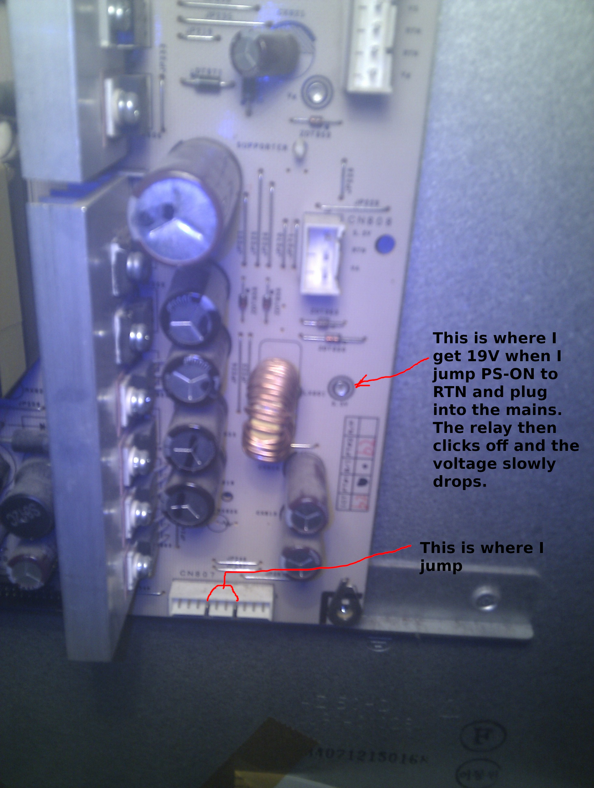

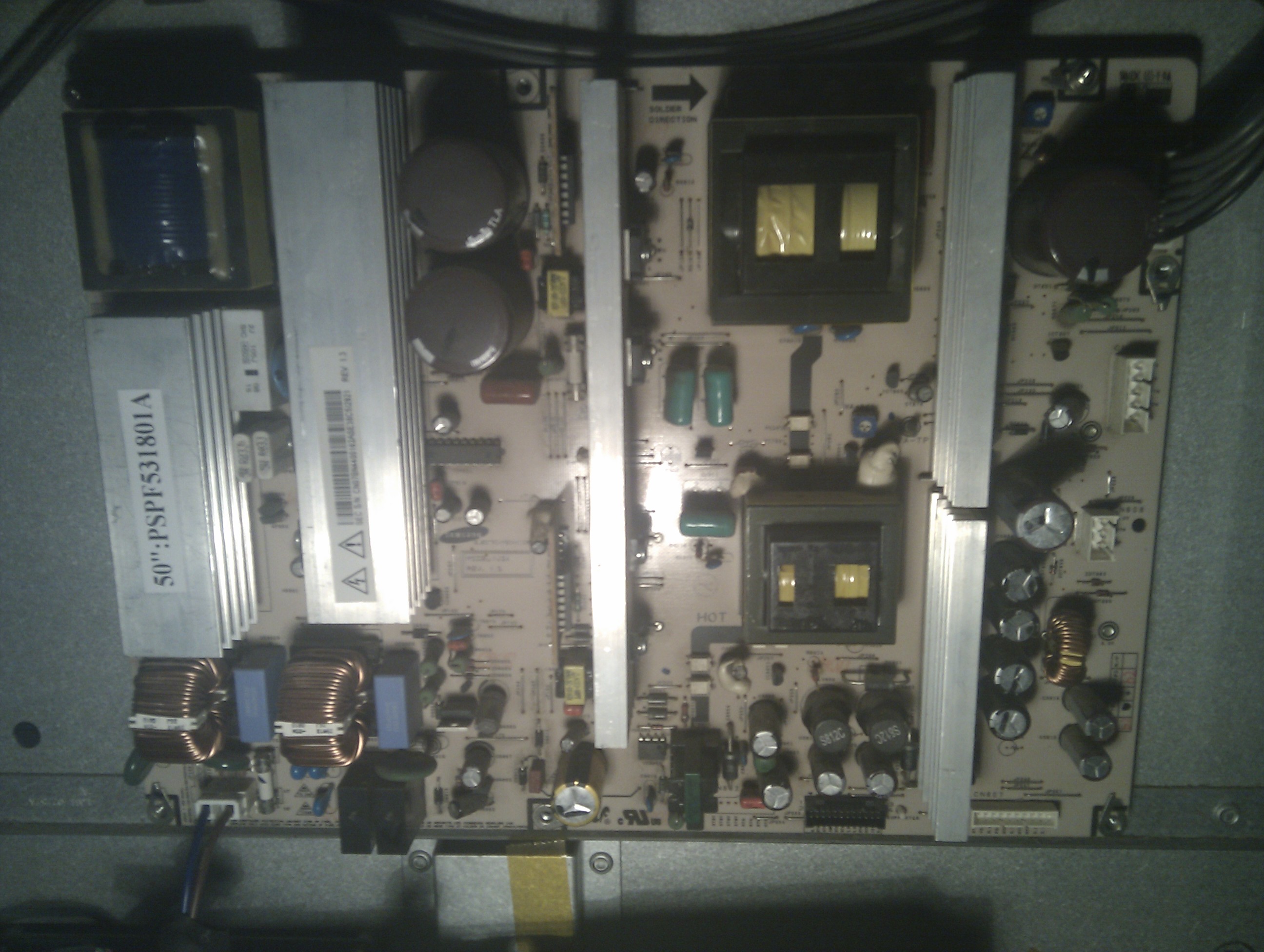

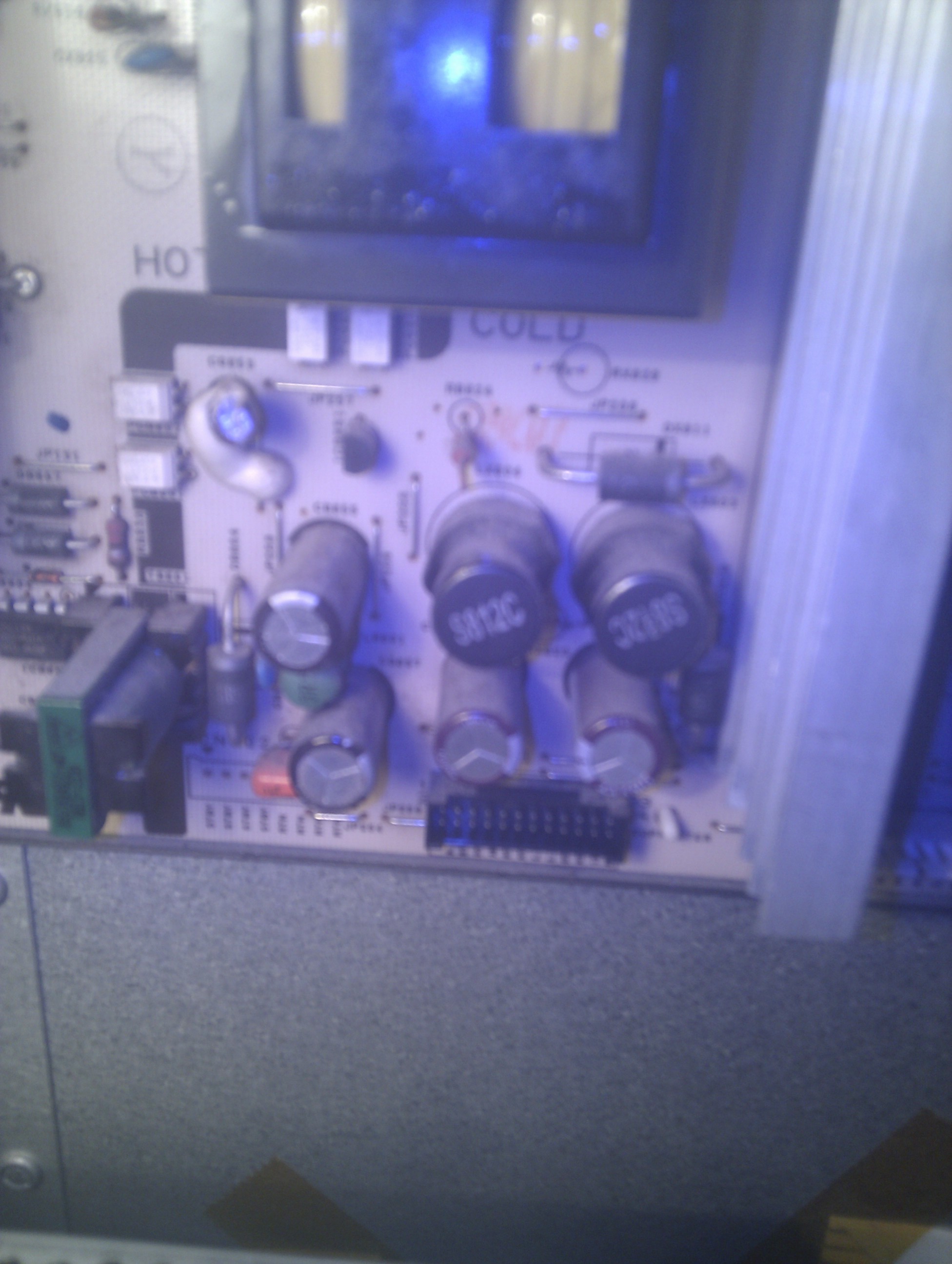

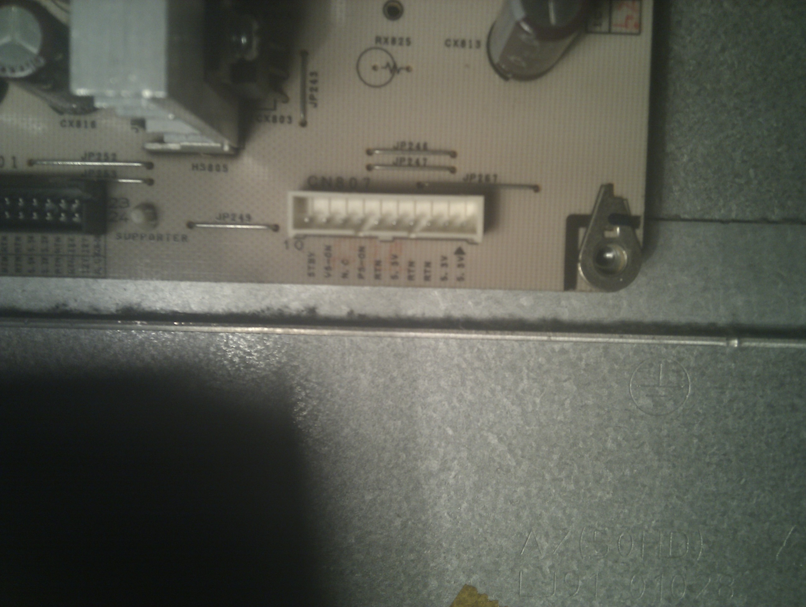

                              How does my 5.3V rail jump to 19V on power on???
                              So finally I got about to measuring things properly. These are the voltages I took from CN807 when the PSU is plugged into the mains and nothing else:
                              STBY : 5.11
                              VS-ON : 0
                              NC : 0
                              PS-ON : 4.19
                              RTN : 0
                              5.3V : 1.74
                              RTN : 0
                              RTN : 0
                              5.3V : 1.74
                              5.3V : 1.74
                              The 5.3V test point also gives 1.74V
                              Now the interesting part is the measurement I got when jumping PS-ON to RTN and taking the measurement at the moment I plug into the mains.
                              My 5.3V test point jumps to 19V and then slowly drops off after the relay clicks off. How does my 5.3V rail get 19V on it? No wonder the mainboard I plugged into this TV burned out. I hope nothing else got fried from this.
                              New pictures attached.
                                The mainboard doesn't receive the 5.3V signal, that's for the logic board, only 5V/18V/12V.
                                Trace that 5.3V on the power supply to see what's wrong with it.
                                I'll be uploading a service manual which is useful in this case, pages 71 and 72 show all the connectors and their pinouts.
                                    https://www.amazon.co.uk/CLICKING-Sa.../dp/B00H97REEM
                                    Found a repair kit that also list the defective parts for "psu clicking", that may be your fault. And I have a schematic for this PSU too, page 4, good for troubleshooting this 19V in the 5.3V rail problem.
                                    You logic board is probably the one who lit on fire if this 19V spike was happening at power up.
