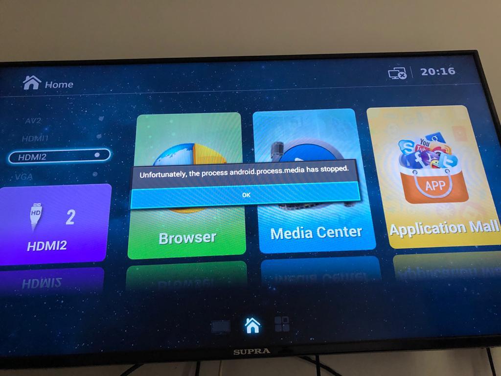

    hi i have a supra smart tv stuck on unfortunately android.process.media has stop. it shows this as soon as the tv start and only thing you can do is press ok but bring up the same message its completely stuck.
    normally some well know brand tv you could go to factory reset by pressing volume down and power on startup do go to recovery mode. but this one can find anything.
    anyone knows how to do a hard reset on IT . model is SUPRA SLED43CFHDSM1606.

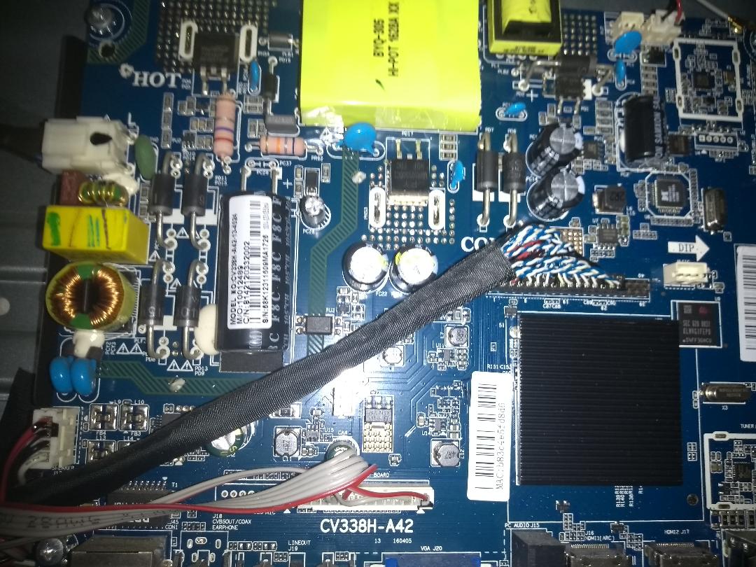

    Can you reload the firmware. Perhaps this site may be helpful.

      ok ill tried that. ive open it up just to confirm it has the same model board .
      but i see two file for supra, one supra dubai and the other doesnt have anything how to know which one is it?

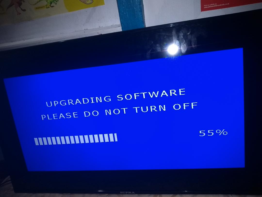

              Re: supra smart tv stuck on unfortunately android.process.media has stop
              I downloaded the correct supra firmware from the site provided https://www.kazmielecom.com/2018/10/...-download.html . on the board i found the info to which firmware i needed to download
              1.extract the Ctvupgrade.bin file to a usb drive after download
              2.connected the usb drive to the tv and power it up
              3. you will get a blue screen software updating after update is finished the tv will shut down
              4. remove usb drive and power up tv again it will take a while to load then should take you to a welcome setup wizard
              then thats it new again
