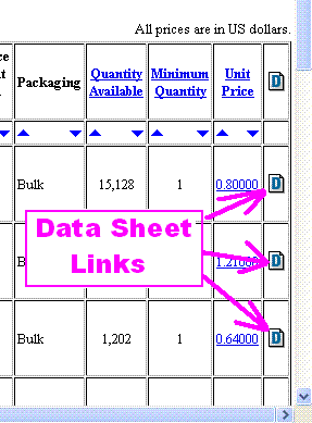

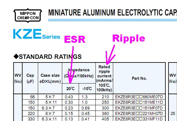

                                The aluminum caps I see in the Digi-Key catalog do not show any ESR rating.
                                Ripple should be the same or higher?
                                Please recheck your post.
                                • PCBONEZ
                                  Grumpy Old Fart
                                  • Aug 2005
                                  • 10661
                                  Re: Swap a 1000uf 10V for a 1500uf 16V
                                  You have to read the data sheets.
                                  See pics. That should explain it.
                                  Yes, Correct.
                                  Ripple is a -Max Limit-.
                                  Nothing wrong with a higher limit in a replacement part.
                                  Using a part with a lower limit than original could be REAL bad.
                                  It is correct.
                                  And before you ask...
                                  At 100kHz the ESR = Impedance
                                  [Or at least it's so close we just say it does.]
