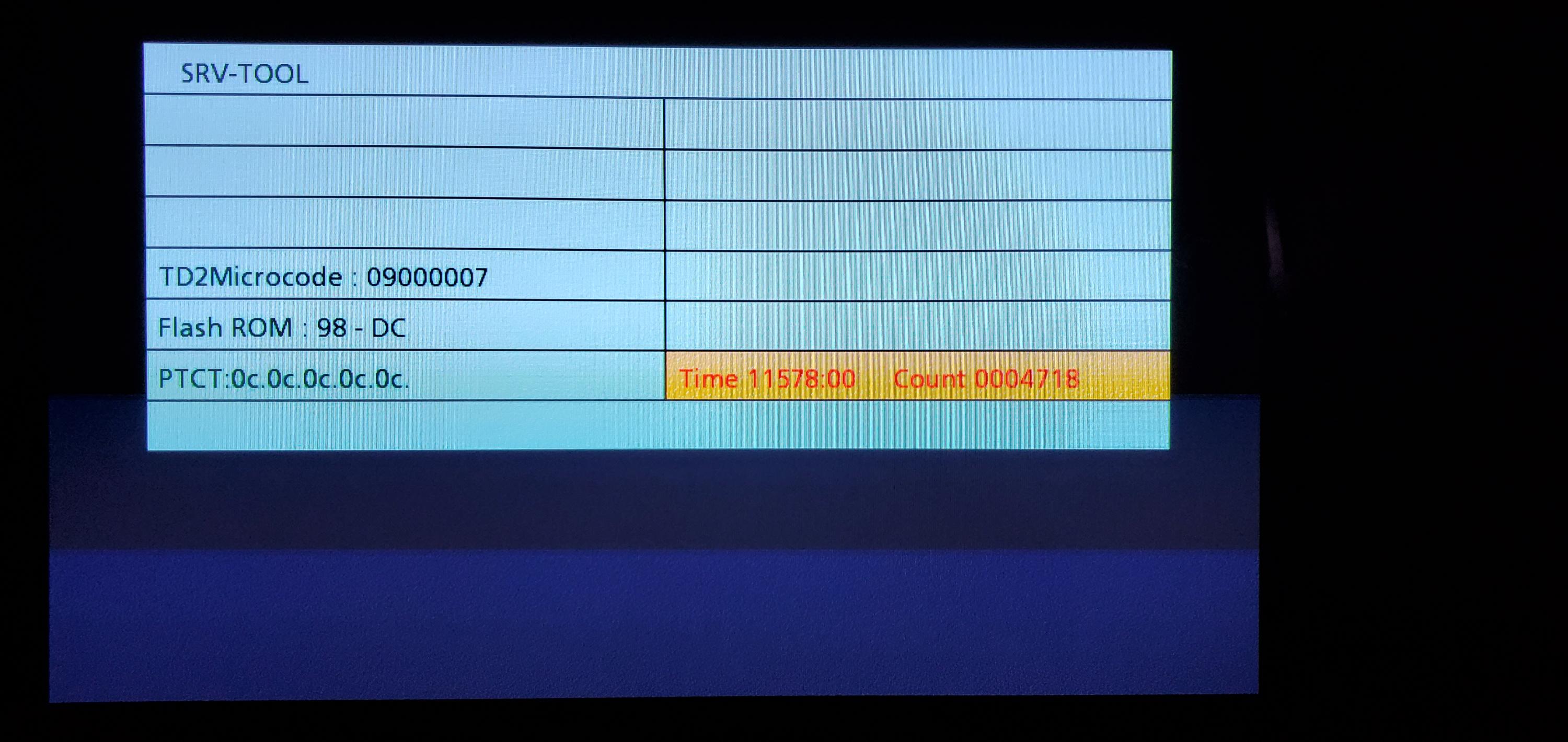

    I have a 55VT50 that turned off and started blinking 12 times. I unplugged the speakers from the A board and turned it back on and everything worked great.

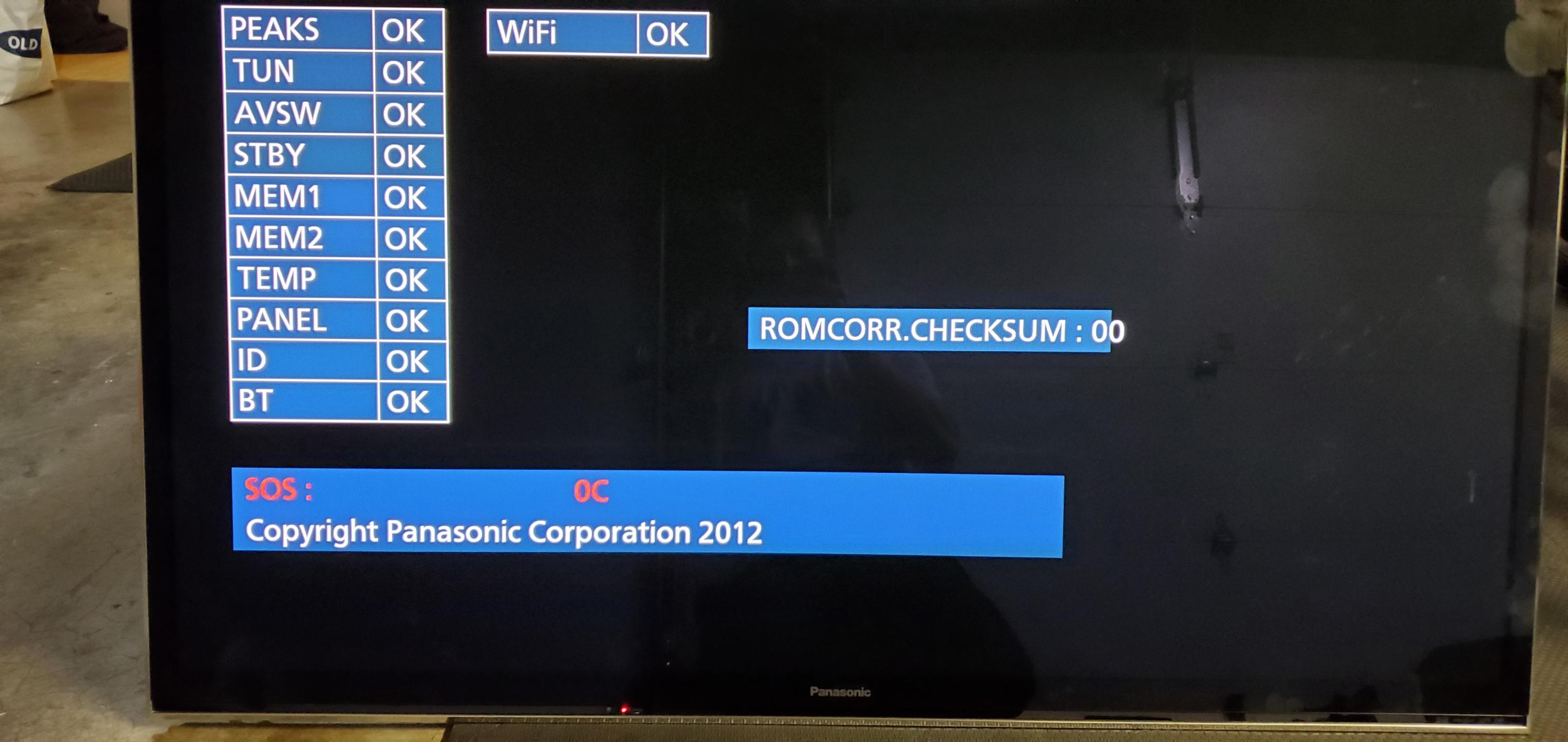

    Few years go by and now the TV will randomly turn off after about an hour and will blink 12 times. I went into the service menu to check any issues but I don't know what any of it is or if it shows any issues. Here are some pics.
    I'm assuming I will need to replace and fix the A board but wanted to check here first. Any help or guidance is appreciated. Thanks!

    I'm not 100% sure about this but,
    SOS: 0C
    0C hexadecimal is 12 decimal, so I think it refers to the error code which ties in with the blink code you see on the front led.
    Found this regarding blink codes but do not know if it's applicable to your model.
    Panasonic TV Blink Codes for All Panasonic Models

    12blinks Sound SOS H Board
