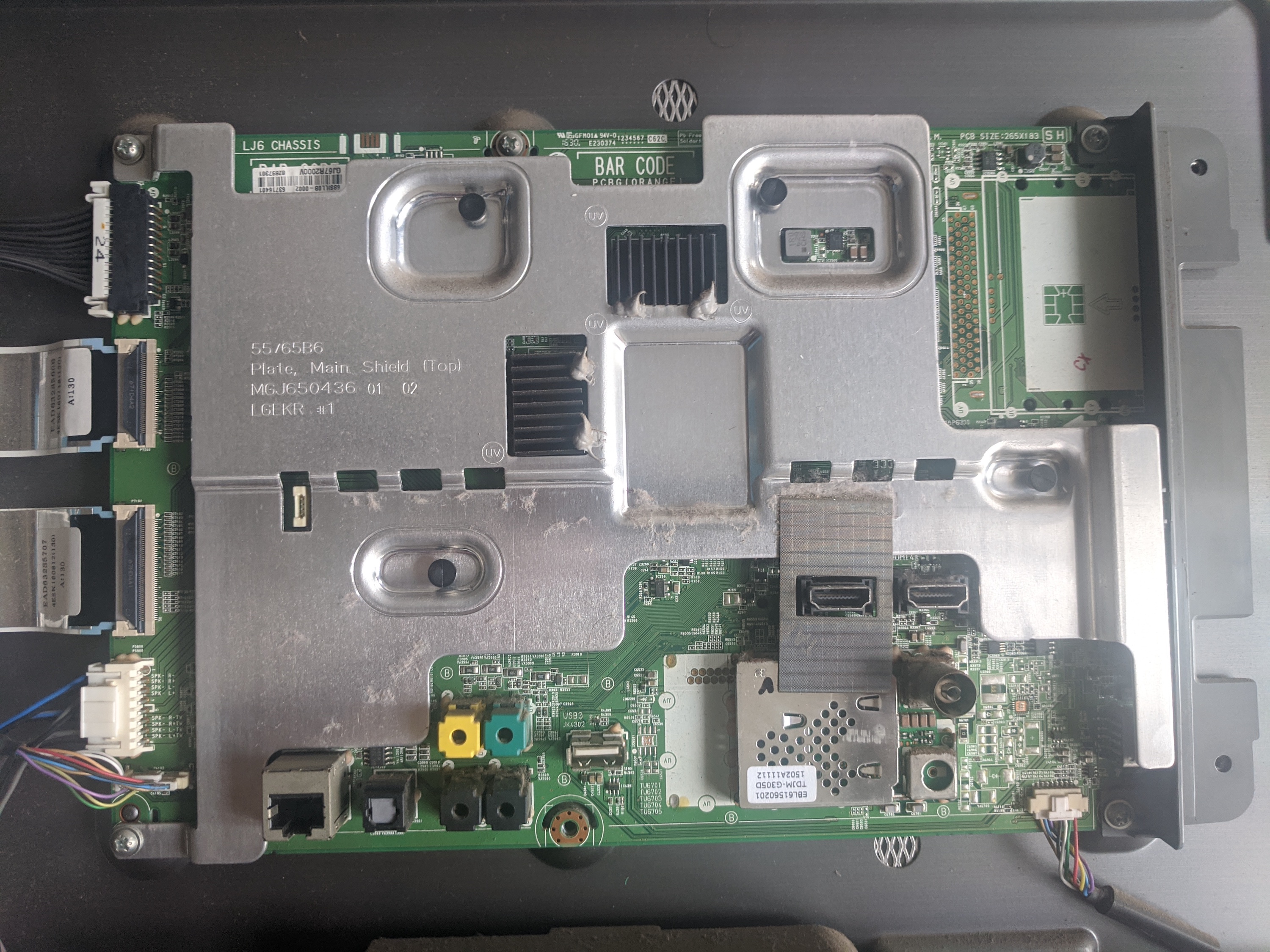

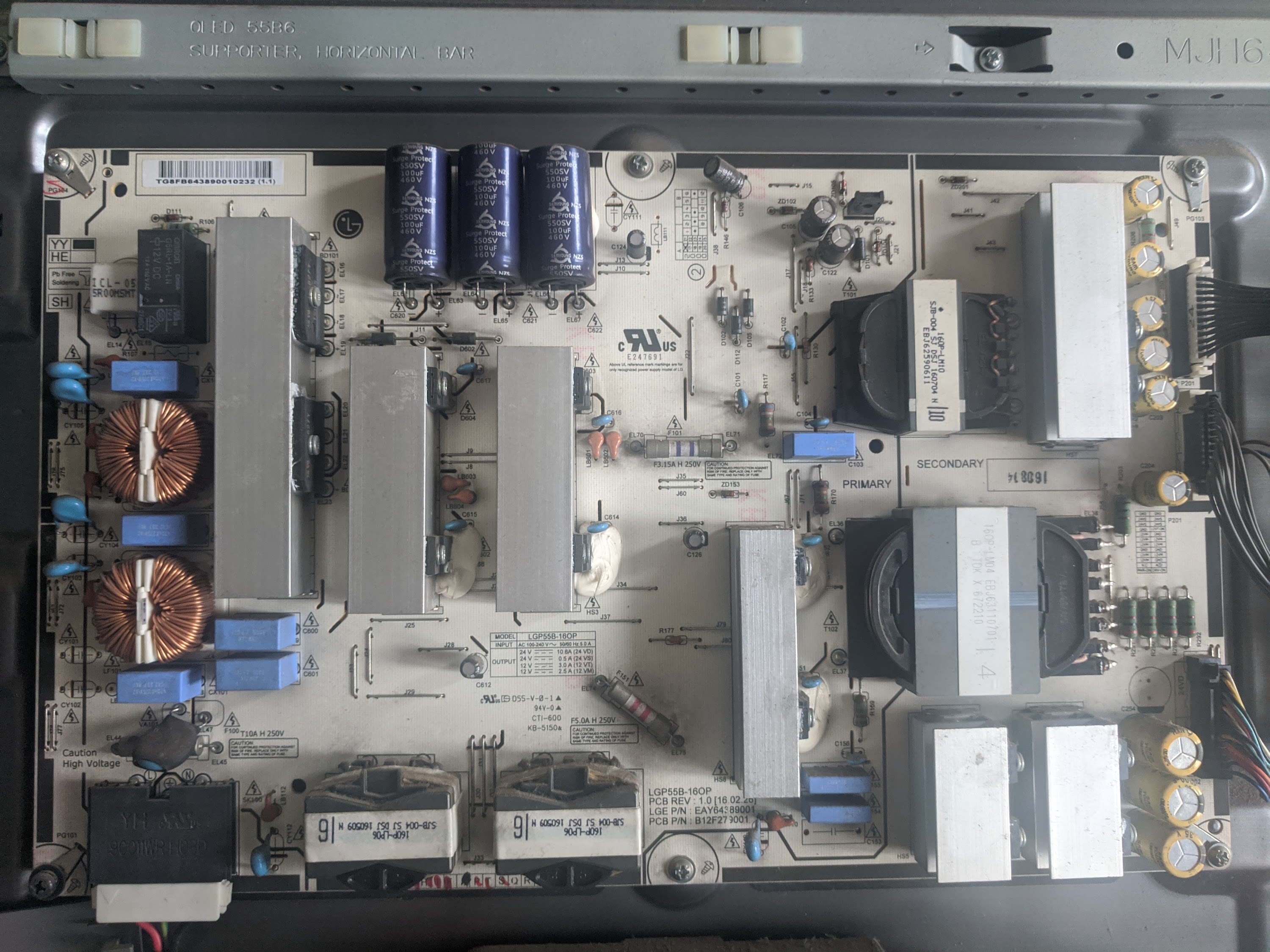

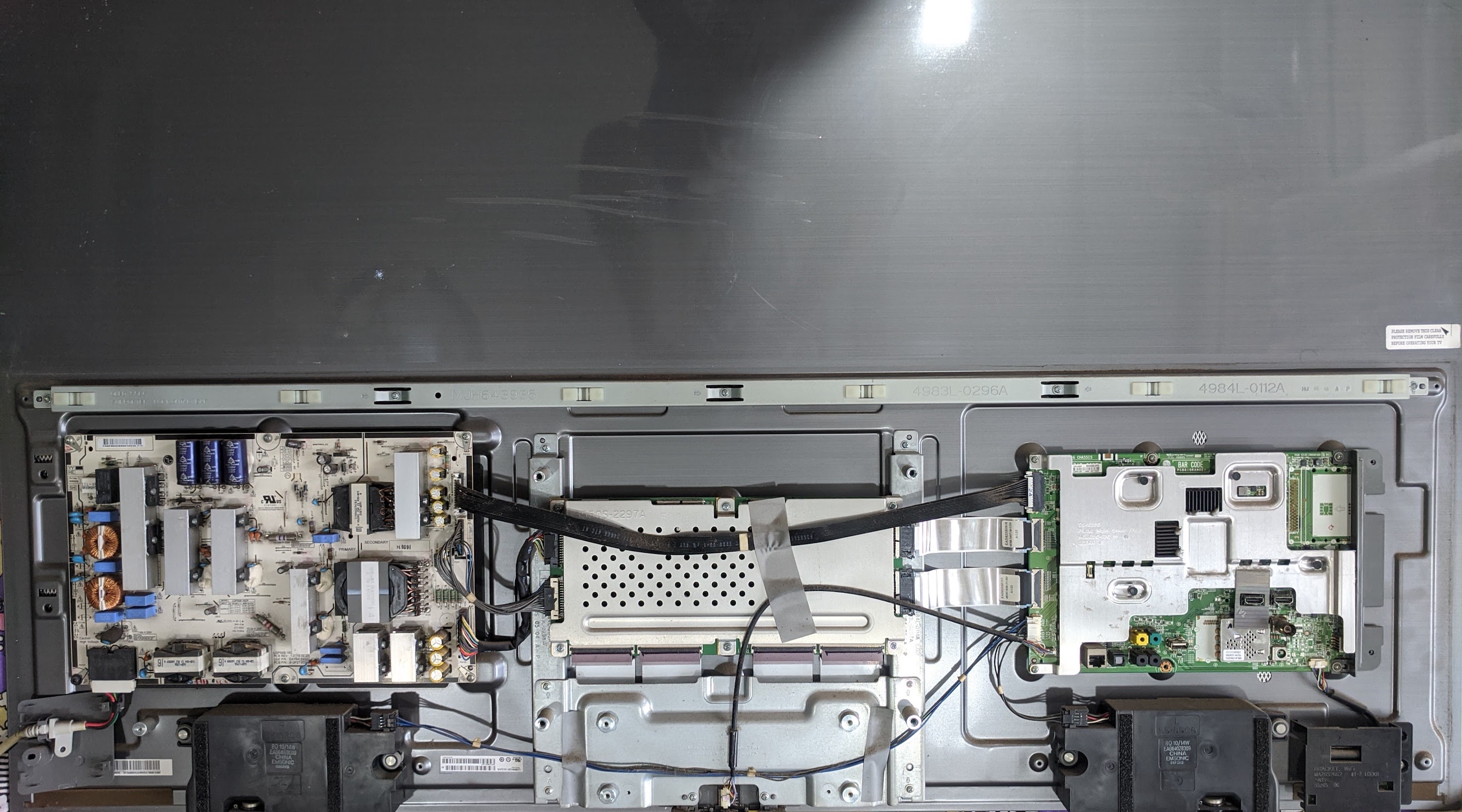

      Re: LG oled 65c7p-u
      Can you post some good straight on pictures of each board and one of the whole back so we can see how they are connected, post m here, just hit go advanced and manage attachments.

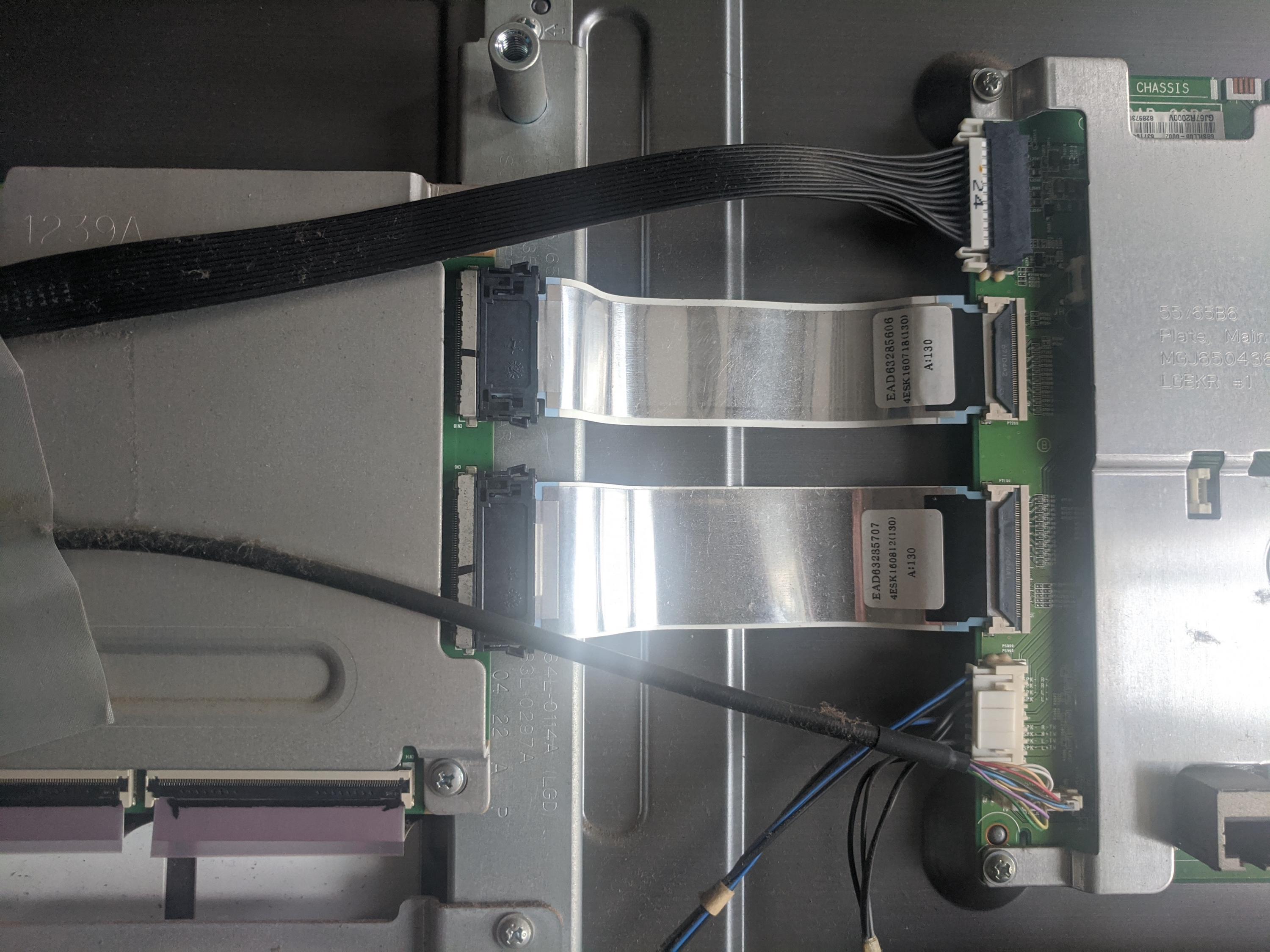

          Re: LG oled 65c7p-u
          Originally posted by dalack
          Hi Everyone
          I have replaced the main board and power supply but same problem.
          C7 C8 LG OLED suffering from cheap LVDS & ribbon cable.
          1- take out the 2 LVDS from MB to T-CON Panel driver and inspect them under loop. specially the area where it connected to MB side 2-8 mm forward to the T-CON you could find burn point or broken line
          2- the 4 Ribbon cable going from T-CON Driver to OLED panel.. do same way and give attention to the OLED side all of them.. any changing at color clean them with alcohol same to LVDS.
          4- inspect both LVDS & Ribbons then clean .and reset them carefully as they should then turn on.

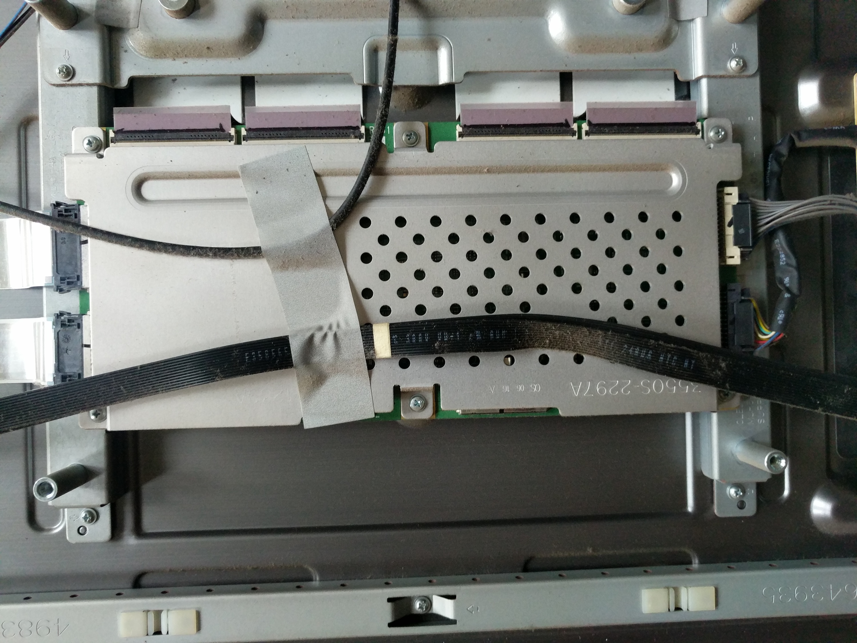

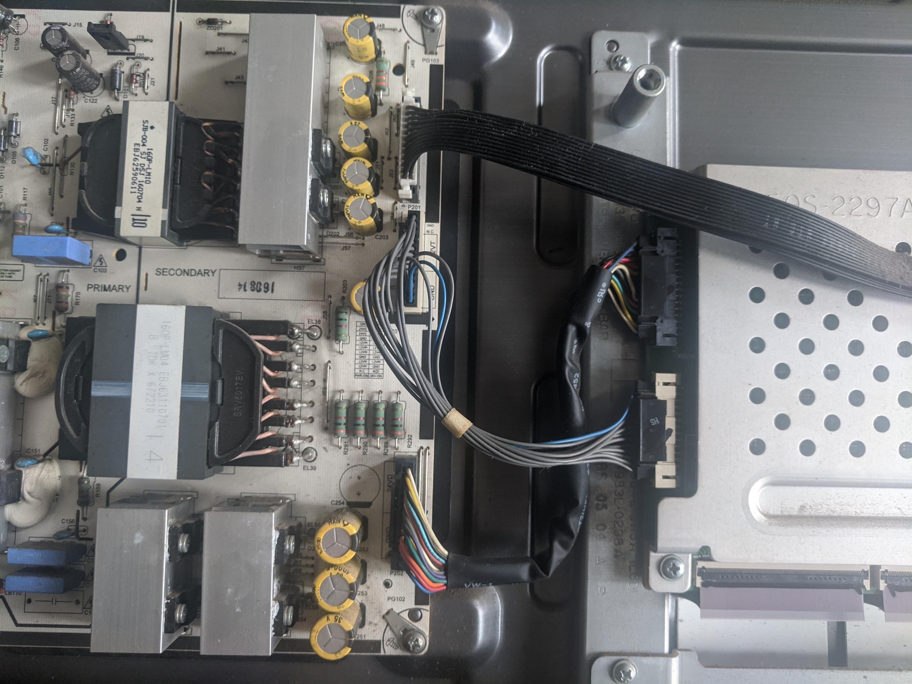

            Re: LG oled 65c7p-u
            Have similar issue on my OLED55B6 https://youtu.be/paHY_MLtHdQ
            this happens while on home screen too, screen goes blank intermittently, sound and remote keeps working fine. This got worse as time passed by, these days screen just remains on for short period. attached boards and connectors images.
            mainboard and power board seems ok as PWR_ON DRV_ON 12VT_ON control signals from MB and 12VT, 12VM, 24VS, 24VD power outputs are working as expected.
            Have detached and reattached most of the connecters except PANEL to TCON and LVDS MB side connections, for LVDS MB side, do i have to open the locks from left to right upwords?
            Haven't opened TCON heatsink yet, but if i open it what all things i can check? can this be PANEL/TCON/MB issue? also are newer MB like C9 compatible with this TCON? or whole set of C9 MB+TCON+PWR will work with this panel?
            Thanks in advance
