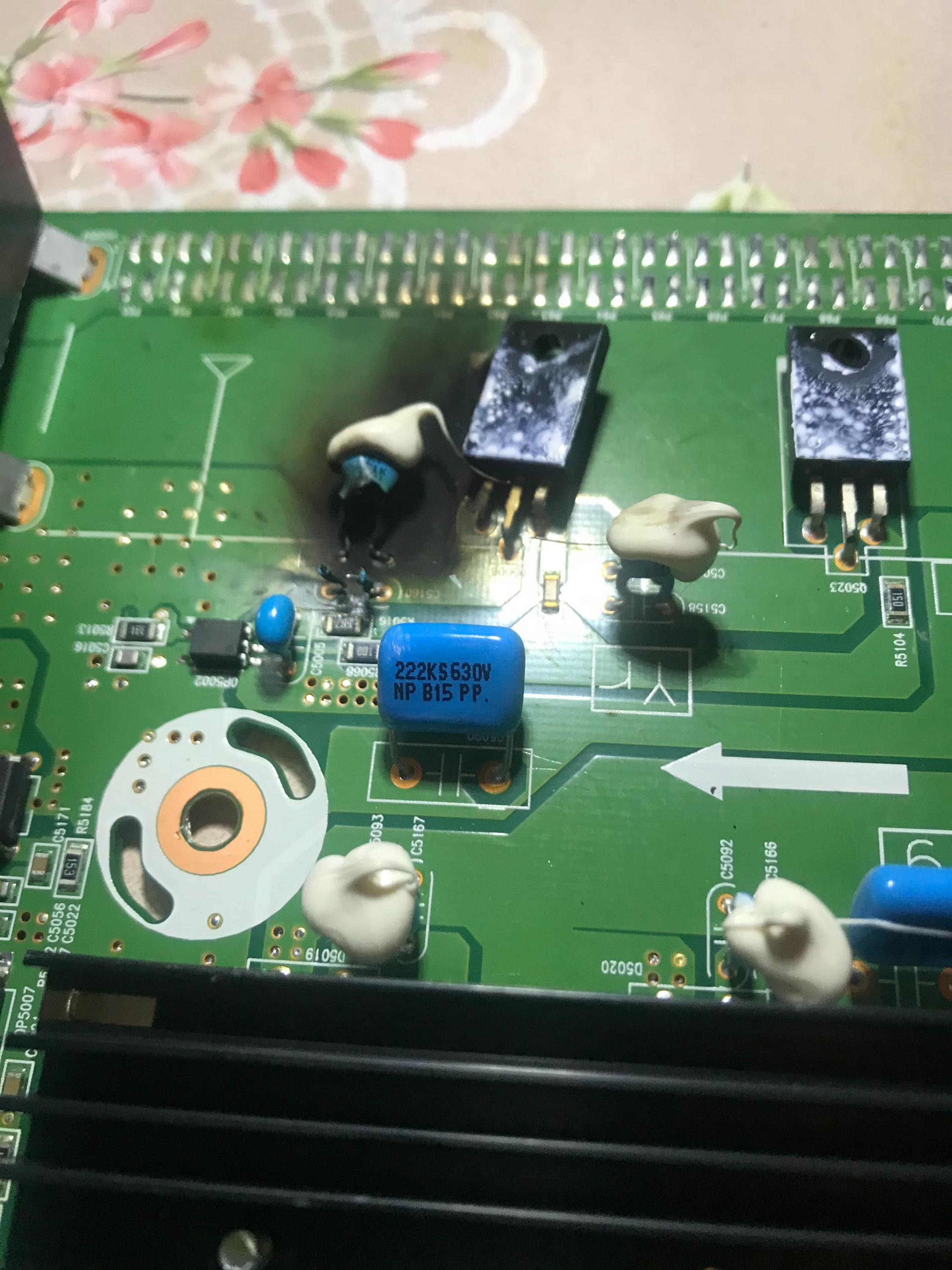

    Samsung lj92-01766a blown Cap
    I am new here and I hope someone can help me.
    I have a Samsung ps51d6900, that went Boom.
    After opening it up I can see on the Y board it has two blown caps.
    Well one is blown the other one is gone completely.(see picture)
    I have been searching for a couple of days now but can't find a schematic of the board and what the value should be so I can replace them.
    Can some one help me with this ?
    Regards
    Robbert

    Re: Samsung lj92-01766a blown Cap
    They are very likely the same as C5158, C5097, C5087, C5161 under the white silicone
      Ahh okay they are 331k 1kv !
      Thanks for the replay
        I would try to find them in the 2kv to 6kv for replacements.
          Ah okay I just ordered some with the same value.
          I will check if they sell them with higher voltage too.
          What could be the reason it blew ?
            I replaced the caps, and tried it again, but the standby light goes on and flashes 5 or 6 times
            but nothing happens, so I ordered a new board.
            But this has the same problem, so it should be something else.
            I checked all the boards but can't see anything, I feel the standby light is also dim.
            what print could it else be ? the Powerboard ?
