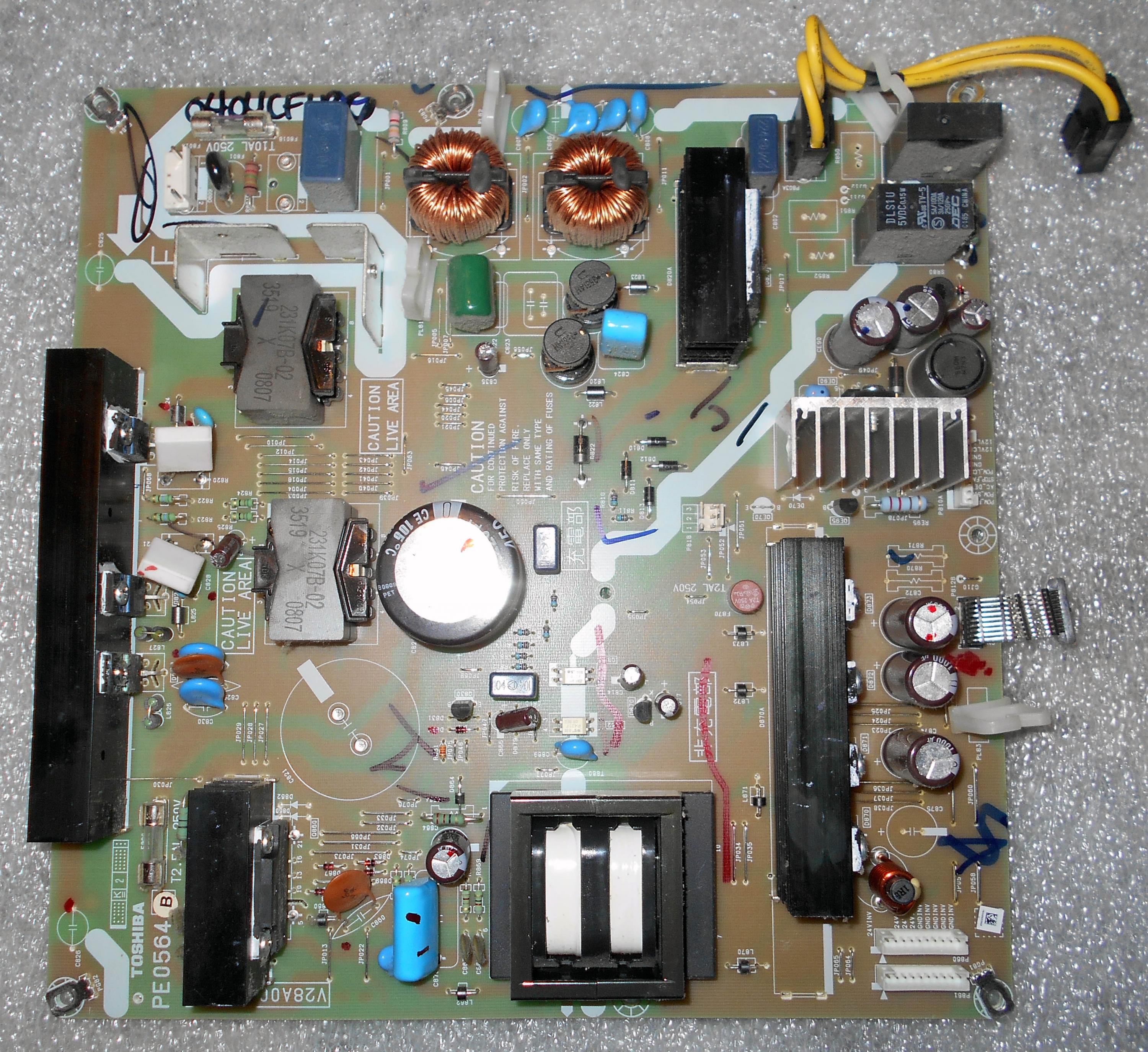

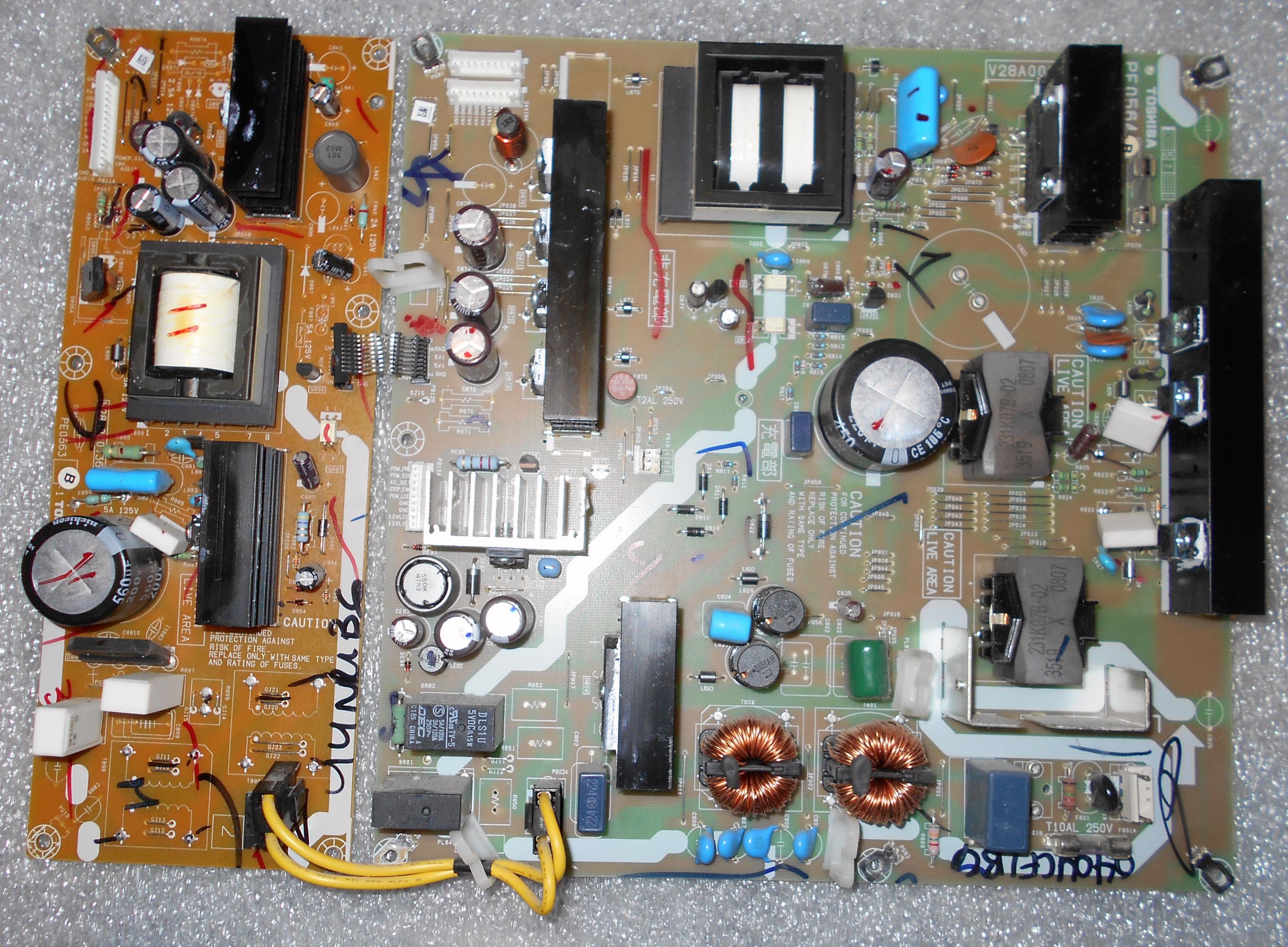

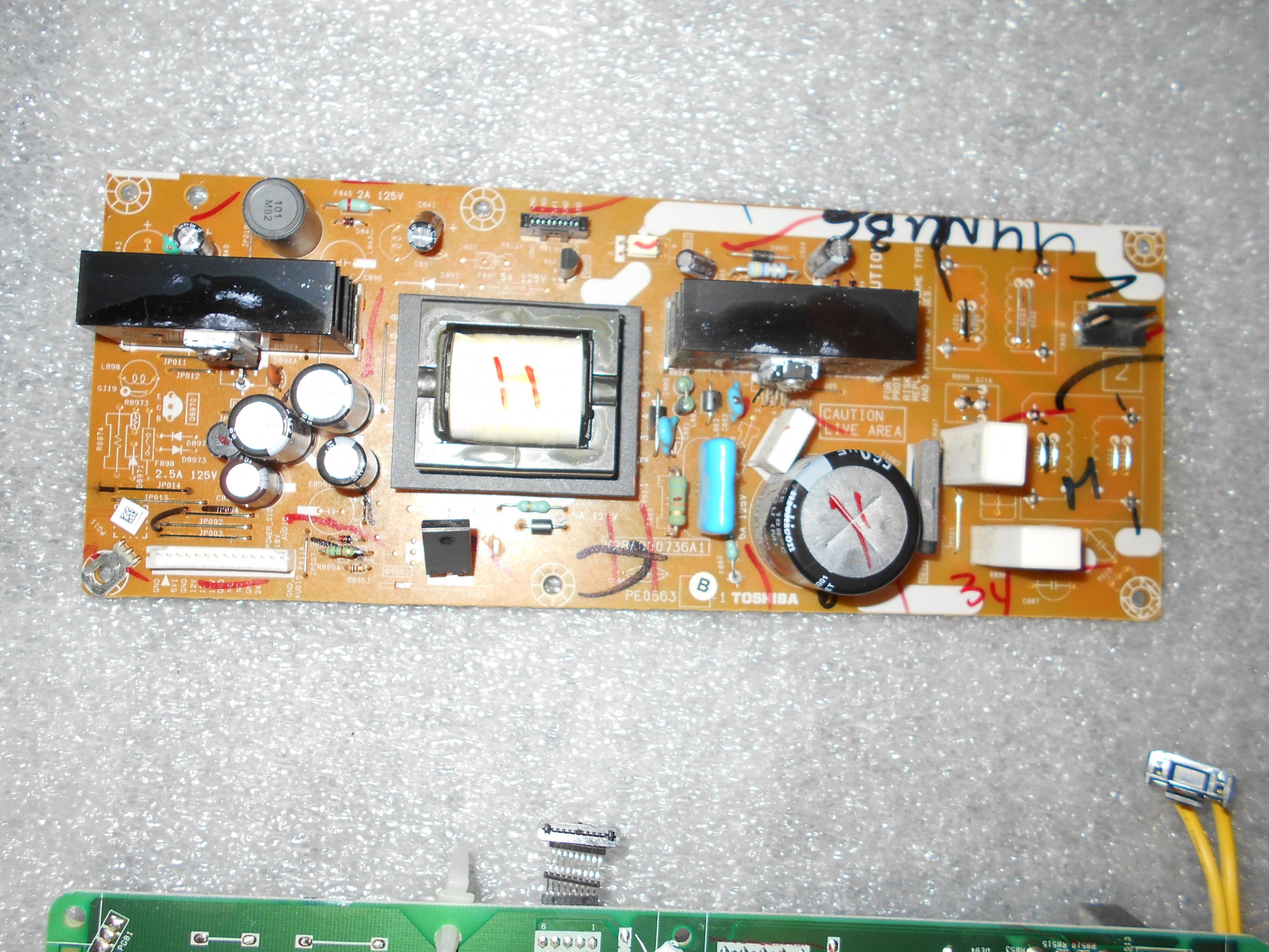

    Power system is conformed by 2 power boards interconnected.
    Bigger power board model#: PE0564
    Smaller power board model #: PE0563

    - Tested Fused Resistors R897 and R898 on PE0563 board and both are good.
    - Tested fused resistor R850 on PE0564 board and there was no continuity and 0L (open loop) when testing resistance ohms.
    - Removed R850 fused resistor and tested it out of the circuit, same results.
    - Already ordered replacement for this resistor.
    My question is, whatever blew this fused resistor may still be bad and the same thing can happen once the replacement is placed back in the circuit.
    Any ideas on what should I test next?

    R850 Fusible resistor will go open circuit if the bypass relay SR81 for the R850 has bad contacts which causes not to bypass R850 when TV is fully turned on, that is common problem.

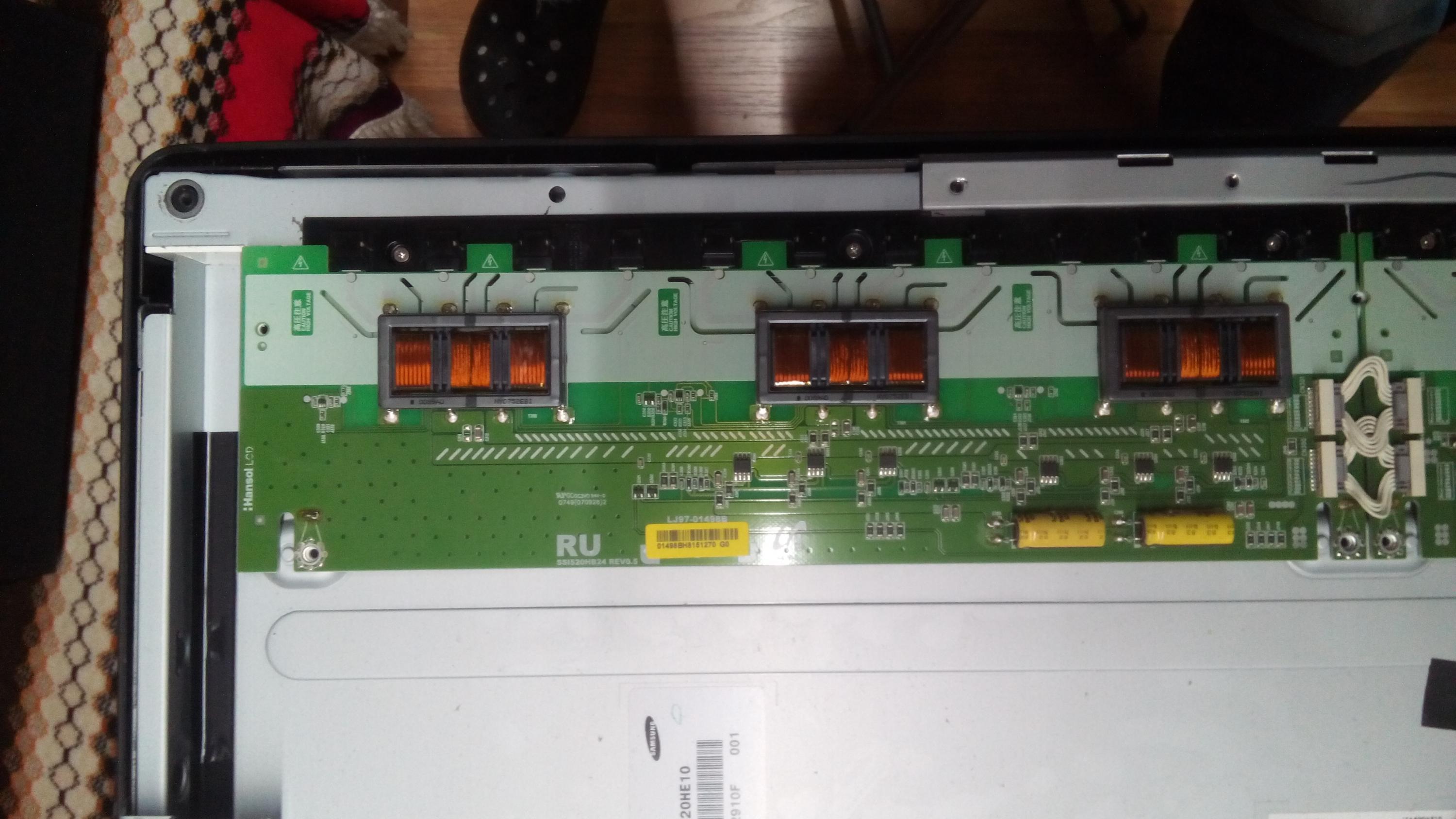

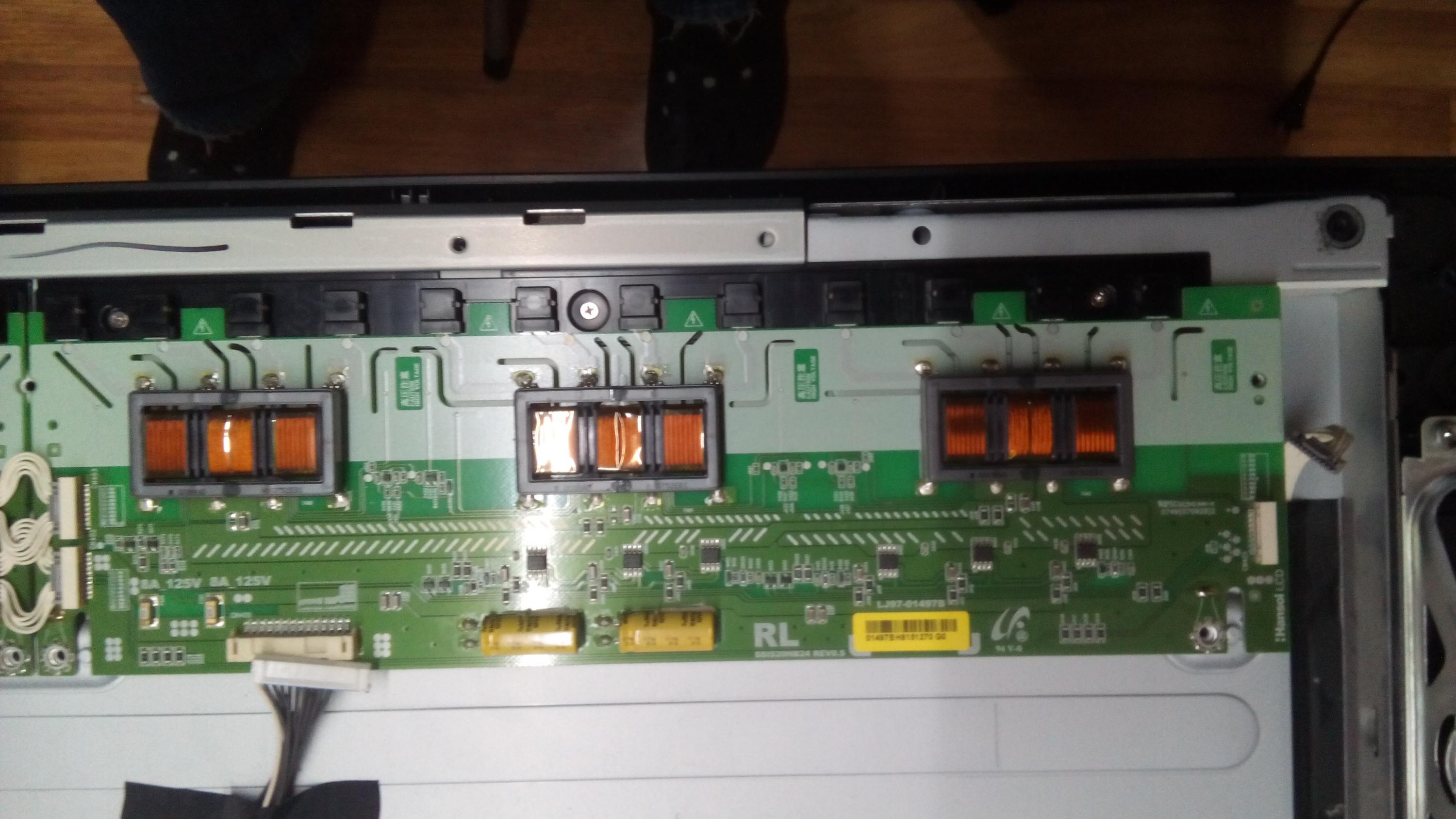

          Hi there,,
          I am new here and i have a similar issue: no light on a Toshiba 52XV540U
          I've checked all voltages and i found that the 24V going to the lights is not correct.
          Going forward, i disconnected the power inverter side boards lower connector (it goes to the lower lights?) and then i got 24V correctly, but still no light.
          I checked the transformers and in the back (towards the fluorescent lamps) they have continuity, but in the from the ohmmeter shows no continuity....
          Question is: they should have few k ohms continuity - correct?
          Posted the pictures.
          Please advise if i am correct. Tx.
