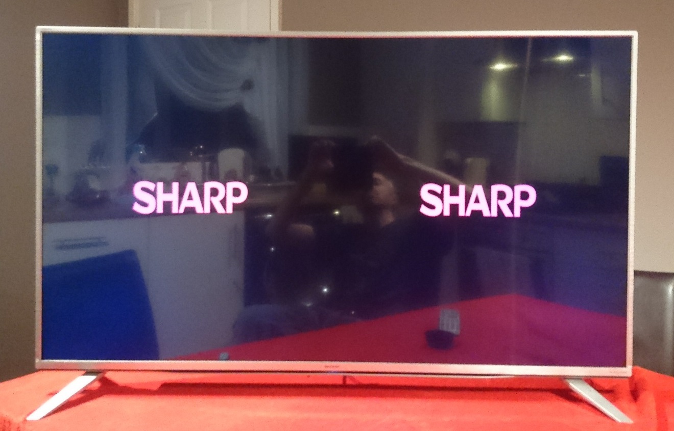

    Got Sharp lc-49cug8462ks with NO sound through the speakers.
    Sound is working fine on the headphones.
    In the TV menu can't change from HP to HP+TV.
    Any idea what's wrong?
    Thank yo very much for any support.

              • jczarniak
                • Oct 2015
                • 179
                Re: SHARP lc-49cug8462ks NO Sound through the speakers
                I downloaded the firmware from manufacturer website.
                Updated the TV.
                Got sound working now but got two pictures on the screen instead of one

                  Hmmm, try another factory reset maybe.
                  • jczarniak
                    • Oct 2015
                    • 179
                    Tried a few times.
                    Still the same

                      Makes me thing that that firmware is buggy, I would email sharp, maybe they will send you the firmware, hopefully they have one that works correctly if it is buggy that is.

                        Maybe try the firmware update with a different usb thumb drive.
