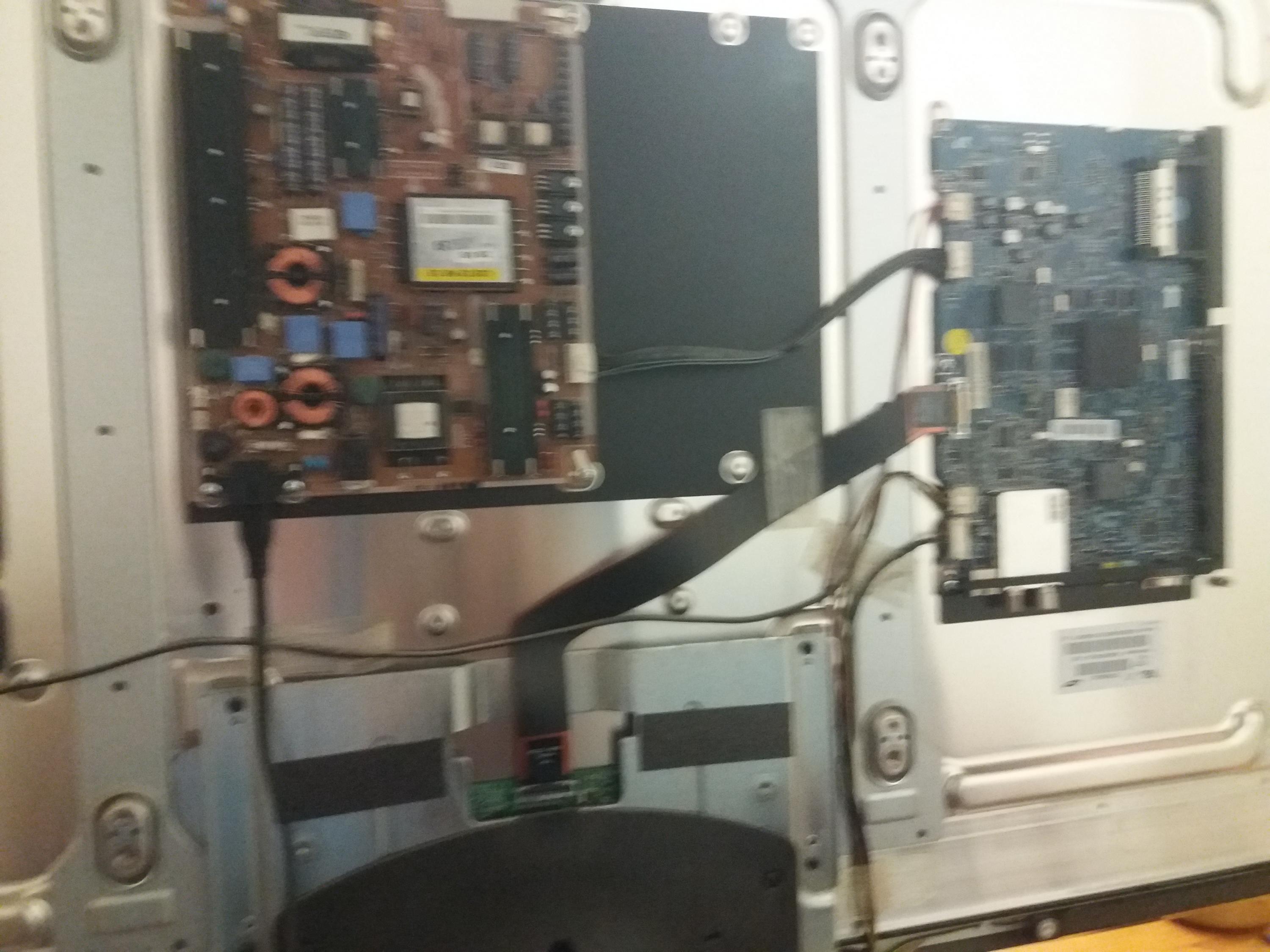

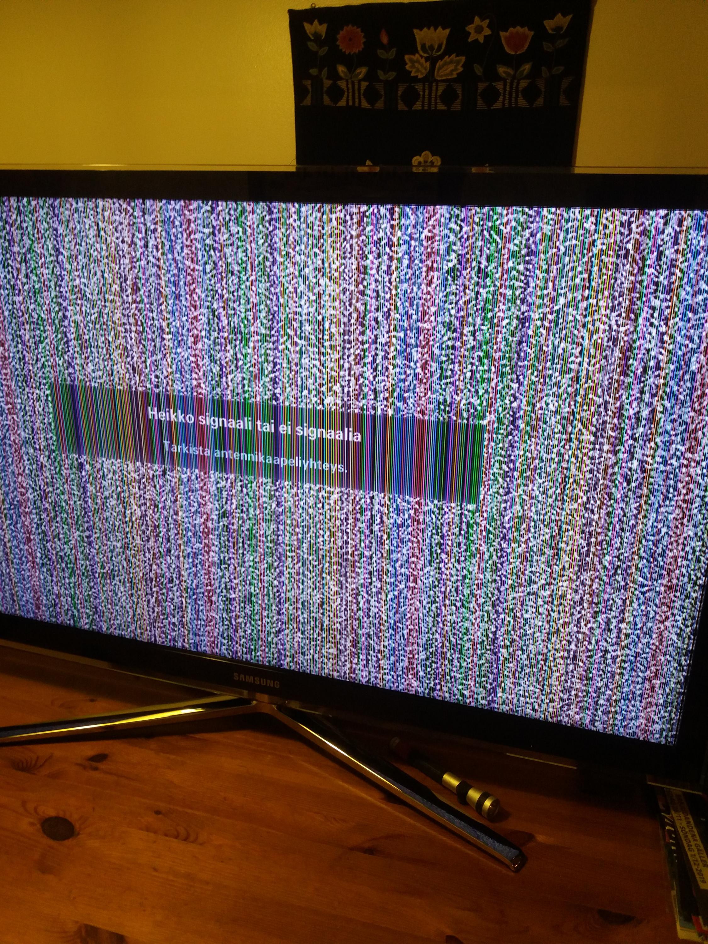

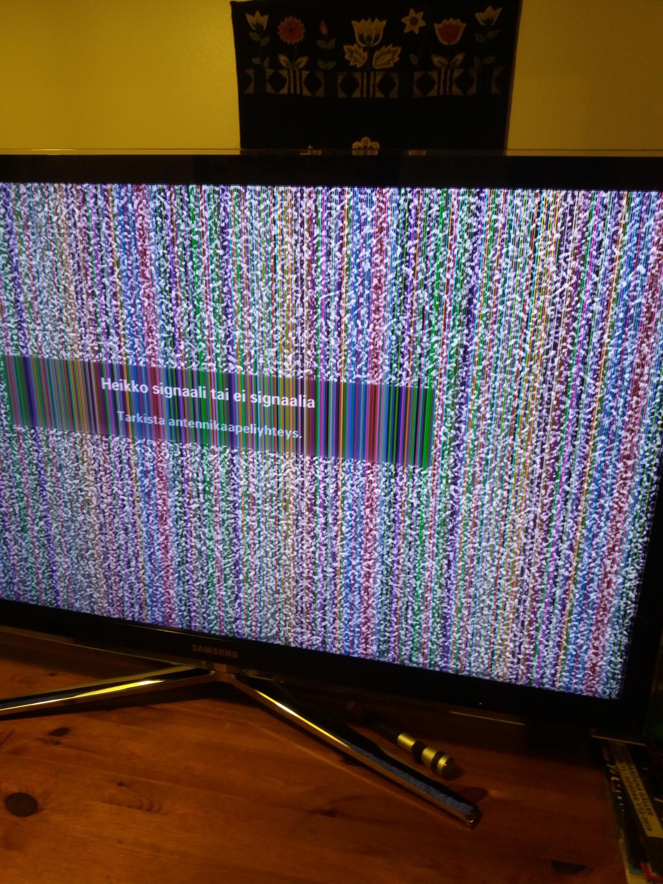

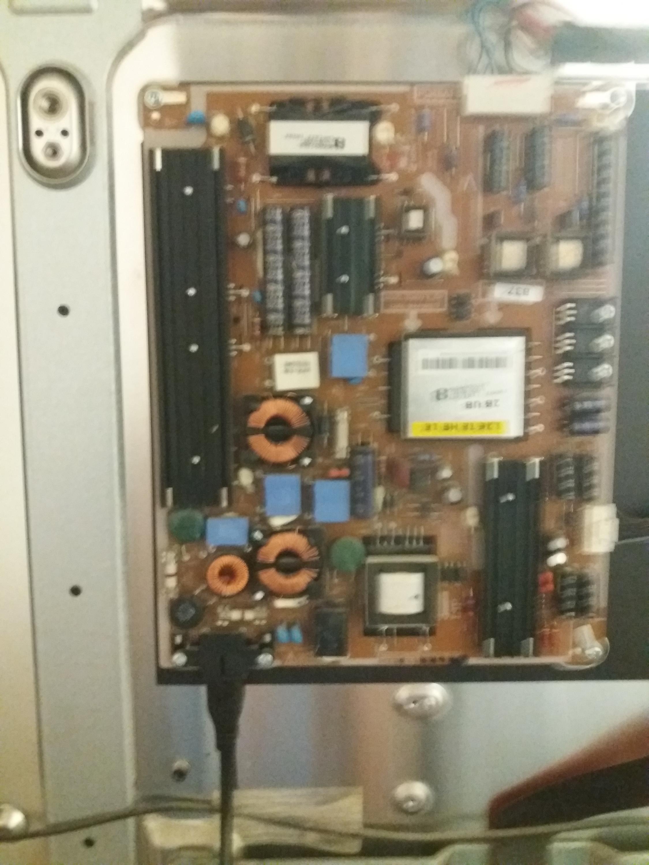

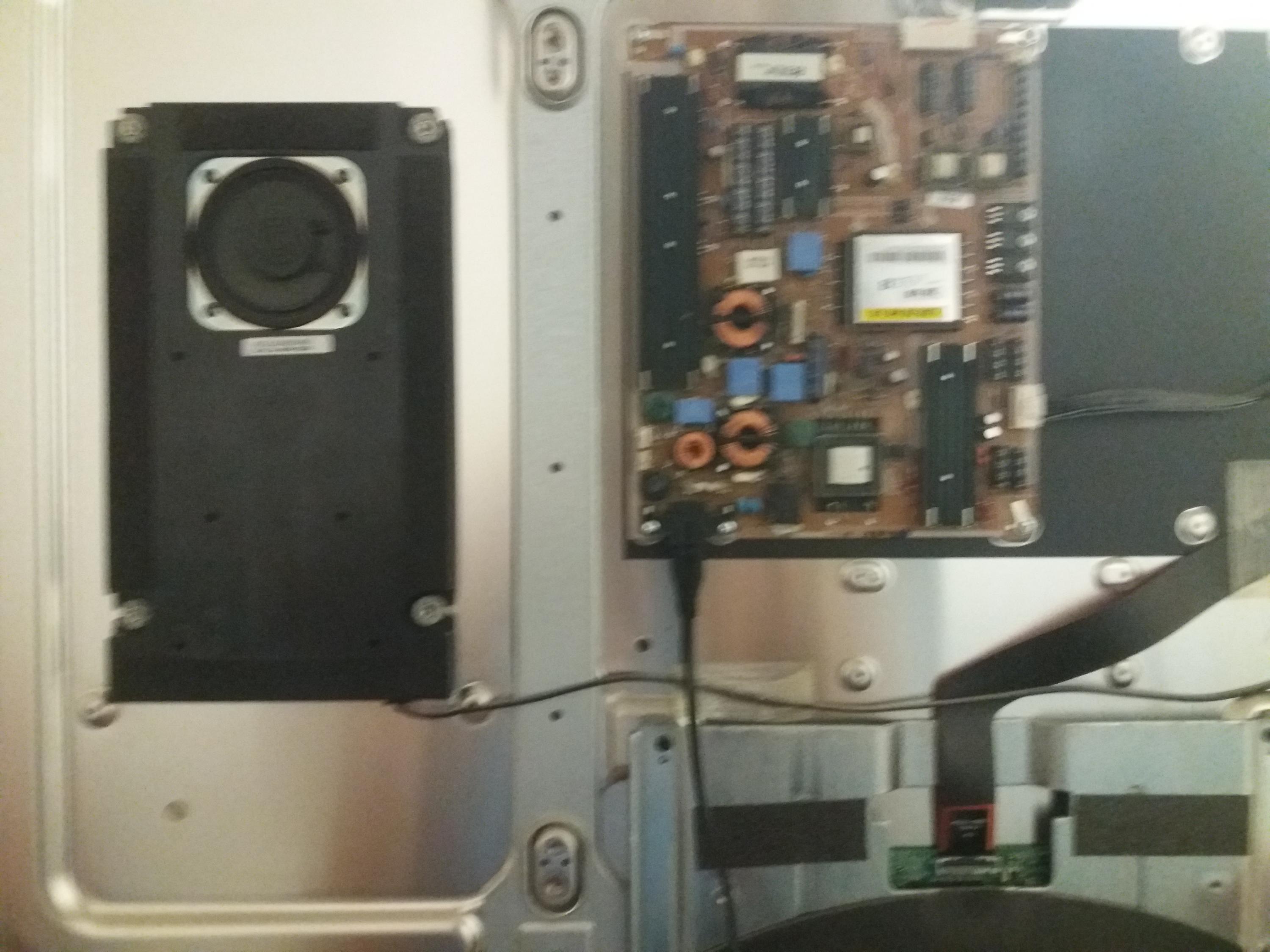

    Hi have a problem with this set as you can se on pics there is pictures and sound just those line over the hall screen any help thank you in advance

    Re: Samsung 46 model:UE46C675US
    Try cleaning the ribbon cables going from the tcon to panel and make sure the cable from mainboard to tcon board is clean and securely connected.
      hi thank you for a quick replay.i did but no changes but do there is a special way to clean or as usual tooth bruch and rubber thank you.if it wont work by cleaning where i shoold look the Tcon?
        Could be main board. Do the menus look the same ?
          Yes, looks like a BGA (solder balls) problem under the main processor or a ram issue.

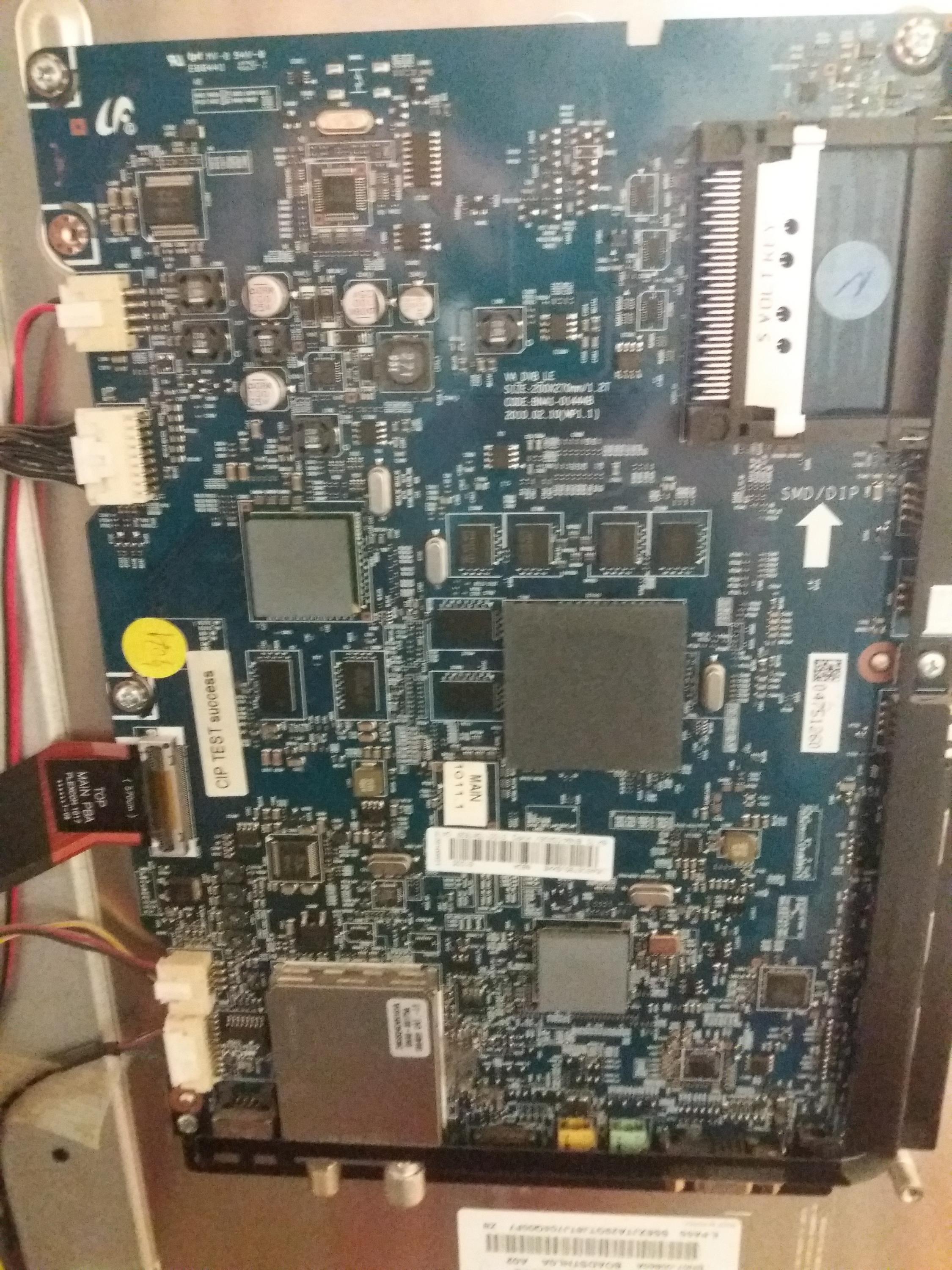

              Hi Diif woold you please explain it to me i am quite novice if you can point it on the pics or anything to help me thank you
                The bigger of the two squares on the mainboard. Under the heatsink is the main processor. Around it are 6 black rectangles, these are the RAM.
                It could be either the processor or piece of RAM failing or more commonly a crack/break with a solder ball(s) used for electrically connecting the many contacts to the PCB.
                You could try heating the area with a hairdryer to see if it makes any difference to the image.

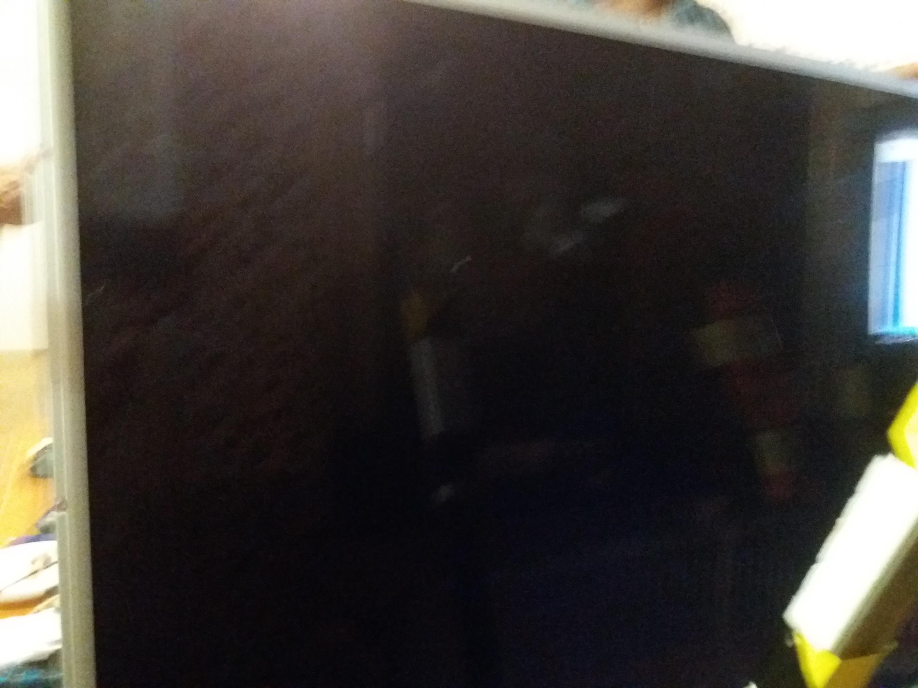

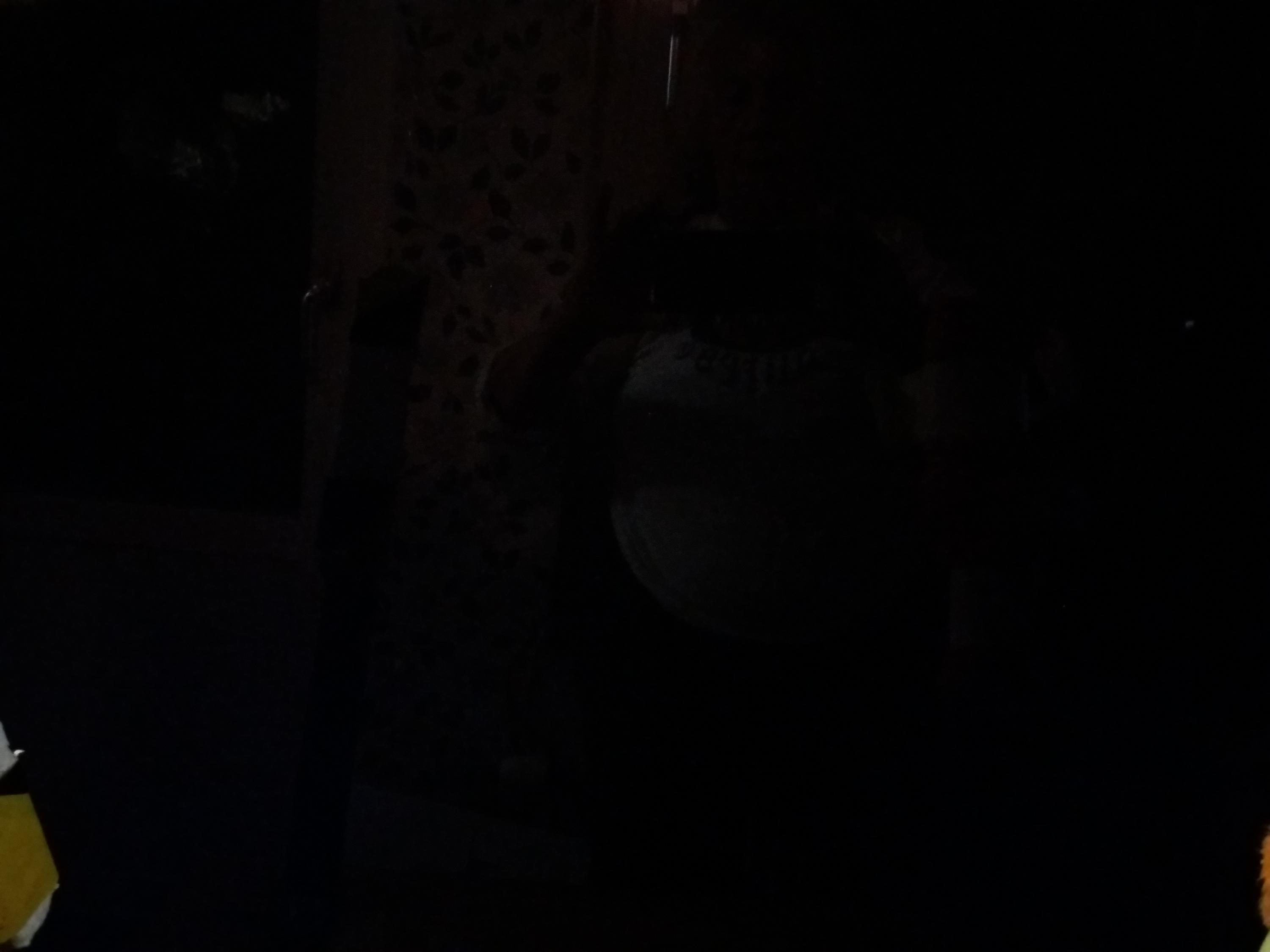

                                      Hello all of you.After foloweing some advices from mmartell to warm by the hair dryer
                                      the main process and the rams around and a goof kleaniing all the ribbons from T-con to main board and their connections i get this resolt compare to the start look at those pictures the first pictures it how was the problem at the begining the next two are after cleaning and warming with the hair dryer any idee where to look and if there is some solutions thank you in advances
                                        hi sorry i did miss the pictures here they are as you can se just black
