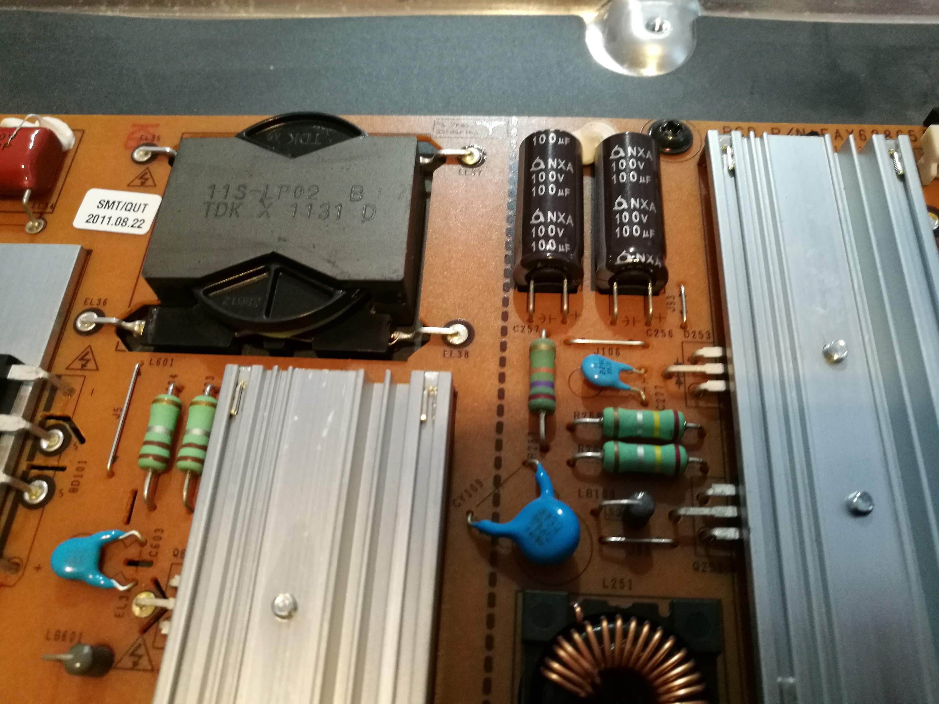

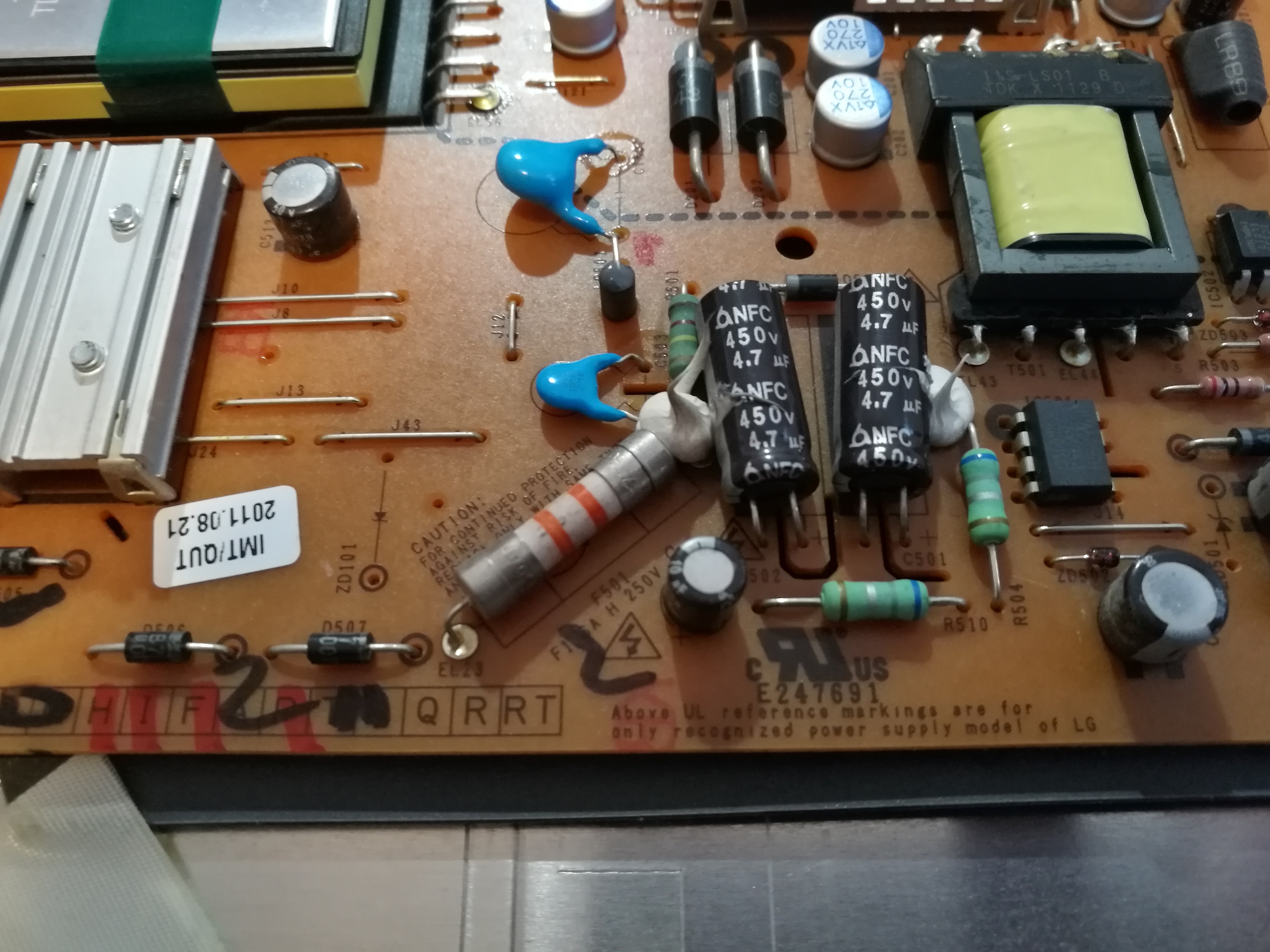

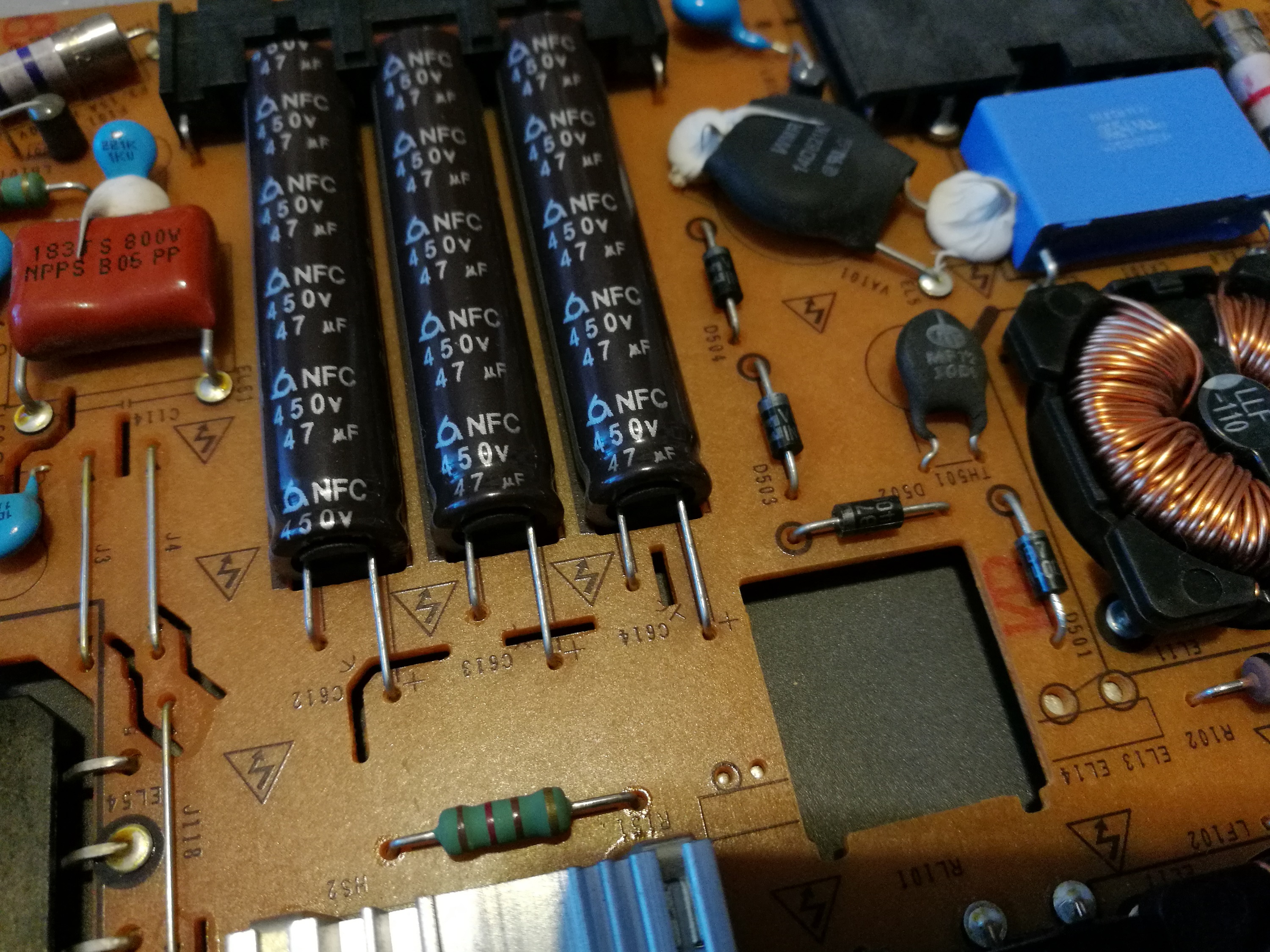

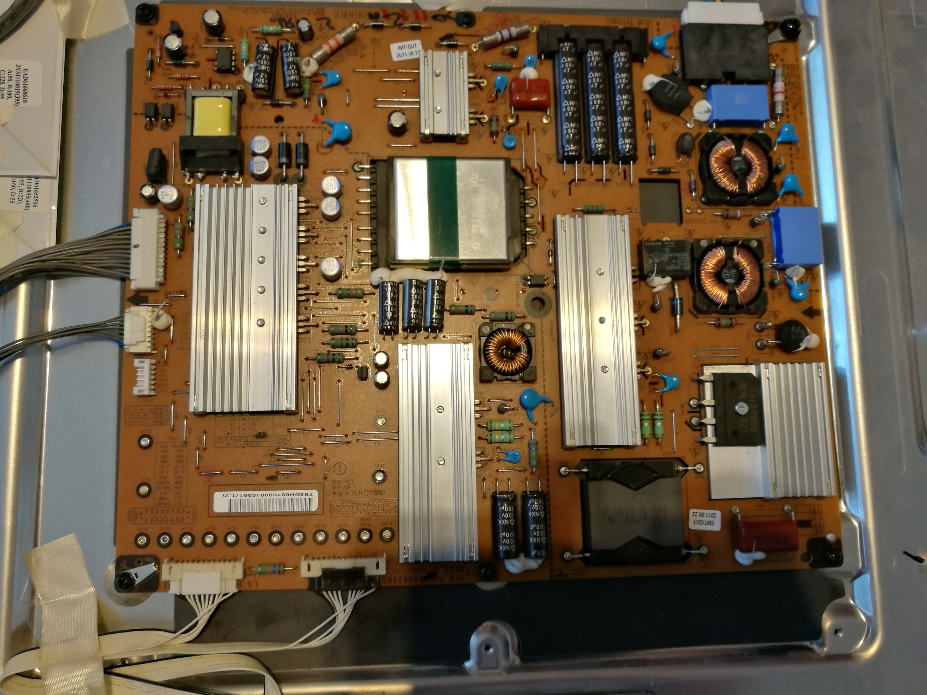

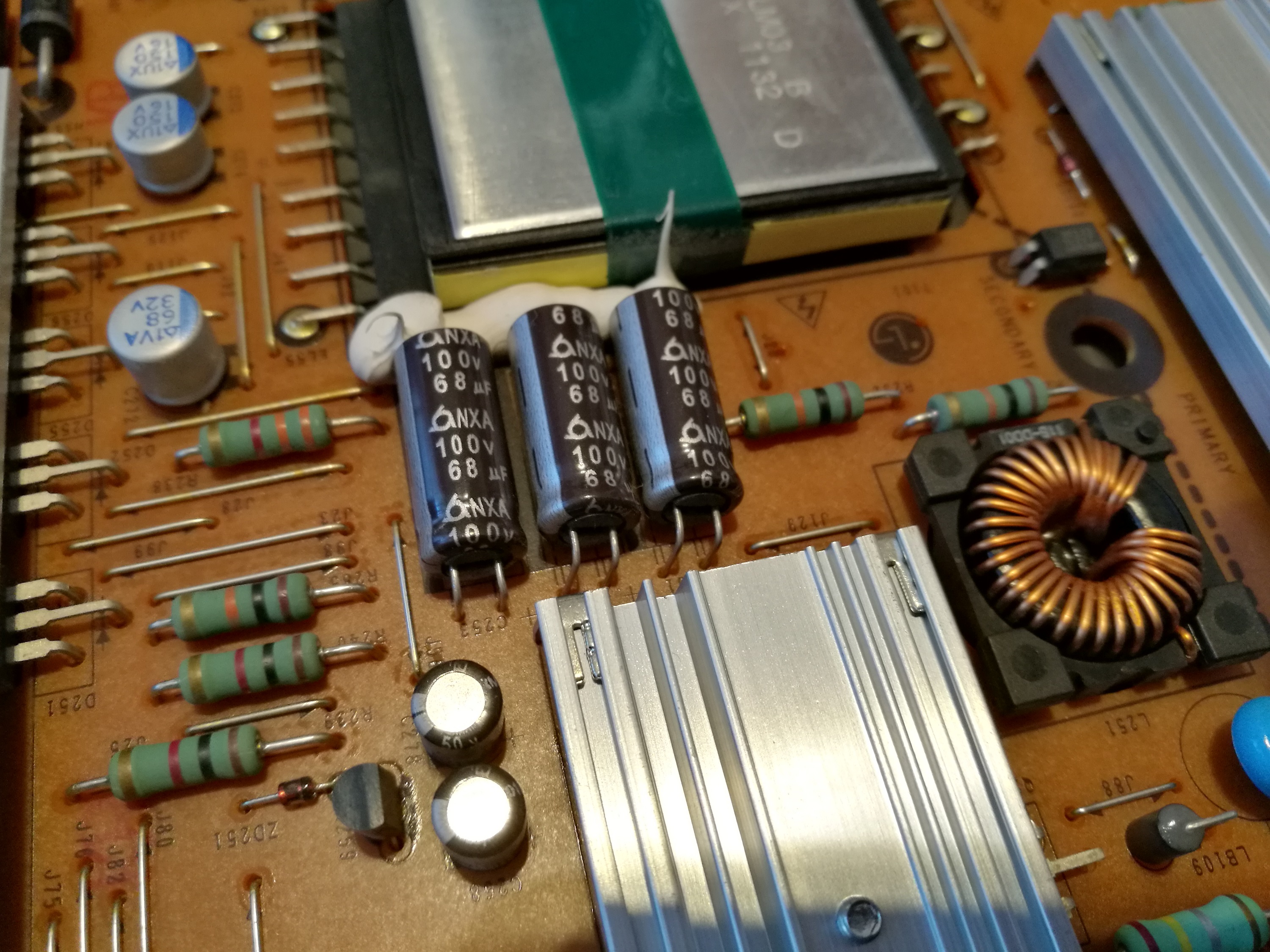

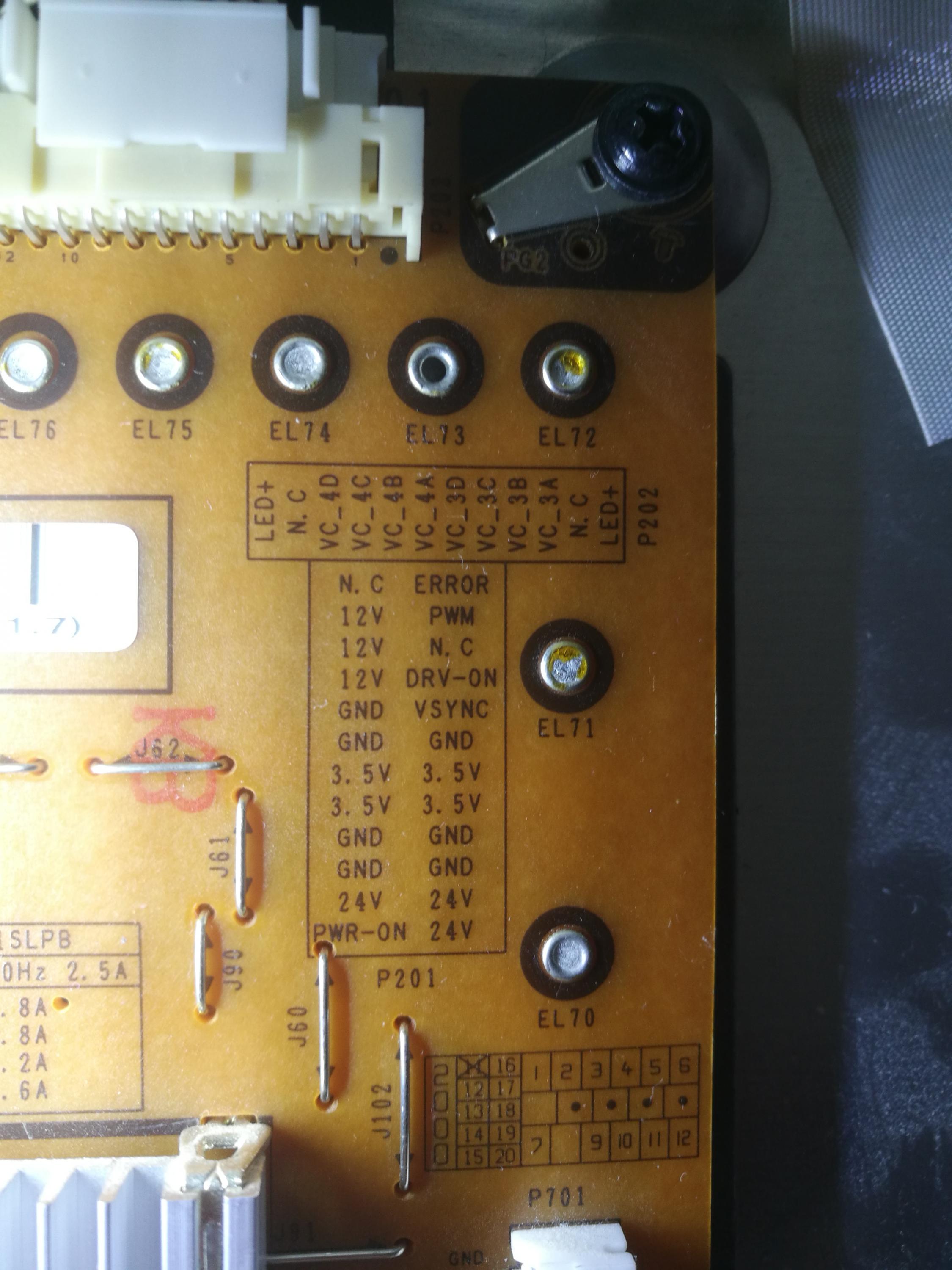

    Re: LG TV 42LW4500 does not starts up LED red white red
    adding some pictures of the power board:

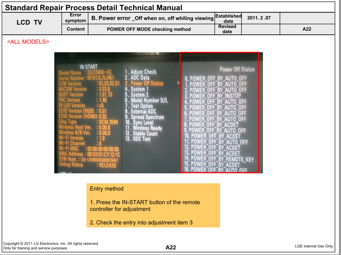

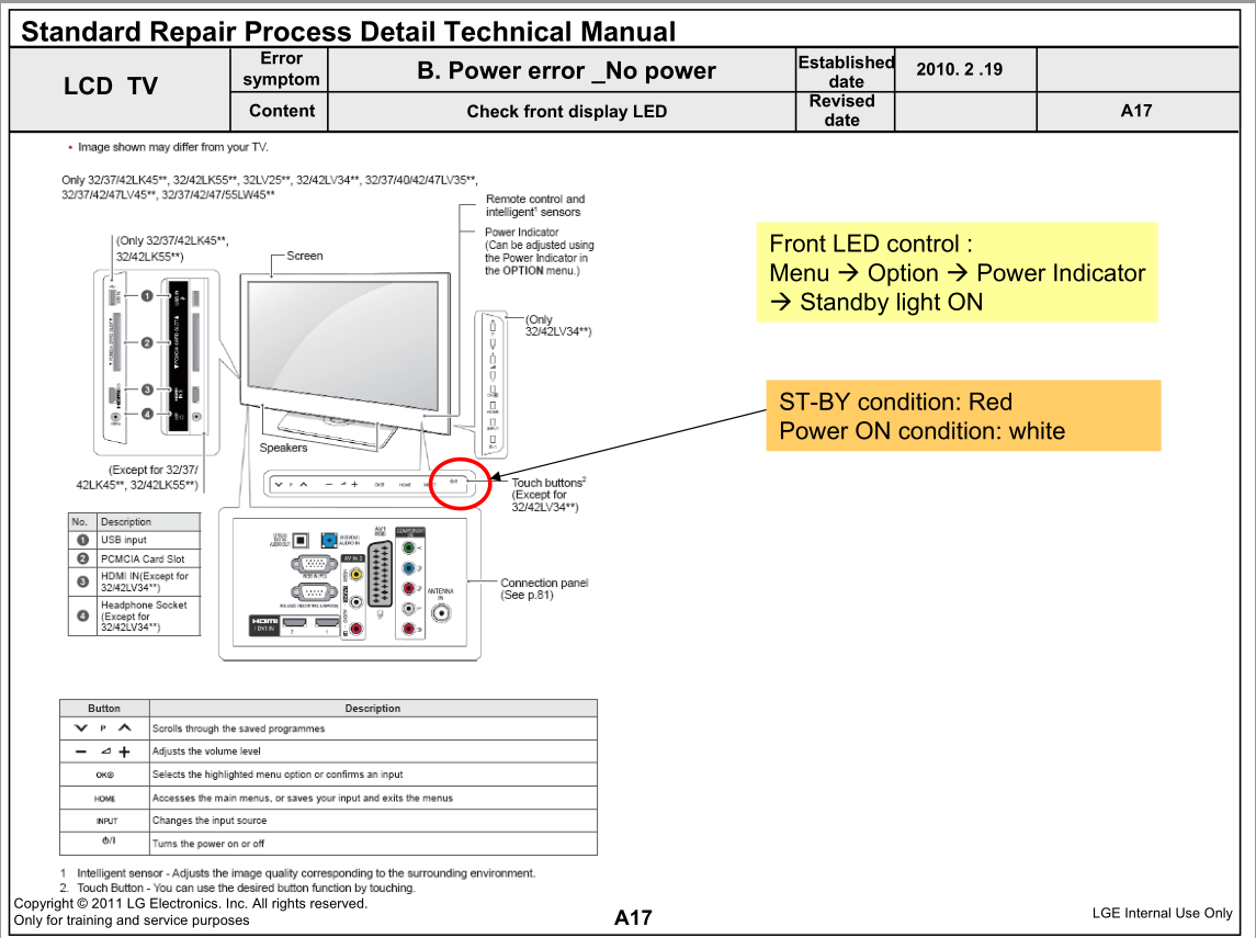

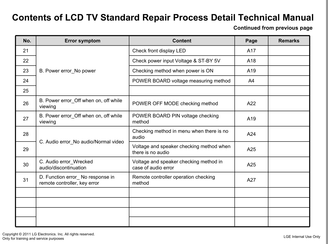

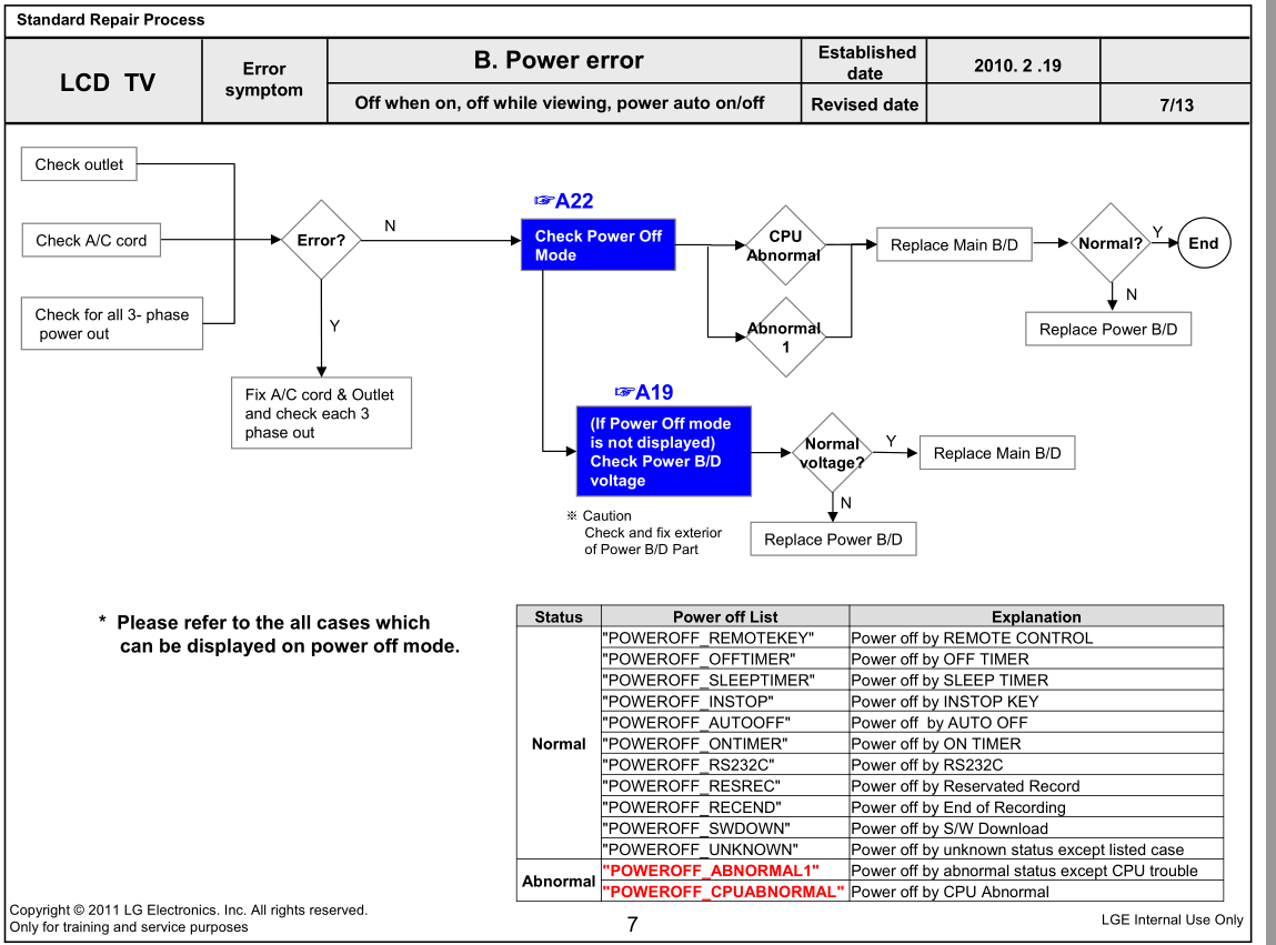

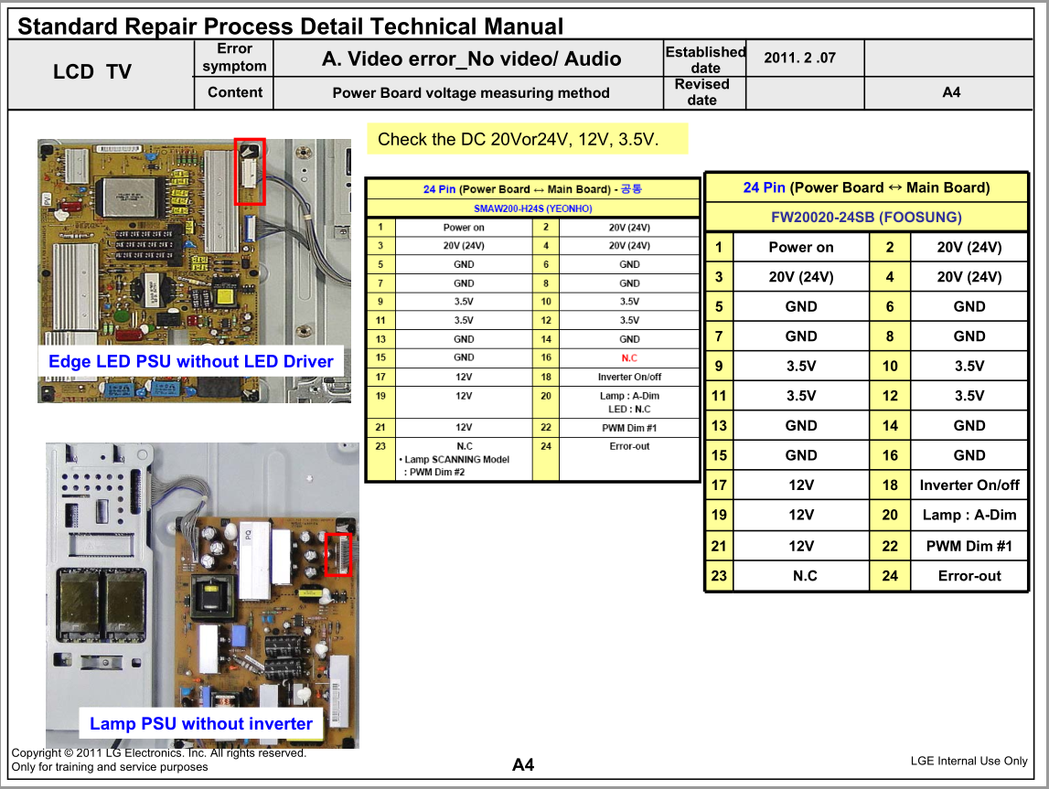

              from the lg service repair process I should go to A19 and A22, but
              can someone explain me the attachment
              how to do so?
              which is the IN-START button of the remote?

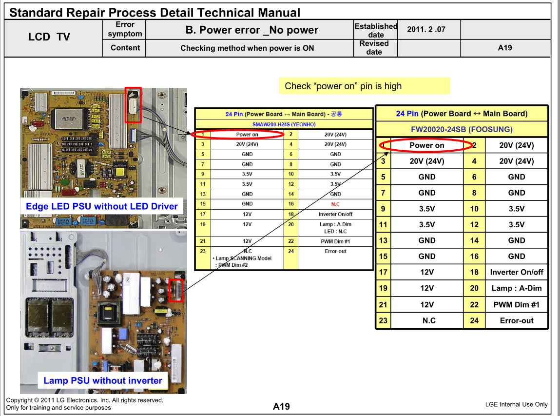

                today I made some measurements and here are results, look attachment
                as you can see when I press power on on remote the votages on column pins2 - PWM jumps from 0,28V to 0,38V then (relay cycles) 0,01V again to 0,28V, any advice where should look next?
                  It seams that all voltages are correct only pin18 DRV-ON (Inverter On/Off) I have 0V, which voltage should it have?
                      That is the control voltage which comes from the main board, likely 3.3 volts. It appears the main board is not sending the control signal, and likely the pwm control signal is also missing. Like others have said, likely main board fault
                        Do you mean that voltage from pin2 PWM which jumps from 0,28V to 0,38V is low and should be 0 powered off and 3.5V when powered on?
                        Even the voltage pin18 DRV-ON (Inverter On/Off) on which I have 0V, should have 3.5V when turned on TV?
                          Yep, 0 volts DRV-ON means no backlights.

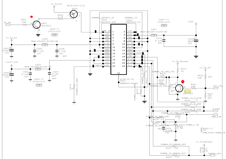

                            The PWM pin is "Pulse-Width Modulation", you would need a scope to look at the waveform.
                            DRV-ON needs to be high(3.3v) to turn on the backlight, but you can't force it on with the main board connected as you could damage the main board.

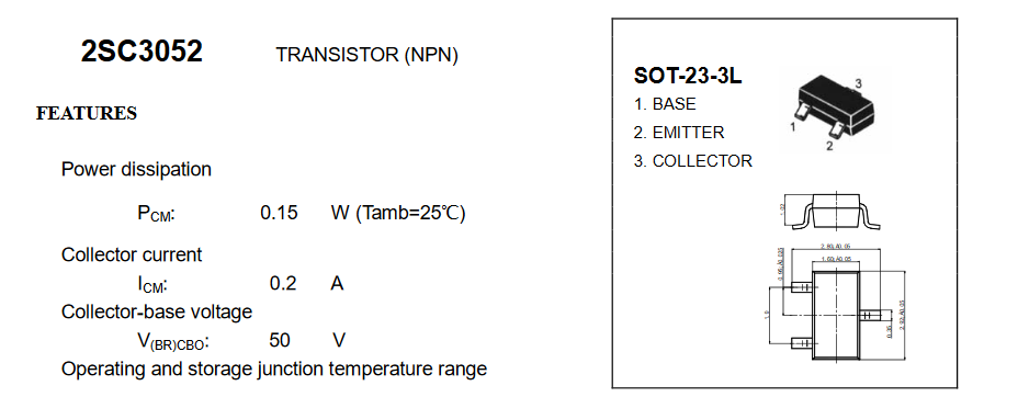

                            Look at the main board and see if you can find Q405. This is the inverter control transistor, It might be shorted. The INV_CTL signal comes from IC1002 (microprocessor) and drives Q405 base
                              Today I found the NPN transistor Q405 2SC3052 and measured it on board like diodes with digital multimeter and here are results:
                              -pin1 Base to +pin2 Emitter = 1969 mV
                              -pin1 Base to +pin3 Collector = infinity
                              -pin2 Emitter to +pin3 Collector = 965 mV
                              reverse measurement:
                              +pin1 Base to -pin2 Emitter = 627mV
                              +pin1 Base to -pin3 Collector = 624 mV
                              +pin2 Emitter to -pin3 Collector = 724mV
                              for me it does not look like shorted, but not sure if it is good or bad, any next idea? advice?
                                  +pin1 Base to -pin2 Emitter = 627 mV
                                  +pin2 Emitter to -pin3 Collector = 724 mV
                                  compared measurements on Q401 same transistor type
                                  -pin1 Base to +pin2 Emitter = infinity
                                  -pin1 Base to +pin3 Collector = 1963 mV
                                  -pin2 Emitter to +pin3 Collector = 1521 mV
                                  +pin1 Base to -pin2 Emitter = 628mV
                                  +pin1 Base to -pin3 Collector = 631 mV
                                  +pin2 Emitter to -pin3 Collector = infinity
