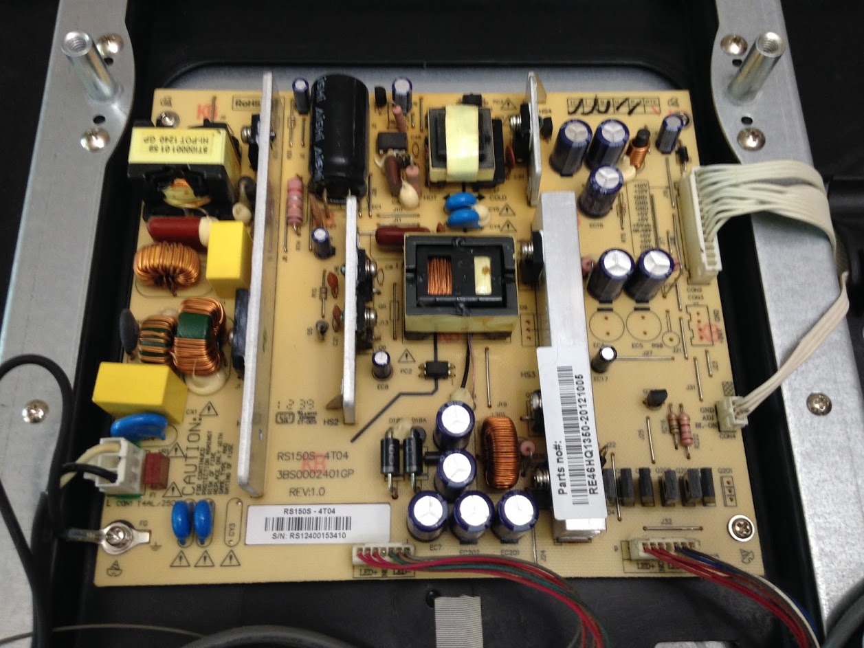

    I have an RCA LED52B45RQ television. Does not turn on, but if I unplug it for 10 seconds or so and plug it back in it will power up after a few tries. Any ideas? Has a RE46HQ1350 power supply board. Thanks

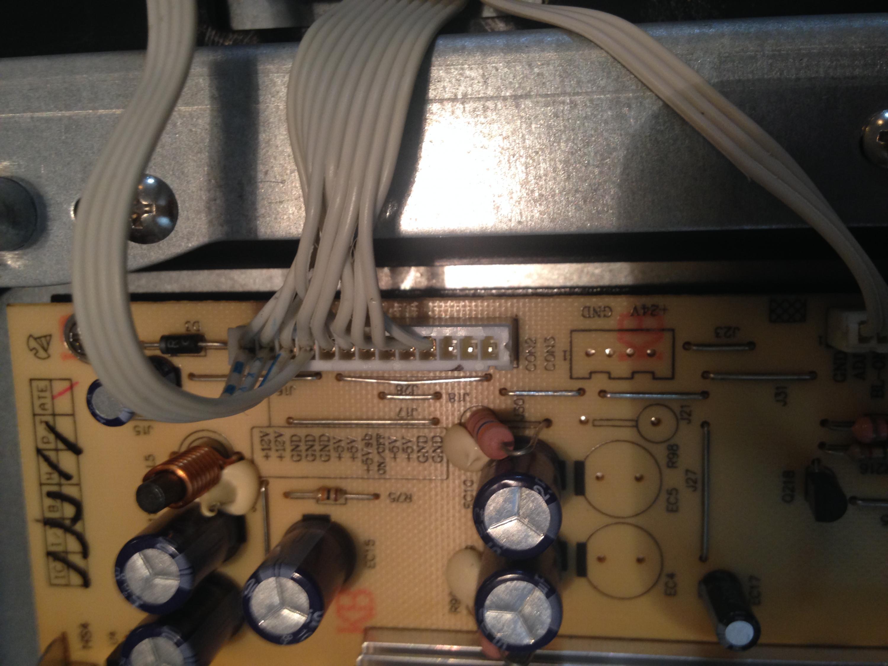

    Do test in number 3 below, video demo in number 2 if needed, can you post some nice clear pictures of all the boards and one of how they are all connected?

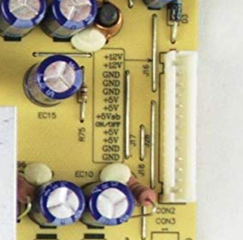

      this is a photo of the main in bus to the power board, three 5v positives, which are we testing?

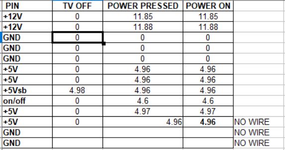

        All 13 pins with cable hooked up, see the map/legend of the pin names and expected voltages beside it, report those in standby which is tv off but power cord plugged in, also report voltages when you hit power.

          I tested all pins in three states. With the TV plugged in, TV plugged in after hitting power on but the screen and speaker fail to activate, and finally after cycling a couple of time and the screen and speakers coming on.
          Also noticed that if the TV comes fully on when I turn it back off the voltages return to the "just plugged in stage". If I hit power and the screen fails to come up when I hit power buttons, voltages come up but remain strong when attempting to power it back off.

            Those voltages look pretty good, if I understand it comes on, when it does if you can go into the menu and turn the backlights (not brightness) way down, then see if it acts any different, can also try unplug tv from power and hold down the power or standby button on the tv (not remote) for about 30 seconds then plug it back in and try it, did you try a factory reset and firmware update?
