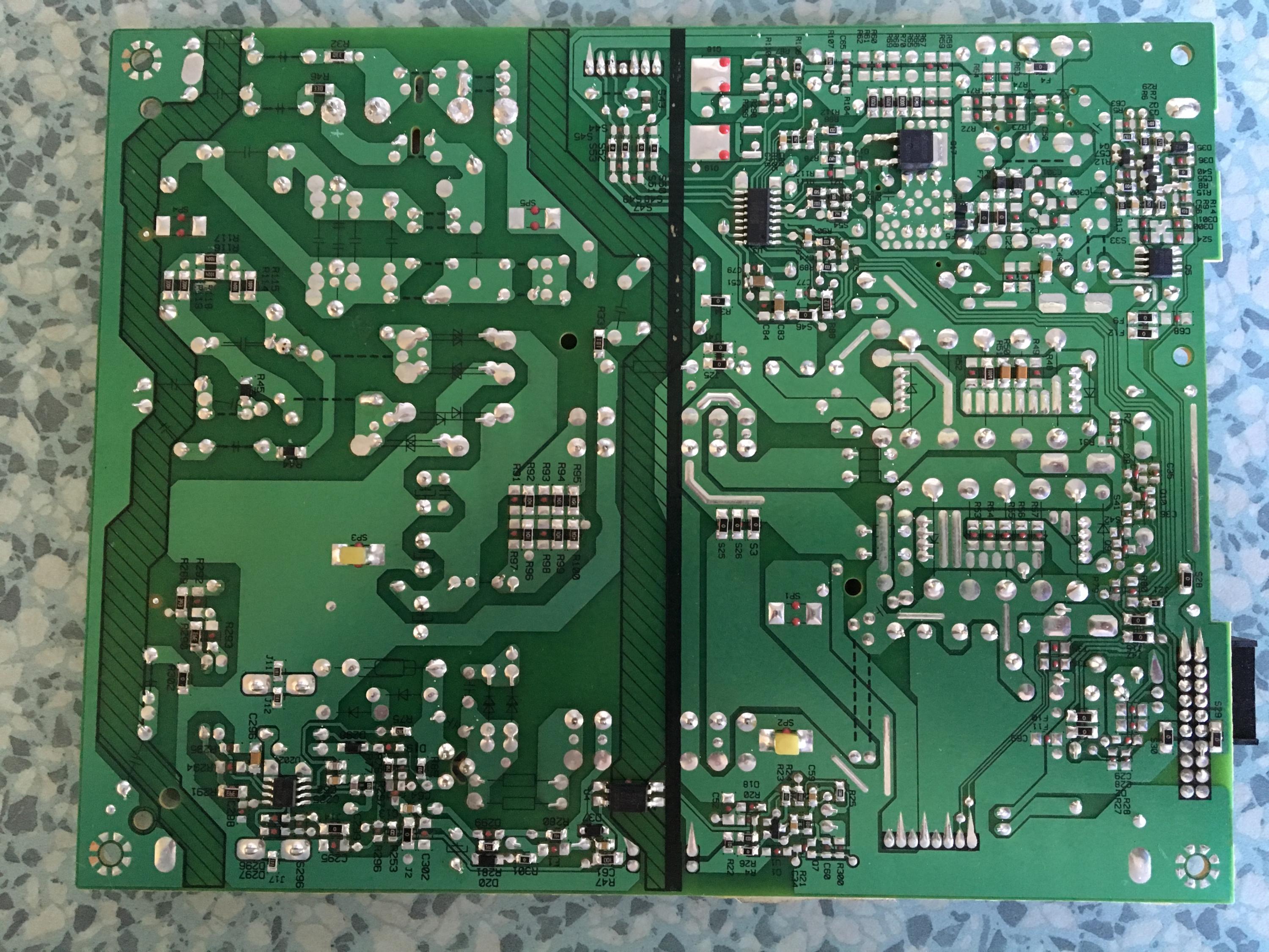

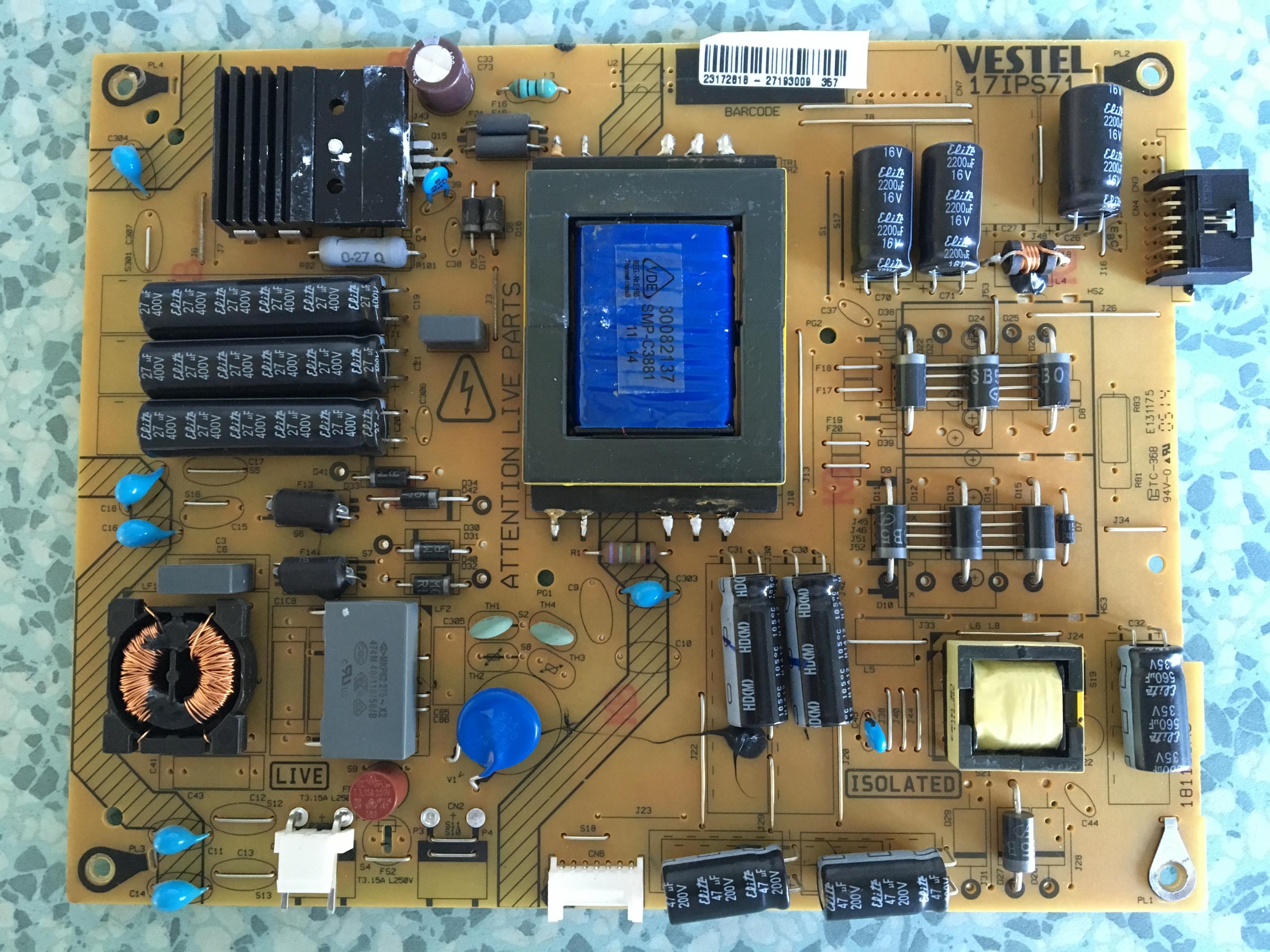

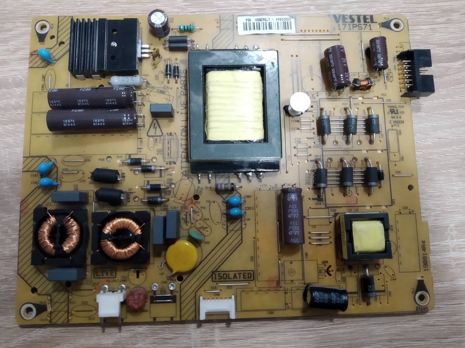

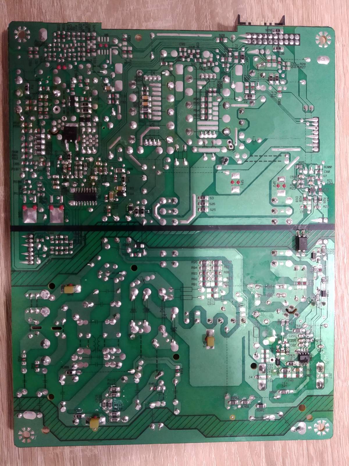

        Re: VESTEL 17IPS71 - Quadro TV
        Sorry guys, these pictures are not actual PSU (i download them on internet). But yes, the Q1 is not populatet on my board also.
        This is the real pictures.
        The problem is it wont start, no LED blink or nothing.

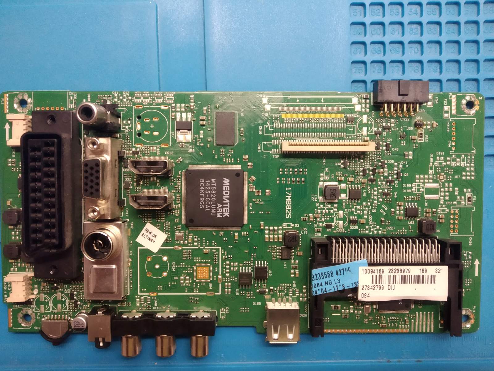

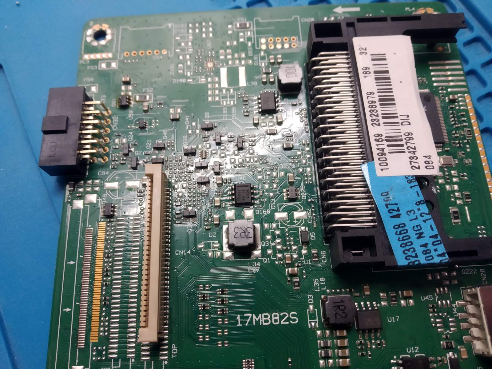

            hello, the MB name is 17MB82S
            here is the picture
              edit: attach pics

                          Q61 is burning?
                          https://www.badcaps.net
                          • CapLeaker
                            Leaking Member
                            • Dec 2014
                            • 8351
                            I am thinking the mediatec IC bad.
                            • rtstorm
                              • Feb 2012
                              • 971
                              • Croatia
                              i try the arizanotlari dump .bin files but still no change. The Q61 is not burning i did some solderin on it so it look like burning.
                              I try to heat the MediaTec IC and i got red light, but that is it. When i unplus and plug in back, again no red light.
                              ...the quieter you become the more you are able to hear...
