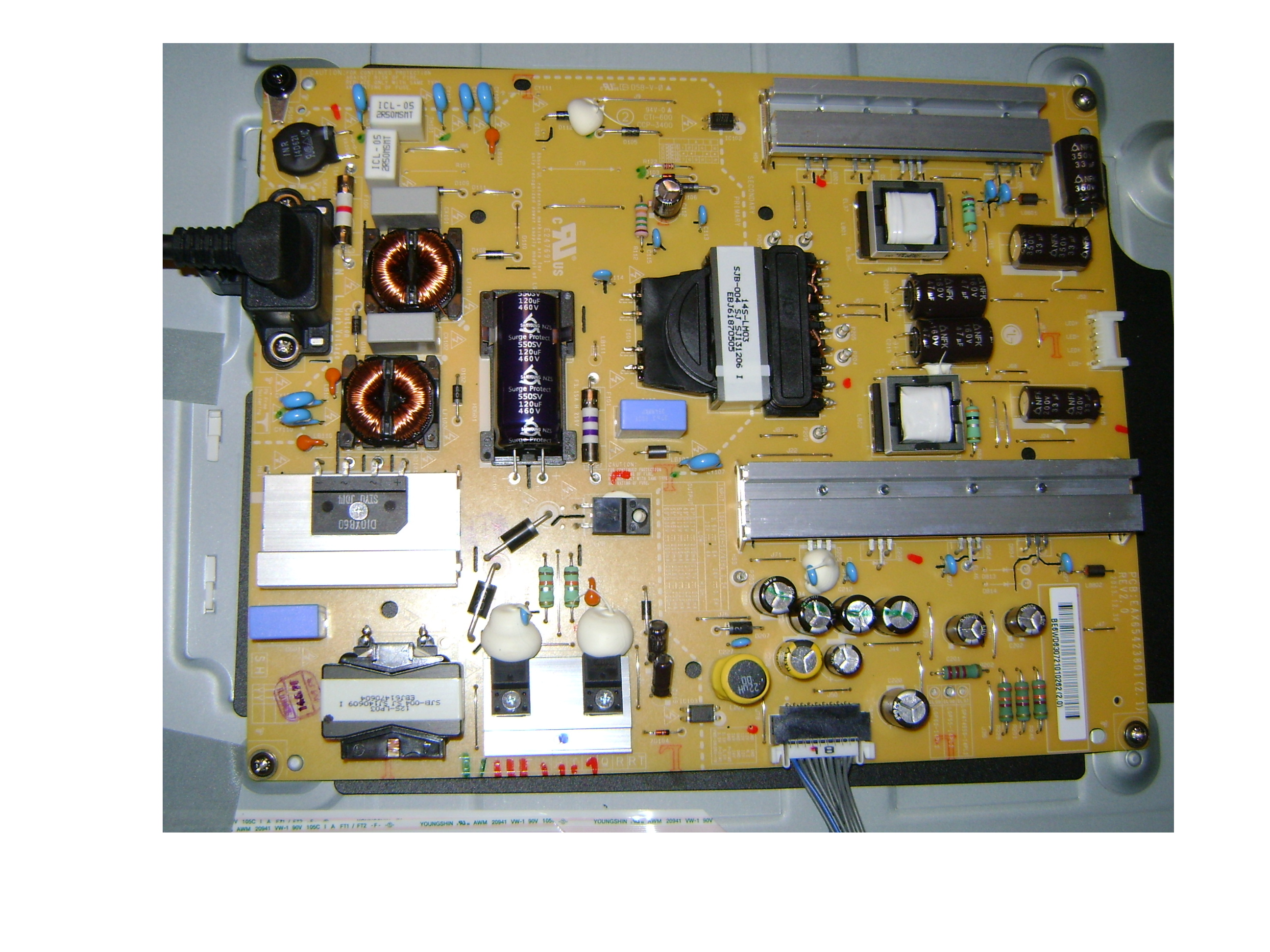

    From my reading, this LG looks like so manty others, with the slightly visible logo at power on.
    I'm pretty sure the metal back is coming off so I can replace ailing backlights.
    I thought I'd go ahead and post up, since this model didn't search here.
    Here's the 20 pin voltages:
    GND
    11.8
    11.8
    GND
    23.8
    GND
    3.4
    3.4
    3.3
    Evens
    GND
    23.9
    11.8
    23.9
    2
    3.4
    2
    3.3
    The big cap is 395 VDC.
    There are 2 pairs of LED leads at P801.
    With P801 connected:
    Pin 7 LED+ 207
    Pin 5 LED- 26.8
    Pin 3 LED+ 138
    Pin 1 LED- 18.8
    With P801 disconnected:
    Pin 7 LED+ 90
    Pin 5 LED- 0
    Pin 3 LED+ 90
    Pin 1 LED- 0
    The voltages don't spike at P801 when powered on, and connected.
    I guess we'll see what needs replacing after I get to the strips.
    Or are those voltages pointing to something else?

    You should do a full replacement of all strips. The LB's use a thicker style lens and the double sided tape is super strong. The lenses can also fall off/get loose with age and will definitely come off when removing the strips. Trick is to use a scraper to remove but tap the handle with a rubber mallet.
