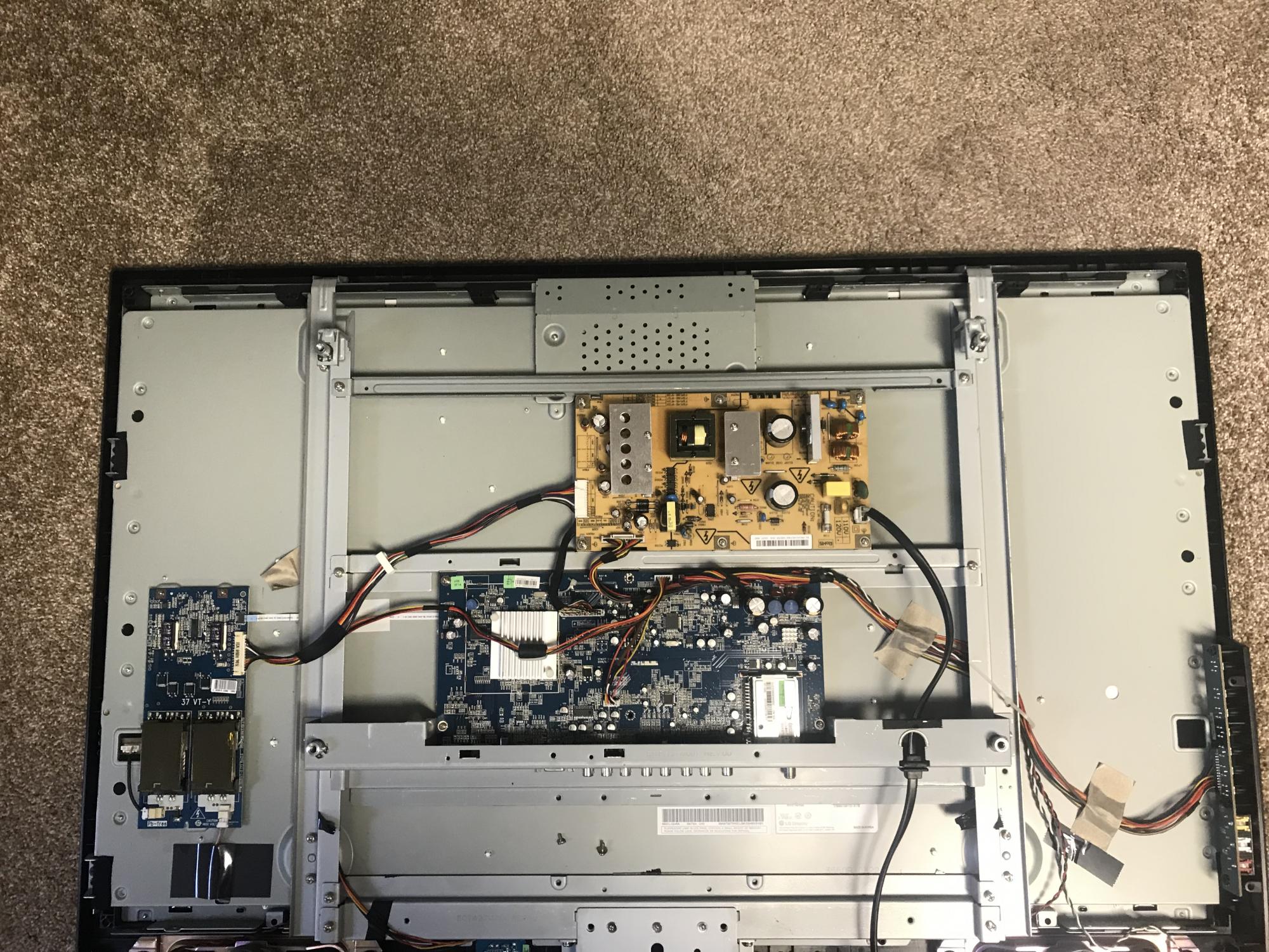

    You can start by providing good clear pictures of the whole backside of the TV showing all the boards so we can see what we are dealing with.

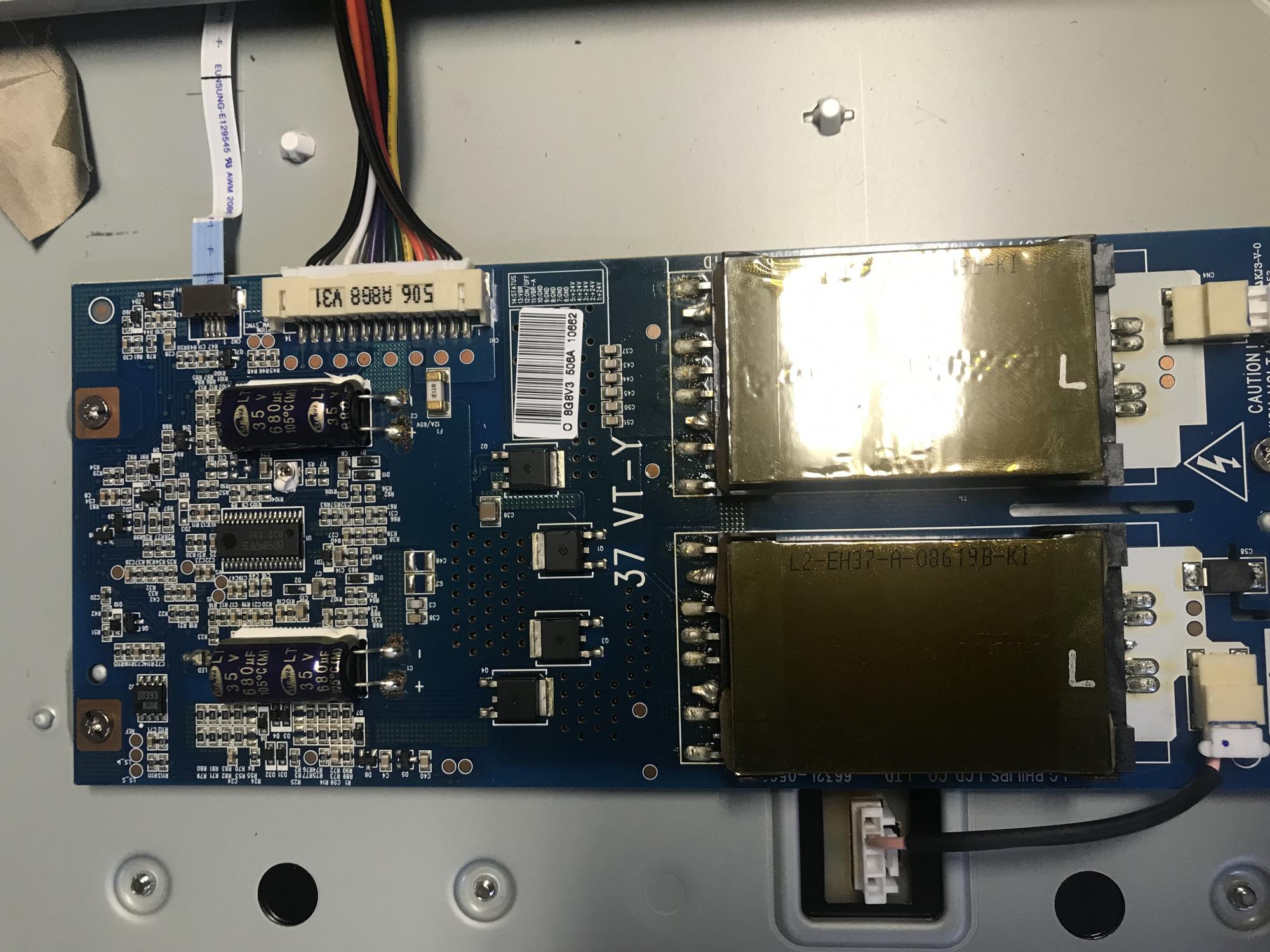

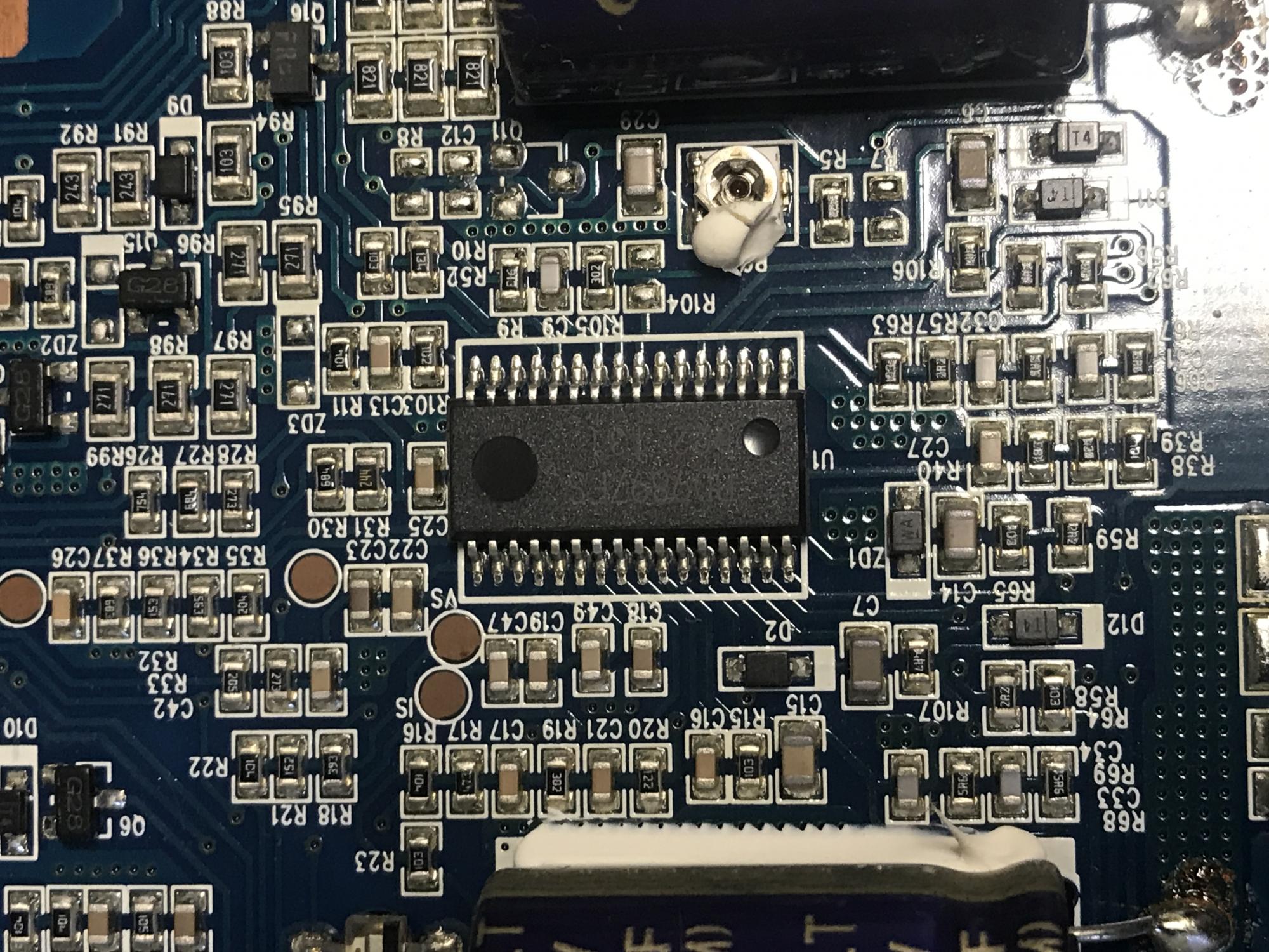

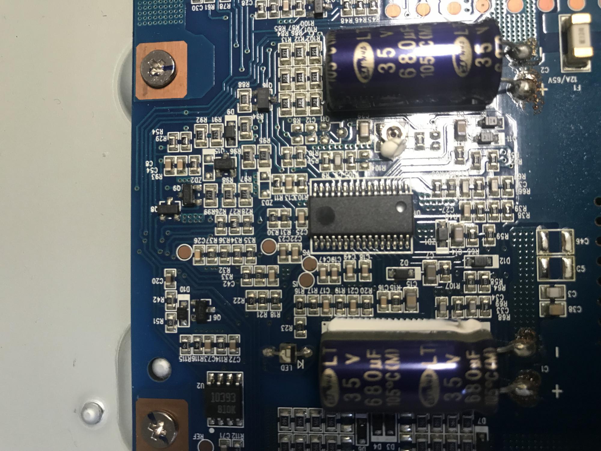

        Look at the two caps on the inverter, are they bulged? check the fuse, F1. look at the top of the ic, does it loo like it is cracked, or does a pin on the ic look over heated.

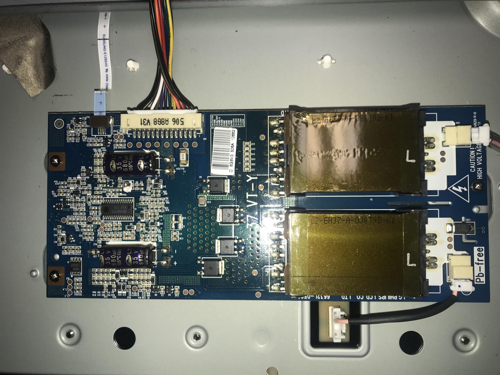

            Here are the pictures. I can upload one if the inverter from shopjimmy if you want better detail.
            Everything looks fine to me.

              There is a small led on the inverter, when you first turn on the tv it should light up then fade out
              • Malachi
                • Dec 2015
                • 1077
                • Usa
                Re: Toshiba 37AV52U no image
                It flashed a couple of times then stopped.

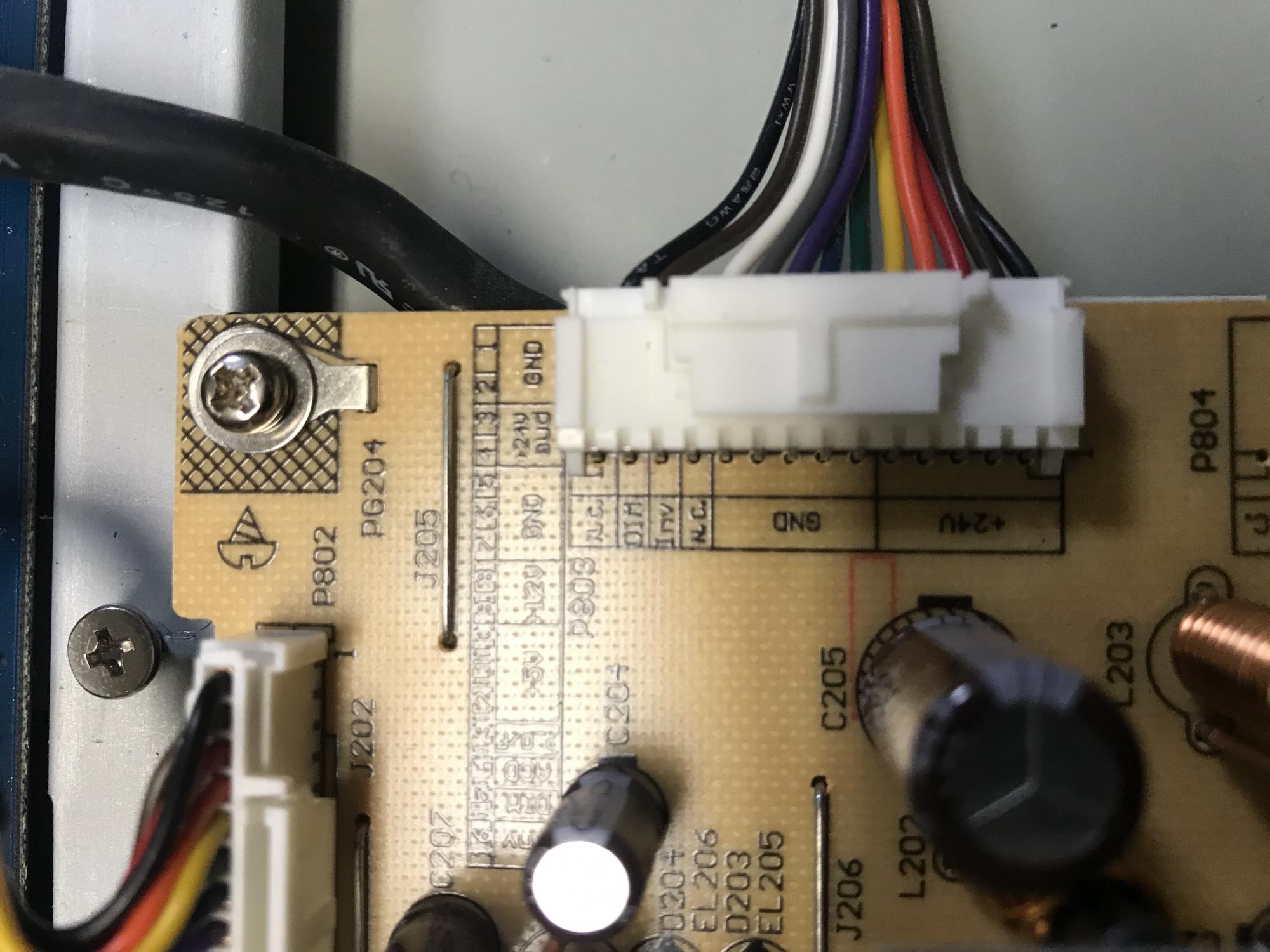

                  Now the tv works. All I did was remove the inverter and reinstall it.
                    loose or corroded connectors
