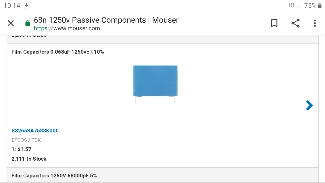

    Need to identify blown part to fix set
    I found this blown part after taking board out Need to know what it is so I can replace . Looks like a monster fuse or compacitor says its 1250volts .
  • Packard93
    • Jul 2016
    • 81
    Re: Need to identify blown part to fix set
    68n J 1250v pILKOR
    384 MMKP WK 1041
    ANYONE KNOW HOW to identify this compacitor so i get right one?
    • tvtimmy
      • Mar 2015
      • 1160
      • usa
      Here's one.
      • Robinsosa
        • Nov 2013
        • 19
        • kenya
        Polypropylene Capacitor (Film Capacitor)
        68nF 1250V
