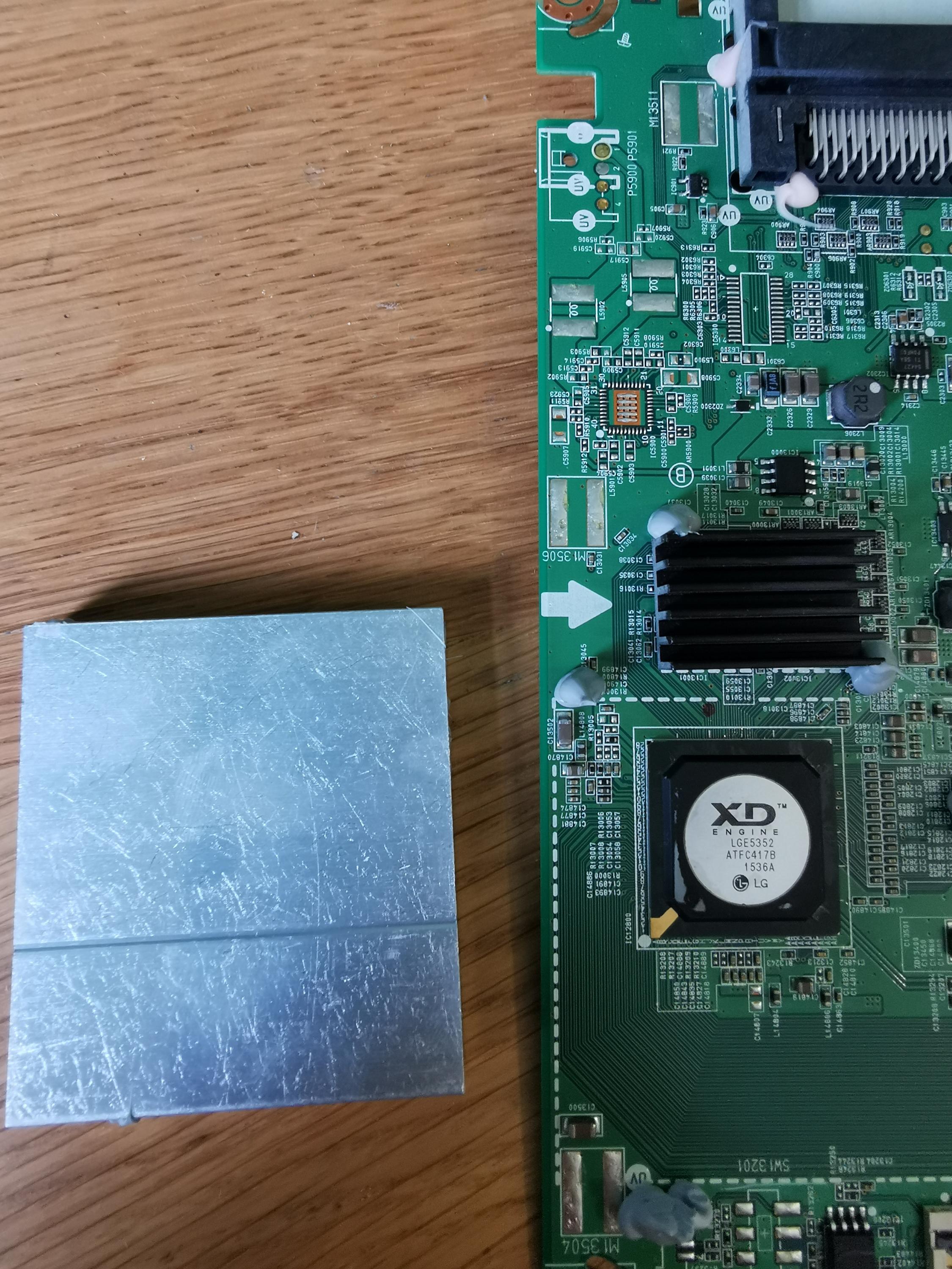

          Not sure what you mean to rework IC under white heat sink. Here is a picture. Where should I heat it, I've got a hot air gun on my aoyue solder Station.
          I've spotted a few solder points that look like they need touching uo
          • Sevenqi
            • Jul 2011
            • 292
            Re: Repair LG 60UF770V
            You need to remove the white mental heatsink and you'll see an IC.
            Rework means re-soldering that IC, but it's BGA IC so it's a bit harder and skillful. Please refer to youtube video for BGA soldering tips if you're not experienced.
                  You mean this chip here. Yea looks difficult. I can see what I can do with my heat gun.
                  Ready to give up on this TV. Its up in the attic now out of the way, will have to make do with a 42 inch on the wall.
                  Maybe will find someone who has smashed screen, spares and repair.
                  Does anyone know of any centres that may deal with large number of broken TV. Basically a scrappy for tvs lol
                    There are a few in the UK, EMOS, spares2repairs and tvparts spring to mind.
                    Good luck with finding one though, BGA failure on the LGs is common so they are rare. You might get lucky on ebay but most people seem to ask silly money for broken screen TVs, although you do occasionally find them cheap.
                    You ideally need more than a hot air station to effectively reflow the solder. The heat has to be even and you don't want just the processor area heating up, the whole board should be around 150c to avoid thermal stress before reworking it.

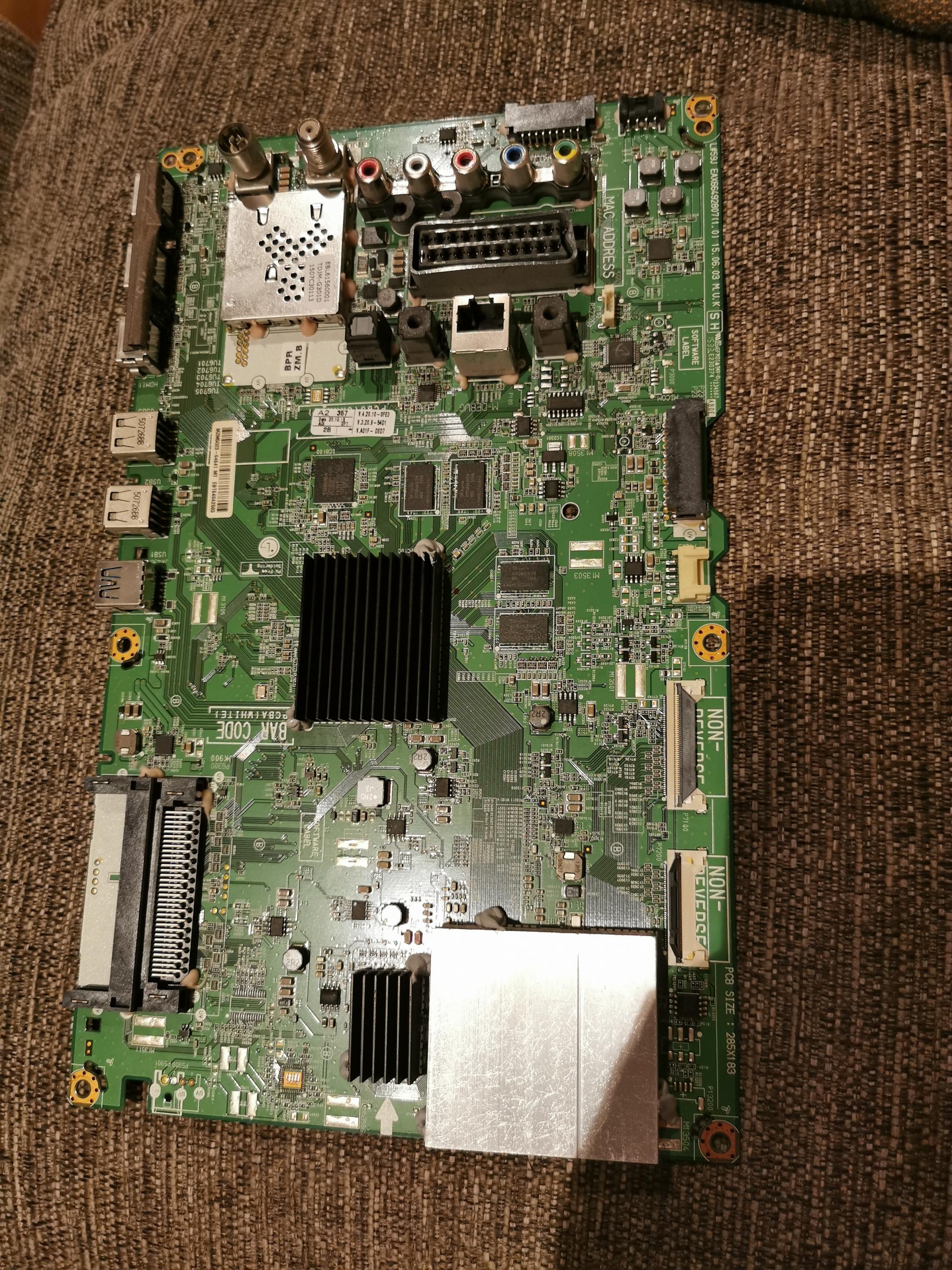

                          New main board coming today I hope. £70. Not too bad.
                          If a new main board doesn't fix it, I've no idea what to do.
                          Is it possible a faulty tcon board could cause issue in picture at start of post
