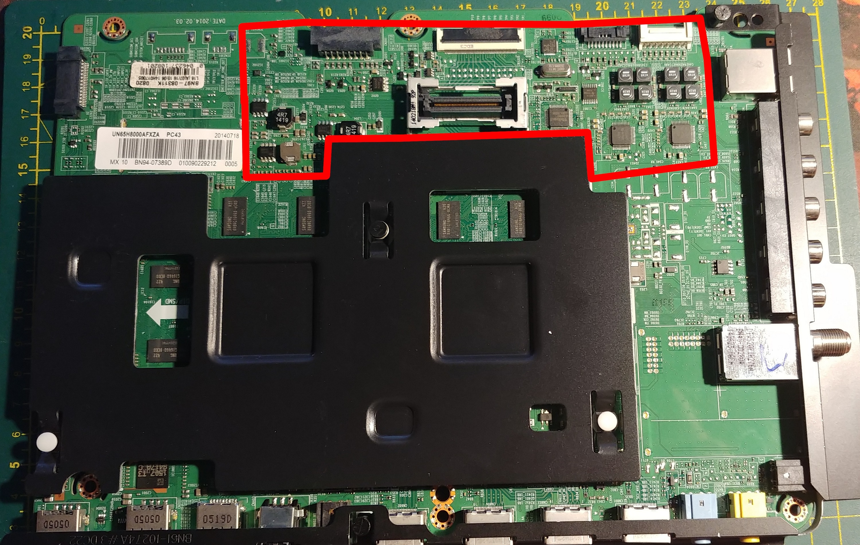

    I have a Samsung UN65H8000AFXZA that I got from a friend a year ago. The Backlight comes on but no image. When I connect it to my laptop it picks it up as a 1080p 60hz monitor that I can use as a secondary so the logic board seems fine. I have checked all the voltages and they seem to make sense. I got a replacement tcon board but the problem persists. On the tcon board I am getting 2 of 3 leds lit up. I have tried unplugging 1/2 of the tcon to get half the panel working and tried taping over some pins. If anyone has a service manual or anything that can be helpful please post. Also if you want exact voltages ask away.
    Thank you.
    T-Con Part# BN95-01595A
    Power Supply Part # BN44-00743A
    Re: Samsung UN65H8000AFXZA Backlight No Image
    So either one of the cable between the LCD panel and the T-CON connected you will get each half of the screen to work?

      Sorry didn't make that clear but I couldn't get either side of the screen to work and had 2 of 3 leds each time.

        So today I got some freeze spray (compressed air) and decided to spray it around the part that I thought was good the main board and I got 3 light on the tcon board briefly and some white lines on the screen. But now I am getting power loops where the tv backlight comes on and promptly off. The highlighted part of the image is where I sprayed it.
        Mainboard Part# BN94-07389D
