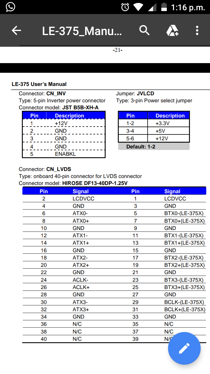

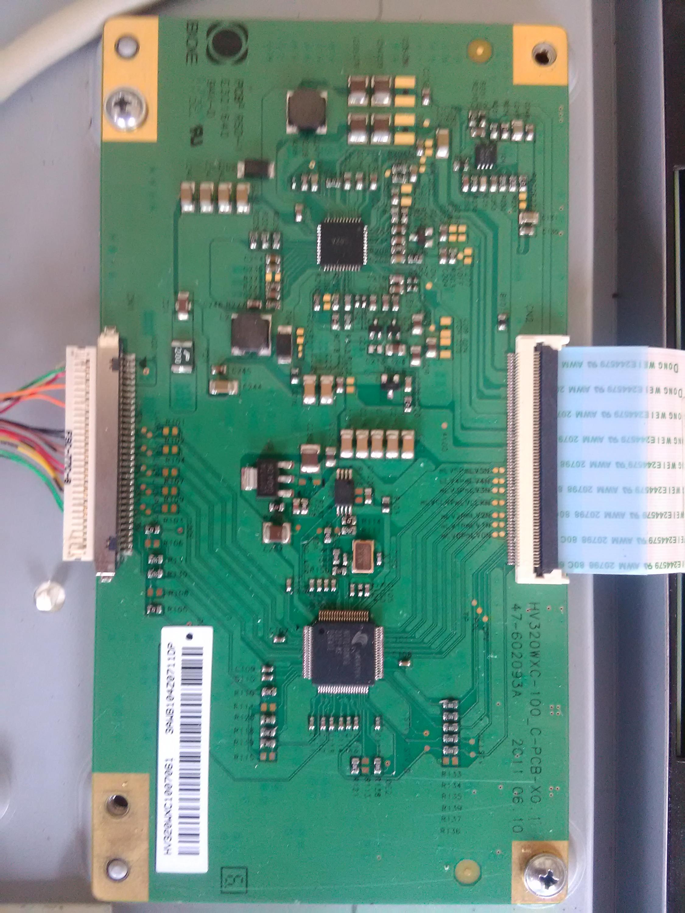

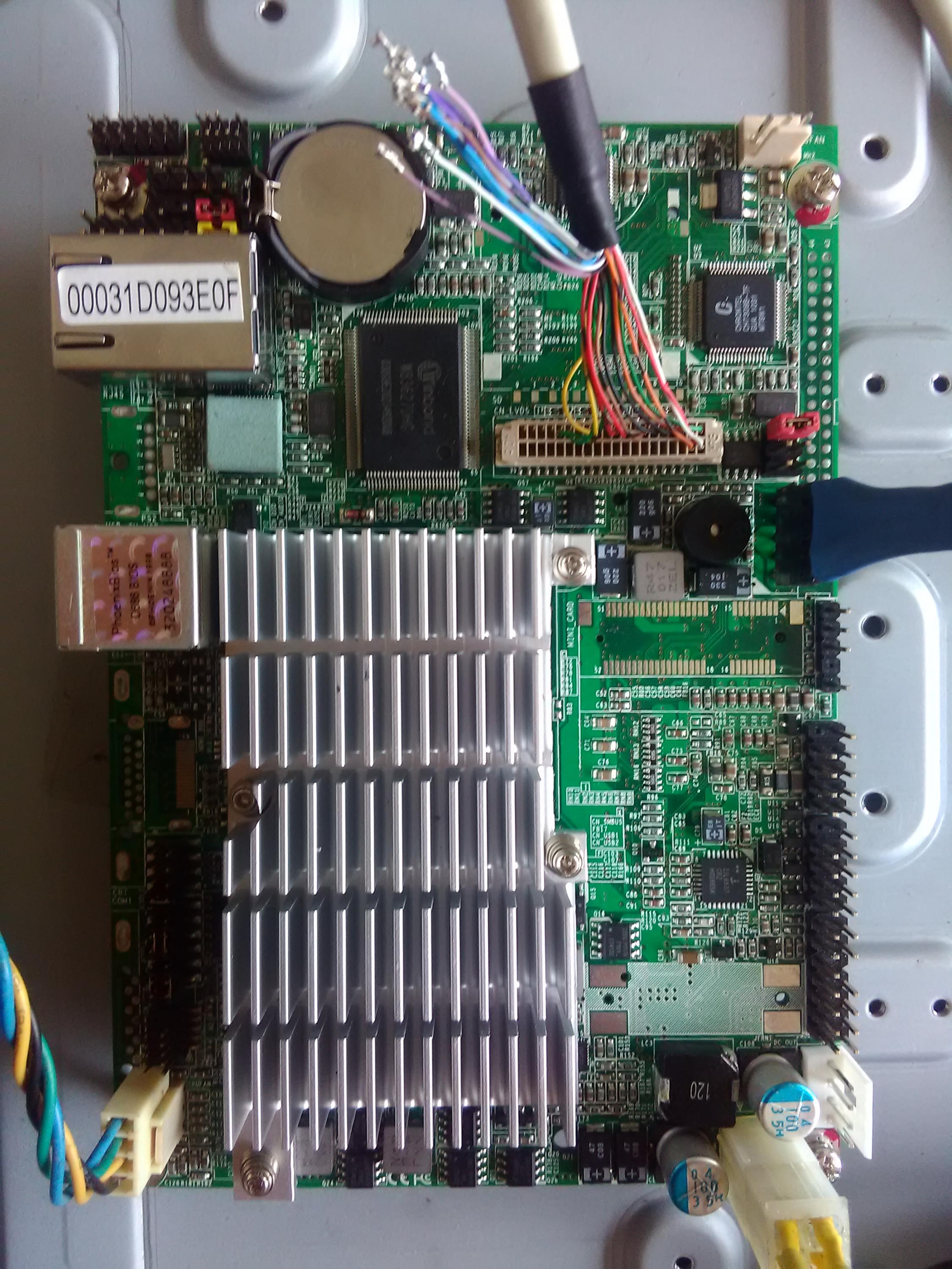

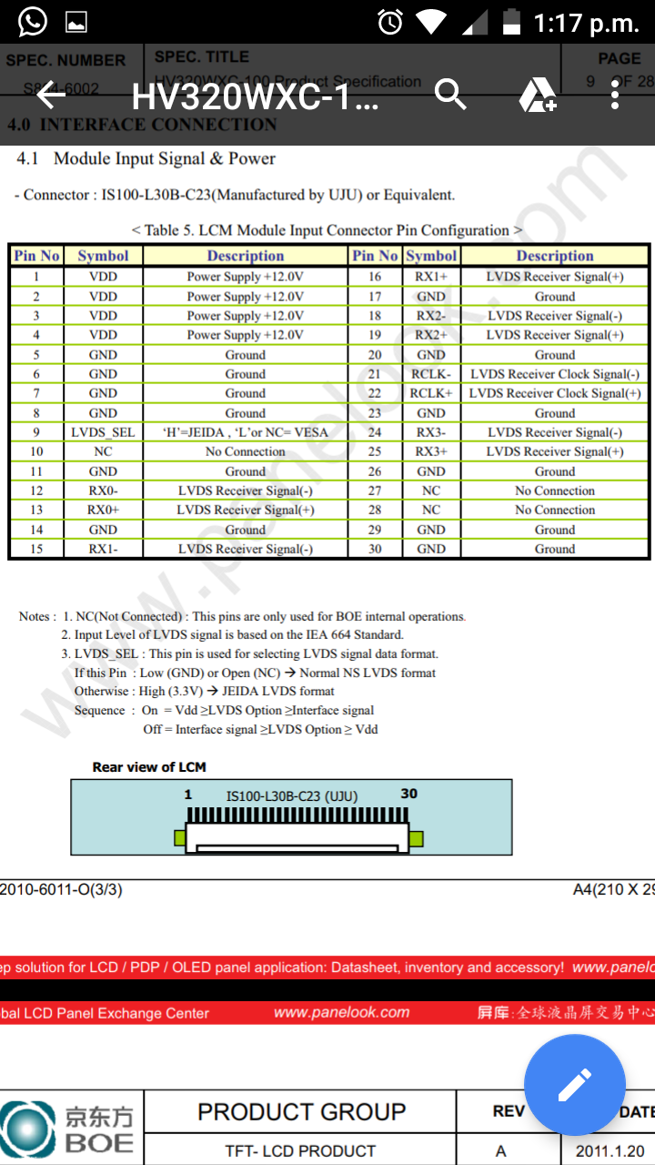

    Iv been given a LE-375 (its a mini pc with lvds output),
    And I have a old HV320WXC-100 screen.
    I'm trying to connect to mini pc to the screen but haven trouble getting the picture to display, iv got the inverter working using a 12v relay controlled from the pc using a 24v power supply.
    Pc boots up fine back light comes on but no video feed.
    I found information on the pc and the screen, I'm guessing iv got the pin out wrong somewhere any help would be much appreciated
