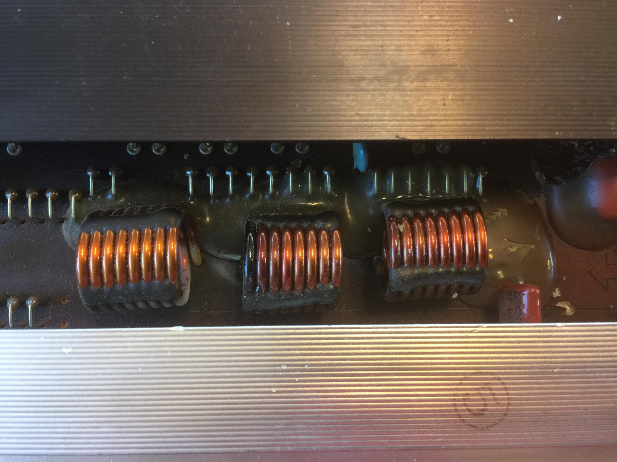

    Soldering advice.
    These coil are sucking up so much heat that I feel my like my solder joint is not good, any trick or advice to make it work better?

    Re: Soldering advice.
    Either use a higher wattage soldering iron or hold the coil end with a long nose pliers on the component side of the board and solder normal way. I have along nosed vice grip pliers that I use.
      Preheat the joint with a heat gun or even a hair dryer. Heat to about 100C and your solder will more easily flow to a perfect joint.
