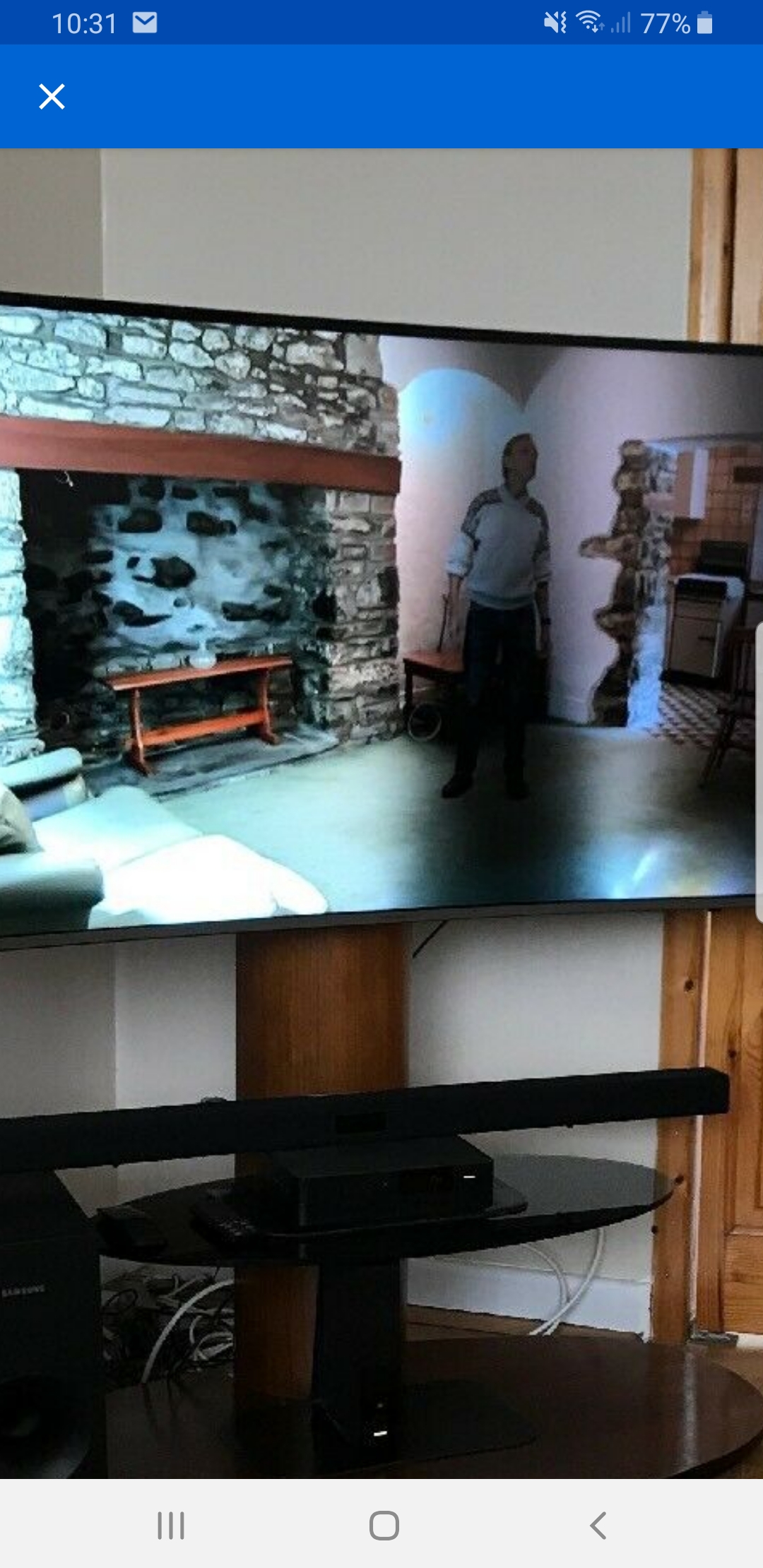

    Hi
    Haven't looked at the tv yes but does anyone had this fault before possible backlights ?

    Yes backlights.
