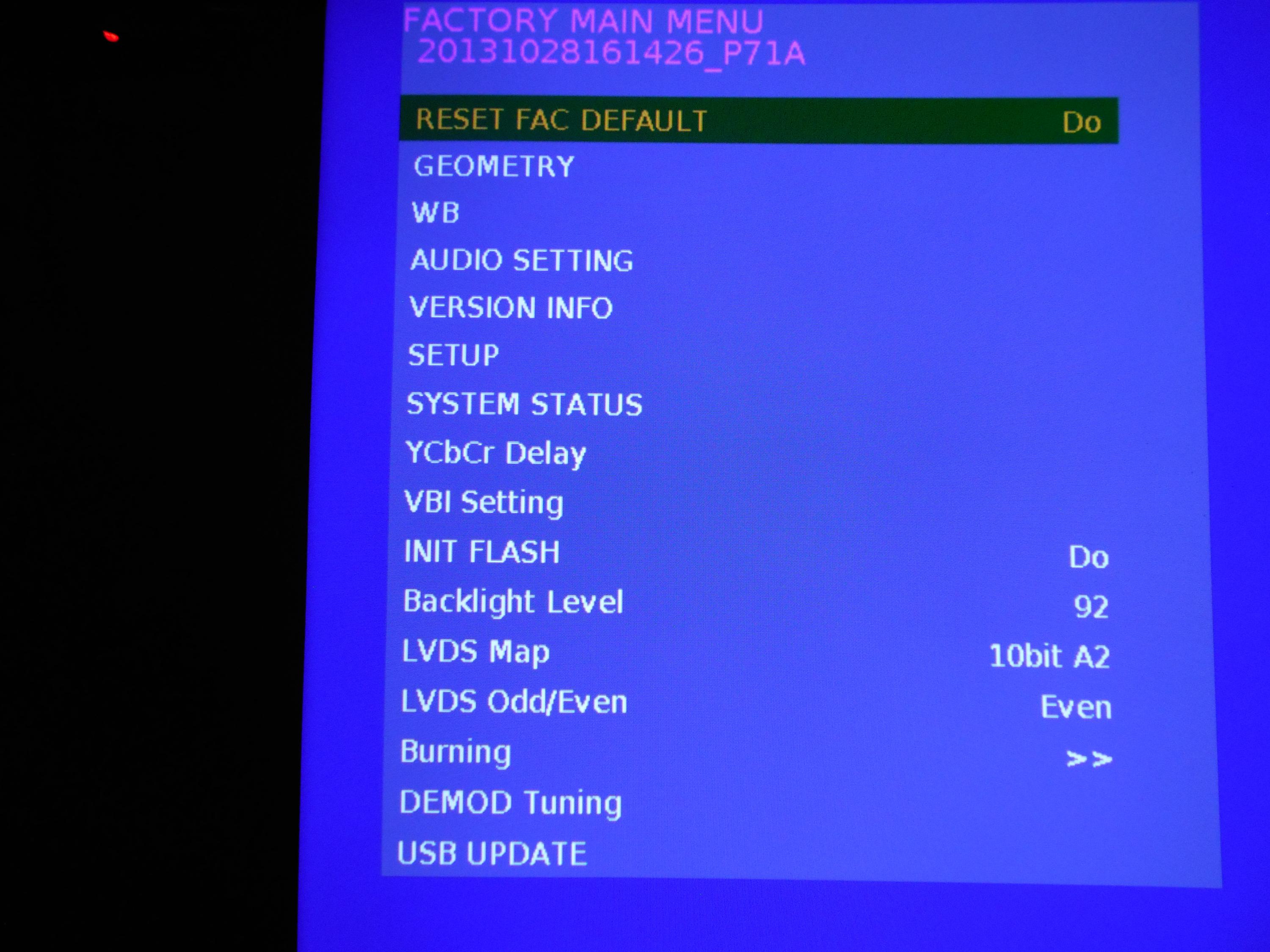

rca rlded5078a-e flip image
  • tonytiger
    • Jan 2010
    • 163
    • canada
    hi everyone,i change a eeprom on my mainboard rlded5078a-e and now i have a upside down image,all the rest work like a charm so my question is.....in the sevice menu(1147) there is no place for panel setting or i missing something....can someone help me please.here is a photo of the service menu i have.

    It might be behind another of the menus, the setting you are looking for is probably called mirror control.

      Re: rca rlded5078a-e flip image
      thanks for the reply,but did check all the other setting and nothing on mirror,flip,inverse,ect picture,i did alot of this setting and usely it is writen flip,ect but here there is nothing not even panel setting....at lease if there was and ver. update that i could do with the usb..but did not find nothing...
        Think you need to update firmware.
          Looks like it will be hard to find firmware, rca has virtually no support, your best bet may be a new eeprom, not sure if that would work but might be worth a shot. Found nothing on flipping the screen of this model, might be there someplace tho????
