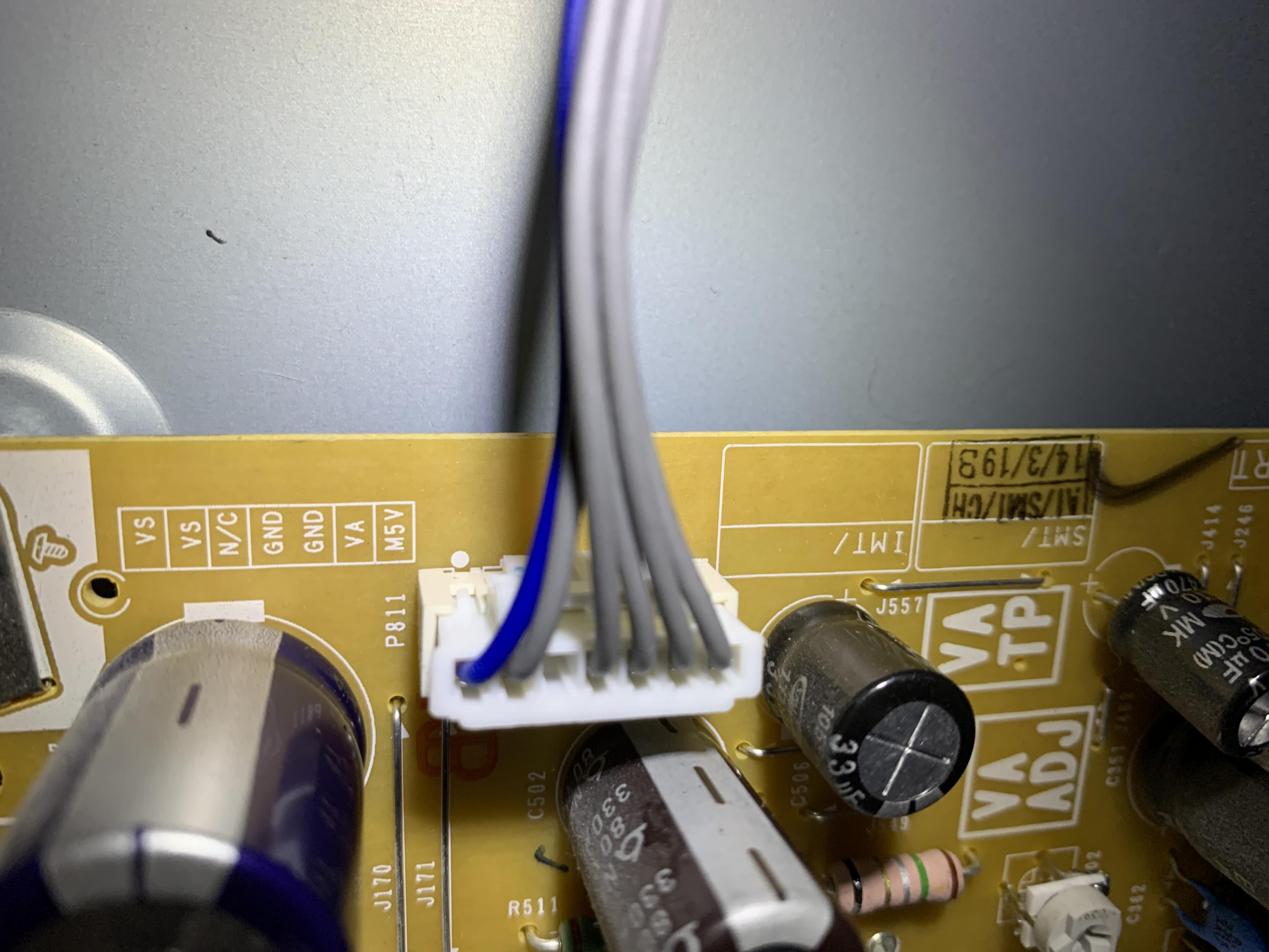

    Oh wow, I am really glad I did not bake the boards.
    So I see now why the 55V is correct on pin#6 of P811. That pin corresponds to VA which is supposed to be 55V.
    Attached are photos of P811 and P813 (which is just the other end of P600 so they are exactly the same) and also a photo showing what the VS and VA voltages are supposed to be.
    So the fact that when the TV is working properly pin#6 on P811 is the correct 55V but when the TV is not working properly it is 0V, does this tell me anything useful?

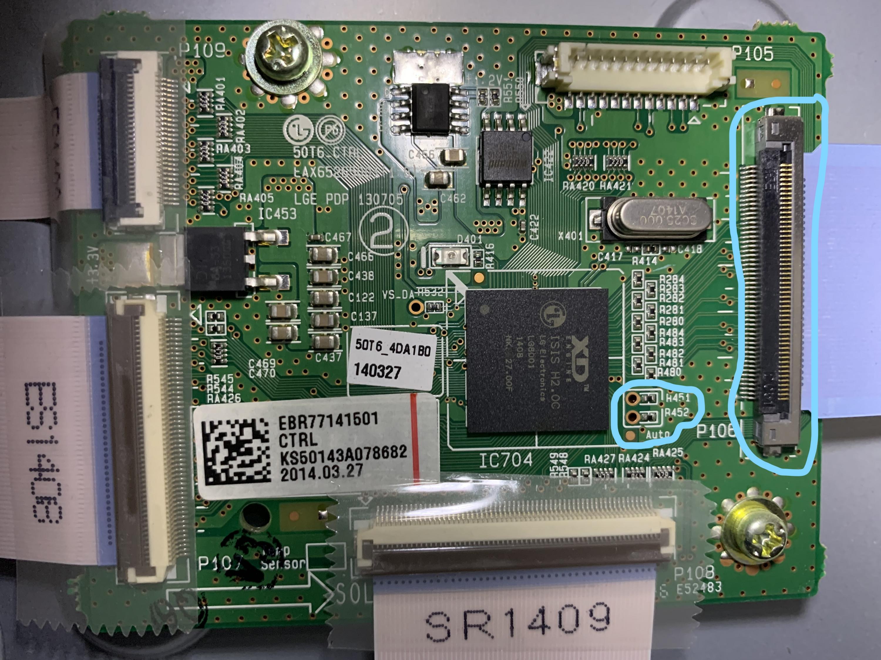

          Attached are photos of the back of the TV and a closeup of the Logic Board.
          I really only see two small next to R451 and R452 and below it is a pad labelled Auto.
          I am actually not really sure how to release that ribbon connector that goes to the main board. I assume I lift a clasp and then the ribbon cable will pull out but I cannot figure out what I am supposed to lift. I tried both the black plastic part and the silver metal part and neither want to lift easily. I figured I better ask before I break something.

              Re: 50PB560B -LG common problems?
              Yes the two pins labelled AUTO are the ones you need. Jumpering these pins with mainboard disconnected and plugging in the tv should let the tv turn on and display test patterns if panel and panel boards are working. It helps you isolate mainboard issues.
              Gently lift the black plastic part with fingernail and gently remove ribbon cable by pulling to the right. Very little force is required. If you need force you are doing something wrong and should re-evaluate before breaking something.

                Ok, so I am trying to connect the two holes, basically I want to connect the copper rings around the holes to each other?
                For the black connector, am I slipping my fingernail under the ribbon edge (right side) and lifting, or the circuit board (left) side?
                • Unspun01
                  • Jun 2011
                  • 349
                  Yes, connecting the copper rings of the holes. Paperclip will apply gentle spring pressure to hold in place. Don't insert too deep - you don't want to accidentally contact other ground points.
                  Lift black plastic from circuit board side I thing. Look closely at it. You should see a hinge appearance and it should be obvious how it opens.

                    Ok, I unplugged TV, removed ribbon (you are correct, black tab lifts from left), inserted paperclip between two holes, plugged in TV.
                    The standby light came on but that was all. I tried turning the TV on and off several times but all that did was toggle the standby light, the screen never came on.

                        Do you have VS & VA when you power up?
                        • jp_fizzer
                          • May 2020
                          • 17
                          • Saudi Arabia
                          #32
                          Yes, I just checked and I have VS on both pins 1 and 2 and I have VA on pin 6

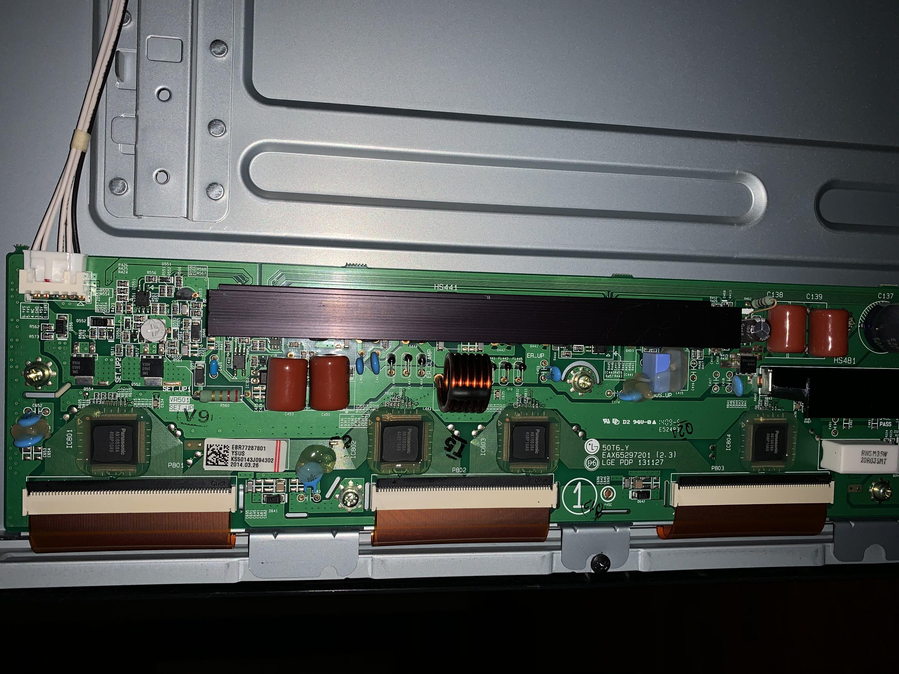

                                      I could not find the Vsc and Ve voltages. The Vy is 190V. Attached are pics of the Y buffer board.

                                        #39
                                        What do you have for +Vsc to chassis
                                        • jp_fizzer
                                          • May 2020
                                          • 17
                                          • Saudi Arabia
                                          #40
                                          Ah found it. Vsc to gnd is -23.5V
