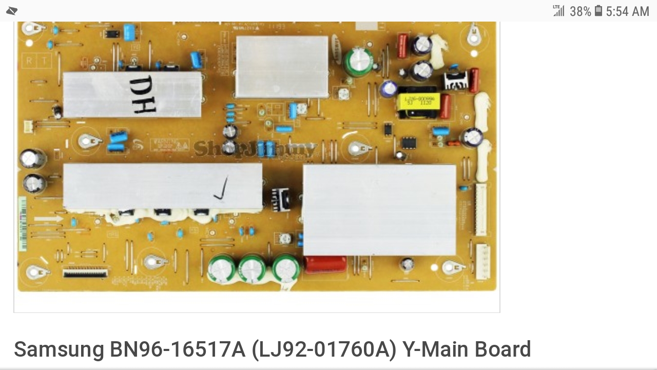

    I'm looking for a set of schematics for the PN51d440A5DXZA - the Y-main board in particular. Does anyone have any leads on where i can find it?
    Model Number: 50DH/DF Y-main(1 layer)
    PCB: LJ41-09423A
    PBA: LJ92-01760A HD
    PBA: LJ92-01764A FHD
    Unfortunately, the Y-main doesn't indicate which PBA number this really is.
    The original owner said the video went out, but you can still hear the audio. When i received it, i noticed three N-Channel FETs were shorted out. All are RJP30H1's. I replaced them, but no dice so far.
    Any leads would be greatly appreciated.
    Thank you
    -Thomas

    Yours is NOT the LJ92-01764A. That is for the 550 series. It s 3d tv.
    Have you confirmed that the parts you replaced were not fake Chinese copies? There are tons of them around.

      Thanks for the reply. Good to know the unit does NOT use the LJ92-01764A board. I guess i'm interested in getting the LJ92-01760A HD board schematics then. I just haven't been able to find a source for it.
      I received the TV from the original owner. As far as the actual boards go - they are from the factory as far as I've been told.
      The replacement N-Channel FETs came from eBay a few months ago since they are no longer manufactured. I've used them successfully on a different plasma repairs and they still work on the TV I have on the wall.
      -Thomas
