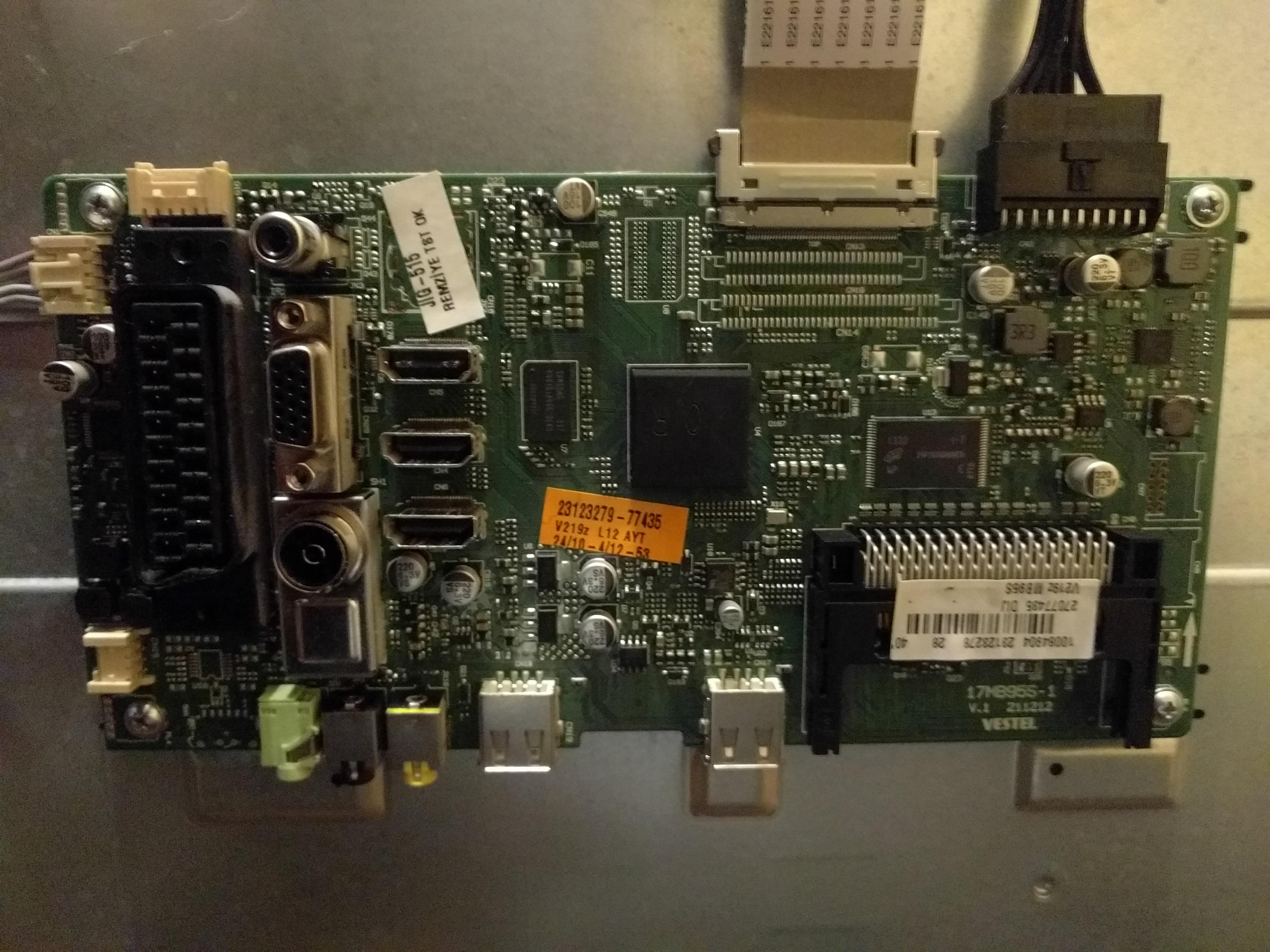

          i went back to read all yours POST. stop me 2 things 1- you wrote over night was on STB Red LED next day was off.... then other post i think post 27 you wrote same issue but next day when turn on only green LED Flashing... from both i am sure now 99% yours PSU Normal. yours Problem was double MB and BL. BL you fixed but now MB start clear its fault.
          leave the screen apart.. never connected again until you have it turn on and BL on for more hours and you can hear sound too.. also this TV can work with out LCD. more time you take LCD in out you will destroy the ribbon cable
          post clear photo of the MB there are some of Toshiba Vestel failed with BGA or firmware

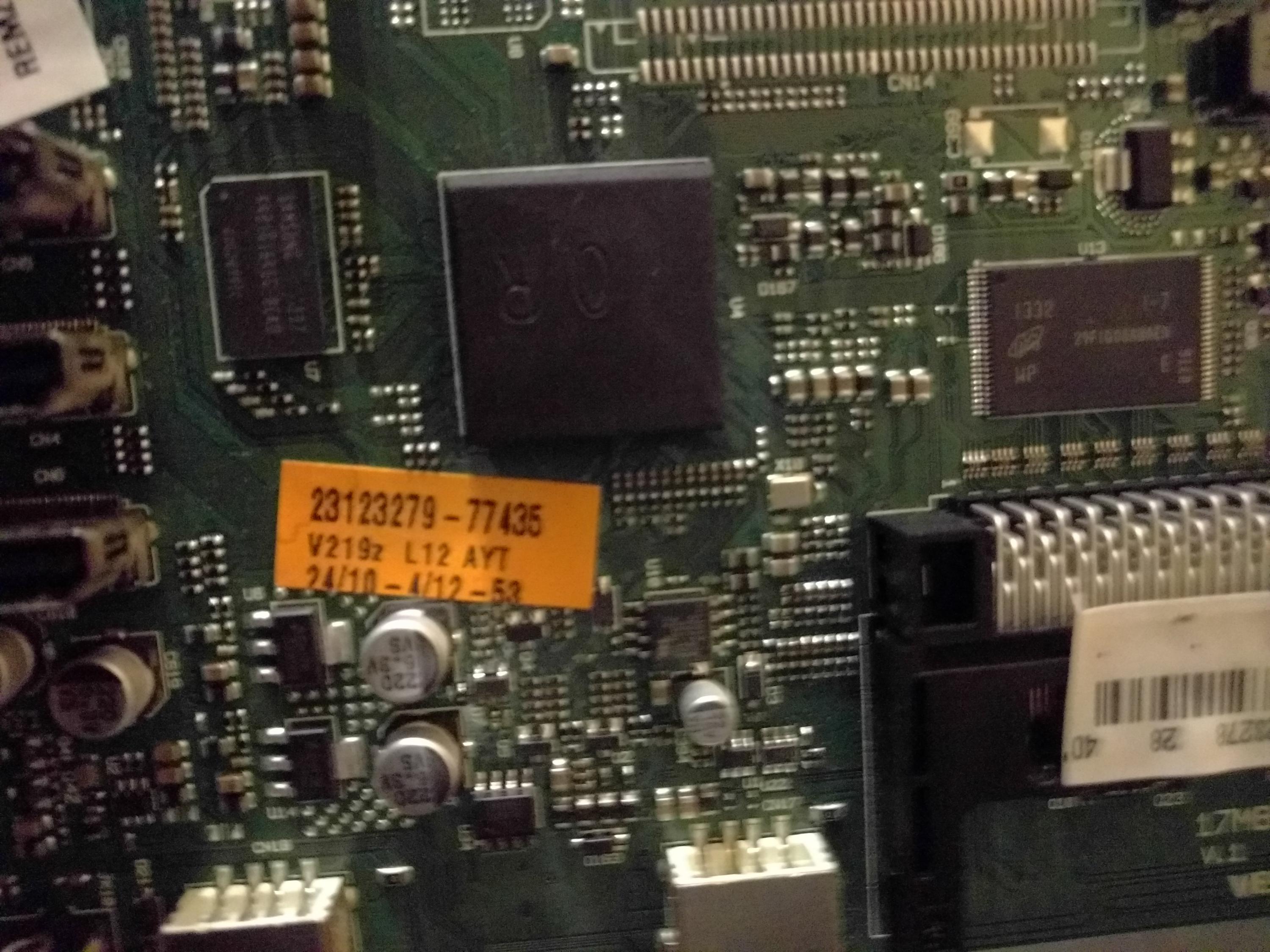

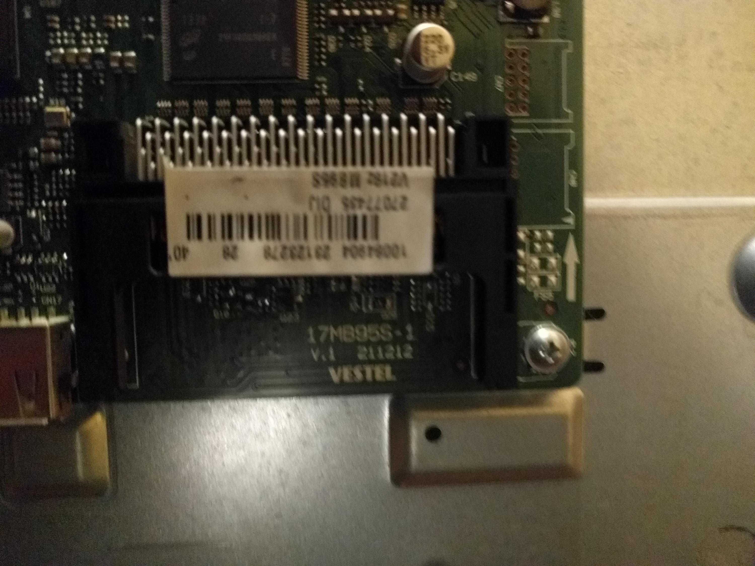

            Ok these are the mainboard. at 1 point when the tv actualy was working for a few hours i did update the firmware to the latest on toshiba website (it had previously been original firmware). the update didnt seem to make any real difference to the operation of the tv just added / changed a couple of items in the menus. hope that helps
            • Diah
              • Feb 2013
              • 6560
              #126
              Re: I think i killed it Toshiba 40L1333DB
              yes this MB what expected, most of them got BGA fault as the CPU chip with out cooling, and many user was added metal shield on it with cool fan.
                ok so replace the mainboard then?
                will any 17MB95S-1 work or must it be 23123279 only. as i cant find the exact part there are others listed as being for the same model tv but they dont seem to have the same part number.
