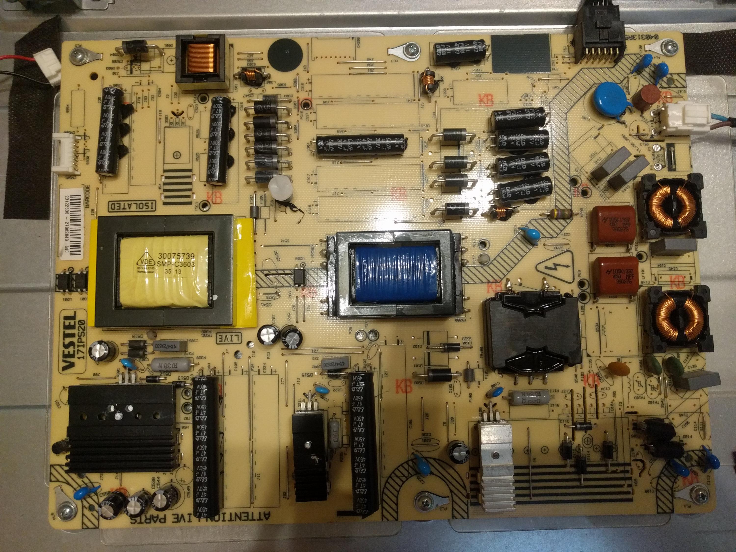

    Hi guys & girls, first of all i better say im no expert in TV repair but im pretty good at fixing CNC machine tools down to board level and phones / android apps, its just TV's i seem to be killing.
    I was given a Toshiba 40L1333DB for my lad to use in his room, was told that the tv had been working and suddenly went off. i had a good look online / here and found that it was probably a backlight failure. with a torch i could see the picture and sound was ok.
    checked there was power coming out of the power supply ( vestel 17IPS20 23122636) which seemed ok.
    took the screen apart to get to the leds and started checking the strips using home made 27v & 3v battery packs.
    all but 1 strip worked but 2 strips had a bad led (open circuit) which were replaced using a piggy back type repair and the strip that didn't work at all was found to have a faulty / burnt connector that was fixed by soldering direct onto the feed point also had 1 bad (short) led that was also replaced.
    feeling proud and smug i started putting things back together again but when i connected the power the thing is now dead, no front panel power led flashing nothing. i know there is power to the power supply but i think i must have shorted something while doing the led repairs. i have disconnected the backlights and main board from the power supply and it is still dead.
    i have found and checked the fuse fs101 which seems to be fine but beyond that im lost so im hoping someone clever might be able to help get it working again.
    i looked on TV spares and found the board but they are out of stock so im really hoping someone might take pity on my and puppy walk me through fixing it. Thanks

    see if you got stby voltage coming from the psu to the main board. STBY is always on as soon as you plug in the PSU into mains outlet.

        just checked and 1 pin to the main board has 24v and another has 12v
        also just checked and there is 84v at the led connection too

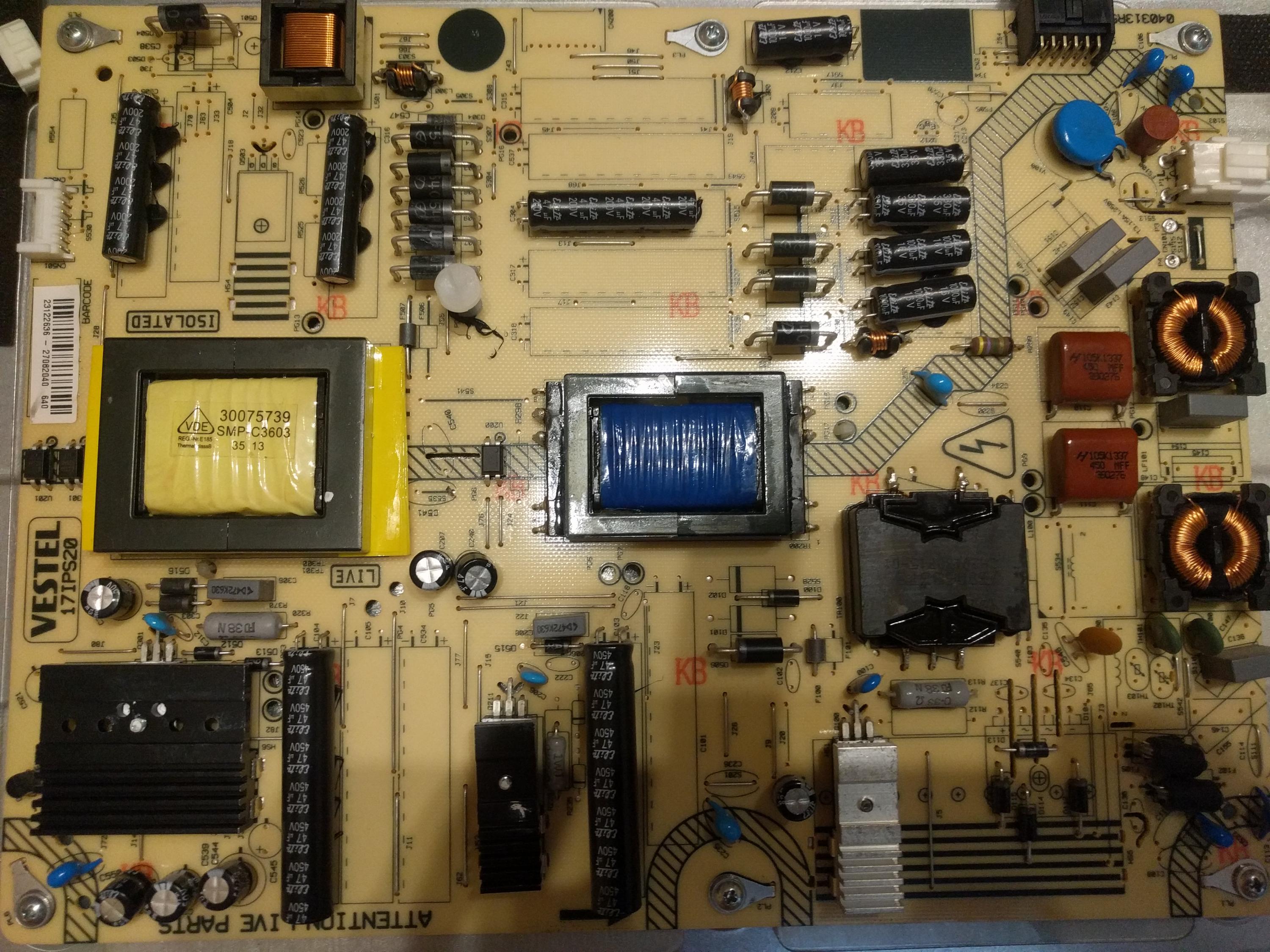

            They will be the 450v capacitors on the 17ips20

              ok thanks. there seems to be 869v ac across those 2 caps
              • sordids999
                • May 2013
                • 2155
                • uk
                Re: I think i killed it Toshiba 40L1333DB
                Measure in dc should be around 390v

                  getting 68.5v dc on both those caps

                            right i picked up my other meter from work today (bloody faulse alarm from the burglar alarm). there is 389 / 390v on both of the 'main caps' so what else should i be checking please?

                                      something is not right. You are measuring 390V on the caps, that means the PSU is full on and the PFC is running. So that again means either you had forced the PSU on, or the main board is stuck in on mode right now, since it doesn't respond anymore and yet turns on the PSU?
