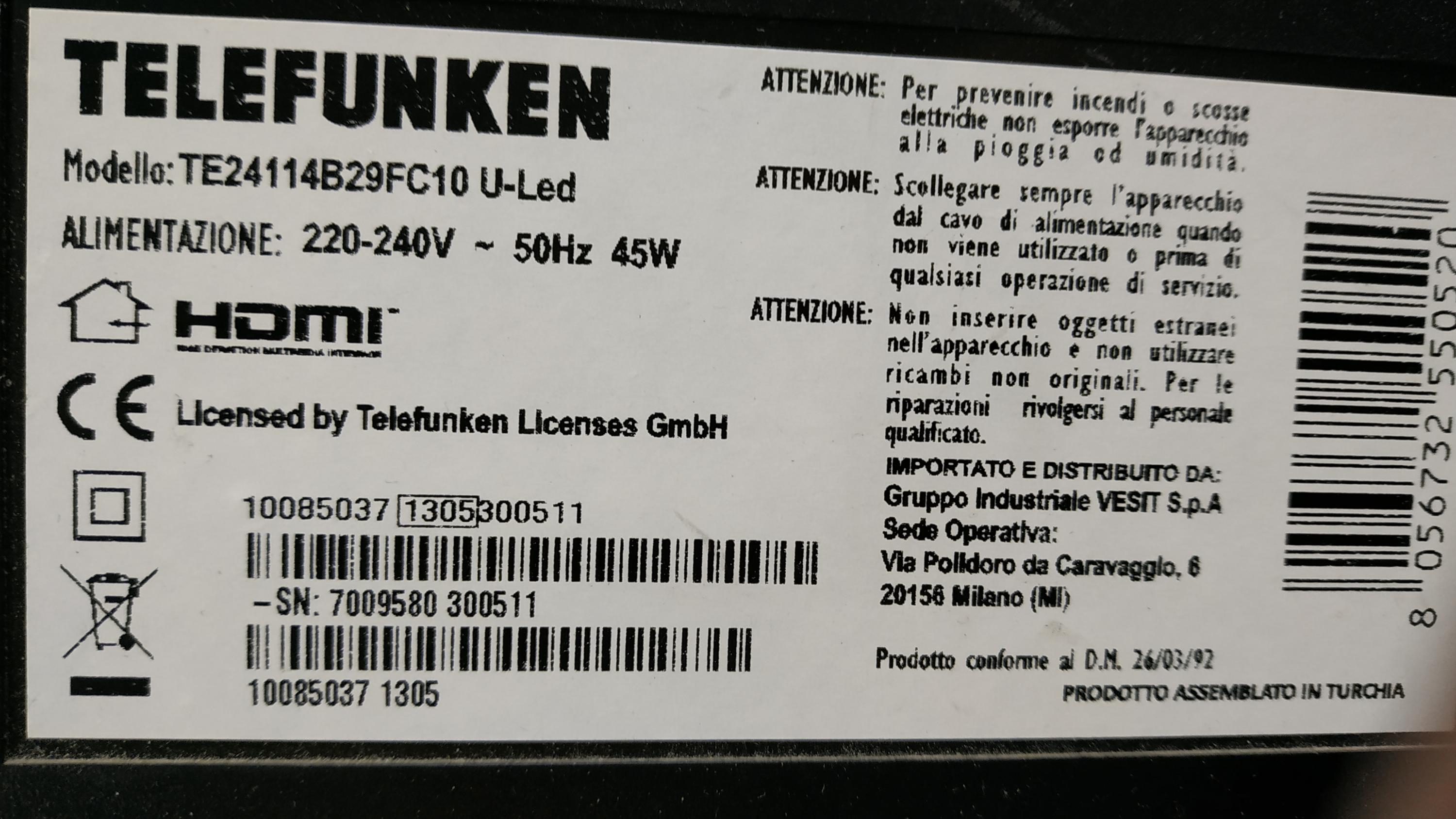

                        I actually don't have the back cover 'cause another dude tried to fix it and didn't succeed and gave it to me.
                        Strange thing tho, today another technician I'm friend with told me he also has one of this 26" vestel tv with the same 17mb82-1a motherboard and he has the same issues as me PLUS he has some issues on the image, but I think it's unrelated.

                                  Hi buddy Back cover model Serial number Picture. Pannel no Picture upload. How Many Inches? Upgrade full firmware ok. Recover firmware ok. 17MB82-1 A firmware
                                  Two days later i m send ok.
                                  • Acca
                                    • Jul 2017
                                    • 47
                                    • Italy
                                    Re: Vestel 17mb82-1a loses memory
                                    Here
                                    7009580 300511
