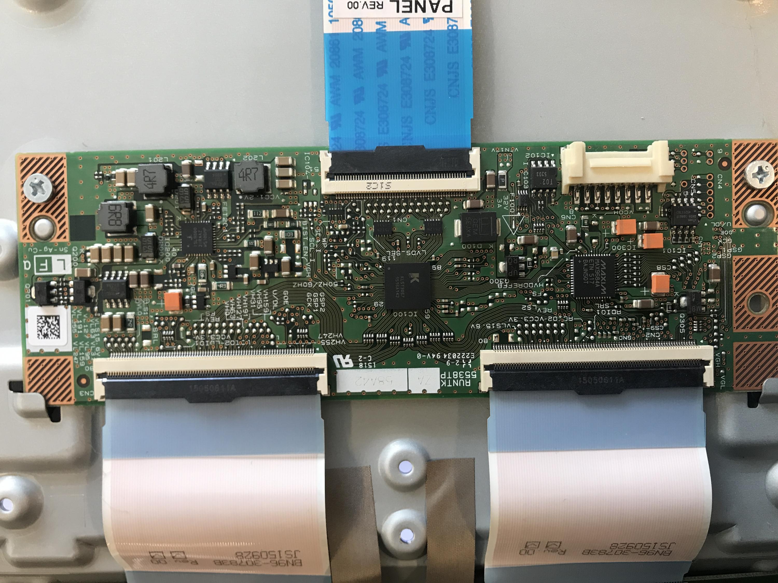

    Hello out there - got this one for free, nothing special but manufacturing date is 2016, so it not that old....
    Symptoms :

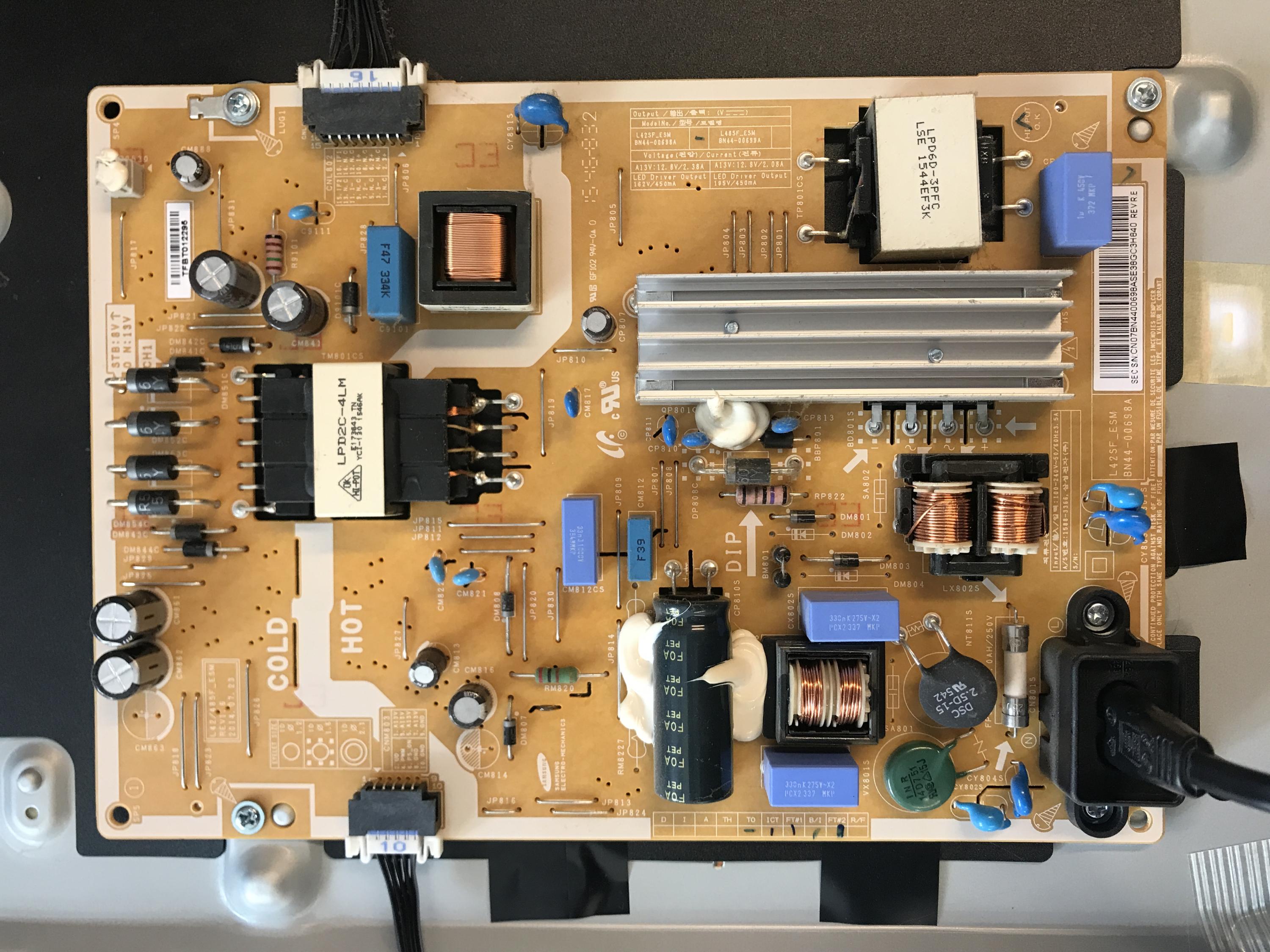

    Black screen, no picture of any kind
    Backlight OK, and backlight also dims after a few minutes
    Reacts on remote control ( ON/OFF )
    No sound when I feed a HDMI signal, but I am not sure the TV autoswitches, so maybe it is just not set to correct input.
    Voltages out of power supply OK

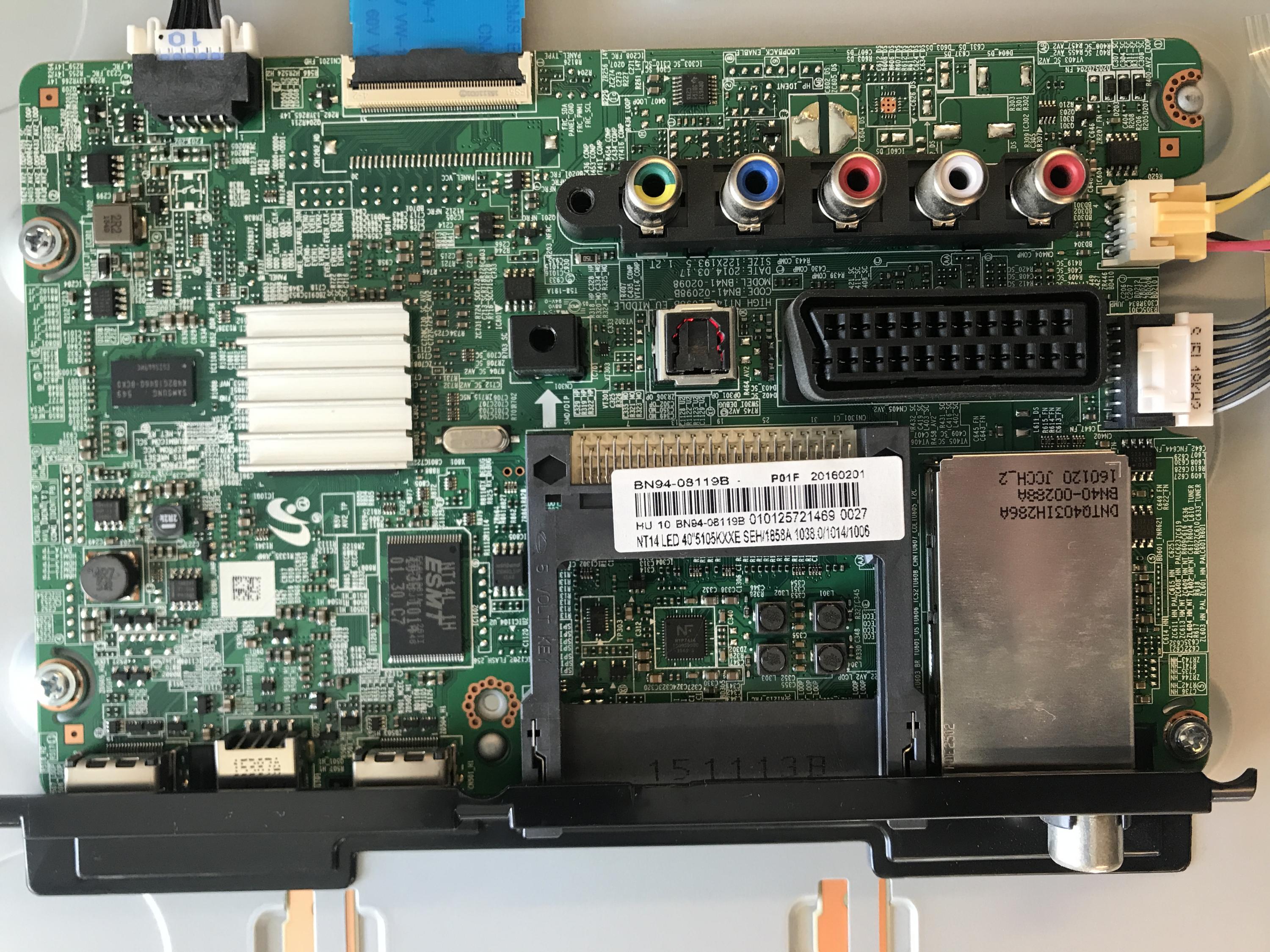

    Main processor becomes hot
    T-con board is cold as ice, and the 12V fed to the T-con passes one fuse ( OK ) and arrives at a single transistor which is OFF - all lower voltages on T-con NOT present ( no voltages on any pin on any IC )

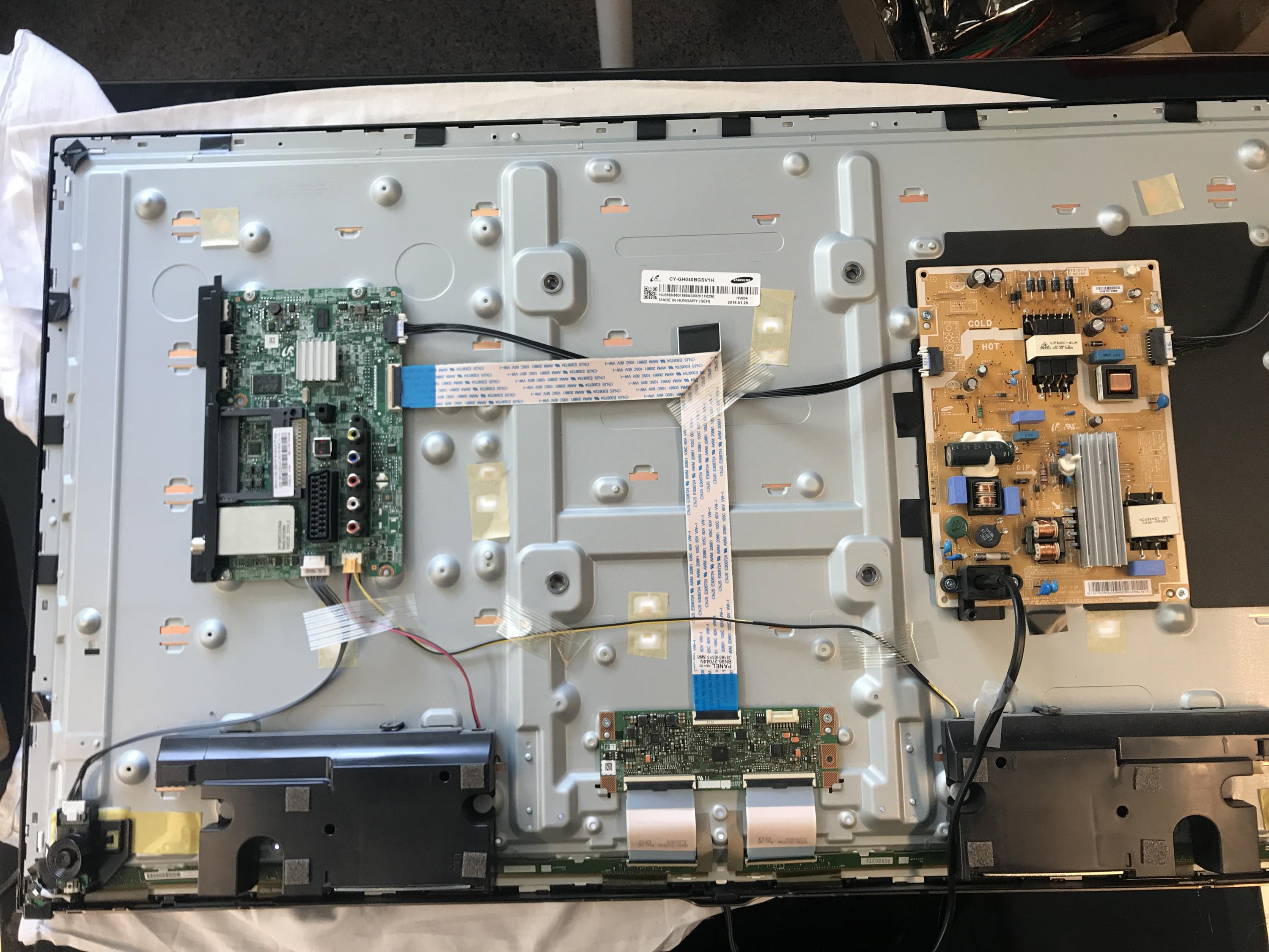

    I have been unable to locate a schematic, but the chassis should be "UH5C"
    Any suggestions ?
    Both T-con and Mainboard can be found a reasonable prices, but which o one to choose ?
    Pictures of chassis and boards attached

    I would try tcon
    i think that tcon is known to fail
    with the isl chip

      Yes. I would go for the T-CON Bd. replacement, also.

        But are you saynig that the ISL9860 probably is the main issue ?
        I can replace it, and it can be bought really cheap......

          First connect if you can a DTT decoder in SCART, only this can autoswitch..
          it have to be pre-selected.. If you get a sound then move to the tcon..
          disconnect tcon>panel ribbons one at a time and try, post pictures if you get an image..
          When you first test a tcon you have to test across capacitor or if present, testpoints, not IC pins, you can destroy the rest!
          Test the VCC1.2V TP

            No VCC 1.2 - Ordered an ISL9860

              Got a new ISL - swapped, and set works :-)
