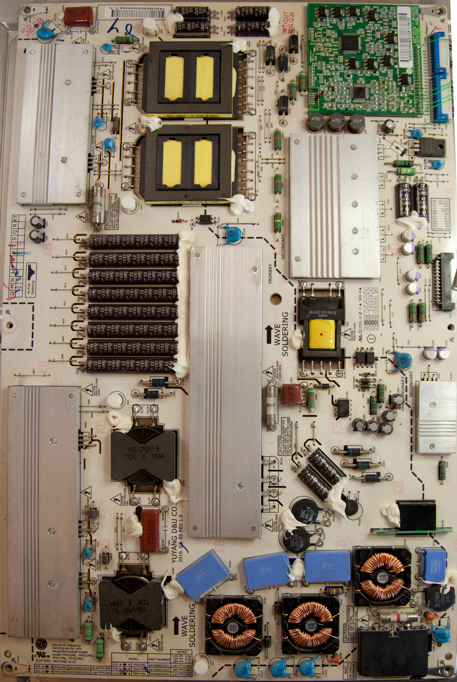

    I'm trying to fix an LG 42LE4500-ZA TV for a friend, and I was hoping someone might be able to help. At first glance it looked like the backlight had gone, but on further investigation it turns out the 20V power output from the PSU isn't working.
    The PSU has the Model: YP42LPBA, Part Number: EAY60803202
    The 3.5V output is working, so the MICOM on the main board powers up and will attempt to power on the TV when the power button is pressed. Power On will go high, the front panel LEDs will do their power on dance and the relay will click on, but there's 0V on the 20V lines.

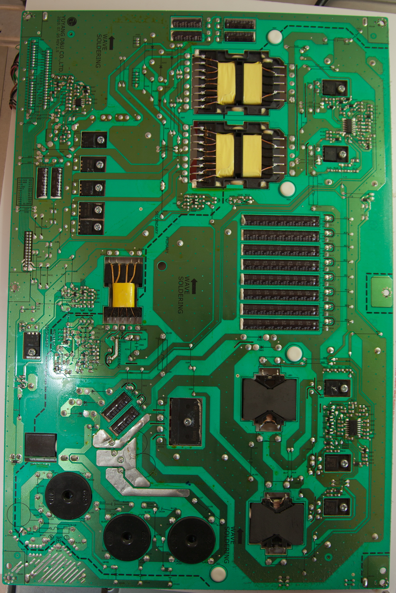

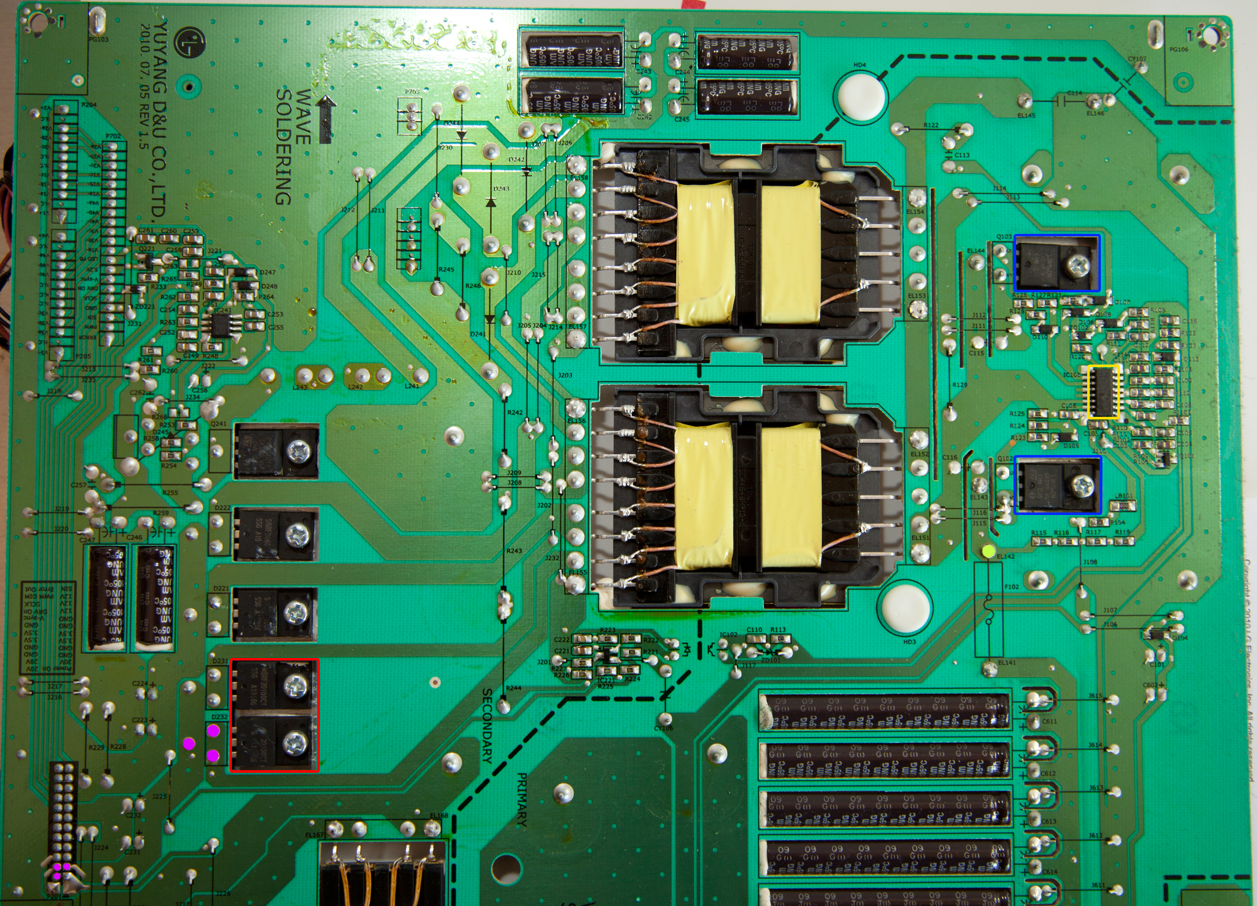

    I've attached several images including an annotated one which I'll refer to.
    I've narrowed down the issue to the top section of the board, as there's a fused 50V input to this section which shows no ripple on the oscilloscope (green point - EL142).
    I've tested the purple points, the 20V output pins on P201 and the inputs and output of rectifier D232, these show 0V with no noticable noise/ripple above the noise from my cheap oscilloscope.
    The highlighted packages are:
    Blue: STF13NM60N MOSFET https://cdn.badcaps-static.com/pdfs/...ba5c2ba3ce.pdf
    Red: MBRF20100CTG Rectifier https://cdn.badcaps-static.com/pdfs/...e518a26d5c.pdf
    Yellow: ST L6599 Resonant Controller https://cdn.badcaps-static.com/pdfs/...7cd0b455f4.pdf
    So this is an LLC resonant bridge converter apparently, which I've done some research on and concluded that I have no idea how an LLC resonant bridge converter works or how to debug one!

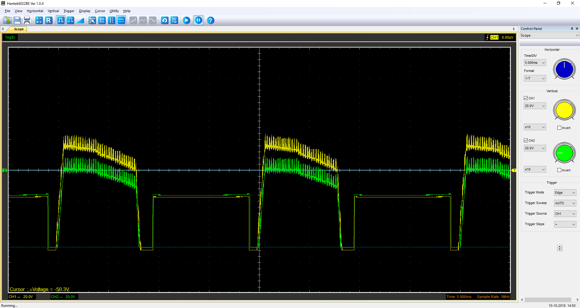

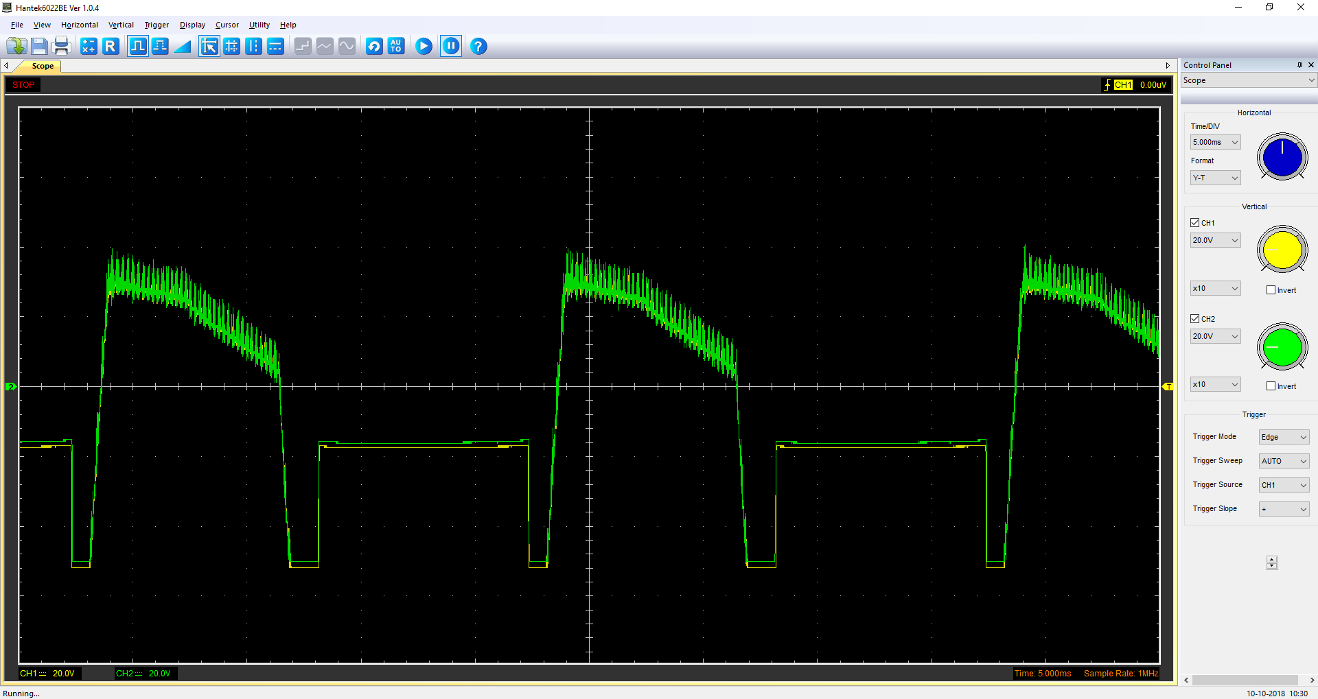

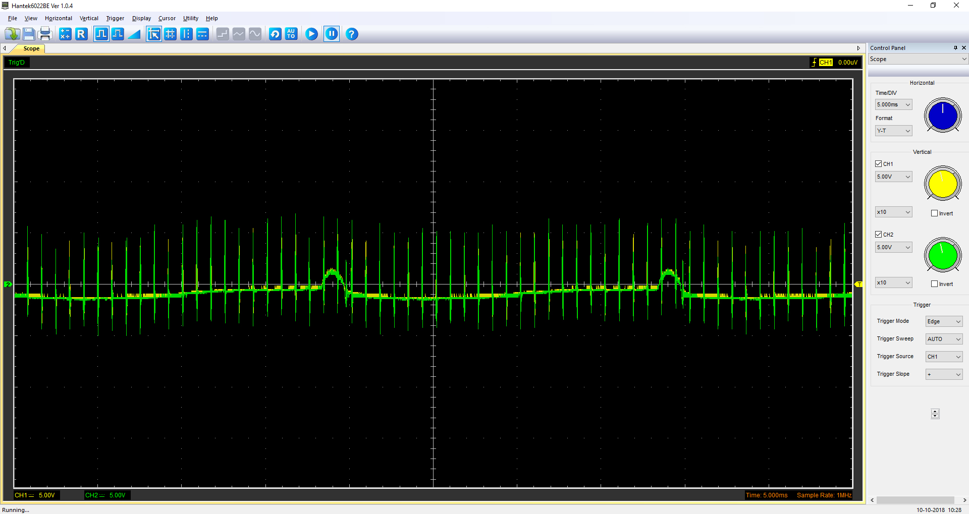

    I did try probing the inputs to the lower transformer and got the attached results (one in standby and the other 'on'). It doesn't look right to me, but I wouldn't know what does look right either.
    I can replace the PSU as a last resort, but if it's a component I'd rather just replace that (unless it's one of the transformers, I can't find sources for them anywhere).

      I'm checking for 20Vdc on the output of the rectifier on the cold side (getting 0Vdc), and I'm looking for 20Vac on the inputs of the rectifier which are connected directly to the output of the transformer (getting 0Vac), but I've also measured from the pins of the transformer directly to be sure.
      I'm wondering if I'm not doing the measurement correctly because I'm so used to DC. I'm connecting the reference wire of my probe to the chassis ground - which I've checked is connected to the GND pins on P201. But that's DC, do I need a different 0V reference for the AC?
      Also I completely forgot to check the 12V rail, this is also showing 0Vdc on the output.

        Are Q102 and Q103 getting power at the S pins? IC 101 could be malfunctioning, too.

          I attached the probes to both Q102 and Q103 S pins and the result looks very similar to the input to the transformer (see attached). Voltage doesn't go much above 0, but goes as low as -50V.
          From what I gathered from IC101s datasheet Q102 and Q103 should be alternating, but they're in perfect step.
            Re: LG 42LE4500 - No 20V rail
            1) It looks like you use chassis GND for your scope, the negative leg of the main filter cap is the GND ref for meter and scope, you better make sure that the TV is plugged into the isolation transformer when using the scope on the hot side otherwise you will see nice smoke and spark if the scope GND is tied to the scope incoming AC SAFETY GND.
            2) "I've narrowed down the issue to the top section of the board, as there's a fused 50V input to this section which shows no ripple on the oscilloscope (green point - EL142)."
            it shows 50V because you use the wrong GND as explained above, it should have about 390VDC with ref to the negative legs of the main filter caps (those lytics caps with 450V rating on them).
