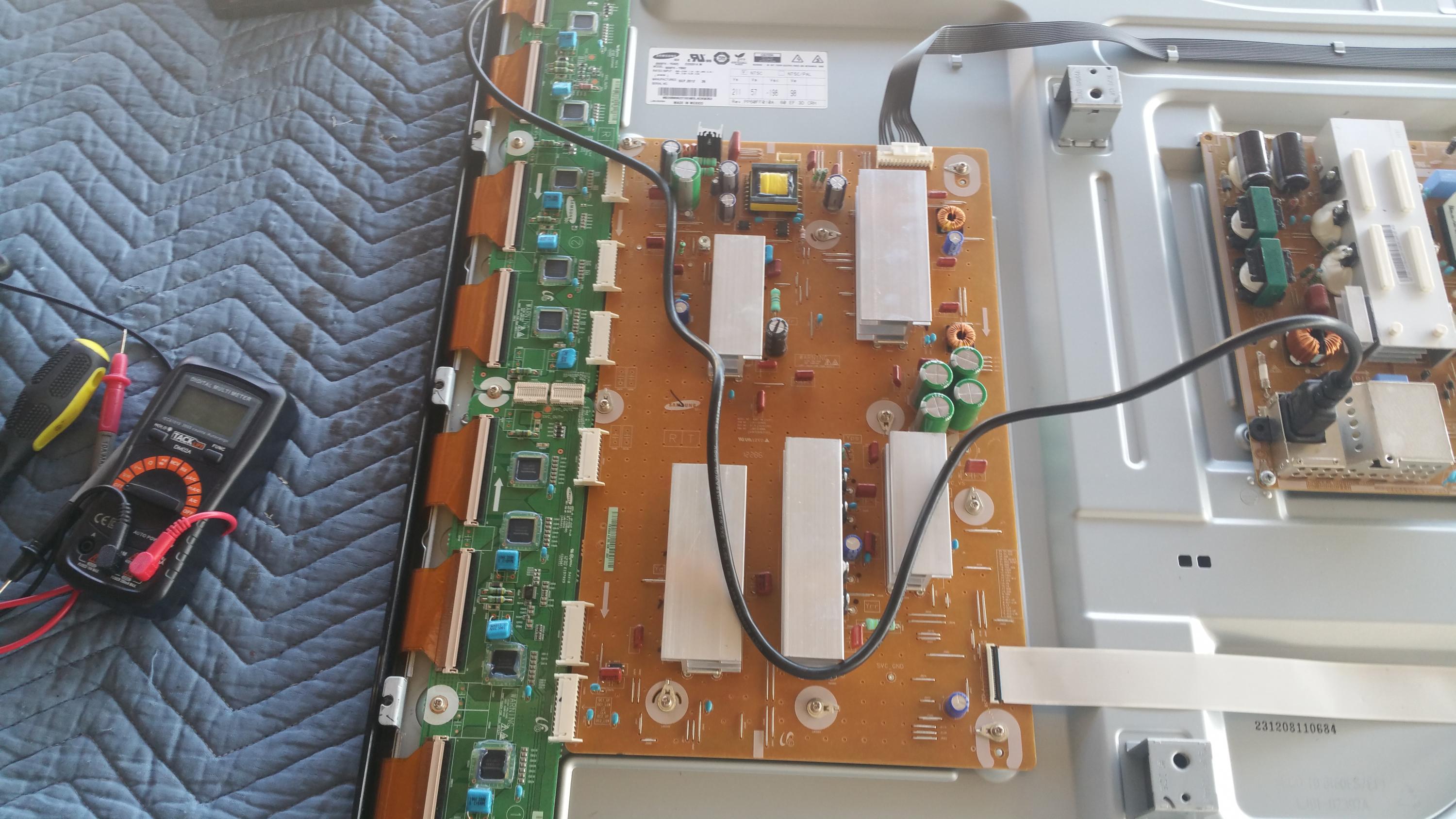

    On VS (marked) I get 210V that quickly counts down to 15V
    The Control Board LED (marked) blinks slowly.. 3sec off, 7sec on... 3sec off, 7sec on...
    That's all I have so far...

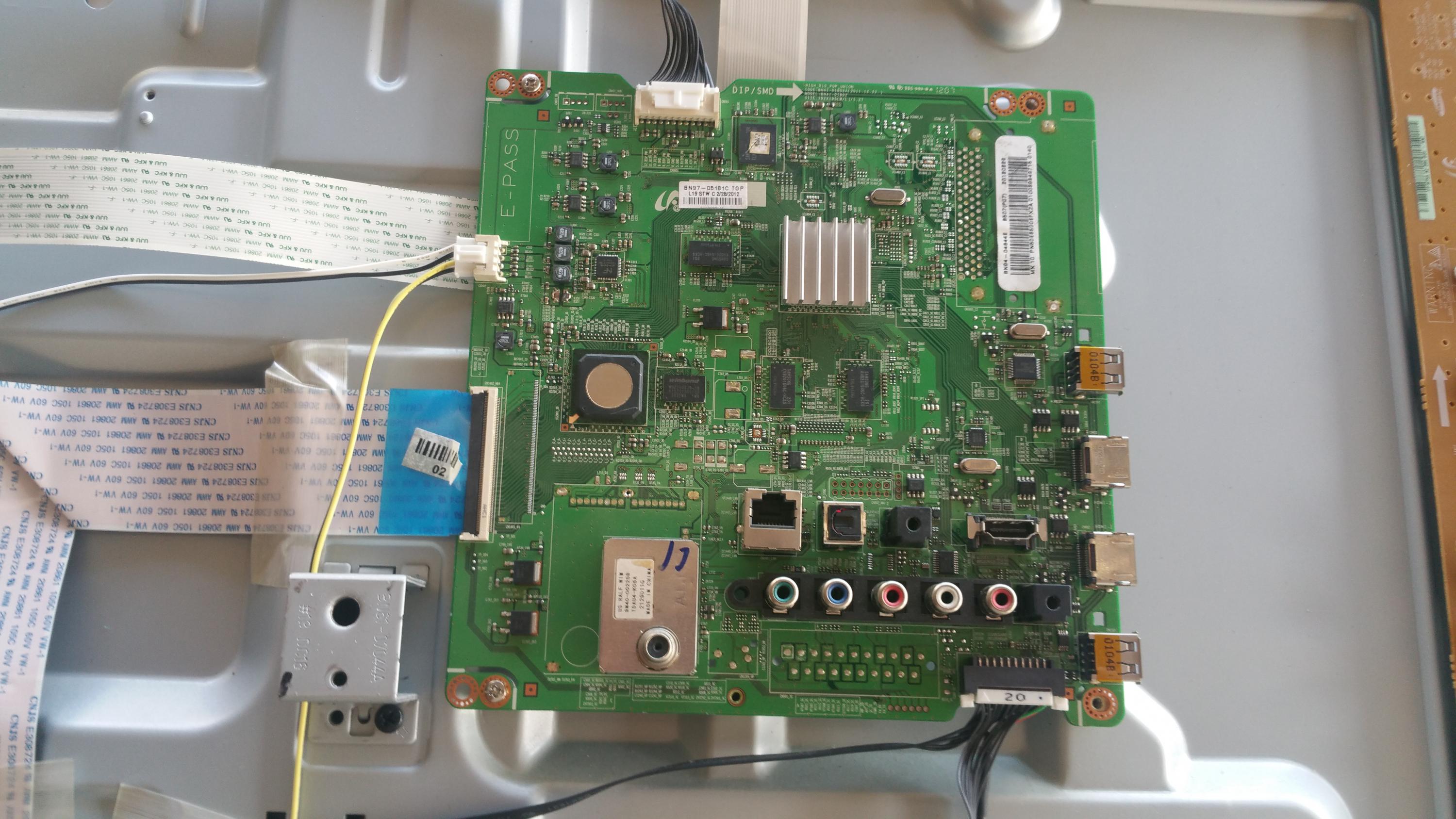

    Thinking it was a Main Board issue, I found a good deal on a replacement Main Board..
    Still have the same problems..

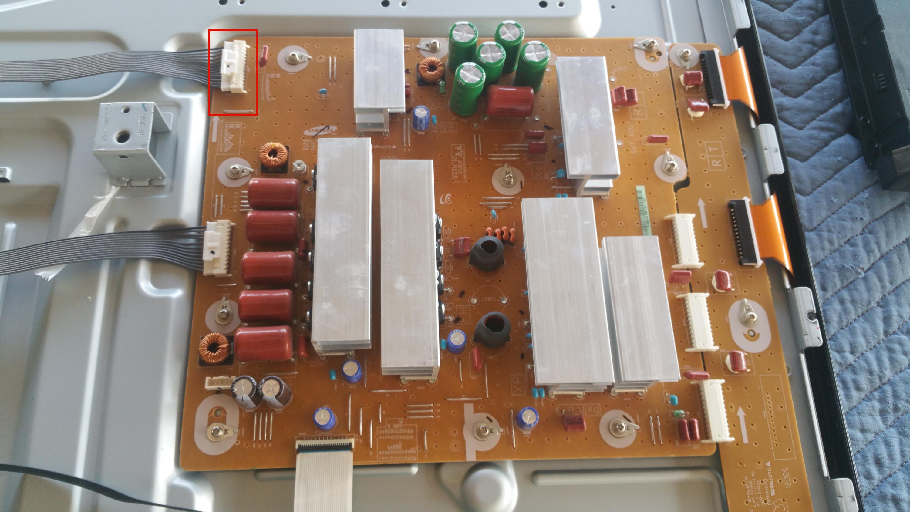

      ... that had a comment from MagicSmoke about testing this TV:

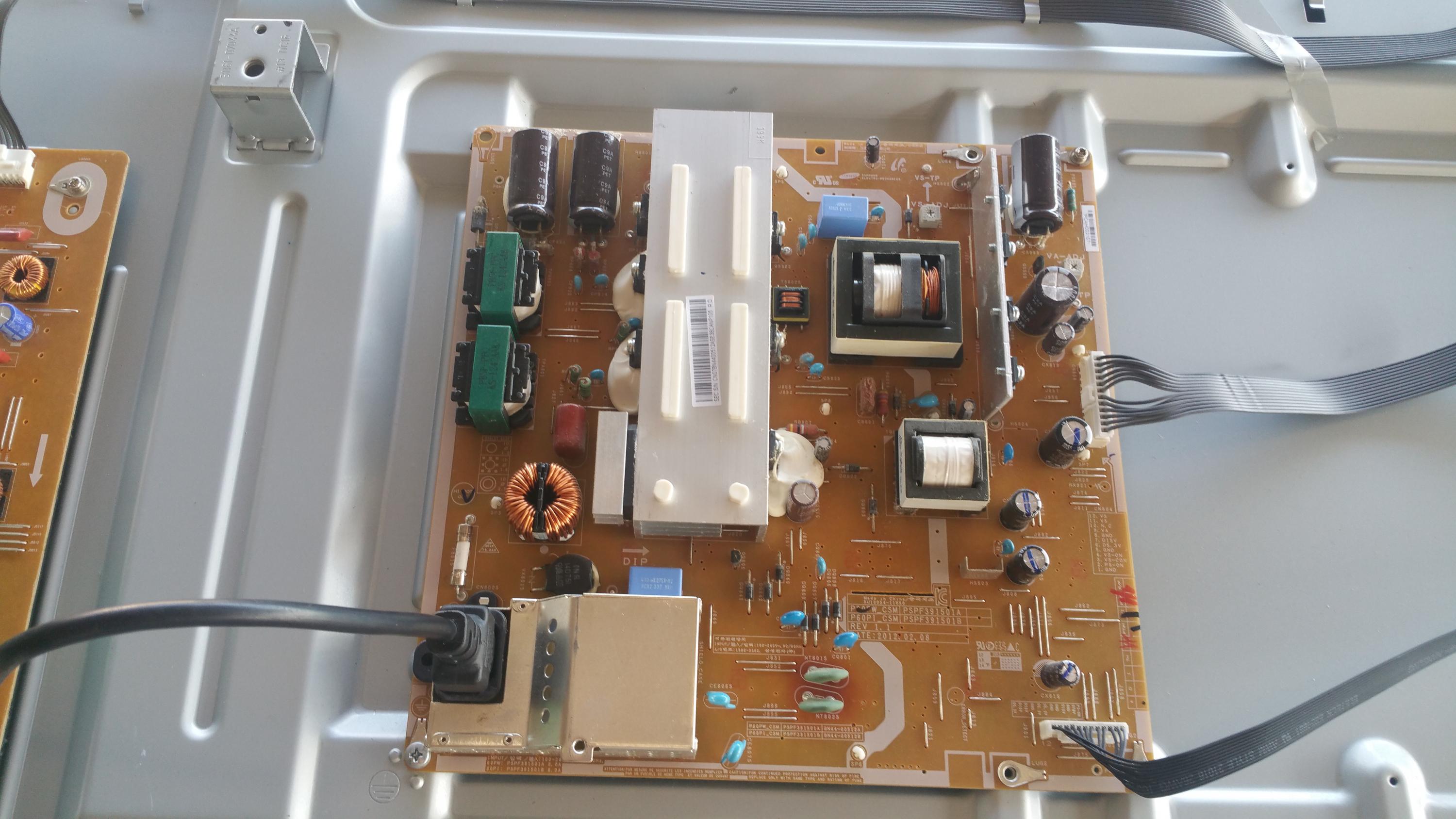

      This is the same PSU as in my pn60e550. To test VS and VA volts you will need a 1K ohm 1/4 watt resistor.
      Disconnect from AC before doing this
      Remove power cable from x main and from main board for this test. Now on the X main side of power cable insert resistor in pins #4 VS-on and #6 5.3v,Logic board sends the signal through X main to PSU for VS on. Plug into AC.
      This will turn on PSU and VS should come up and be stable at panel sticker rating. There are test points on PSU.
      If they don't come up or are unstable then the PSU is at fault. If they are stable then further testing is required.
      Edit... you can use a jumper wire instead of the resistor without damage, but VA & VS will read higher than normal volts.
      I am not sure I am understanding this.. It seems like I am supposed to disconnect all the power cables, but if I do that, how will inserting a jumper in the X-SUS cable affect the PSU???
      Thanx in advance for any assistance.
        I think he means disconnect it at the X-Main board end of the cable so you can just stick the resistor in the end of the cable instead of trying to jumper directly on the PSU board.

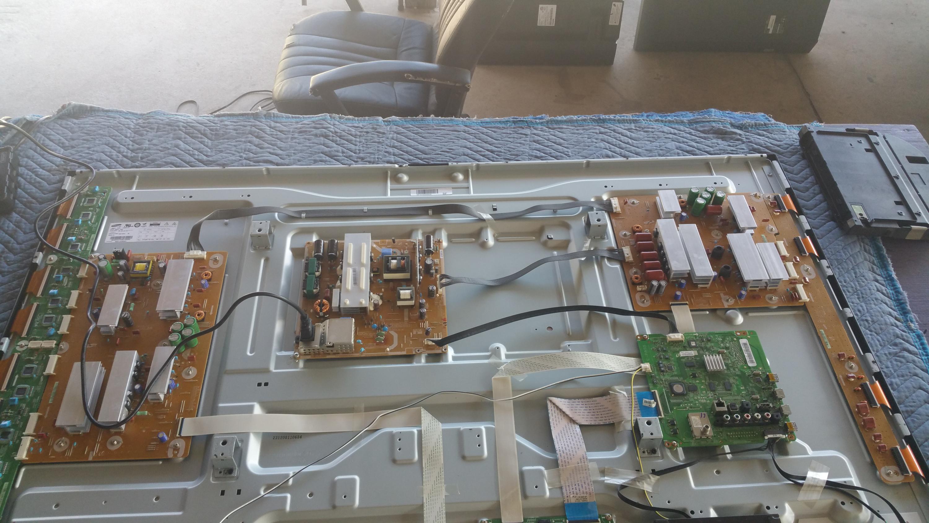

            OK I have it on the bench...
            I disconnected the cable between the Power PCB and the X-SUS... I jumpered #4 & #6....
            Powered the TV on and got a steady 217v.....
            I am now smarter than I was 10 mins ago..
            Err.... What do I know??

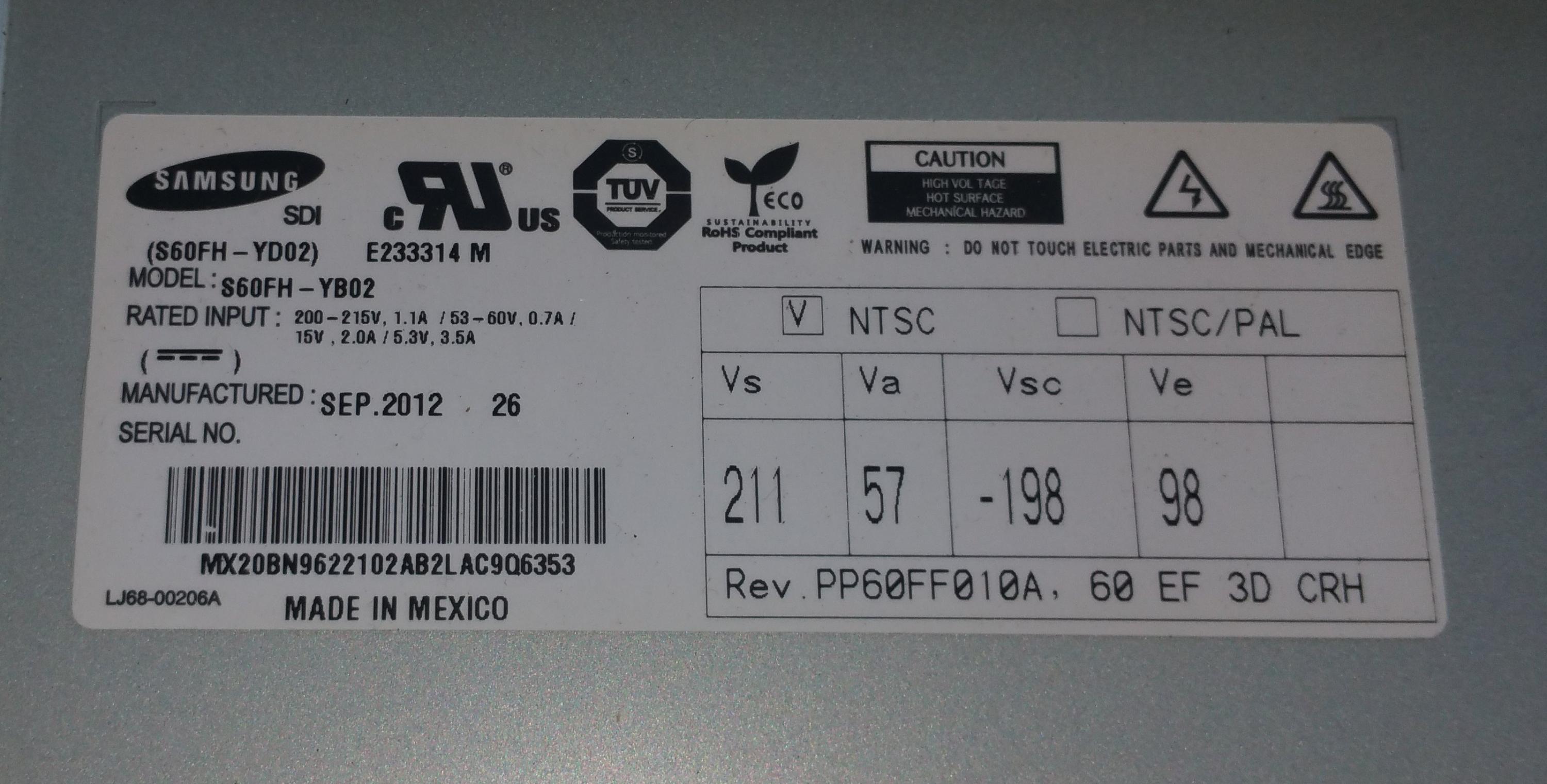

              Are you using a resistor for jumping the PSU on? 217 looks high, your sticker photo is blurry but isn't it supposed to be 211? What is your Va? In any case, as long as Vs and the Va are present and stable, the PSU is probably OK.
              If they're fine, re-connect all the cables and check the other voltages. What does Ve do, and more importantly, what does -Vscan do? What does the VCC supply (pin 7) to the IC at U5014 do? Do you see the proper 0.9V at pin 1 indicating that the internal current source is functioning? (This helps tell whether it is likely the chip itself or it is the C5162 capacitor.)

                OK It occurred to me that what I know now is that the X-SUS is bad..
                Replaced the X-SUS board.. Checked the voltage held steady at about 210v..
                OK, great...
                Then I noticed that I had forgot to ground the X-SUS board by screwing the screws in....
                Powered down and put all the screws in..
                Powered back up.. Power LED blinks randomly and constantly and I get no voltage from the Power PCB..
                Could not grounding the X-SUS board have fried either the board or the Power PCB???
                      Yea, the Original Poster said that if you use a straight jumper (which I am) the voltage will be a bit higher..
                      VA - 57vc which is right on the mark..
                      VSCAN is dead...

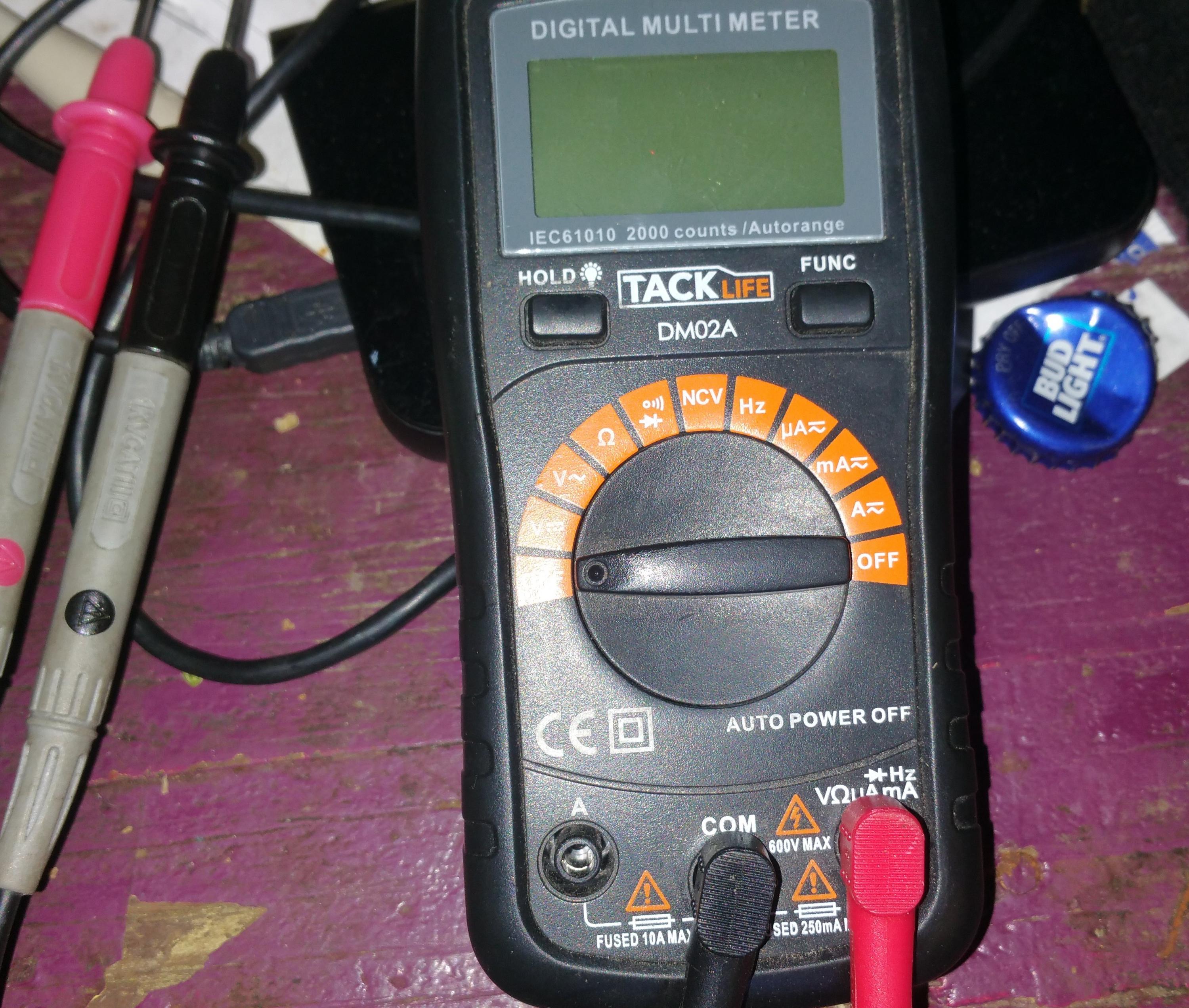

                        I don't have anything in the way of scopes.. Just the pictured voltmeter. Bud Light is optional...
                            Heh... 1100+ posts and no oscilloscope.
                            Does your meter have a min/MAX function? If that chip doesn't see close to 18V on VCC and actually start, you get insta-lockout.

                                    Re: Samsung Plasma PN60E550D1F Power LED Blinks, Appears To Come On, No Display
                                    OK... Pulled the Y-SUS out of the deep freeze.. Put it in the TV... I get -180v out of VSCAN, but (like VS) it starts counting... er up....
                                    I may not have got it cold enough.. What area of the Y-SUS would I shoot with the freeze spray.. Might be more conclusive..
