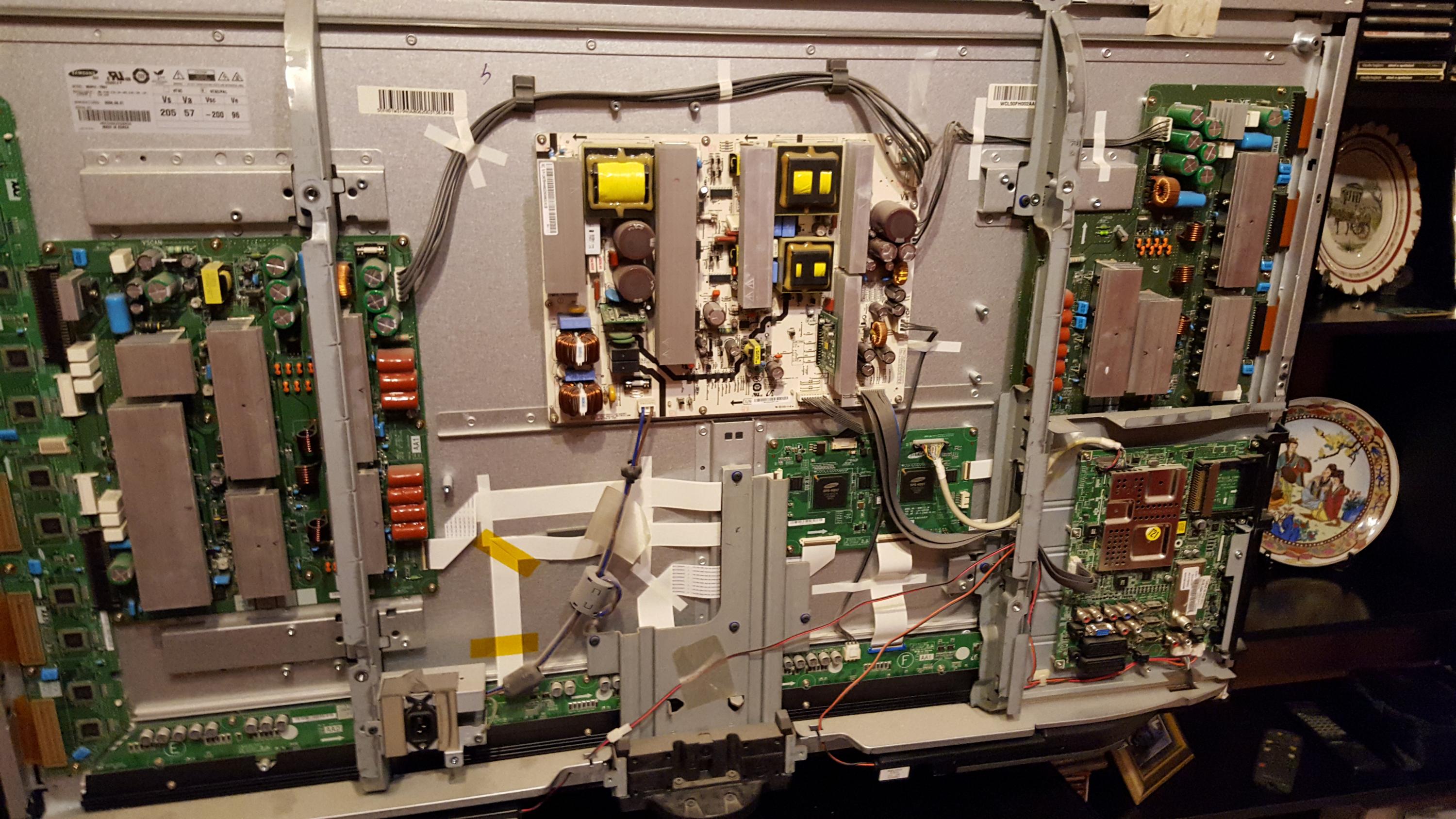

    Defect description:
    I feel the relays that are constantly attacking and disconnecting.
    I tried to disconnect the X and Y cards, the problem persists.
    however, disconnecting all cables does not do anything. I do not hear any relay.
    In the lower right-hand connector (the one connected to the main in the bottom right-hand corner) I find the standby voltage 5.22V.
    As soon as I connect this connector (CN801) I hear the relays that do attack and detach and then I discovered that the card near the heatsink by a kind of code with the green led.
    Two cyclic flashes. Do you know what it refers to and if there is a diagnosis table?
    (I attach the video)
    Video
    I removed the CS809, the condenser seems good to me.
    What other tests can I do?
    Thank you

    Re: Samsung PS50A656T1FXXC PSU: BN44-00222A
    Hi guys, I guess that only now I realized that the power board works.
    After almost dismantled piece by piece the feed card, checked Mosfets, Electrolytic capacitors and replaced those that in my opinion had strange values, diodes and resistances ....
    I reassembled everything and nothing has changed.
    So I fix everything, but a little annoyed I said, I have to start the power supply without having anything connected, so if I do not have tensions I order a new card. But instead....
    Then only power supply connected without X and Y card or other cables. I connected the CB802 cable, the one that goes to the logic board below, but without connecting the other end.
    Connecting PS_ON to GND and VO_ON to 5.3V, but the power supply does not start.
    Then I look at the CB801 connector where it is connected to the motherboard.
    So I connect in the CB801 PS_ON to GND without connecting it to the mainboard.
    While on CB802 connected VS_on to 5.3V
    Now I do not hear relaying interviews, and I see that the power supply goes, all the voltages are present.
    Then I continue with the tests by making stress on the tensions, I wait for you to download everything before putting hands on.
    Disconnect the main from the login tab so you do not have any links.
    Connect CB802 to the logic board below, leaving the jumpers PS_ON and VS_ON unchanged.
    In the logic board I jumpered the famous pins 3 and 4.
    Food all, I do not hear the power supply board relays,
    I see on the TV that seems to light up and the green LEDs on the logic board light up.
    I remove the alimntatore, because I wanted to see if removing the VS_ON connection the logic board worked.
    But from now on, both when I connect the logic board or the motherboard, I always hear the power supply relays that are going on and off as before.
    Disconnecting these two cards, the power supply works.
    Can I do a few more tests to figure out if at least the logic board is working?
    Because if I only connect the motherboard to the power supply, it's the fault. Like now with the logic board.
    I hope in an advice, thank you

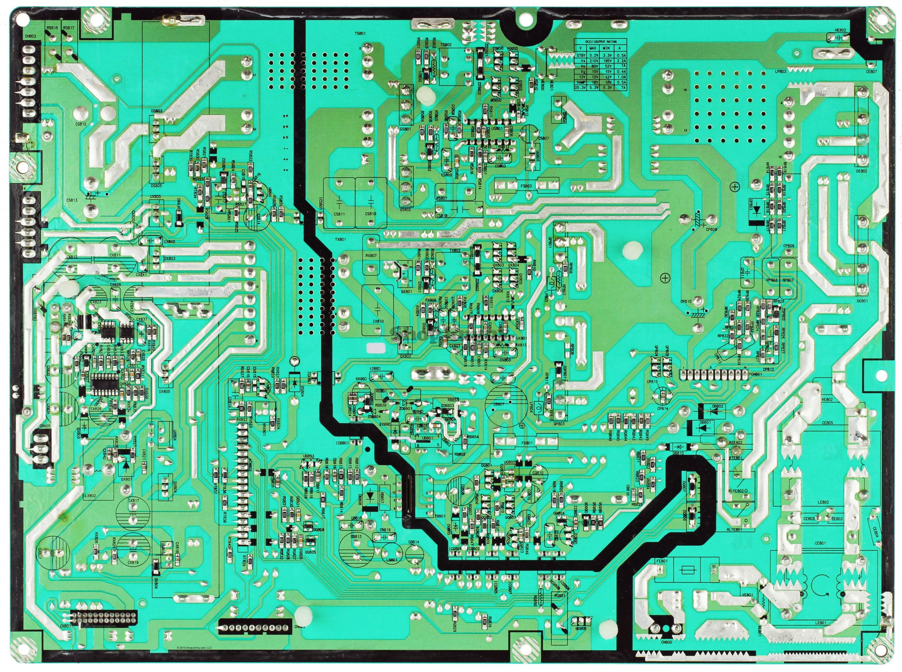

                  Check the voltage on CX823 or CX824 to see if it is ok and stable. (you can check this voltage on the anode of DX809 near CN805)
                  The Va voltage comes from the same transformer as the 5.3v so if it is stable the 5.3 should be also.
                  Sometimes CX810 (square blue capacitor) can be bad (47nf/1250v) Check that it is not cracked or bulging.
                  You may also have a fault that is loading down the 5.3 volt line.

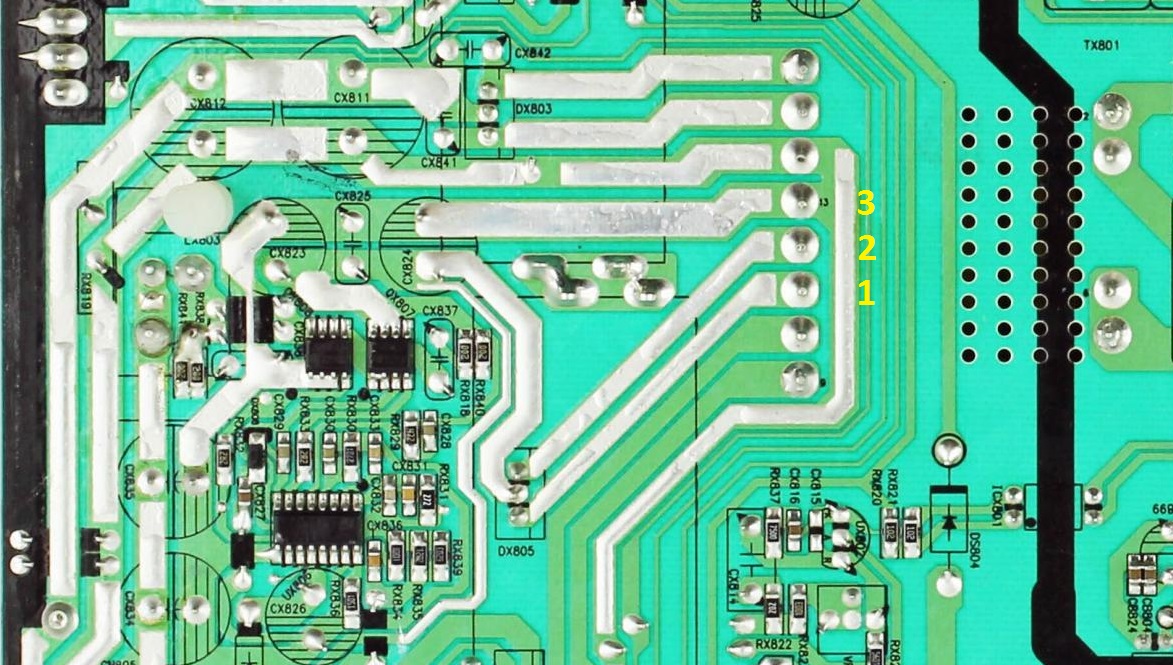

                  Here is a good picture of the bottom of the board.

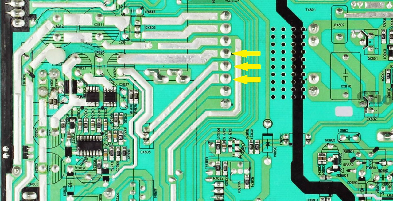

                      The anode of DX809 is connected directly to the two capacitors of CX823 & CX824, the transformer supplies DX805 diode which is the source for the 5.3 volts.
                      It is before the two QX807 and QX808

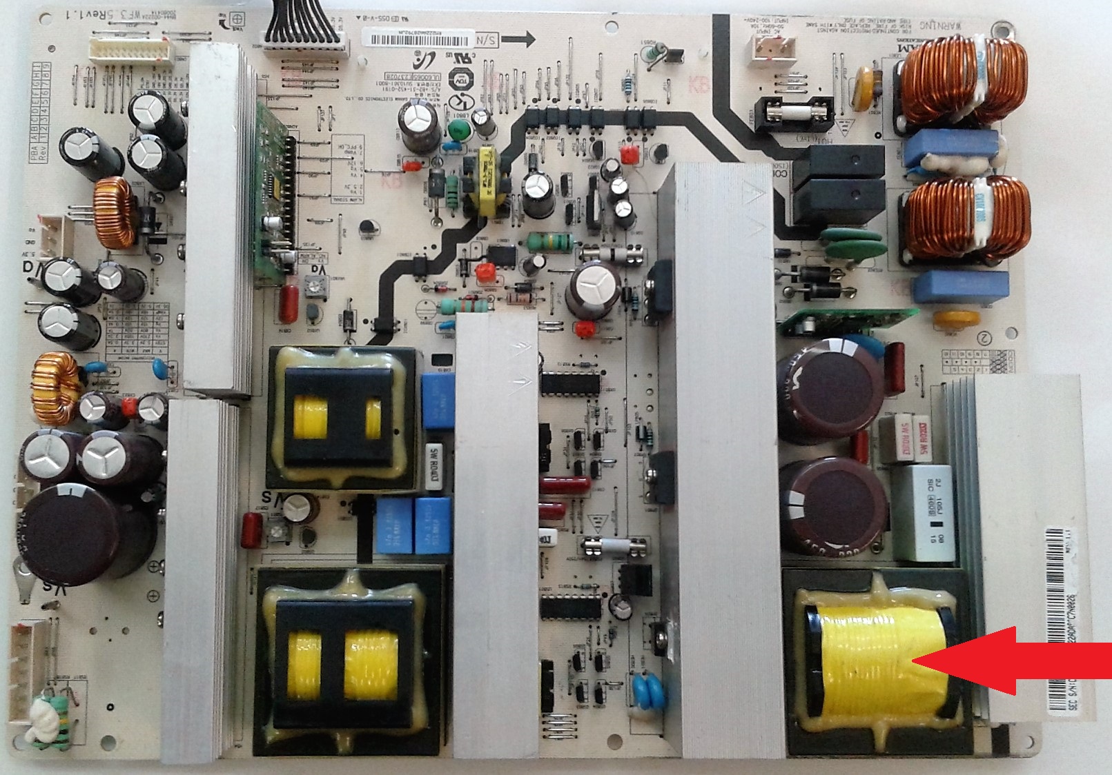

                        I will do these measurements and let you know.
                        Also check the board for cold solder joints like this thread https://www.badcaps.net/forum/showthread.php?t=57754
                        Unfortunately I'm not as lucky as him, I have good welds.
                        Last thing I want to say is this:
                        I feel a kind of "buzz" in the transformer indicated with the arrow.
                        But I'm not 100% sure.
                        When, after a while, the 5.3V stabilized; the "buzz" ended.
                        I hope I have given some other input.
                        Thank you

                          That transformer is the P.F.C. transformer, check the pfc voltage on FS803. The pfc voltage should be around 400v, measure it and see if it changes.
                          Did you check the two fets on the 5,3 volt output? if one is shorted you would still get 5.3 volts but it would likely vary.

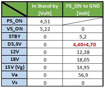

                            Yes, I measured. With PS_ON connected to ground, on the two electrolytic capacitors, I find 396 Volt. I think they are ok. What do you say?
                            Yes, I do not think there is a short circuit.
                            Returning to what you asked me some time ago:
                            I checked, at that point the voltage oscillates between 9.08V and 9.30V.
                            Therefore we can exclude the controller (L6525) and the two mosfets QX807 and QX808 (25H3LL).
                            right?
                            From what I can see, first there is only the DX805 or even the transformer first.
                            In your opinion what measures can I do?
                            I enclose the photo of all the measurements made today.

                              What is that voltage D5.3 if the power supply is connected in the tv. If there is no load on the D5.3 I can not see why it would be changing.
                              • Bobo360
                                • Sep 2018
                                • 36
                                • Italy
                                D5.3V indicates the voltage at 5.3V, as shown in the table.
                                I have no card collagata to this power supply, I will reconnect them if I can stabilize the 5.3V.
                                I would not break other cards. (I hope I have not already broken them.)
                                Since the transformer that generates 5.3V, it also generates the Va (57V) and is stable.
                                Can I rule out that it is the fault of the transformer and all that is on the primary side?
                                Can I control the CX823, CX824 and CX285 and the DX805?
                                In your opinion could it be one of them?
                                I think an oscillating tension could be a condenser, what do you say?
                                But the following points shown in the picture, can I measure them with a multimeter?
                                Thank you

                                  You need a scope to measure those points indicate by the yellow arrows, that is high frequency a/c (20-50 khz) Can you place a load on the 5.3 volt line? you can use a 5Ω 5 watt resistor to draw about 1 amp
                                    Unfortunately I do not have an oscilloscope.
                                    But I disconnected and tried the following components.
                                    CX823 = 924,1 uF
                                    ESR= 0,18 ohm
                                    Vloss=1.3%
                                    CX824 = 918,8 uF
                                    ESR= 0,17 ohm
                                    Vloss=1.3%
                                    CX825 = 1040 nF
                                    ESR= 3,9 ohm
                                    I can think they are good and I have put them back together.
                                    I said, I did not have the osciloscope. I used the Wavetek Meterman 34XR multimeter. I attach pdf.
                                    I performed the following tests, with the points shown in the figure:
                                    1-3 V=379mV RMS; Hz=53,6Hz; Duty cycle=48,1%.
                                    2-3 V=378mV RMS; Hz=53,6Hz; Duty cycle=48,5%.
                                    1-2 V=3,626 V RMS; Hz=53,6Hz; Duty cycle=47,7%.
                                    I do not know if they can be useful, but I'm reporting them anyway.
                                    I tried again to measure and gave about 9 volt.
                                    This is a test I can do.
                                    PS:
                                    Today the very stable tension, very often the 5.3V came out.
                                    Perhaps because the capacitors are unsoldered and resoldered? boh.
                                    PSS:
                                    When the tension is unstable, I feel a sort of "tic tic" at the DX805. Do you suffer from 50kHz?
                                    PSSS:
                                    DX805 -> F20SC6 Schottky Rectifiers, Do you know a better known equivalent?
                                    PSSSS:
                                    Since the 5.3V transformer is the same as the 57V, we can rule out that it is him. Or it is not said!
                                    If you have any other suggestions, I'm grateful.
                                    And all the advice you give me.
                                    I always learn something more.
