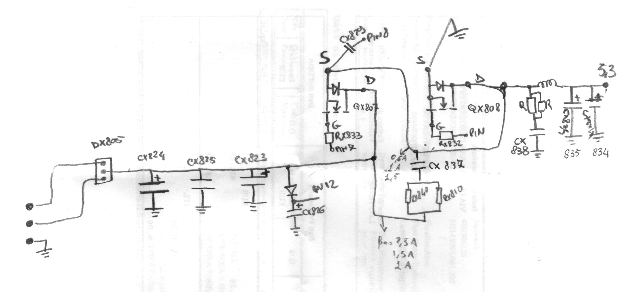

        Re: Samsung PS50A656T1FXXC PSU: BN44-00222A
        I want to write to you because I solved the problem.
        I changed then:
        CX822, CX819, CX817, CX826, CX834, CX835, CX823, CX824, CX812, CX811, CX841, CX825, CX812, CX820, CX837
        and also the big CS813.
        Some are small and non-electrolytic.
        I changed them in steps, not all together, to see how it went.
        So I decided to go a little bit upstream of the circuit and install a resistance and see the absorption.
        Starting from a small amperage.
        Type at the output of the DX805 that there are about 9 / 10Volt, I was absorbing 1A, 1.5A and 2.5A.
        Then before the QX807 mosfet in the same way.
        Then after the QX807 but before the CX837 and the QX808.
        Then after the QX808, but increasing the amperage.
        Finally just before the CX835 with a 1ohm resistance to absorb about 5A it held quite well.
        so I disconnected everything connected to the motherboard and logic board and all is well.
        Following the circuit I had made a card, which I attach, so that I could make these arguments.
        But I wonder why it came back to work by passing some current increasing from time to time?
        Any mosfets blocked? or what?
        Thanks a lot.

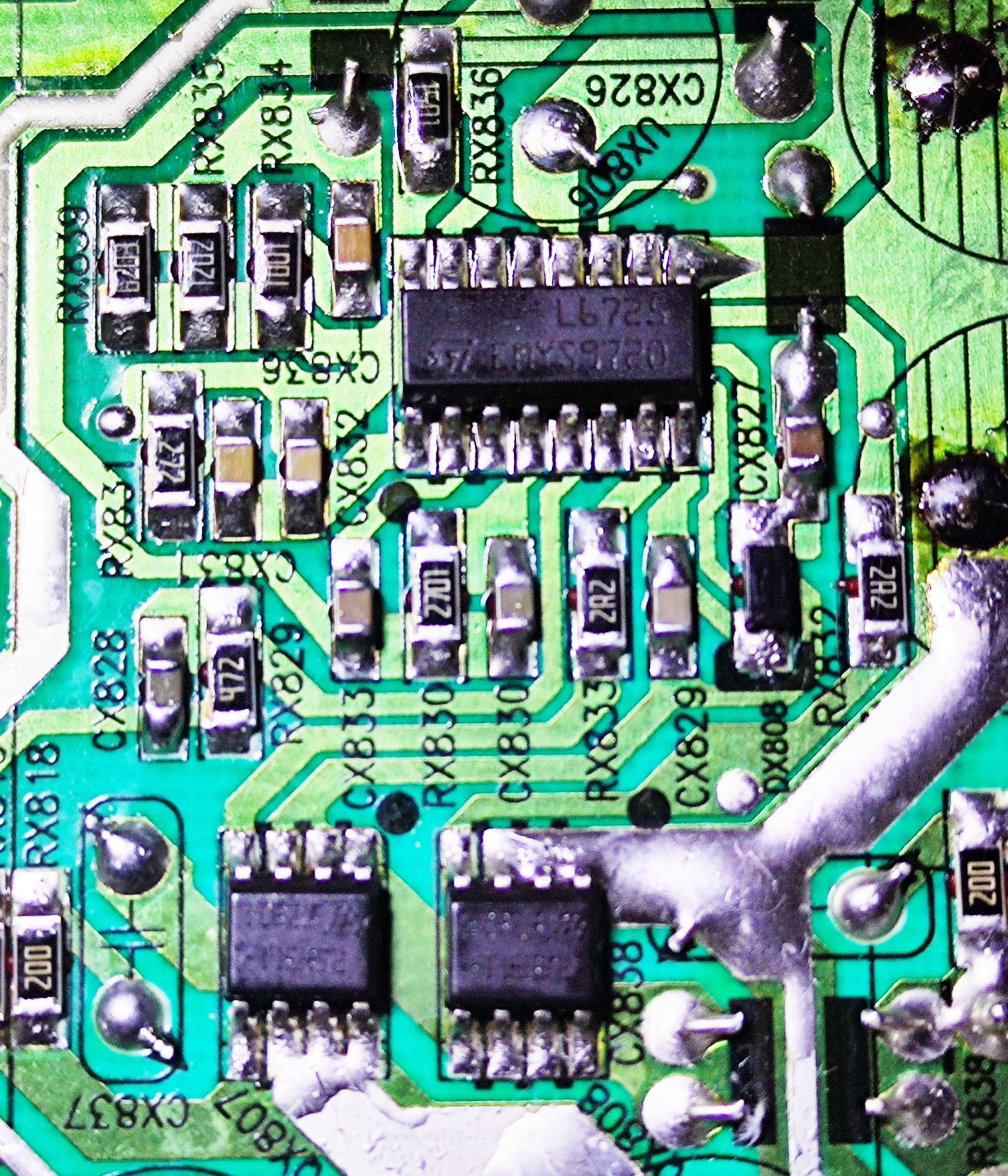

                Hello from Poland here. I also have lower voltage 4.3V instead 5.3V on this board. Any load connected to this line put the board in some clicking-test mode and ends with two green blinks. And worth noticing there is high pitch noise coming from the board once it is switched on by shorting 5V STB to GND. Circuit for generating this 5.3V is on the green-solder side of the board: controller L6725 + two mosfets: STS25NH3LL. In my case I've checked caps and diodes around and they seems to be ok, but QX807 seems to have shortage between GATE and SOURCE, second one QX808 doesn't have it, seems to be ok. I decided to replace both mosfets with BUZ11 mosfets as I have it around. Also there is a chance that controller L6725 is broken, but I do not have it and will start from replacing the mosfets.
                  Hello. It was the right direction. QX807 was faulty shorted. I replaced it with some other similar n channel MOSFET and now the TV works.
