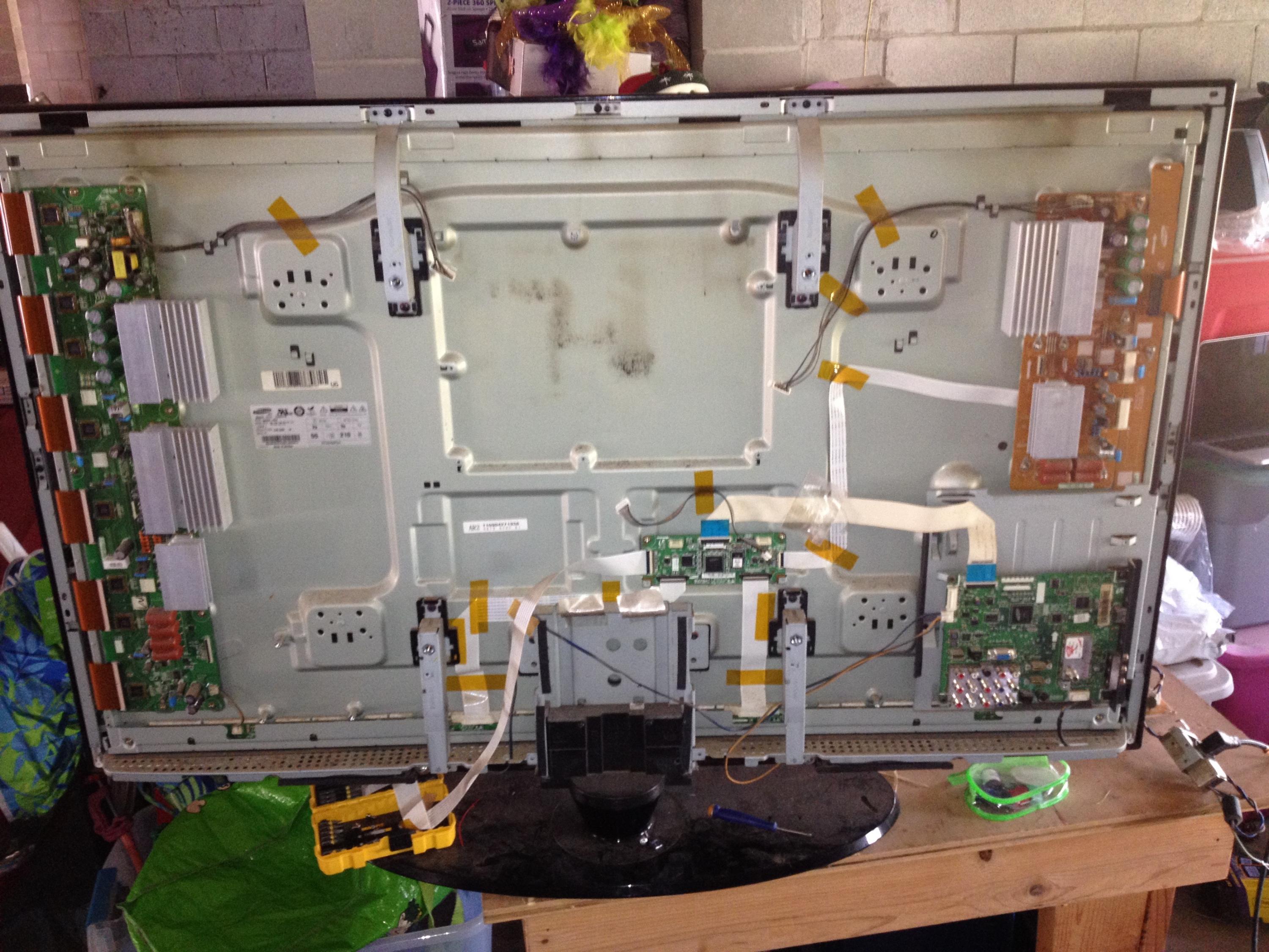

    The tv clicks and sometimes makes the chime sound but will not power on the whole way.
    Va and Vs don't have any voltage.

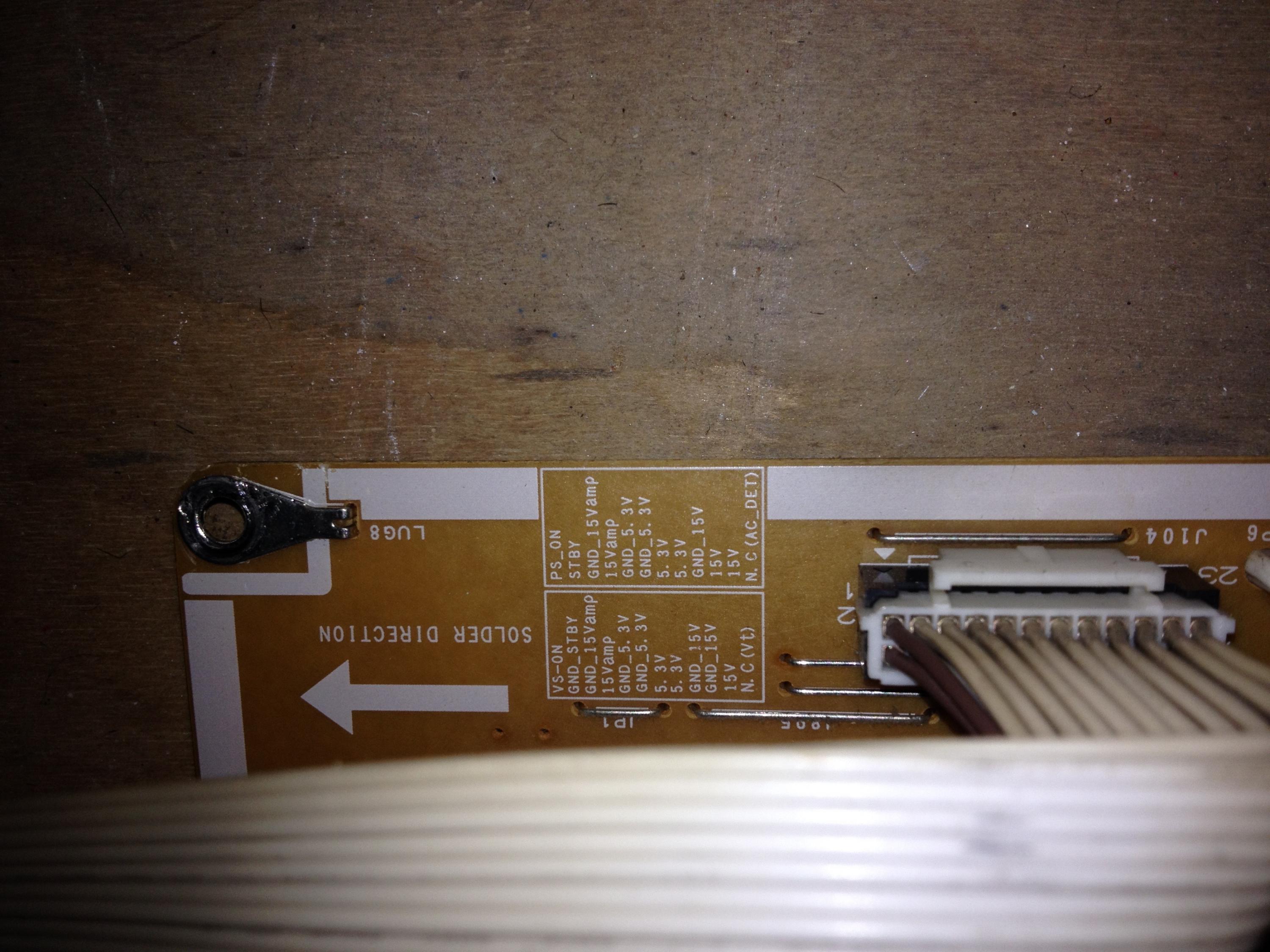

    When i jumper the board i only get 168v on the main caps when powered on.
    I get all of the correct voltages on the connector that goes to the main board.

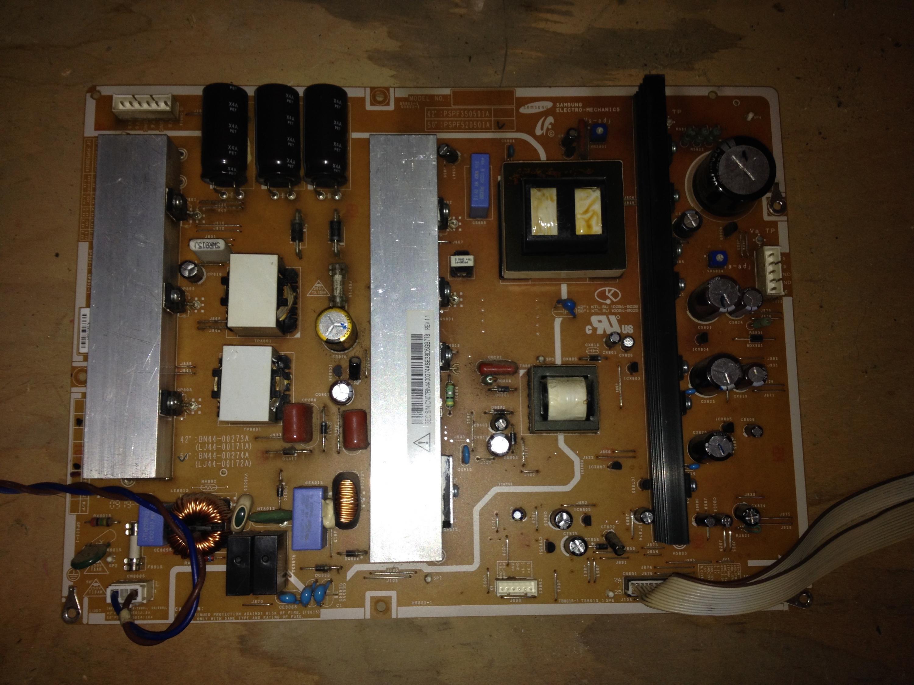

    The power supply is a bn44-00274a
  • pop70458
    • Jan 2012
    • 103
    Re: pn50b450b1d clicking
    I ordered a new power supply and the tv powered up but it has some horizontal black lines.
    Is there a way that i can narrow it down to a bad panel or y sus or buffer problems?
    • Andrew F. Ali
      • Jan 2014
      • 2450
      • Trinidad & Tobago
      This sounds like a Y-SUS and Y buffers problem. I would recommend changing the Y-SUS and Buffer Bds. together.
