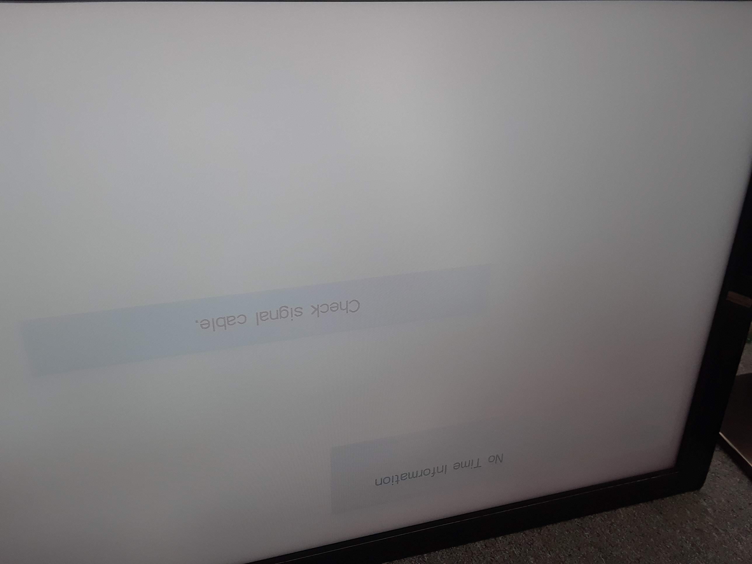

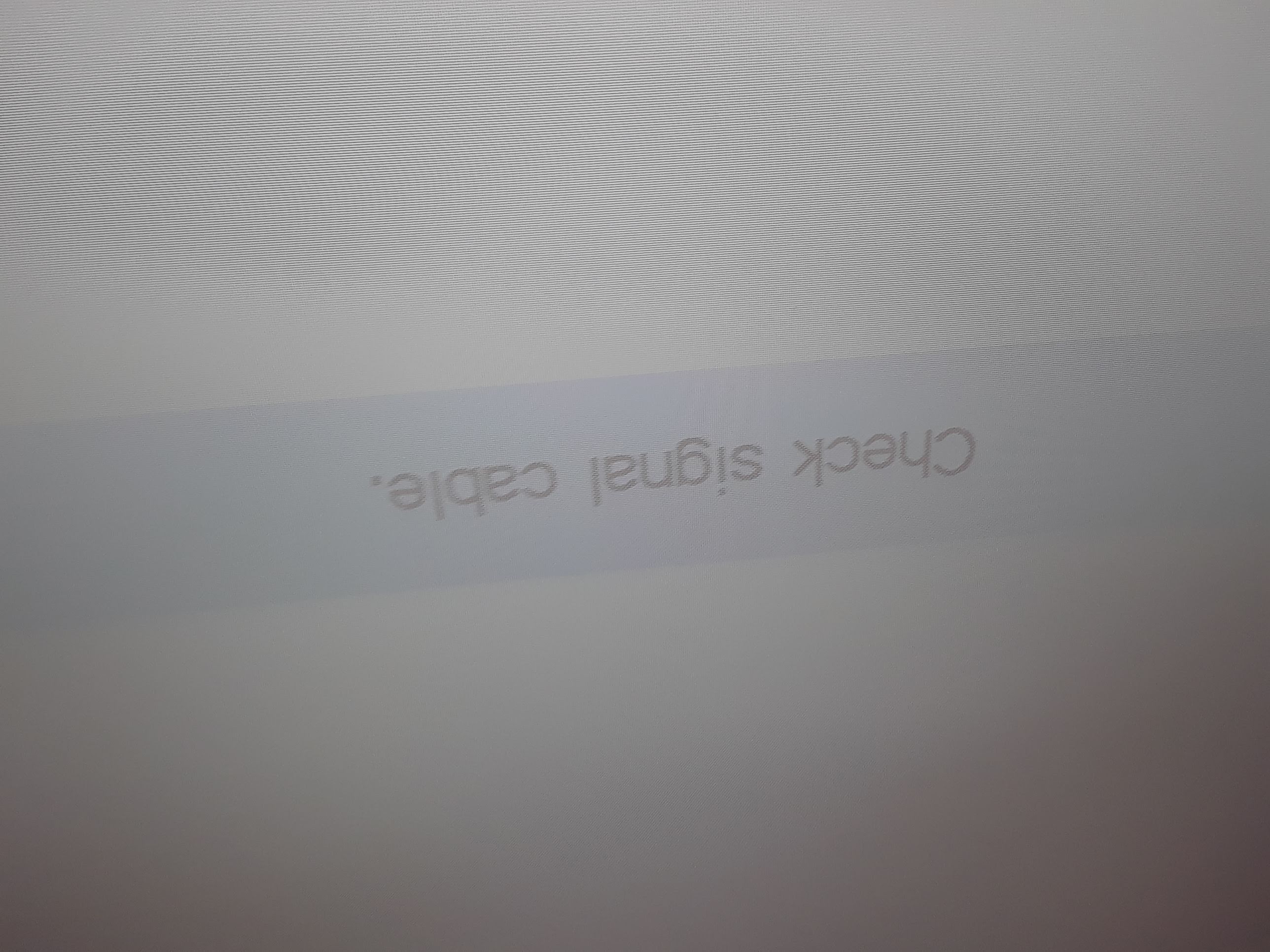

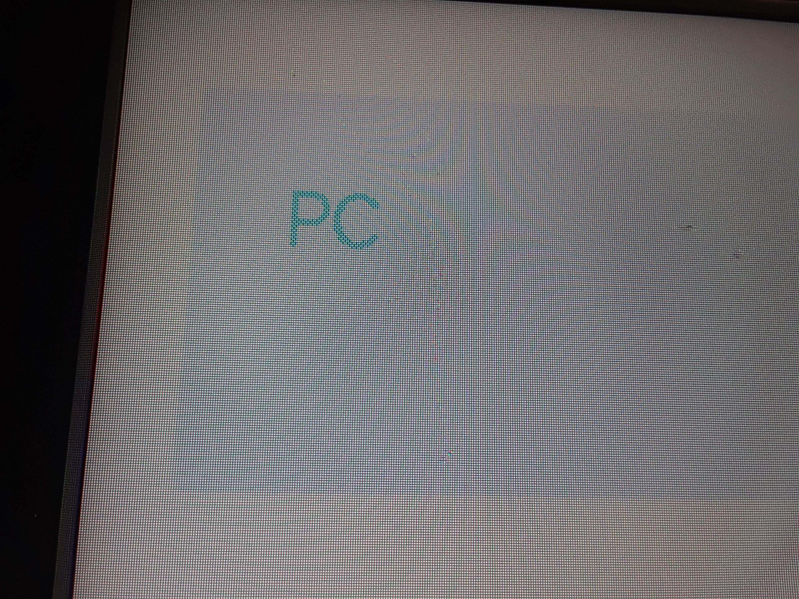

    Getting almost a white or cloudy picture. Voltages checked out good on the psb. Thinking it is possibly the T-Con. Thanks in advance.
    Re: Samsung LN46B530P7N
    Check Gamma Voltages.

        check ceramic caps on screen lvds pcb for shorts
