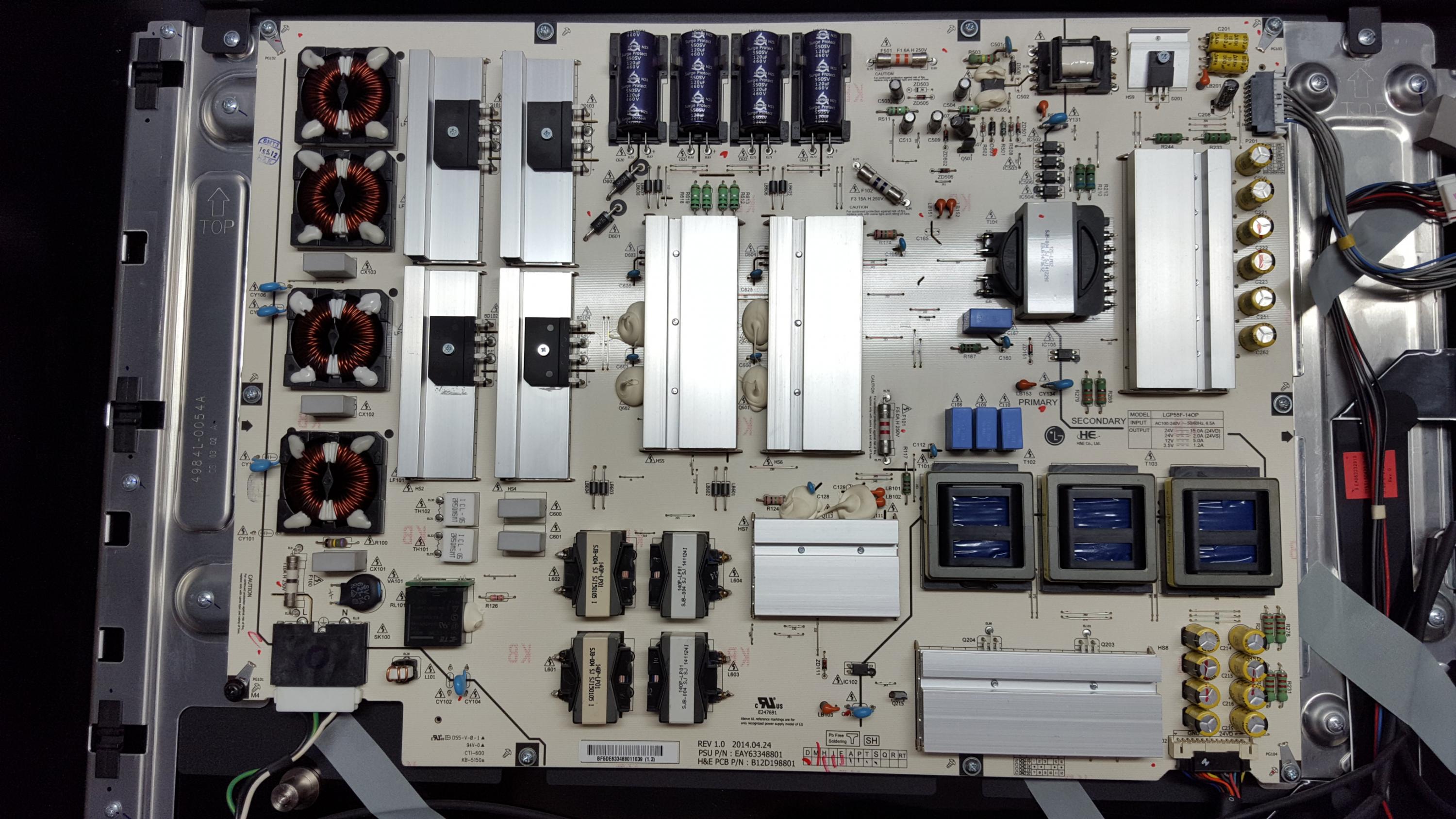

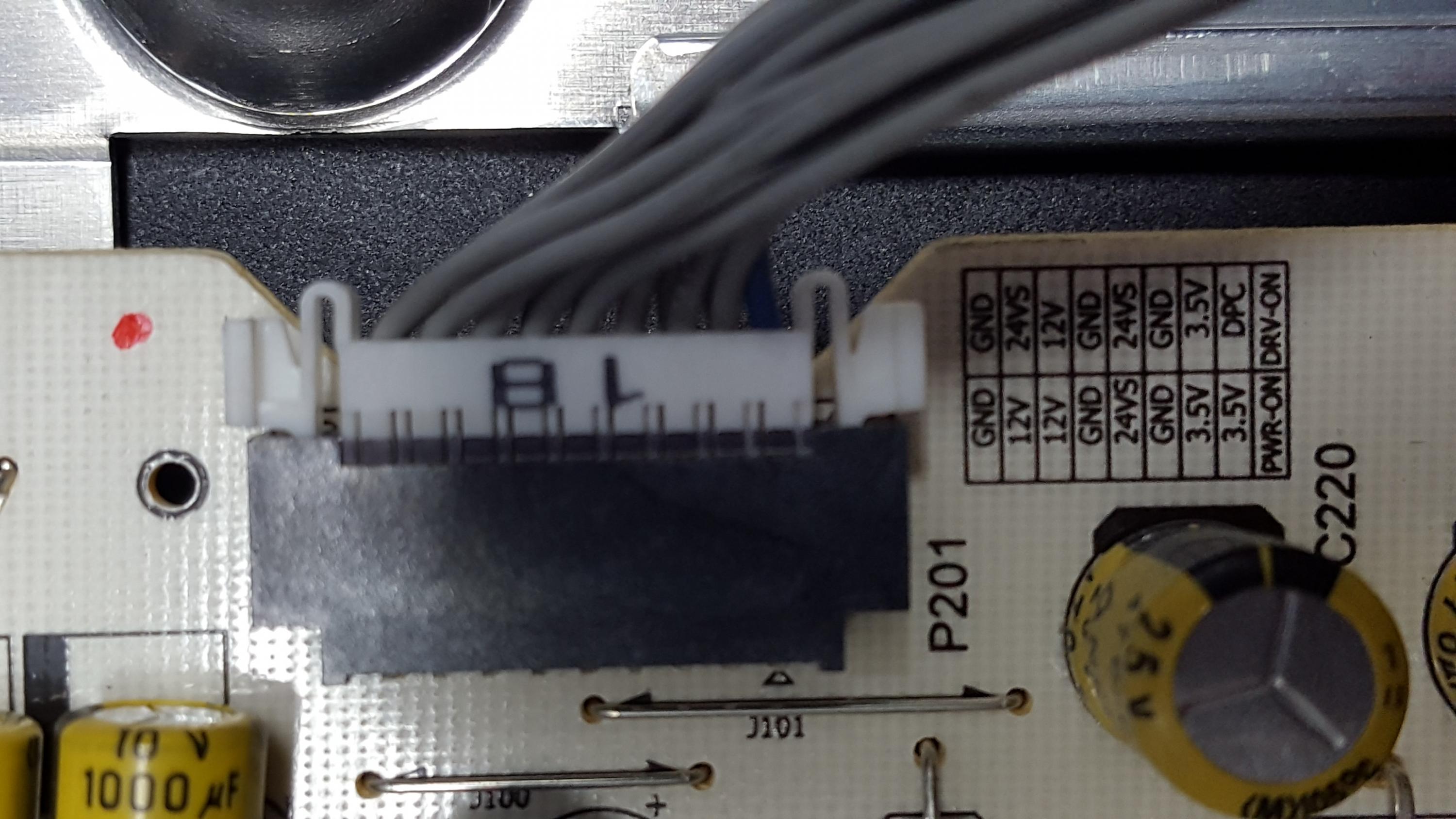

    I have gotten my hands on my first OLED TV, cracked screen sadly. There is oh so very tiny crack in the upper right corner, barely visible. If I am correct, once the OLED screen cracks, it will not self-illuminate at all, correct me if I am wrong.
    I am trying to figure out if the TVs parts are salvageable. When I turn the TV on, I hear a relay click, ~2 seconds later it clicks out. I do not get any blink error codes. I don't know if that is normal operation of the OLED TVs when they are clacked, of if there is an inherent issue.
    PSU is showing good stand by voltage, I even get PSU_ON from main for that short time it is "on". The 12V and 24V are there as well for that time.
    The DRV-ON circuit however is not on (0V), and the 24V pins on the bottom of the board, leading to the T-Con, are also at 0V.
    Any insight would be appreciated. Thanks.

      Once he screen has a fault like crack, etc the TV will go in 'self-protect' mode. The PCBs will be good. So store them for future use.

        IDK, I had a similar model (55EG9100) last year with cracked screen as well. I was able to turn it on, plug the laptop to it and at least get sound from speakers.

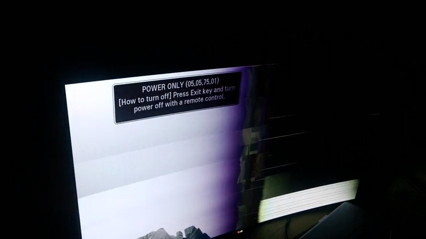

            Re: Need help testing an OLED TV | LG 55EC9300
            I bought a service remote, and was able to turn the TV on with the power only button, and for a couple of minutes the screen was looking good, then the right half went distorted and dark, and tripped out. I can turn it on again, but it trips out much faster than the first time.
            When it starts I get a good onscreen display for 30 seconds now. What would the likely problem be? TCON maybe?

              it is helpful if you uploaded photo on the screen behavior. some kind right screen distorted because of the main boards.. some kind of distorted half screen because of the low level edge boards of the panel. so i encourage you to start with edge boards you may find visible causer.
                I'll try. But it will be hard, because it happens for a very short time before tripping out.
                If I disconnect the ribbon for that side of the screen, should the tv work normally if the OLED panel or driver is bad? Can the ribbon be switched left for right?

                  service RC. you can use it for power it. and the "IN_STOP" it hard reset followed with inter code 0413. EZ_ADJ & IN_START followed with same code 0413 are for changing parameter at the main eeprom this you don't need.

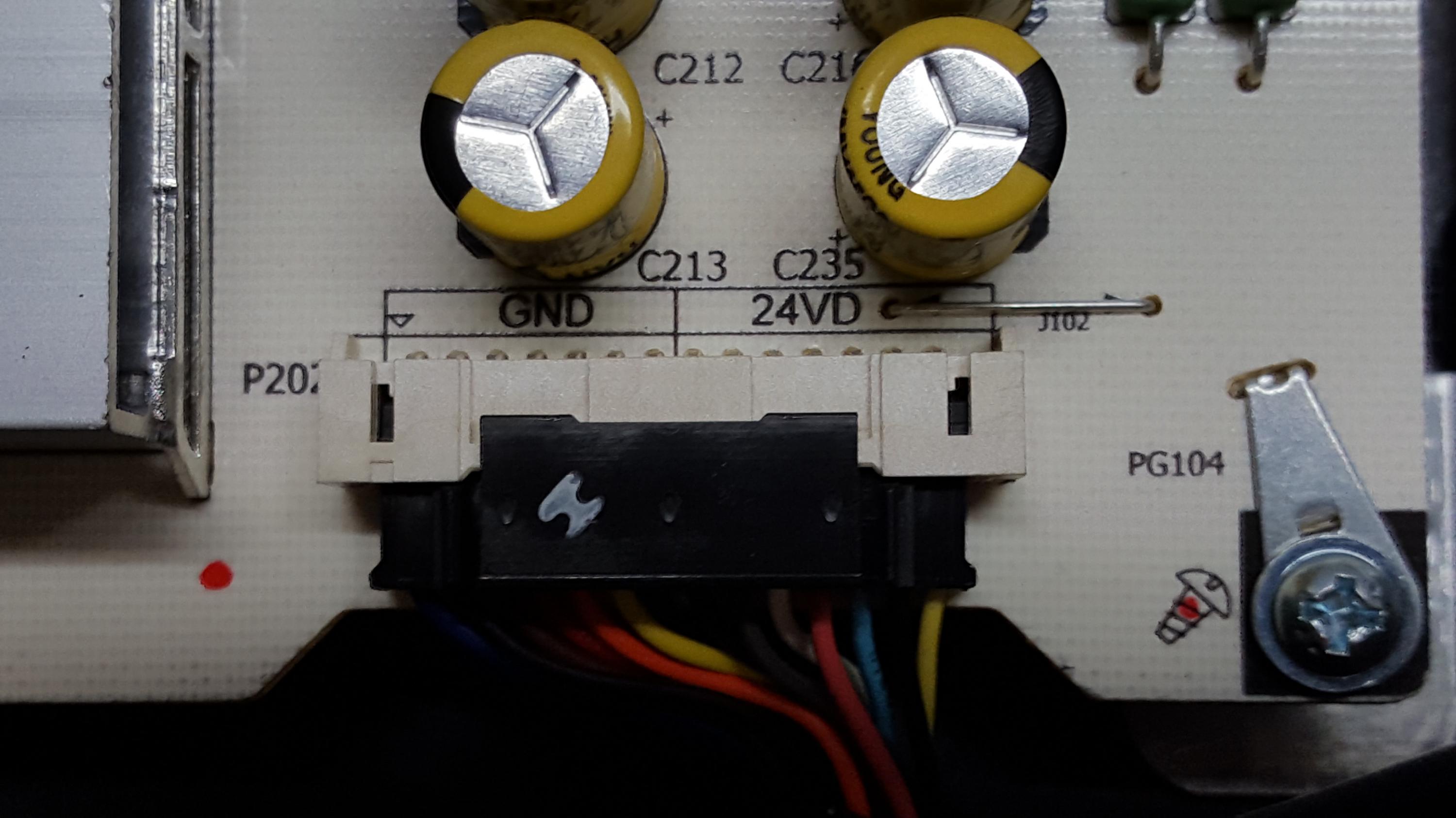

                  Try this test. disconnect the 24V socket cable from Power Boards to the T_CON driver boards.. then switch it on see if the set will remain ON but with black screen. you could know that the set ON from the red LED indicator should lit ON at the Optic Audio Input.

                      Here is a pic of the instant the TV faults and shuts down from the video.

                        its look from this video the issue not the panel .. waiting on yours test result i asked before.

                              yes this test should be as normal power on and only the 24V disconnected between power boards and t-con.

                              this metal cover shield rules not to cool down the IC on T-con. its to protect the boards from external noise magnetic / signal wave..

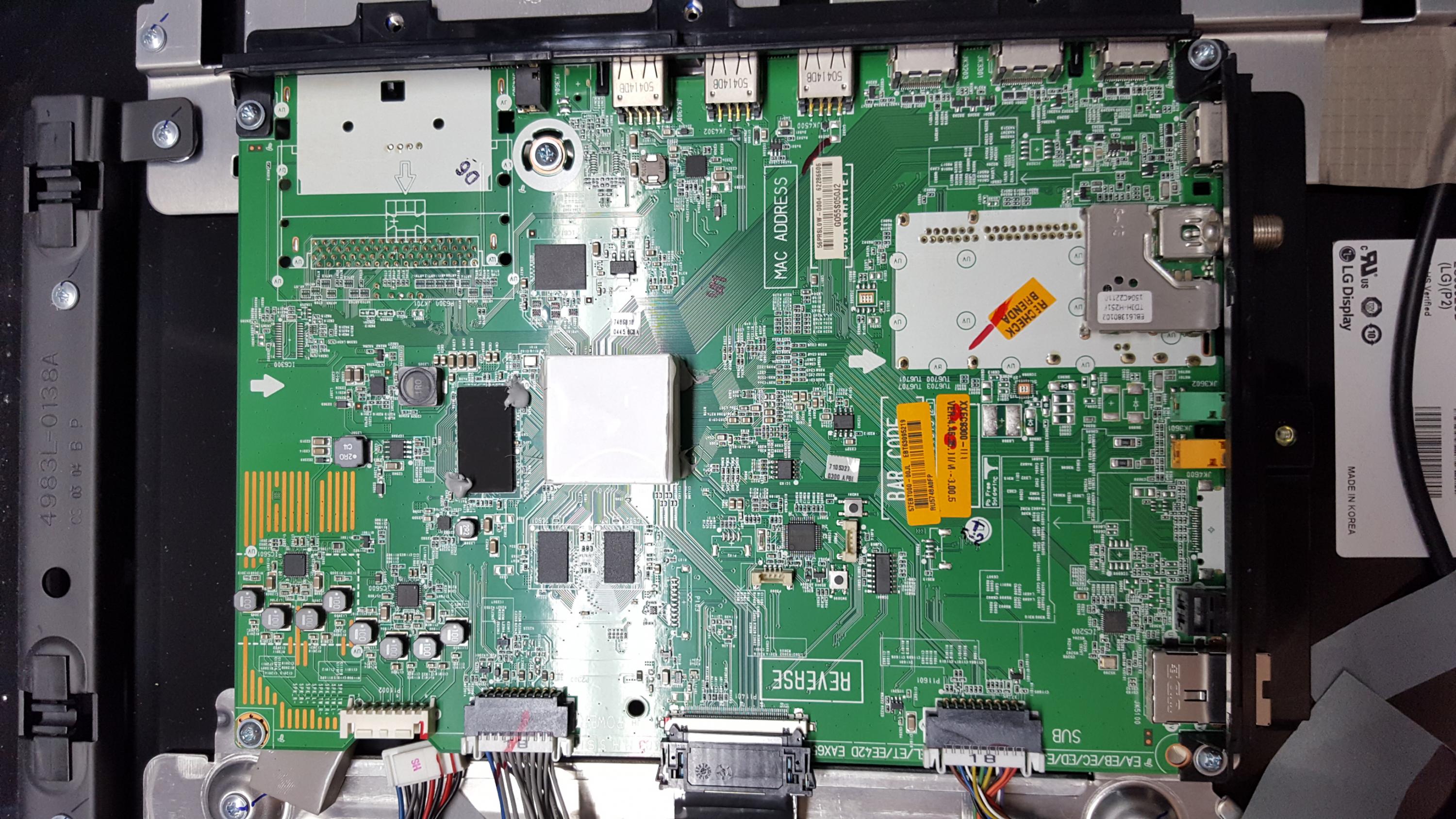

                              if the test you did correct and the set didn't stay on. its much like Main boards issue as i mentioned at my post #7.

                                When the tv did not stay on with the Power cable removed from the TCON, I disconnected the LVDS cable between the mainboard and TCON also to see if that would work, but no joy.
                                It looks like it may be a main board as you sugested.
                                It could be like this guy, and be not repairable, as the problems look very similar.

                                      here the instruction how to let the PSU turned ON with out main boards connected.

                                        I have run the test, the panel lights good on half(rotating r g b colors), and like the video on the other half, so bad panel or tcon
                                        After a while it goes to a white screen with black areas
