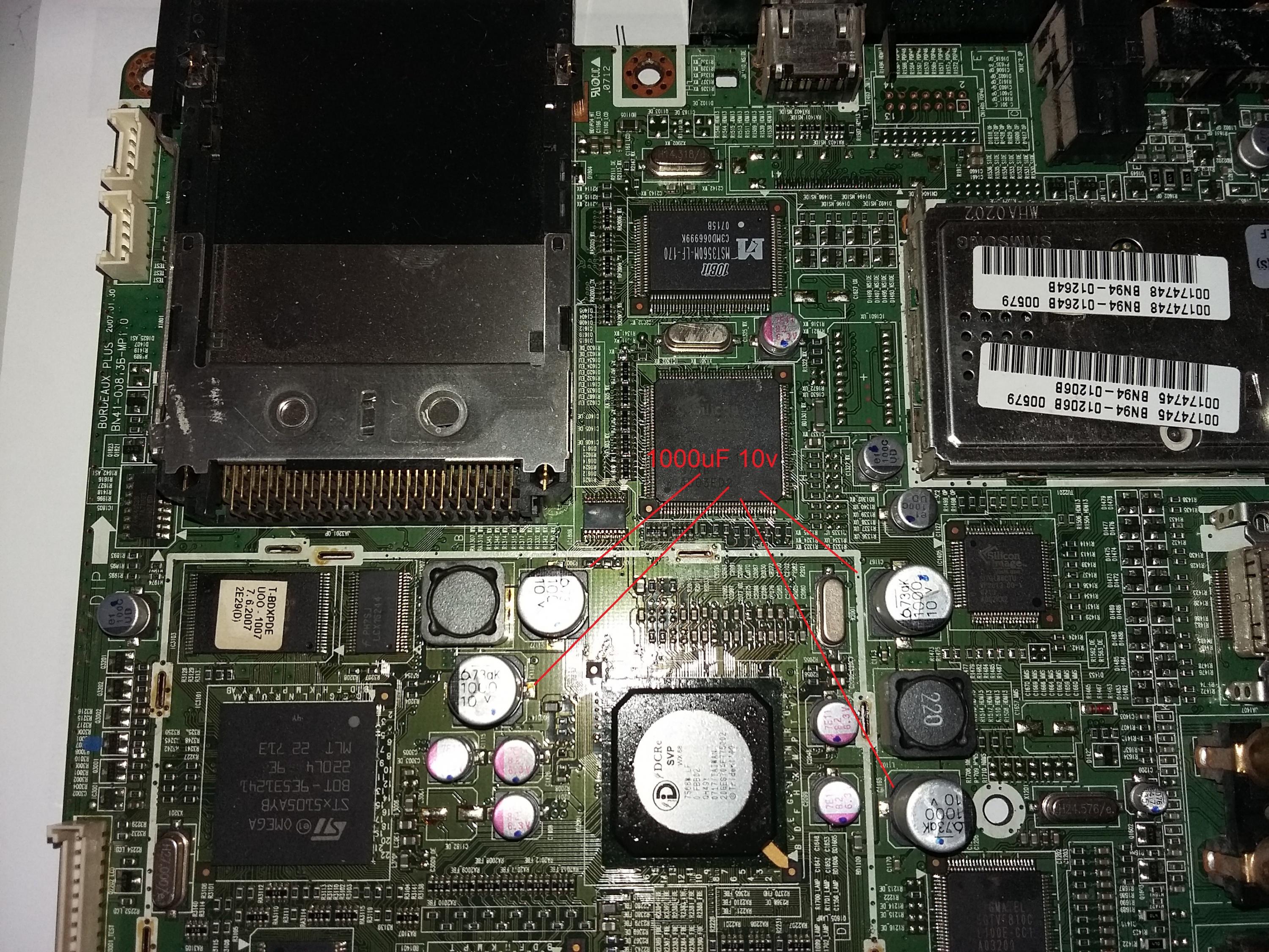

    Samsung LE40M87BDX powers on OK.
    I don't have the remote.
    Display is OK but no channels are tuned as yet, menus can be selected and navigated from the buttons on the side.
    After being on for a few minutes the TV will reset, PSU relay clicks, and the TV powers back up to where it was.
    This then repeats every 15 seconds or so.
    I have replaced all capacitors on the PSU though none were 'domed'.
    I am happy to replace all the SMD caps on main board but wonder about eeprom too, though others seem to have had various results with the latter.
    Problem persists with IR and control cable removed from main board.
    Does appear to me to be a hot fault so am thinking the caps under the DTV screen as this does warm up quite a bit.
    Don't have access to a capacitor tester, just multimeter and a scope.
    Any thoughts ?

              Well, we move on. I started to replace ALL of the caps on the control/system board.
              There are about 35 and are all SMD. I started with the larger ones 4 x 1000uF and 2 x 220uF and then did some others but to be honest did struggle. I found difficulty with my Weller iron and pointed tip getting the contacts to come clean off the pads and actually lifted a couple of pads. In the end I gave up, refitted the tin screen and refitted the board in the TV. Result....TV now stays on and does not have the 15 second re-cycling fault any more.

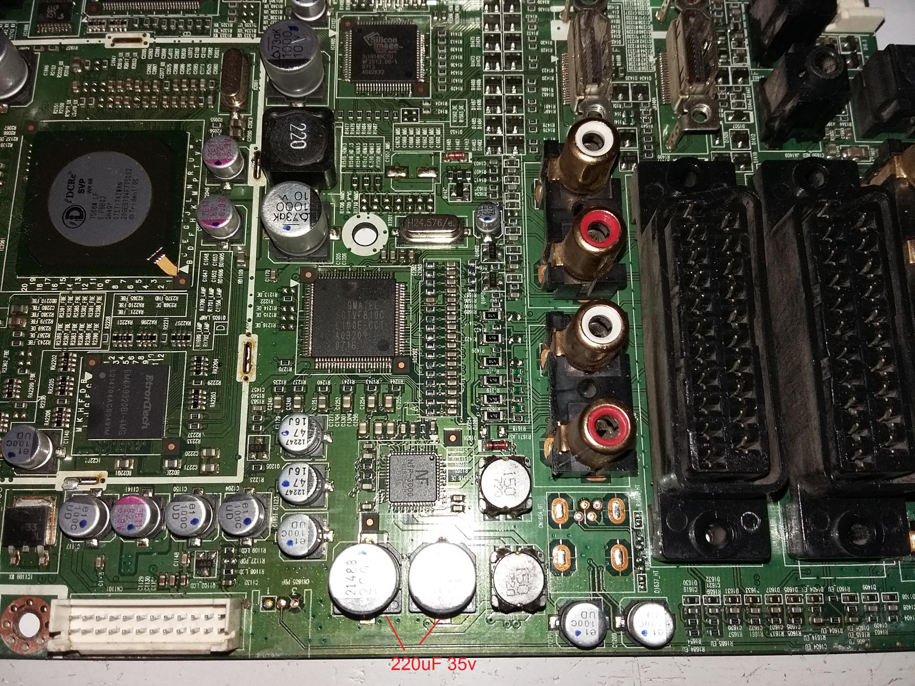

                                  Re: Samsung LE40M87BDX resets very 15 seconds
                                  I think the likely candidates were the 4 x 1000uF under the tin shield of the 2 x 220uF.
                                  These were the 6 physically largest caps on the board.
                                  The others that I changed were small like 1uF as I was going to change everything but gave up in the end due to difficulty getting them off the board.
                                  • andytw
                                    • Jun 2018
                                    • 13
                                    • United Kingdom
                                    Couple of images of the capacitors I replaced. One of which would have been the faulty cap.
