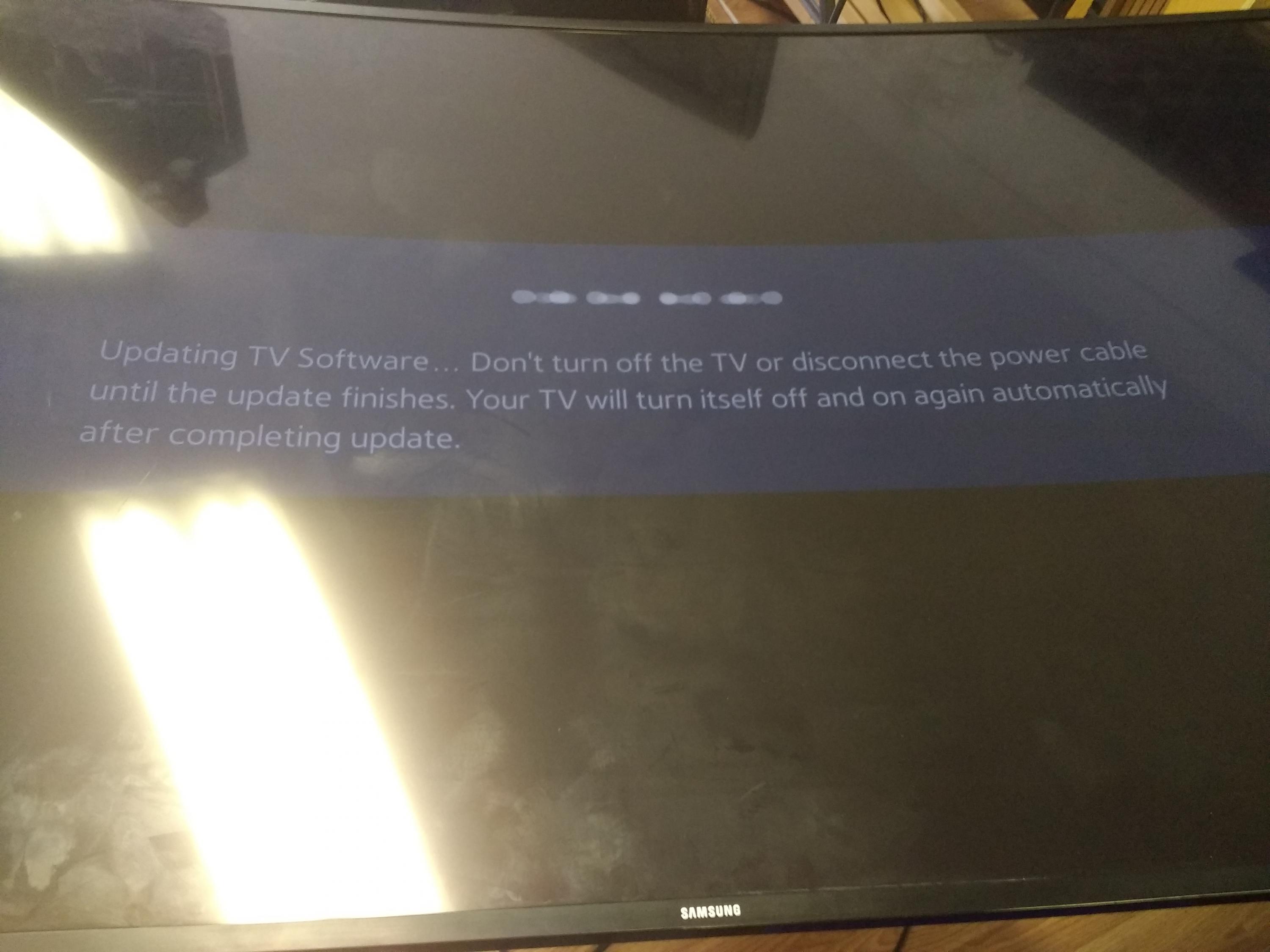

    Hello!
    I picked up a Samsung UN55JU6700F curved TV. It was stuck in an endless update loop where it would restart and go through the update again. You can not do anything with the TV while this occurs (menu, input, etc) I tried a google search and the majority of the issues involved Samsungs that use a One Connect Mini which this TV does not use.
    I found a Youtube video that suggested turning off Wi-Fi and then the TV would come out of update and you could turn remote management off. turning my wifi off did not work. I even unplugged the WiFi card but it kept trying to update.
    I purchased a new main board and that fixed the problem. I never connected the TV to the internet and turned app update off in settings and looked for remote managment but there was no option. About a week later after working fine it went through the same issue.
    I purchased a new main again and when I installed the main this time I just left the wifi card disconnected. The TV worked for 2 weeks before going through an endless update again. I found some information that suggested that a Samsung Technician remote can fix the problem through factory settings so I ordered one off Encompass but it won't open factory settings before going through endless update. I don't want to order a new main because I don't know how to stop this from happening. I'm hoping someone here can offer me some advice.
