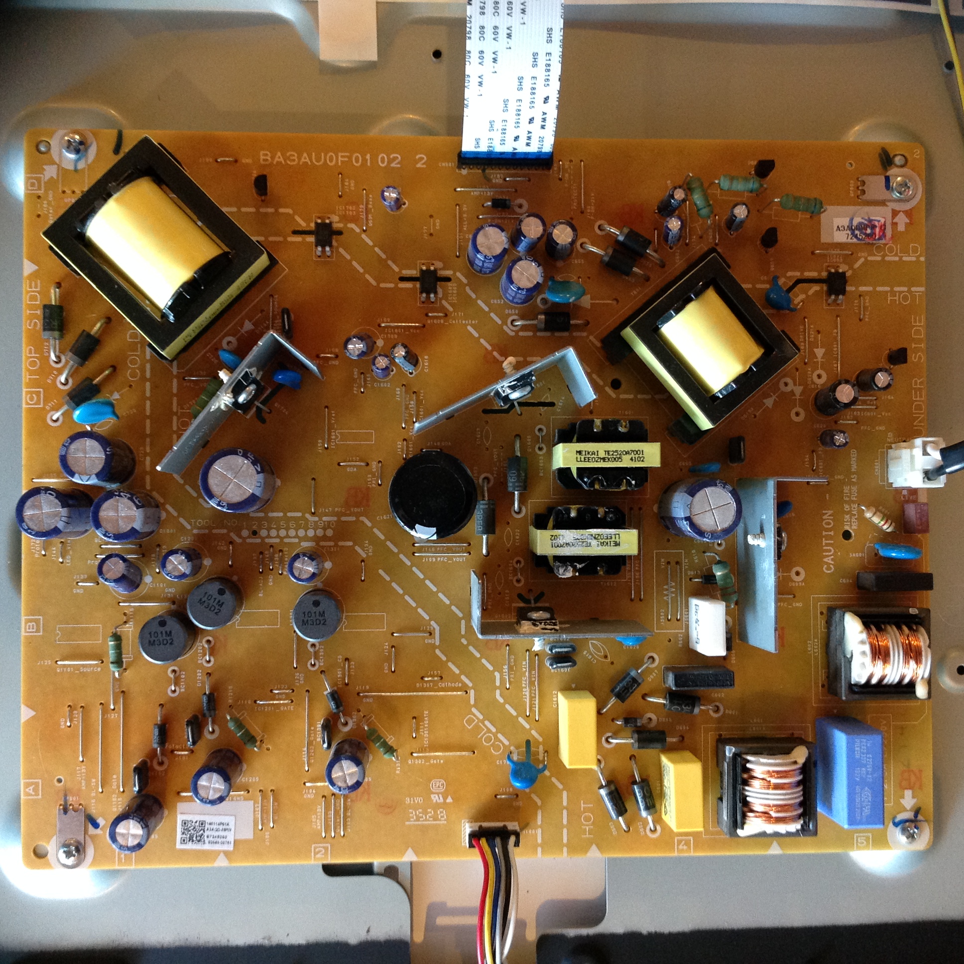

    At the supply board I have what I assume is normal voltage for the 21v power on and the 3.3v standby/always on. I haven't really checked anything on the main board because I'm not sure what I should be looking for. It's definitely getting voltage though. Also I had a small crimp in my cable from main to the T-Con(?) but it's no worse the the folds from the factory. I started checking continuity on that but kinda gave up after the 10th pin.

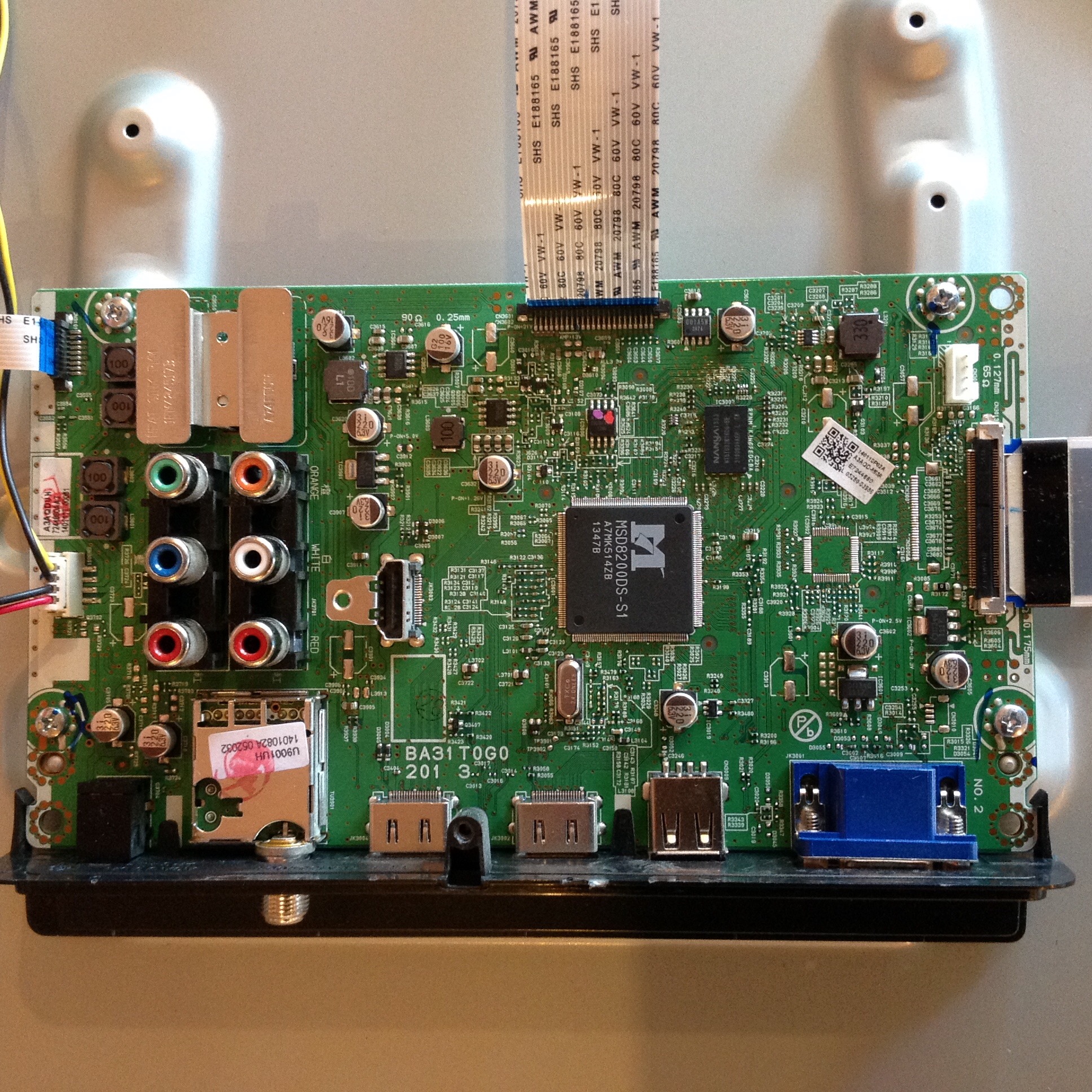

    Initially I was just going to order a new main board but I had a a hard time finding one...which the LEDs were the primary issue anyway. Kinda back to where I started but a different problem. I see some people offer online/mail in repair services for these boards if that is the issue.
    Any advice for troubleshooting and testing would be appreciated. Hoping I can salvage it and put it upstairs as a game and movie TV for me and the kids. Sorry for the essay, I like to be descriptive and usually find that putting all the info out there helps get the problem solved quicker.

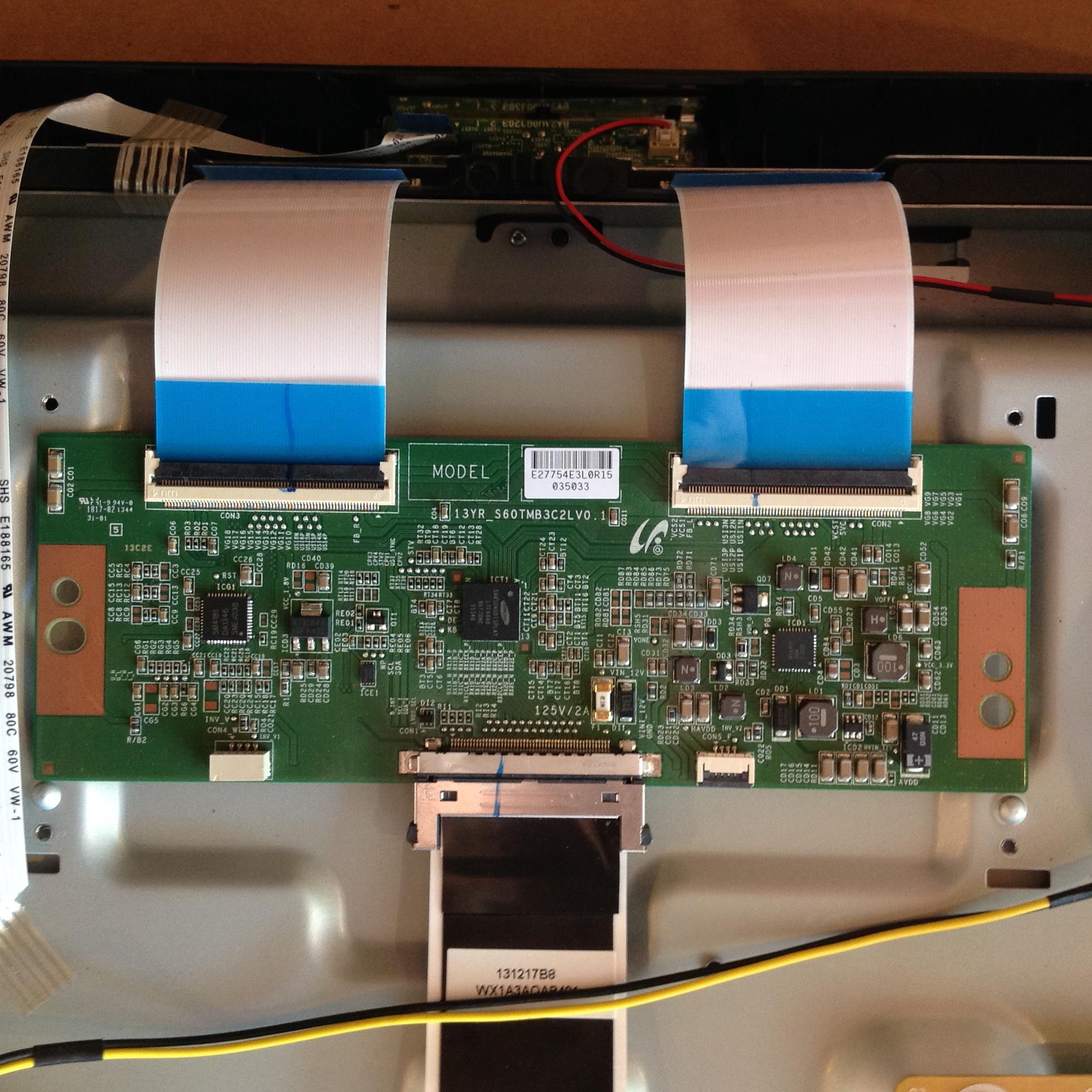

    Did you verify that you do have 12V on both ends of the SMD fuse on the T-CON board?
    Upload good clear pictures of YOUR boards will also help.

            I removed the TCon board for better lighting and access with my multimeter. Rung out pins (1 and 4 connected to fuse). Have 12V on pins 1 and 4 out of mainboard to end of LVDS. Hooked TCon back to mainboard and LCD panel to check voltage on pin 4. Got 12V. Checked pin 1...also 12V AND both sides of fuse read 12V now. LVDS cable isn't getting hot anymore either. Noticed the power supply board wasn't as noisy either. Wondering if a cable was not seated well or something else shorting a connection.
            Got excited and lifted up the display...but no picture still. So now I'm sitting at 12V power to TCon and wondering what to do next.
              Re: Emerson/Funai LF46EM4 no image
              There are two cables between the T-CON board and the LCD panel, try having it connected one a time to see if you will get good picture on half of the screen or not.

                Attached main and supply board pics -- couldn't do it from wife's old iPad earlier. Attachments from photos on iOS just automatically name every file "image" when uploading and overwrites multiple files, just leaving you with the last uploaded.
                  Can we see the pictures of the T-CON board?

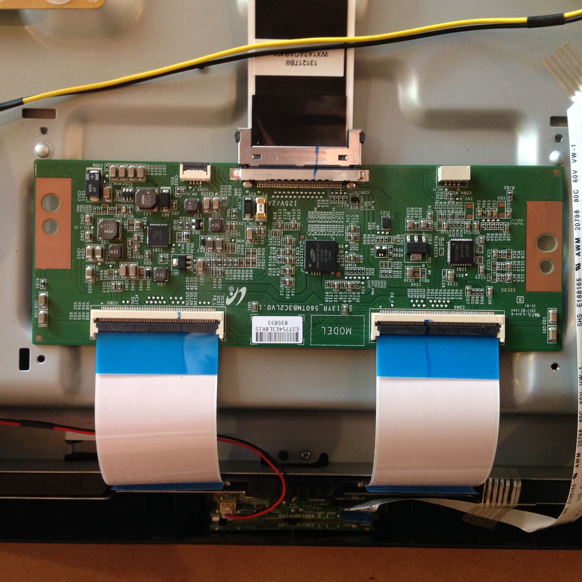

                    Attached again. Let me know if you want detail of anything and I might be able to use a DSLR to get a closer high res pic. Would it be worth checking for audio again on an input since I'm getting normal voltage to the TCon now?

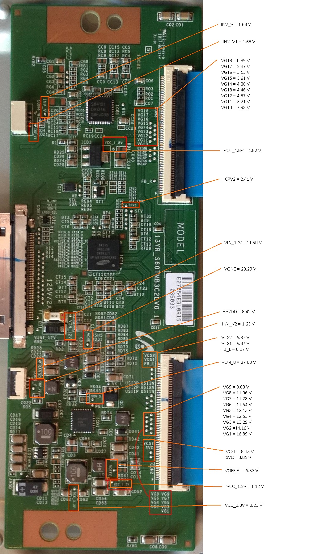

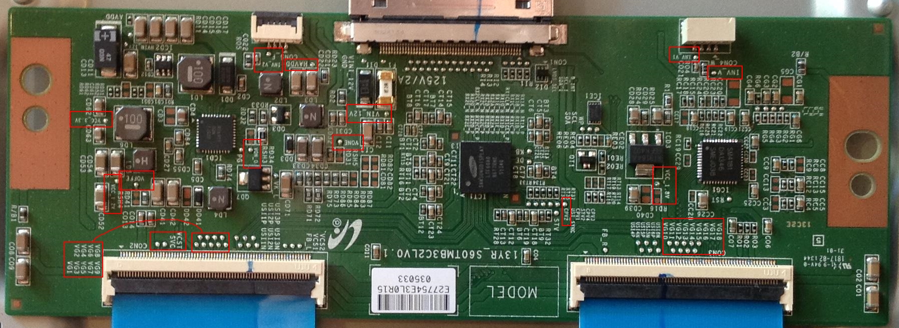

                        I can see some Voltage test points on the T-CON.
                        • Josh86
                          • Jun 2018
                          • 18
                          Reattached marked up image with voltage reads.
                            So looking at the reads I thought "where is CPV1 if I'm reading CPV2"? I then realized I actually never read CPV2; I used the top test point which was likely for CPV3. I completely ignored all the rest of the labels and just looked at that highlighted box -- whoops.
                            If you really need CPV2 (I assume it's an important signal), I'll have to wait until I'm back home to check it out and I'll record all those values on those test points. In the meantime, if there are any other points you want me to check (either here or on mainboard) I'll note those and get the reads.
                            Really appreciate the direction/help.
                              Remeasured and the CPV testpoint area reads as follows:
                              CPV3 = 2.407 (taken the day before)
                              CPV4 = 2.37 V
                              STV2 = 2.37 V
                              CPV1 = 2.37 V
                              (?) USI_SYNC = 1.77 V
                              CPV2 = 2.11 V
                              • Andrew F. Ali
                                • Jan 2014
                                • 2450
                                • Trinidad & Tobago
                                Some of those T-CON Bd readings are off. I think you should get anew T-CON Bd and give it a try.
                                  Which voltage readings do you suspect are abnormal from expected voltage? This way I can retest and confirm before before I order a new T-Con board.
                                        Haven't been able to look at the set for about a week but...
                                        I'm ordering a t-con board because they can be had for ~$10.
                                        I went through the troubleshooting flowchart on a 39" Funai (all the connectors/pinouts identified the same) and I end up with the result that it's either the mainboard or a bad panel. The "no video" tests had me check for certain voltages at specific pins on both the mainboard and connection to the t-con. They ended up coming out as expected which leads to the suggestion of replacing the main CBA or a defective/bad panel. I fear the latter because I moved it around a bit during disassembly to fix the bad backlighting. Maybe there's a short to the aluminum framing; who knows. I could pull it back out of the chassis and see.
                                        Before I put the t-con in I'm going to check the only FET on the t-con board. I read some other posts (and saw the shopjimmy video) about how a bad panel can often be the cause of damage to the t-con.
                                        I'm still a little concerned in the case of either a bad t-con or bad panel that I'm still not getting any audio, which I can't see that issue being anything but something on the main CBA board.
