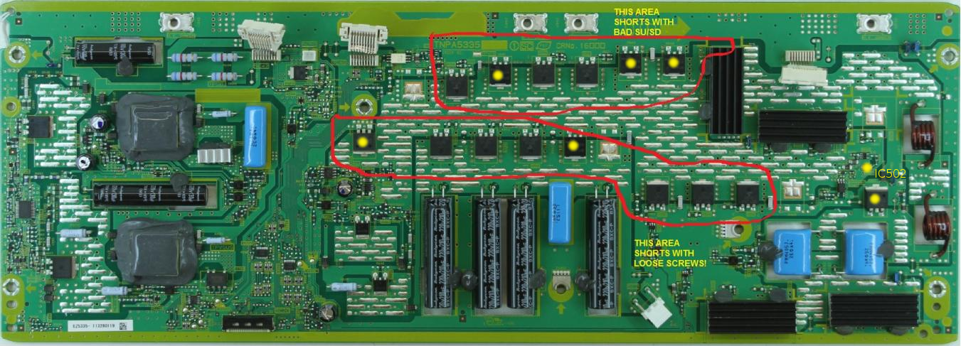

      I added a picture.
      The difference between the TX and TP is that TX is used in Europe and TP is mostly American/Canadian models but the basics are the same. They do use different boards.
      7 Blinks for this model is usually the SC board that is shorted deu to screws that are loose. Board starts arching between ground and the board and the board gets shorted.
      It is best to measure the SU/SD boards outside of the tv. Black prope on the screw hole and slide the red prope against the copper pins. Beep is bad. Watch out though , there are small ground holes on the board. Dont get confused. Make sure the multimeter is in diode/beep mode.
      A shorted su/sd board could be to a shorted panel but usually it's just 1 or 2 chips that get shorted.
      When those SU/SD boards get shorted they can short out the SC board. If you disconnected the SU/SD board from the SC board and used the SC50 jumper and still 7 blinks then the board is shorted.
      If the SU/SD is the main problem you need to measure the 30F131 close to the white connectors. Take a look at the picture , its the top side area.
      There are 2 rays of FETS on the board. Top side and lower side. The top side with RFN20/30F131 are usually shorted because of bad SU/SD board.
      The lower area with just 30F131/RJP30H2A close to the capacitors are shorted when the screws are the problem.
      If you have found the defective area which is probably the top area then measure the OUTER pins on the 30F131 in diode mode. Beep is bad.
      If you get a short then remove ALL the defective 30F131 and then measure the diodes to see if they are still shorted.
      You need replacement parts to fix the sc board. Dont buy repair kits but buy FGD4536TM from a GOOD seller. There are to many fakes on the market.
      If you cant find the parts then buy a SS board from your model , the parts you need are on that board.
      Good luck! Let me know the outcome.

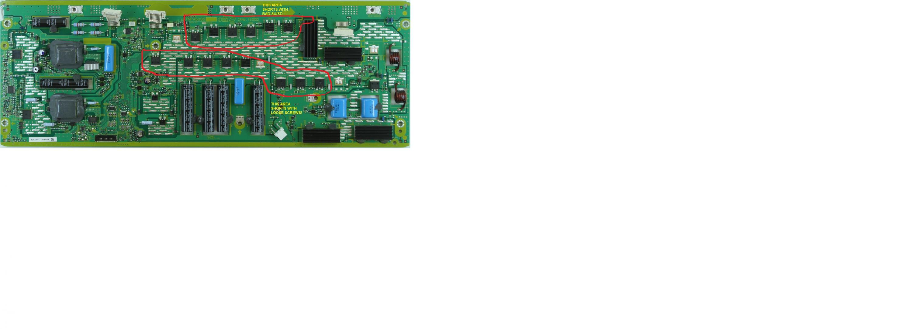

        First, Thanks for your reply. I also added a pic.
        When I ran the SD/SU-isolation-test with SC50-jumper and disconnected buffers, the SC also gone in 7 blinks of death (as I wrote in my first post).
        OK. The SD/SU and SC are now outside the tv. As mentioned in my first post, the SD has no shorts; SU has several shorts at SU3 and SU4.
        The GND-screws holding the buffer-boards on the SC were realy hard to loose and had already spring washers installed. Maybe here did learn Panasonic from failures from past?!
        Now the SC:
        Diode-test beep on following items:
        D421 (DAF30A)
        D401 (RF1501)
        D432 (RNF10)
        D641-643 (RNF20)
        driver IC502 between 1-8
        It seems that both areas are affected... I'm wondering, that all the PDP-IGBT (Qxxx) having no shorts, but only the diodes?!
        At this point I hope not need to seek for Fairchild IGBT FGD4536TM, because like PDPs are extinct, the PDP-IGBT seem also to be extinct. Very hard to find a seller in EU and propably components from china are most fakes.
        I remarked the shortet items in your picture with a yellow dot (please see attachment).
        Could there be another bad caps on SC, that should be tested?
        As a first step I'll replace the diodes first. What Do you think about IC502 Pin 1-8 short?

          The big screws for the su/sd boards all have lockwashers except the screws on the board itself. So no , you have a standard model with 7 blinks.
          DAF30 and RF1501 will probably read short because other parts are shorted. Most likely only the diodes on the top board are shorted , funny the fets itself are not shorted......
          You did test ALL parts in diode mode?
          Parts labeled with Q you need to measure the OUTER legs. ( 30F131/RJP30H2A).
          Parts labeled with D you need to put black prope on middle pin and red on either left or right leg. Beep is usually bad. ( RF1501/RFN20 ).
          Your shorted buffer board probably took out the SC board OR you did not short the sc50 jumper correctly. SC20 cable is still connected?

                              Today I measured again the remaining parts after removed Q62x (2.test in following table):
                              Code:
                              Item  Type     1. cont.-test   1. diode-test   2. cont.-test   2. diode-test
                              Q401  30F131       o.l.      <=0,931       o.l.       0,881
                              Q402  30F131       o.l.      <=0,929       o.l.       0,882
                              Q403  30F131       o.l.       <=0,93       o.l.       0,881
                              Q421  RJP30H2A      o.l.       0,930       o.l.       0,947
                              Q422  RJP30H2A      o.l.       0,930       o.l.       0,947
                              Q423  RJP30H2A      o.l.       0,930       o.l.       0,947
                              Q621  30F131       o.l.       0,931      (removed)     (removed)
                              Q622  30F131       o.l.       0,930      (removed)     (removed)
                              Q623  30F131       o.l.       0,930      (removed)     (removed)
                              D401  RF1501       o.l.       0,412       o.l.       0,414
                              D421  DAF30A      397 ohm      0,343       o.l.       0,344
                              D432  RFN10       o.l.       0,472       o.l.       0,473
                              D641  RFN20       o.l.       0,418       o.l.       0,418
                              D642  RFN20       o.l.       0,418       o.l.       0,418
                              D643  RFN20       o.l.       0,417       o.l.       0,418
                              Qxxx (IGBTs): the outer legs
                              Dxxx (diodes): black probe on middle leg, red probe to left and/or right leg.
                              I'm looking forward for your reply
                              @Moreno:
                              Next I should order some/several of the IGBT Fairchild replacements for 30F131 from the good seller you sent me in your PN...?!
                              Kind Regards
                              Martin

                                TNPA5335-AG
                                After more than a year, the in 2018 repaired SC-board, gone to 7 blinks again. I dismounted this from the TV and recognized, that Q401 was not properly soldered (Gnd plate). Should be easy to repair...
                                So I decided to replace this SC with a second spare SC-board which worked fine in 2018, but after mounting into TV I get also 7 blinks. When disconnecting the buffer-boards (SU,SD) and jumpering SC50 (isolation test mode), the board starts successfully (SC-onboard green LED get's on; no 7 blinks). There are no shorts reading on any of the ribbon connectors from both buffers to PDP. Re-connected the SC to the buffers and removed SC50 jumper, start up fails with 7 blinks again...
                                The also no shorts reading on any of the D- or Q-labelled parts; all diodes and IGBT seem to be OK.
                                Have you any hint, which part in the recovery-unit-area could be bad and how to test this?
                                Could there be a problem with the buffers, despite of having no shorts at the ribbon-connectors?
                                I'll also try to solder the Q401 on the first SC mentioned above and give these SC a try... But I would be glad to have a second spare of TNPA5335 as a replacement.
                                Kind Regards,
                                Martin

                                    After re-soldering the Q401 IGBT, I found the diode D421 (DAF30A) was dead; I exchanged the component.
                                    The story goes on:
                                    Now it's interesting, that BOTH SC-boards start up successfully within the buffer-isolation-test (disconnected SU/SD, jumpering SC50) without 7 blinks and the green on-board LED on SC turns on.
                                    But: BOTH SC-boards don't start up regularly with connected buffers and 7 blinks of death is back - with BOTH!
                                    1. Can 7 blinks indicate also, that one or both buffer-boards are bad?
                                    2. Or is there a problem within the energy-recovery-section on BOTH SC?
                                    3. If yes, which components could be faulty? Where ist the recovery-section located on SC?
                                    Who can help me?
